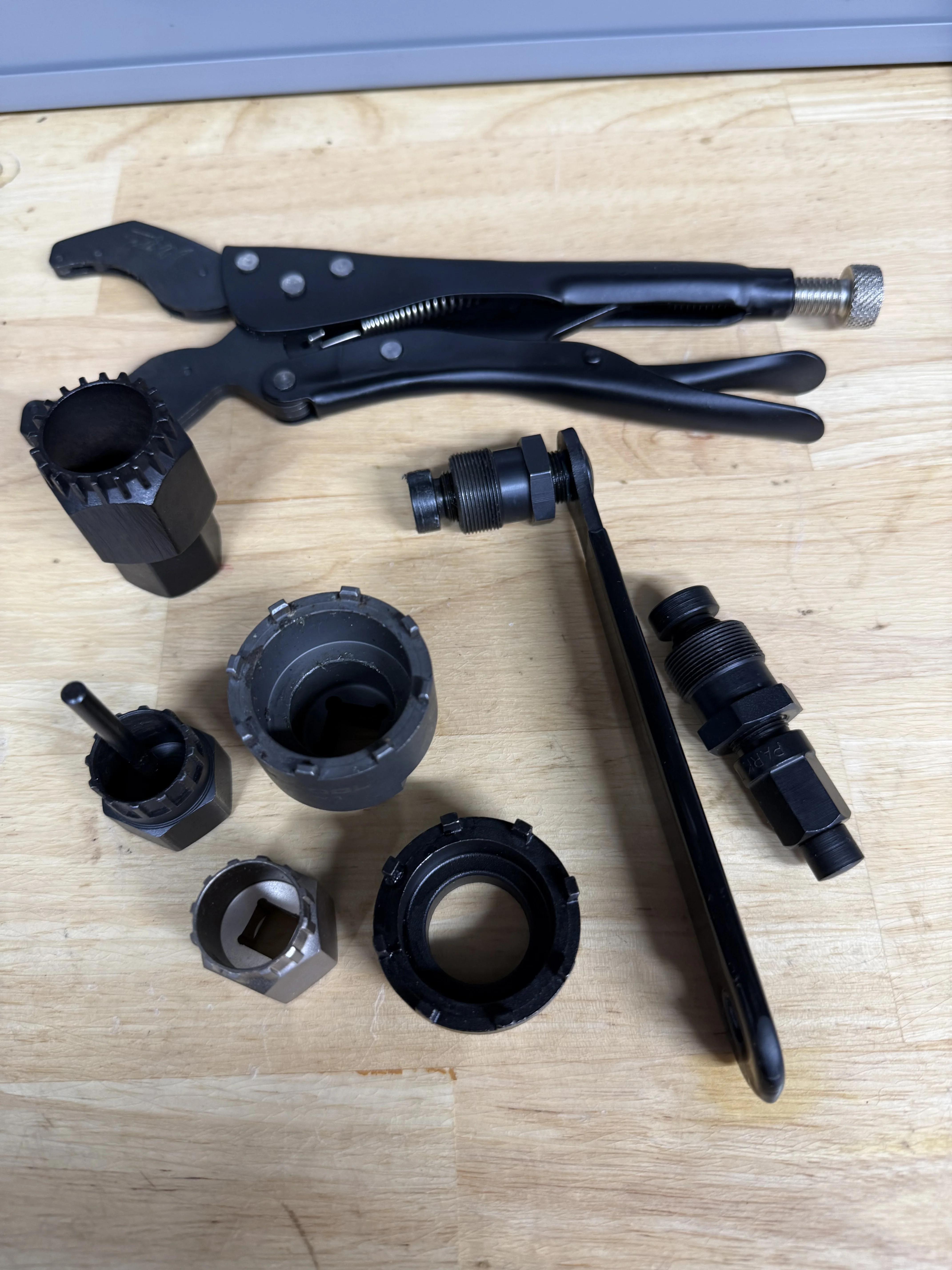

Ah…no. Greg, you may be confusing a cassette with a chainring. Those are different components and require different tools and methods for removal.
An Avinox compatible spider socket, or castle socket (I call it) is required to remove and replace the chainring. The fine threads on some motor shafts are reverse. On the Avinox motor they are standard, or clockwise. (This is better in my opinion).
Regardless; these nuts are fine thread and may stretch or distort after a number of removals and replacements (a spare replacement nut is a good idea).
These castle nuts are torqued to a value of 20-35nm. (Refer to your manual). Try to get a spider or castle socket which uses a 1/2” drive for loosening or torquing. This adapts to most 1/2” drive torque wrenches.
Cassette retaining nuts are a different animal and require different tools and methods.
I expect Greg, or another member, can add some additional information.
I provided a picture of some of the drivetrain tools that I use for the cassette, the chainring and the crank removal (on some bikes).
Crank removal can be different for some makes of bikes.
There’s a couple of different styles of cassette nut removal tools. One with no guide, one with a small guide, and one with a larger guide. A no-guide cassette retaining nut socket will fit most Shimano and SRAM cassettes. A chain-whip or cog vice-grip is usually needed for removal of the cassette retaining nut.
Spider nut’s or castle nuts (for chainrings) require a specific type of socket which fits onto your type of spider nut. (Bosch is reverse thread. Avinox is normal thread). Both are fine thread and require a specific torque when reassembled.
I’m not sure if the sockets are interchangeable, or universal, between different models of motors. Maybe Gregg knows.
I provided a picture of some of the drivetrain tools that I use for the cassette, the chainring and the crank removal (on some bikes). 183278 Crank removal can be different for some makes of bikes. There's a couple of different styles of cassette nut removal tools. One with no guide, one with a smal...

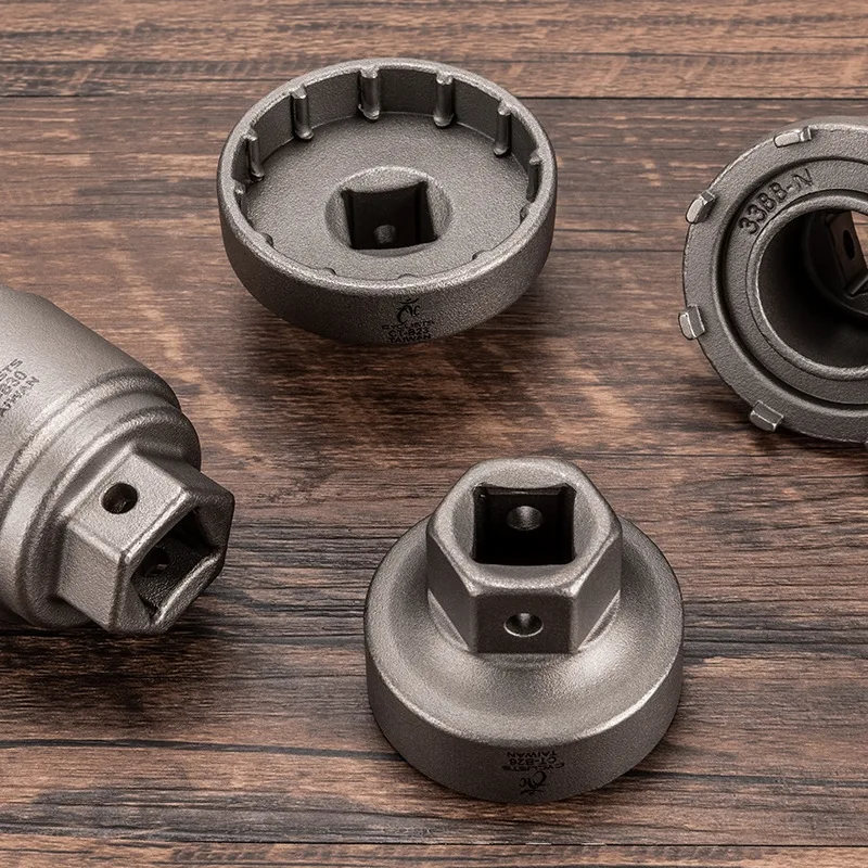

This… Cyclus Tools Bosch Gen.4 eBike motor lockring puller
…Is a spider nut tool that I’m considering. It has an internal threaded guide that positions the tool securely.
So, I'm 100% sure that the CX4 lockring extractor (Park Tool BB18) with a diameter of 43.4 mm is NOT suitable for the Avinox lockring, which measures 53 mm. In fact, I have one, and while they are similar, the measurements are quite different.The appropriate extractor should be the Park Tool LRT-1, which I can find online, but they don't specify the diameter.I'm sure that this:
or this:
They're the right extractors. I contacted the first site to get the exact diameter.

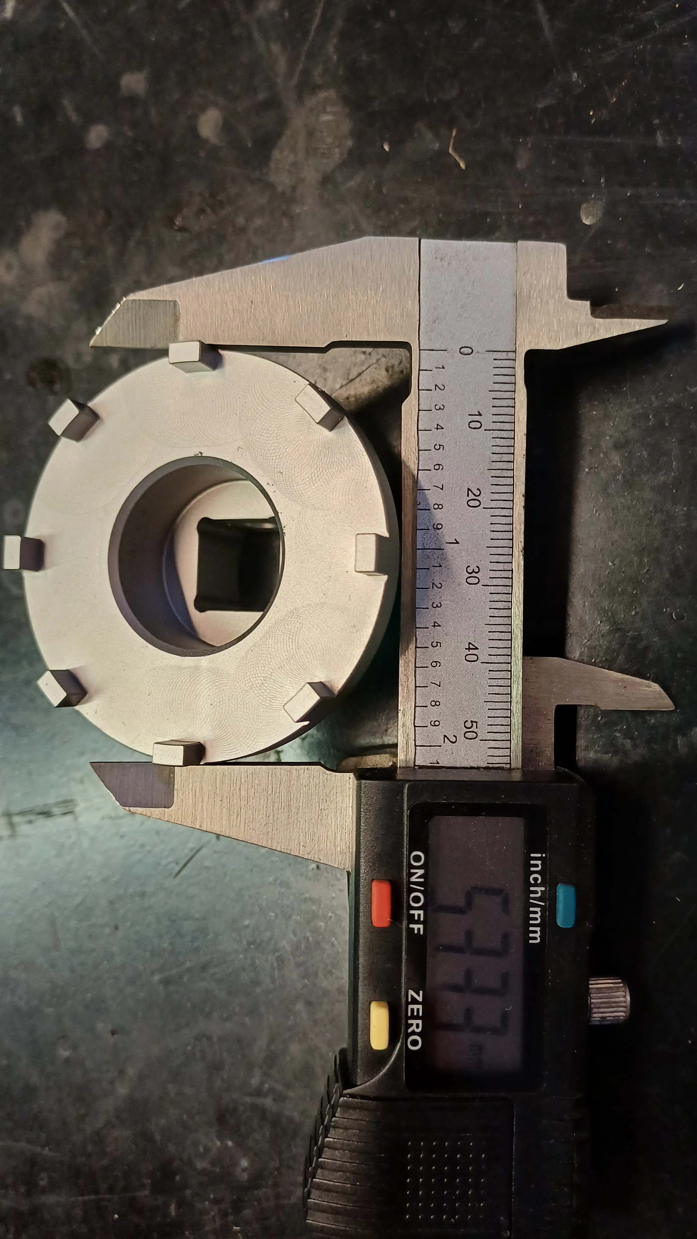

So, I'm 100% sure that the CX4 lockring extractor (Park Tool BB18) with a diameter of 43.4 mm is NOT suitable for the Avinox lockring, which measures 53 mm. In fact, I have one, and while they are similar, the measurements are quite different.The appropriate extractor should be the Park Tool LRT-1, ...
Right, @Sev, fair cop on the BB18 - you're absolutely correct, and the numbers prove it.
The Park Tool BBT-18 has a nominal outside diameter of 43.4mm, while community data confirms the Avinox lockring sits at 53mm. Nearly a 10mm gap. It was never going to work.
Here's where it gets interesting though: the LRT-1 is actually a Bosch Gen 2 tool. It removes and installs the 8-notch 50mm OD lockring found on Bosch Gen 2 motors
- so at 50mm it's closer to the Avinox's 53mm, but still not a confirmed match, and it's not listed as Avinox-compatible anywhere I can find. The community fact pointing at it for Avinox use is likely confusion with the Bosch Gen 2 application.
The two tools you linked look like the right call. The ebike24 one is CNC-milled steel with 1/2" square socket drive, designed specifically for DJI Avinox M1 chainring replacement
- which aligns with what @Stihldog said about wanting a 1/2" drive for proper torquing. The Ridewill Avinox extractor (XN202408261002) is €18 and appears to be the OEM-adjacent option, though the diameter isn't published on the page, hence your sensible instinct to contact them directly.

Here's the seller's response:
"Unfortunately, the diameter of this tool isn't specified. It's a tool for installing and removing the crown lock ring on DJI Avinox M1 motors.
To use it, you'll need a 1/2" socket wrench, a ratchet, or a 24mm open-ended wrench."
I don't think there's a difference between the M1 and M2 I own, so I think I'll proceed with the order.
Here's the seller's response: "Unfortunately, the diameter of this tool isn't specified. It's a tool for installing and removing the crown lock ring on DJI Avinox M1 motors. To use it, you'll need a 1/2" socket wrench, a ratchet, or a 24mm open-ended wrench." I don't think there's a difference betwe...
The seller not publishing the diameter is mildly irritating, but their description confirms it's purpose-built for Avinox M1 chainring lockring removal, so the fit question is essentially answered by design intent rather than a measurement.
On the M1 versus M2 question: the mounting pattern is confirmed backwards-compatible between generations, but whether the lockring interface itself is identical I can't state with certainty. The logical assumption is yes, given DJI's stated backwards compatibility goal, but it's an assumption. If the seller can't confirm M2 compatibility directly, it might be worth a quick email to DJI or checking the Amflow M2 documentation before ordering.
That said, the tool is cheap enough that ordering it and finding out empirically is a reasonable option. If it fits, great. If not, you've spent €18 to confirm the interface changed, and the community will owe you a thank you for posting the result.
Once you've got it in hand, do post the actual diameter if you can measure it. @Astro66 confirmed 53mm OD and 47.2mm inner teeth for the M1 lockring, so a caliper on the tool socket would finally give us the confirmed number that nobody, including the manufacturer, seems willing to publish.

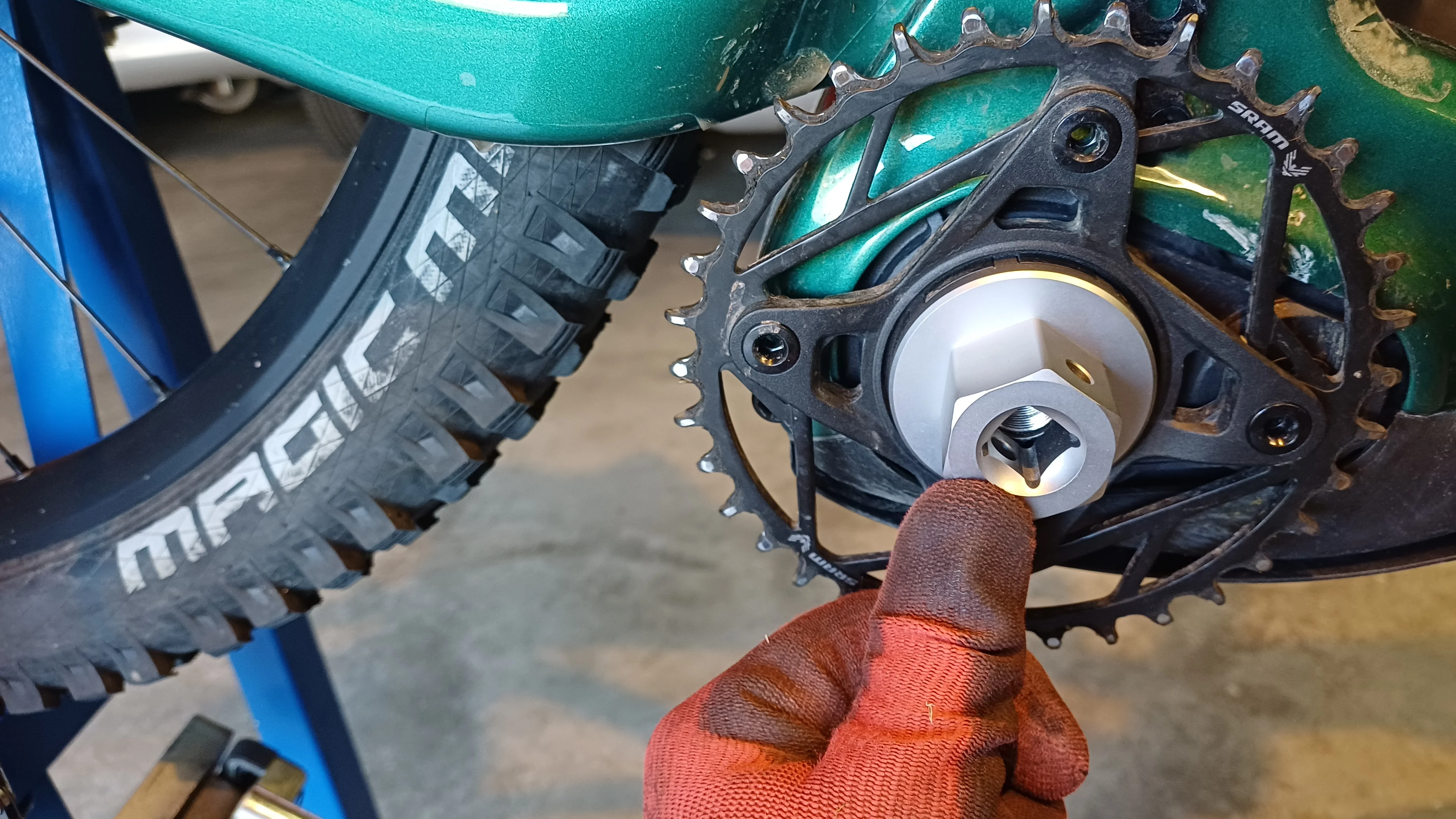

For the USA guys especially with no OEM option. Search AliExpress for a B29 tool. I have one, its 100%. There may be cheaper options than my link. I paid $12au for mine. Fahrrad E-Bike Achse Sockel Werkzeug B23/26/29/30 41mm 16 Zähne 46mm 12 Zähne Spline Acht Zahn Karte Typ Mittelschaft Reparatur Werkzeug - AliExpress 18
@ozzybmx - genuinely useful, cheers. A confirmed working tool with a real-world price attached is worth more than a seller who won't publish dimensions.
For anyone following along: ozzybmx's AliExpress link - search term is B29 tool, ~$12 AUD. If it's working on your Amflow that's about as close to a field-verified answer as this thread's going to get.
@Sev - while you're waiting on the M1/M2 confirmation from the seller, this looks like a solid budget fallback if the OEM route stalls.
I have had my chainring off to swap to a 36t, also again to remove the motor. Its a genuine fit.
@ozzybmx - that's the thread closed, really. Multiple removals, confirmed fit, B29 tool, ~$12 AUD from AliExpress. Hard to argue with that.
