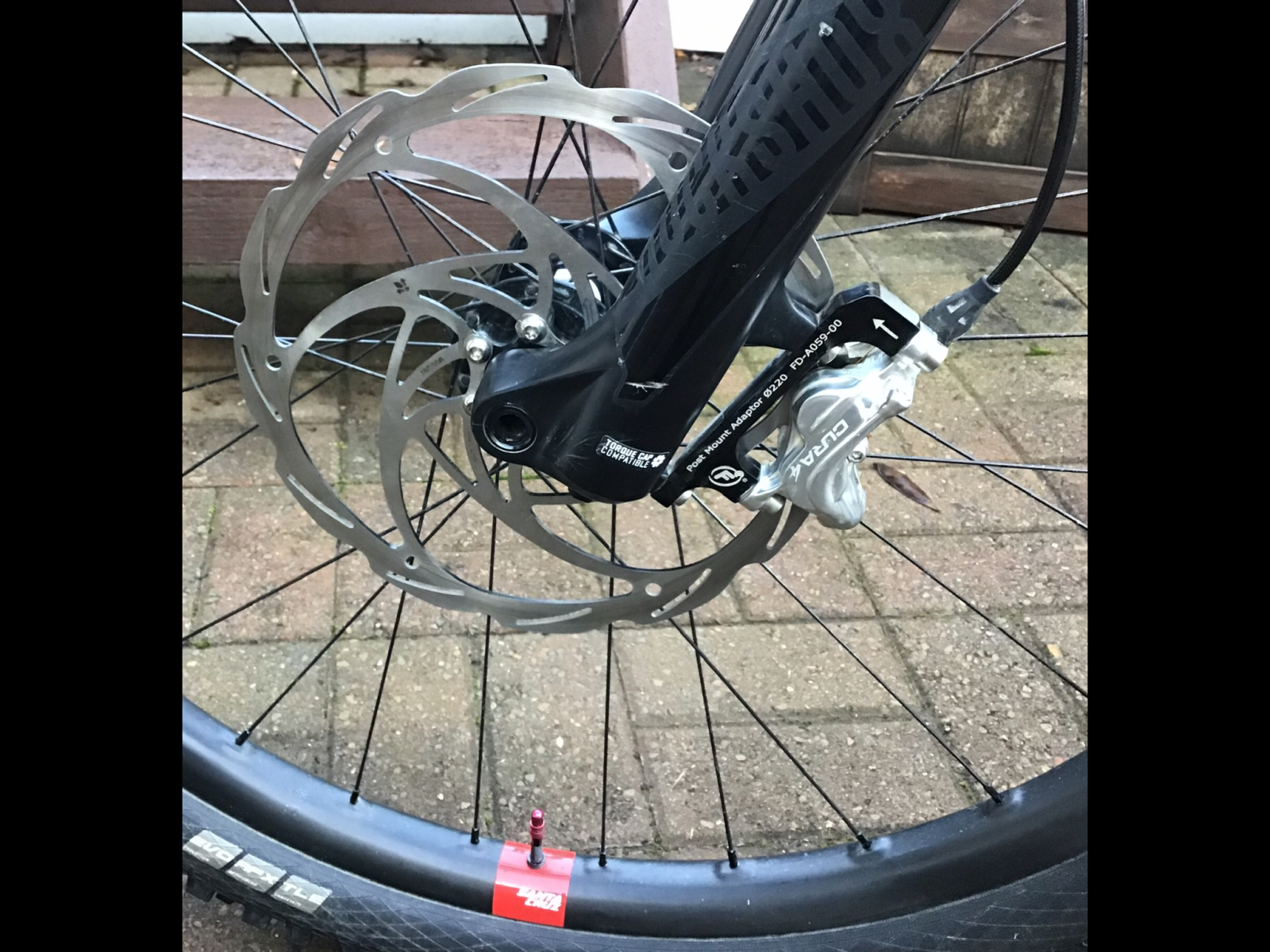

I'm just about to try out the Formula Cura 4 brakes. I've had Curas on my enduro bike (200/200) and love them for a fuss-free life and they're plenty powerful. But I fancy even a bit more power on the eMTB.
Swapped my Shimano Saints for a set of Cura 4s early last year. Best thing I ever did. Easy to set up and they use mineral oil ?Running a 220mm on the front and a 203mm on the back.
Loads of modulation and are way more powerful than the Saints they replaced. Make sure you get the correct bleed kit and follow the bleeding instructions. Caution, these bad boys will throw you over the bars if you are not careful :eek:

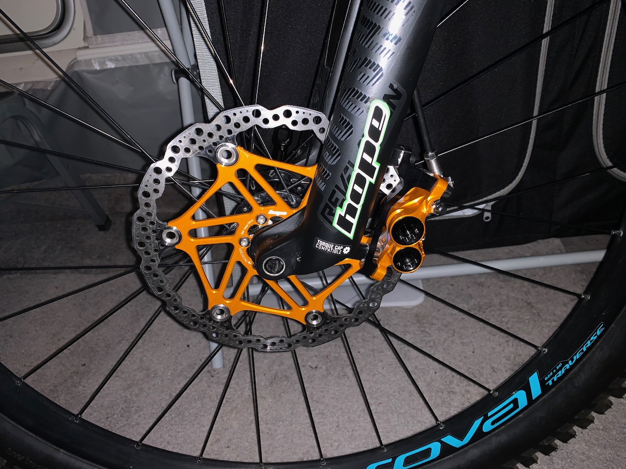

This is what I run and find them powerful enough with good modulation. I’m going to change one day as the levers are getting a lot of play in them at the pivot. Might have to give the RS a go. I prefer the 4 pot up front with the organic pad, and the rear 2 pot with metal pad is plenty enough. I find it a fairly good balance for me. What suits one may not suit another. I see plenty of people around that are way way over bikes for how and where they ride. They would be way better off getting a bike that suits rather than just throwing $’s at the biggest and best of everything.
