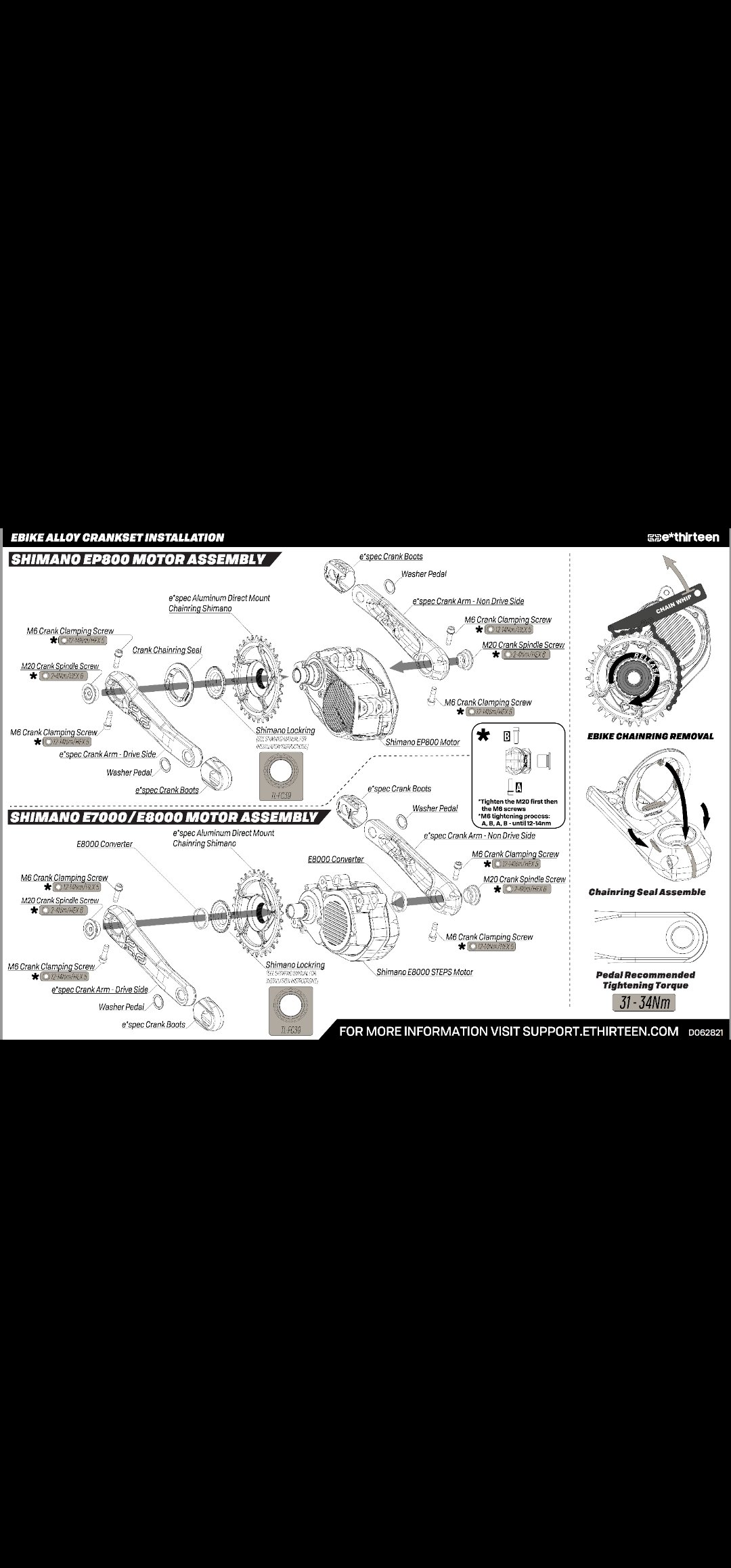

I am talking about the crank chainring seal that is required on E-13 but not Shimano cranks, that rubber seal you pictured doesn’t even come on the later E-13 cranks
Ah, got it. They really should have called that part a spacer. Even dumber, e13 doesn't even mention that part in the TSB. No wonder everyone is dropping these cranks and just going with Shimano.

I have the E8000 motor and believe the cranks are the same for both. You will need a little spacer (E8000 CONVERTER in the schematic) for the E8000 motor. Check out a company called 5Dev. They are making some awesome but pricy after market cranks for emtbs.
