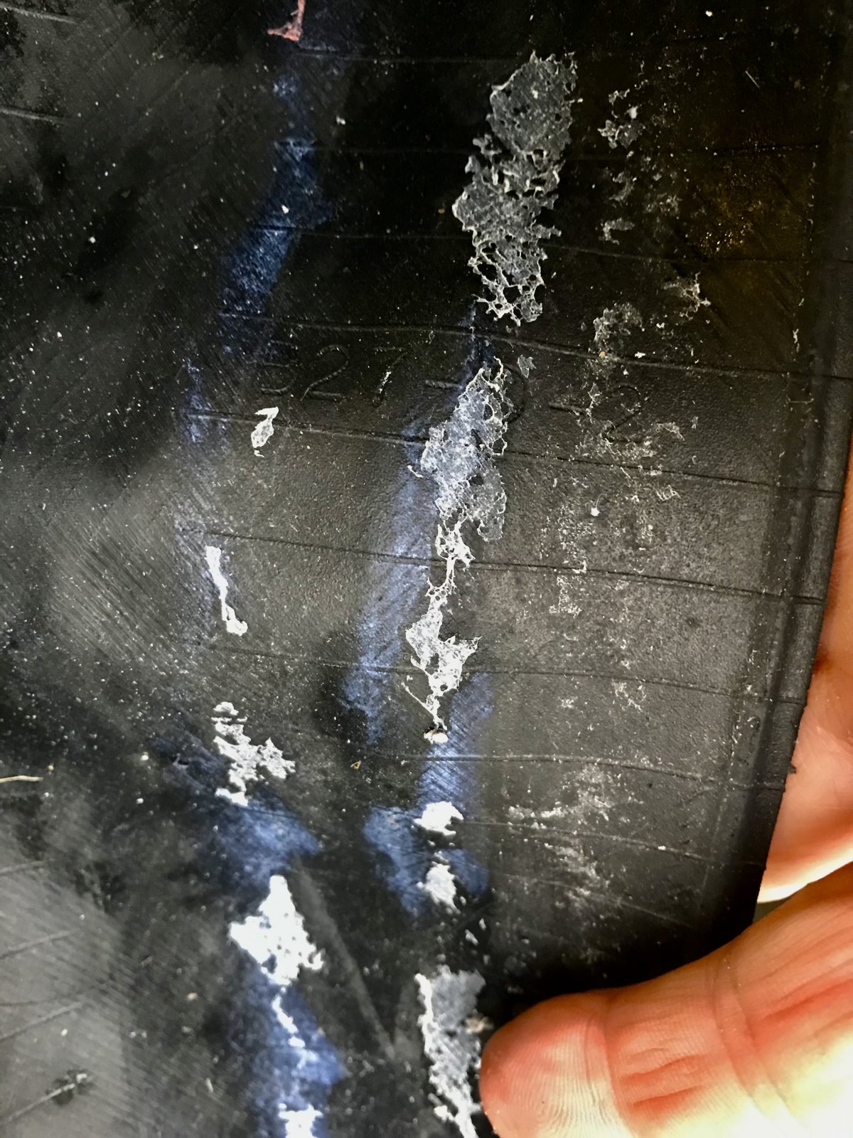

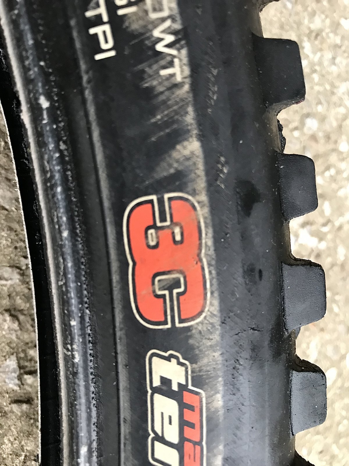

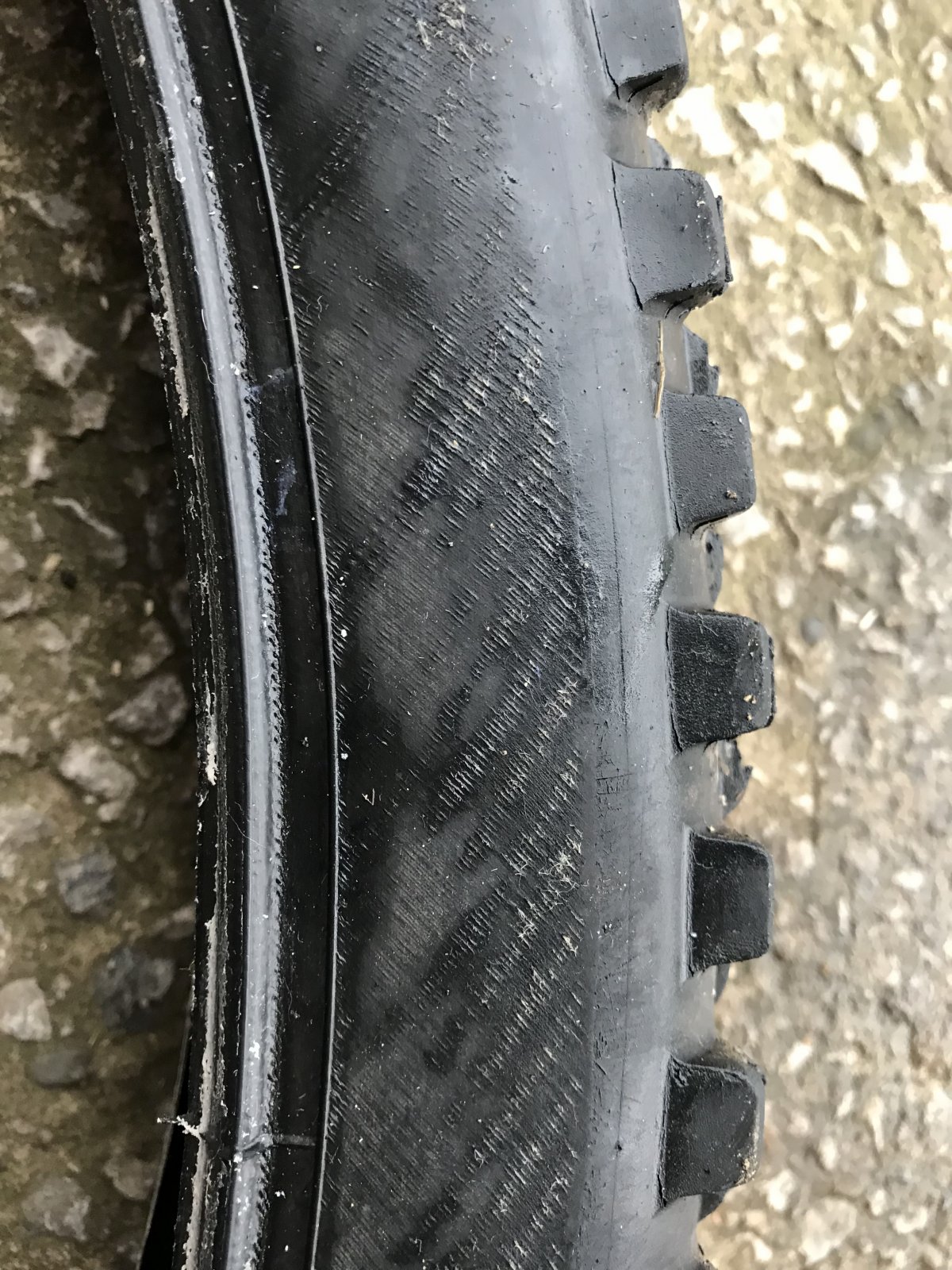

Moving on… I hope it’s OK to ask this one about tyre wall wear here 🥳
What does anyone think is going on with the sidewalls of this MAXXIS DHR II 3C DD MaxTerra 27.5 x 2.5?
And,
Is it fine to continue to use the tyre?
This pattern is on both sides and on most of the circumference. It goes from the rim roughly to level with the top of the insert. The writing on the tyre wall is kinda smeared in places towards the rim and the wear is weirdly less there. There’s evidence of sealant congealing on the inside under areas of most wear on the outside. It looks like maybe sealant has leaked through on the outside, but it hasn’t: that’s just the threads in the wall.
I've had a quick Google and it's been noticed for a few years with several manufacturers, especially OEM MAXXIS, but with no concrete explanation. Can’t find anything here. New to me.
The story:
Rear from my Bullit. OEM Tubeless from new with a CushCore insert. Rim: Alu RaceFace ARC 30mm OEM. The tyre has ridden 1000km on a wide variety of U.K. trails from Wharny through The Peak round Hope/Edale/Win Hill, Forrest reds like Dalby/Gisburn and b-parks like Llandegla red/blacks. It has some life left in the tread. It's almost always run at 25psi (never lower than 23psi, never higher than 30psi). It holds air well, (2 weeks to loose ~4psi). I'm 88kg with pack etc.
I think it's probably nothing to worry about, so fine to continue using it, but thoughts welcome. For example, perhaps this shows my pressure is too low, but I don’t understand how that would expose the sidewall nearer the rim to more rubbing than the part further away, except the wear is where the wall is and further out, that’s tread 😊
That's just the tyre casing threads showing through the outer layer of sidewall rubber. The layer which covers the sidewalls is pretty thin as its not a contact patch. purposely keeping it a thin layer keeps tyre weight down. Old skool Amber Wall tyres don't even have that layer.
And No. Its nothing to worry about.
Thanks 🥳

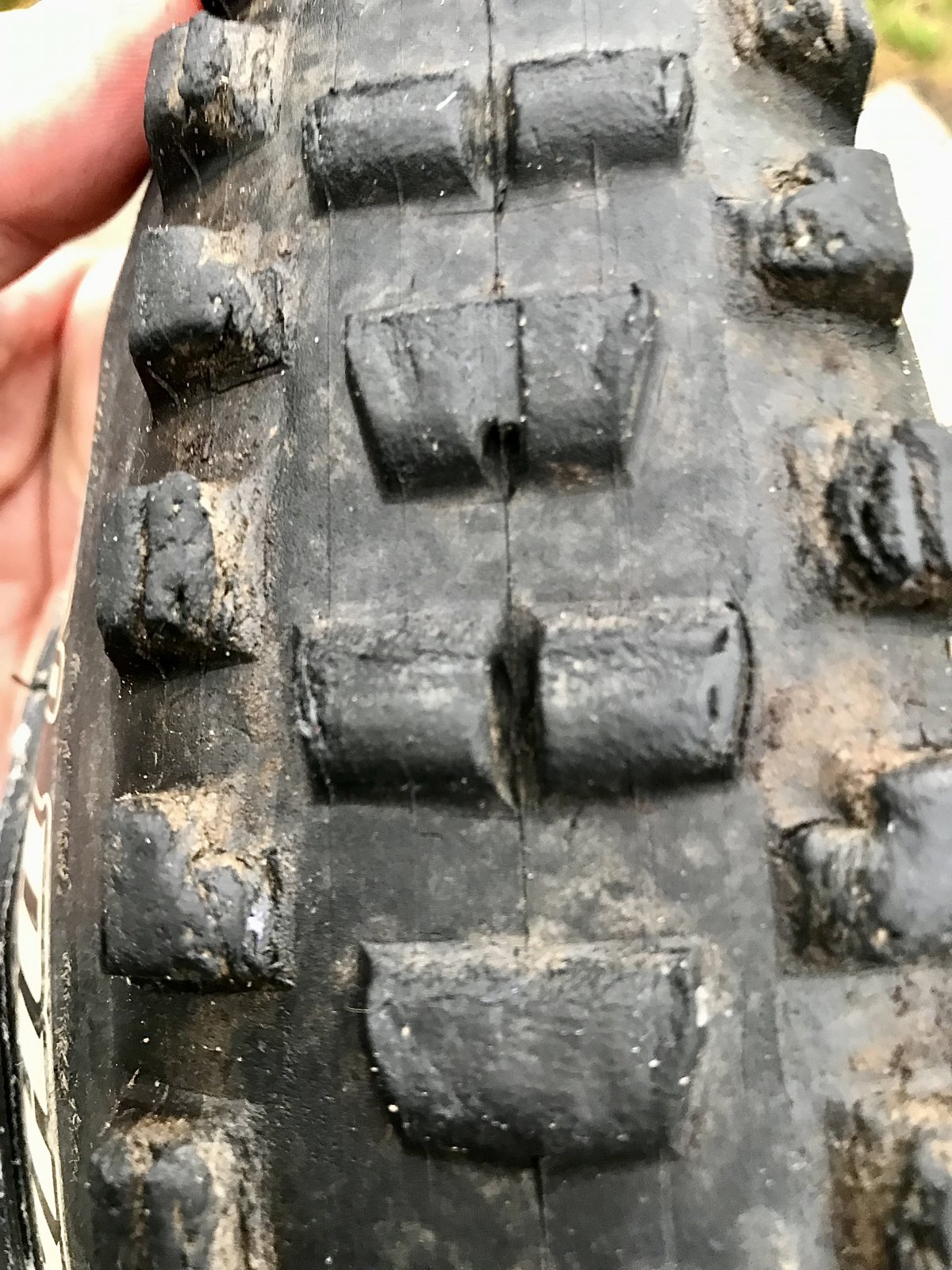

Ahdunno, man. I would have thrown that tire out long ago.
HaHa! That plays on my mind, because I do have it’s replacement tucked away on a shelf ready to go (another DHR🥳).
It will go on soon.
But this one’s improving my skills so much….🤣
Seriously tho’, my experience is that the DHR stays predictable as it wears and that’s a key feature for me that’s not always true of tyres that are predictable when new.
Of course it’s not quite as ‘grippy’ now -- mainly in a straight line. Cornering’s as good as ever still, as 2/3 of each nobble (knobble?) is still there.
