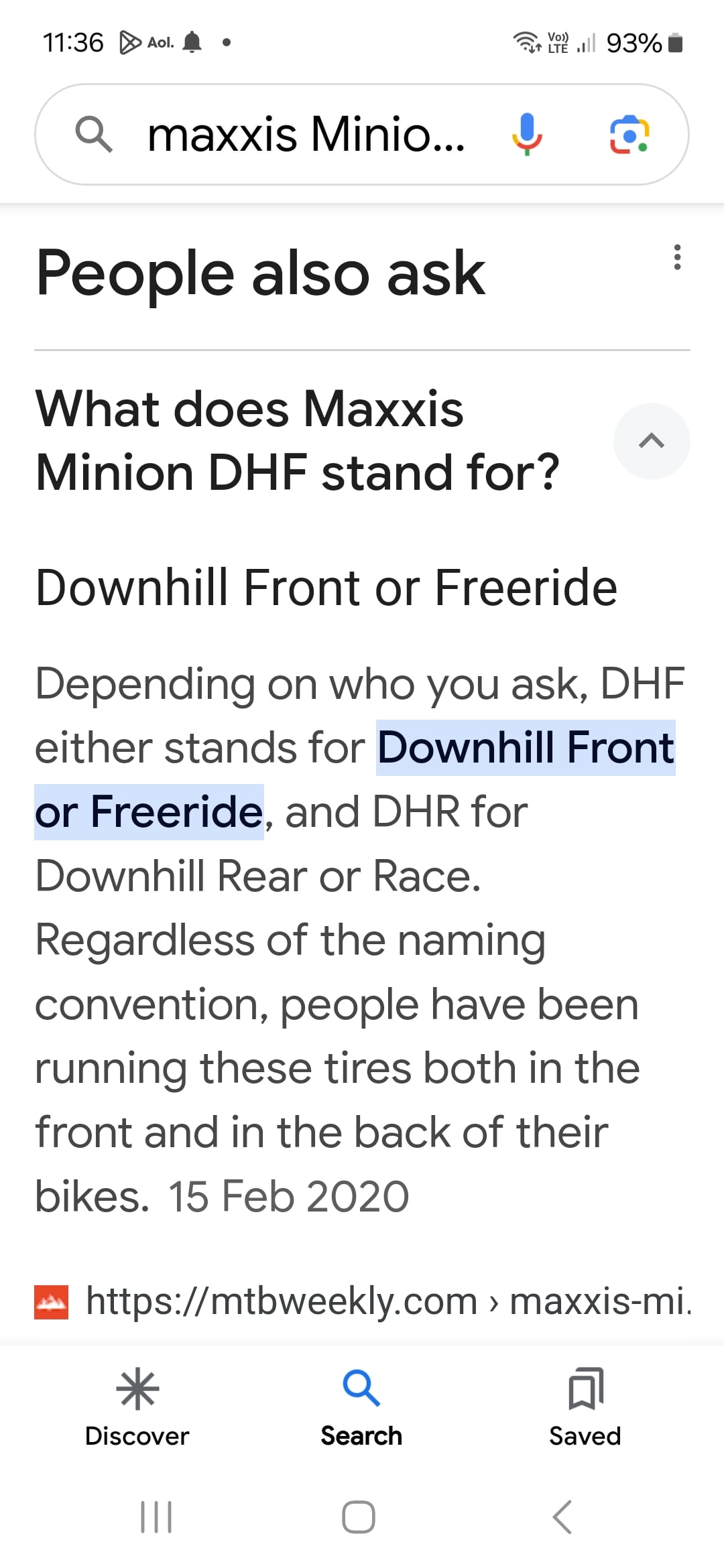

Agree with the Assegai on the front..but forget about the Minnion DHR on the rear and instead go for the DHF dd casing instead ..totally transforms the ride in a good way ..despite what you may think F&R don't signify front and rear ..the f= freeride..
(Sorry to refloat this, but maybe interesting for others)
Not sure about yout statement @The Hodge ....

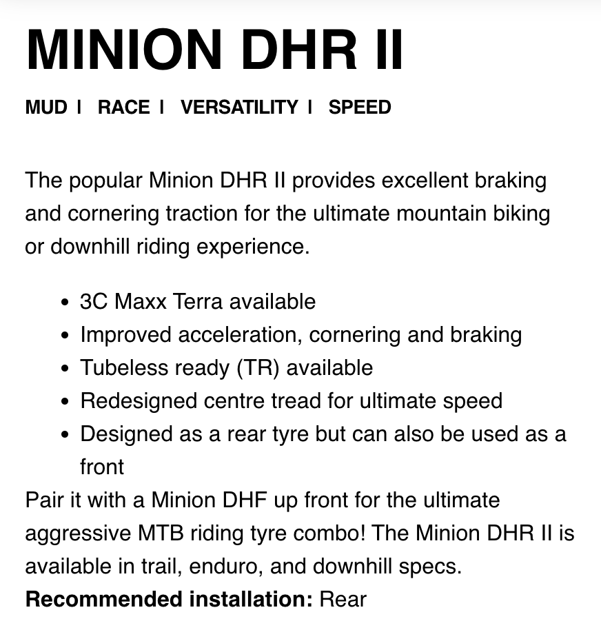

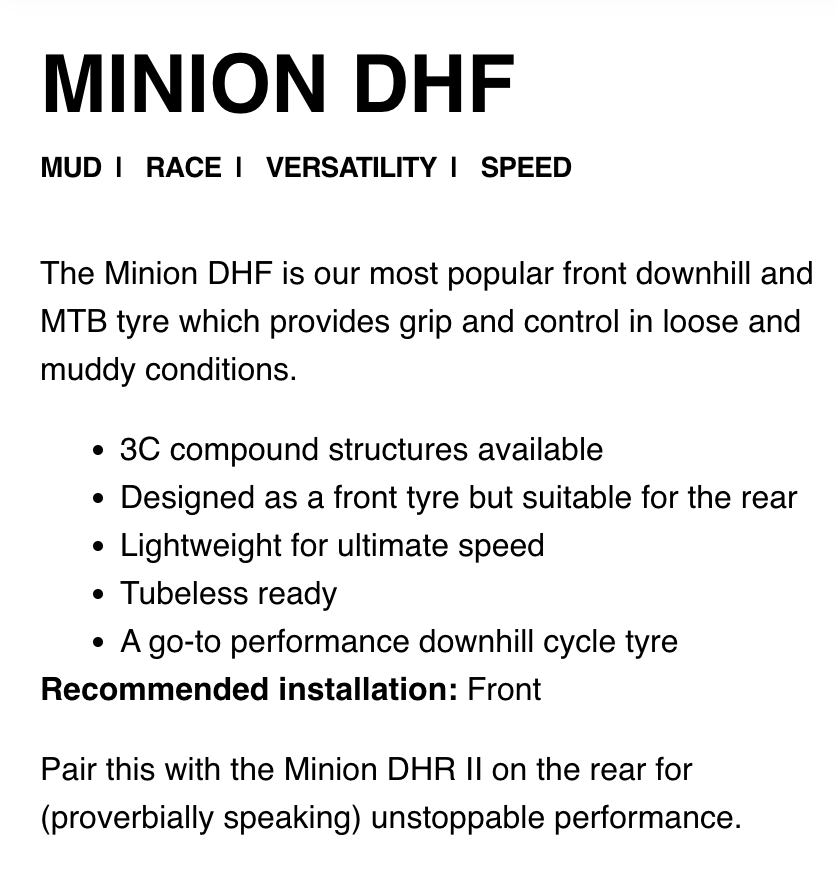

From Maxxis website:

I was checking to see if I could change from Assegai 2.5 front maxxgrip and rear maxxterra to other models/brand and saw your post and checked.
