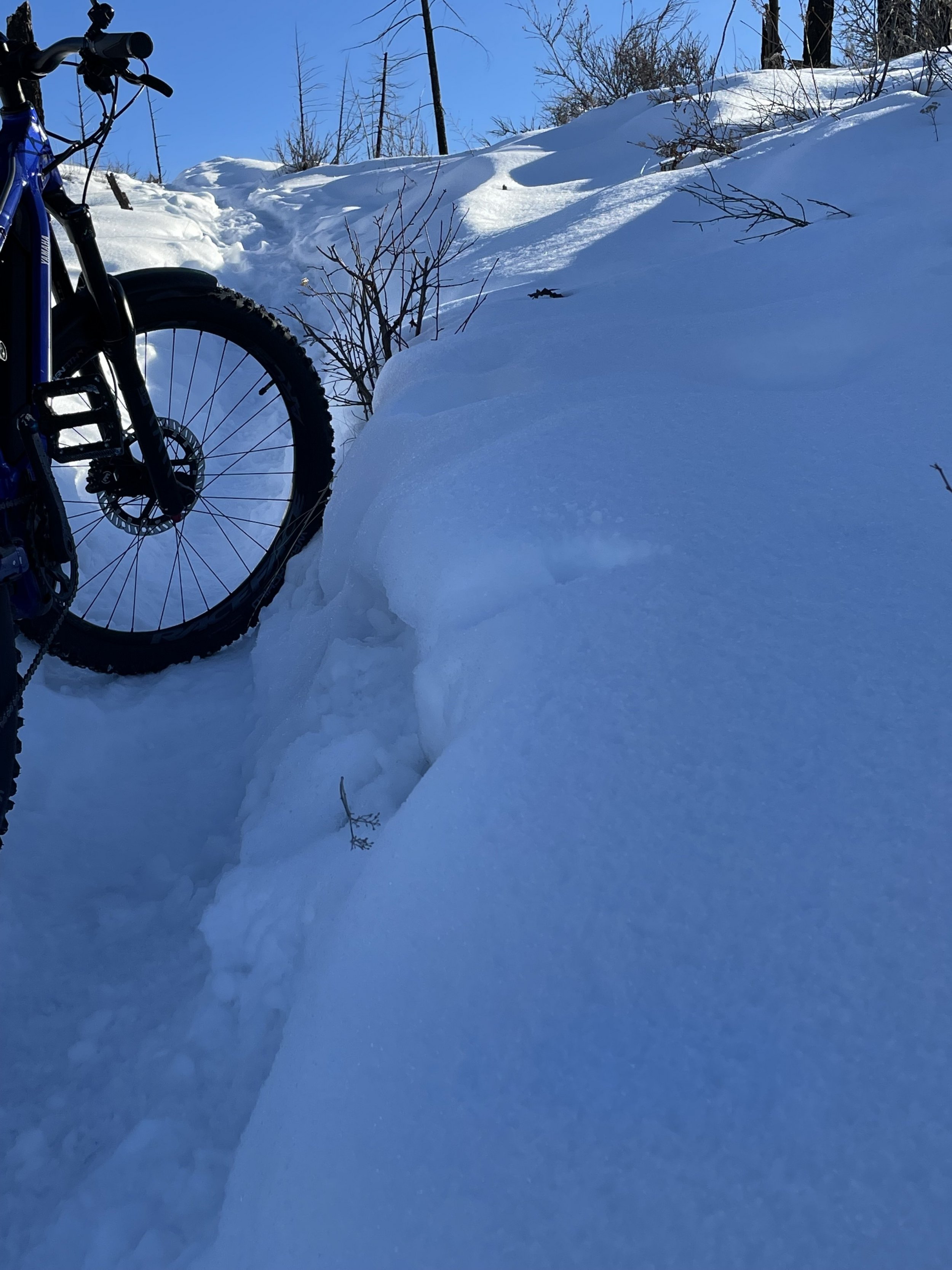

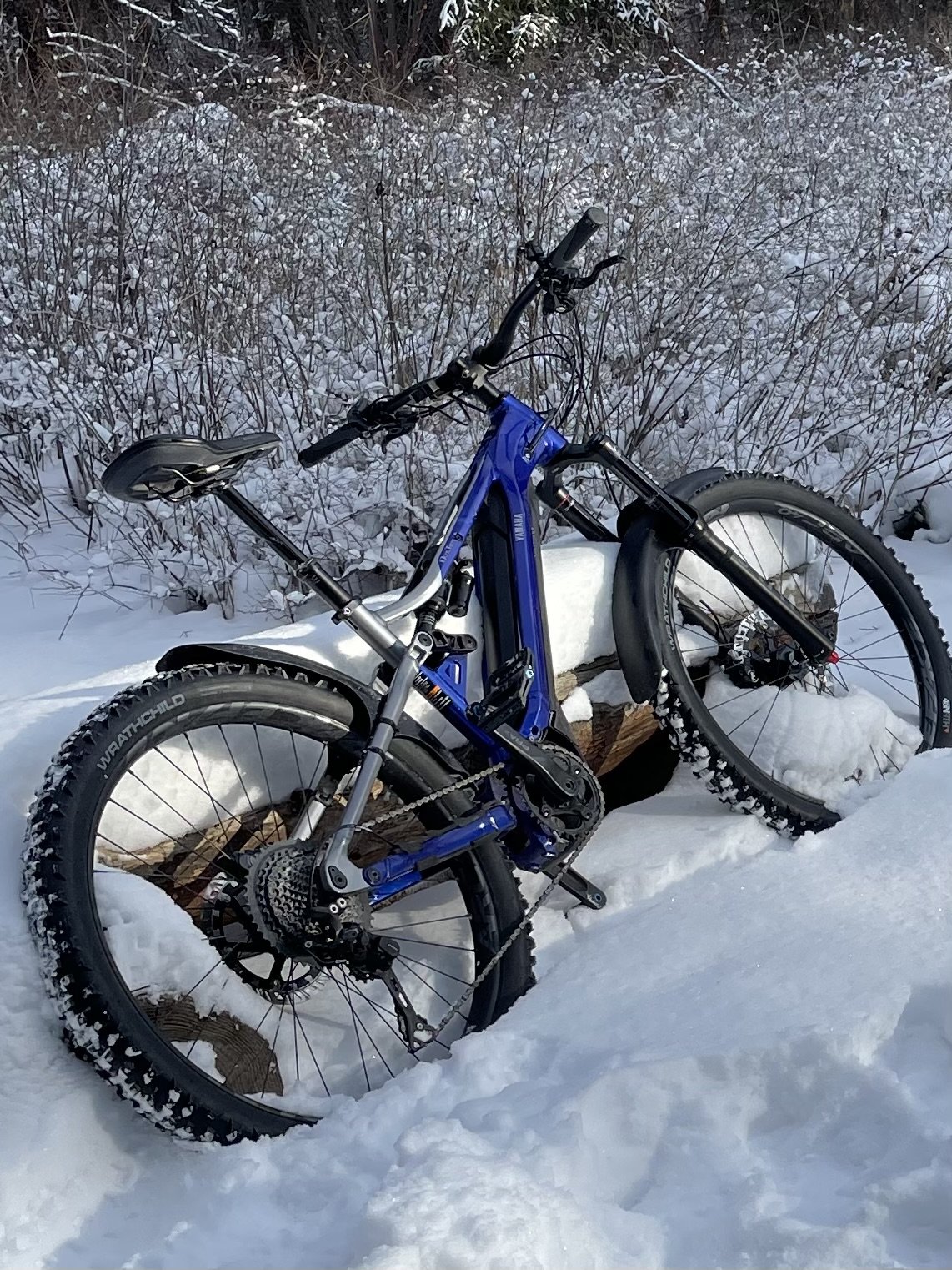

Gee you guys I guess your Winters are a lot different than here... 45NRTH 3.0 Studded Wrathchild's
Winter is the fourth season with snow, ice and studded tires otherwise it's just three seasons with no need to change tires.
