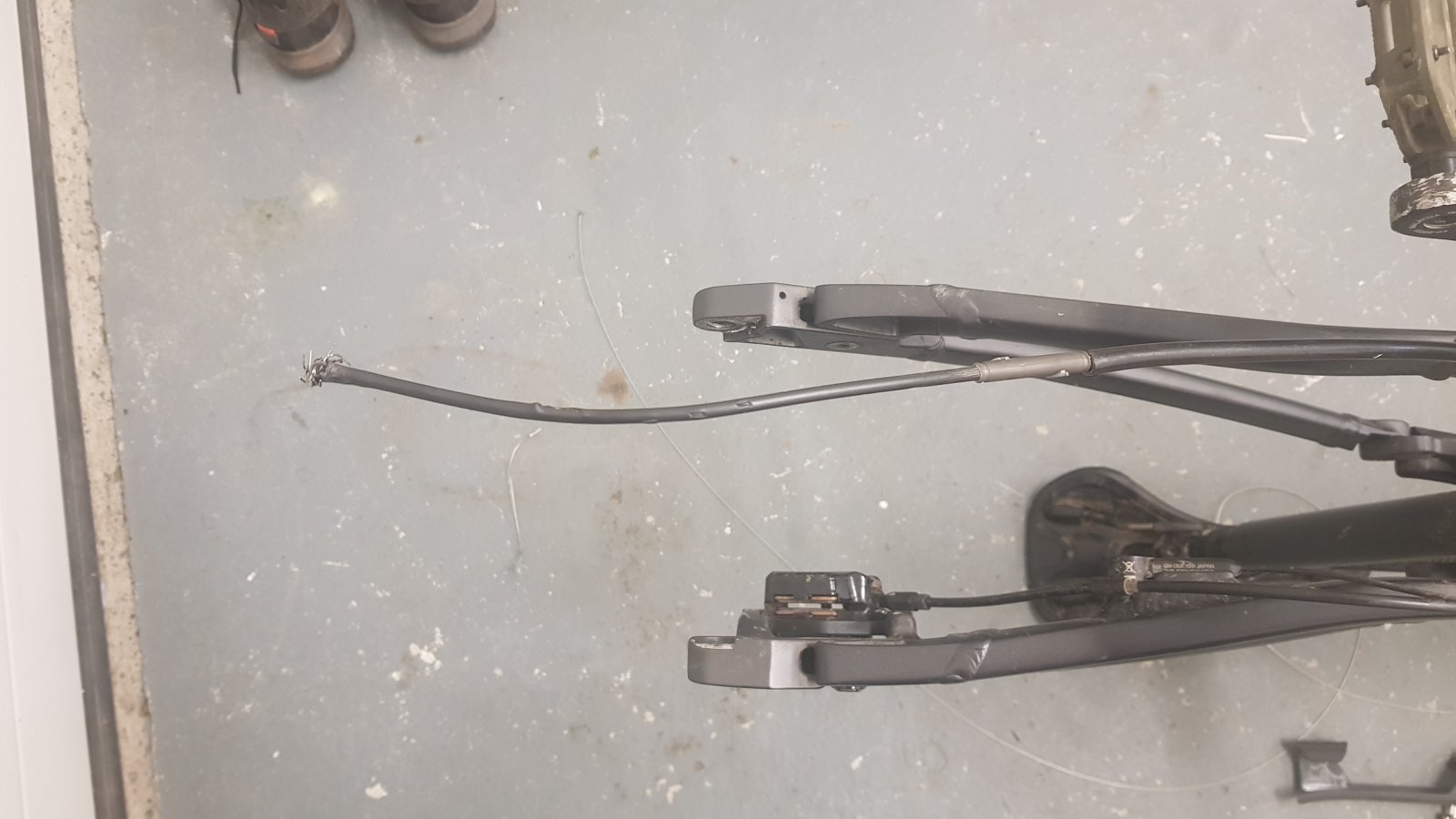

Broke my hanger and ended up wrecking the gear cable on my spectral on.
Is it just a sram 12speed slickline kit i order?
There's a grey canyon branded sleeve as shown in the pic, is this to stop dirt getting down the outer sleeve?. Does the new outer cable feed through the sleeve on the right?
Mates a bike tech and will give me a hand fitting it, just wanted to get the right parts first.
Cheers
The usual problem with gear cable kits is they're still for 2x/3x i.e. you end up with one inner/outer you can't use because it's too short. Better to get a decent length of outer and separate gear inners IMO.
I'm not a Canyon owner - but from your pic it looks like the gear inner/outer sits in a liner in the frame? If so I'd reuse the liner and that sleeve (unless it's damaged).
Get yourself a rockshox reverb stealth barb connector so you can conect old outer to new and pull throw frame.
