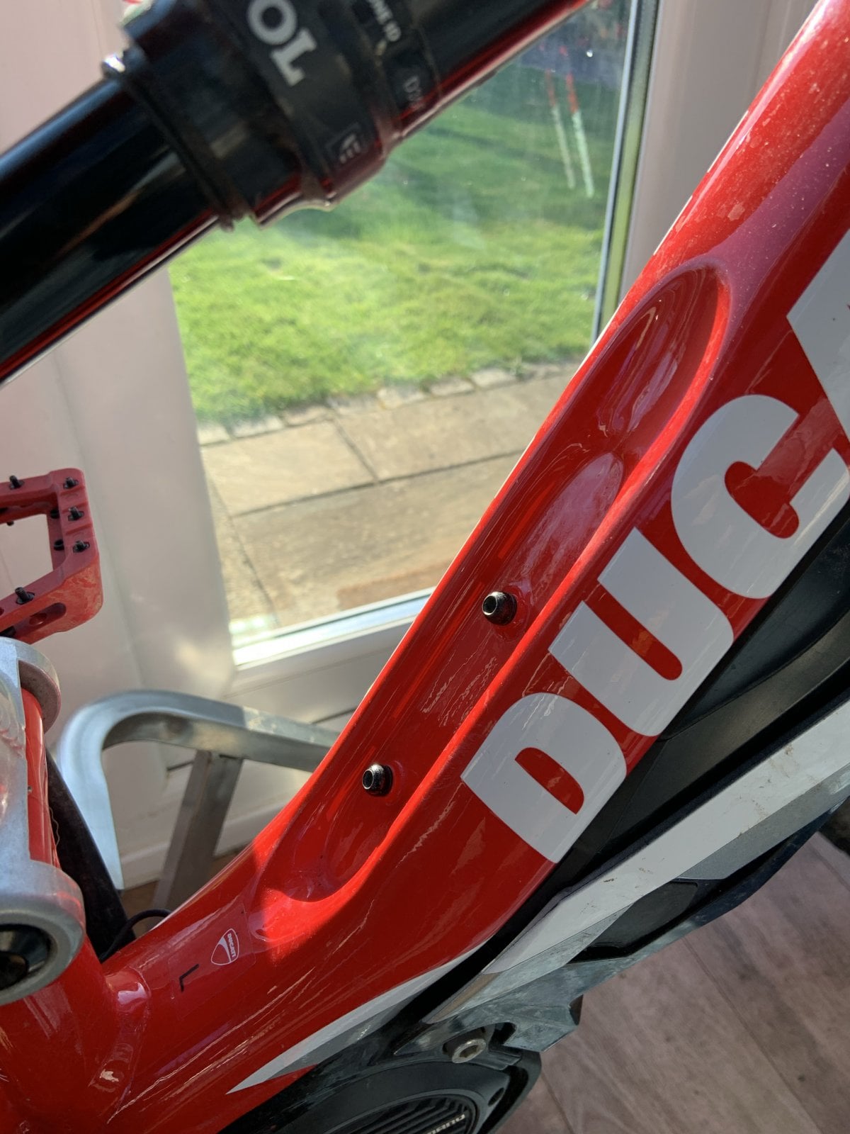

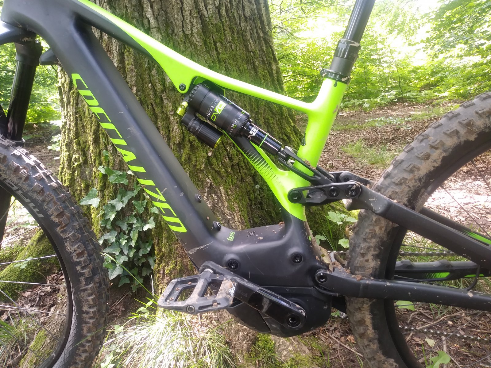

I want mini-toolbox that would fit where bottle goes. I ride with hydration pack on my back... I would like my hard-tools on the frame of the bike... right here:
You can get the water bottles cases, they have a screw off top and you can stick your stuff in. Also, the water bottle cases with a zip round the edge where you can do the same - more accessible but less water/mud proof.
like this :
You can also get a twin bottle cage mount to mount them side by side, so one for tools and one for water.
like this :
Very cool, thanks ZF for the reference!

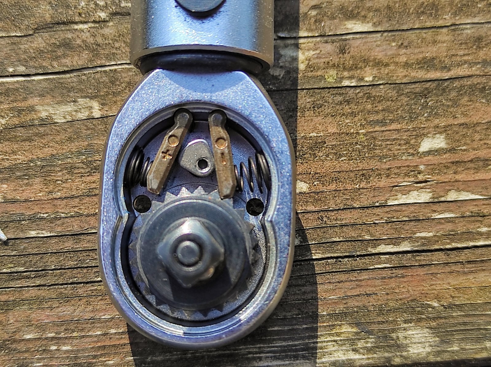

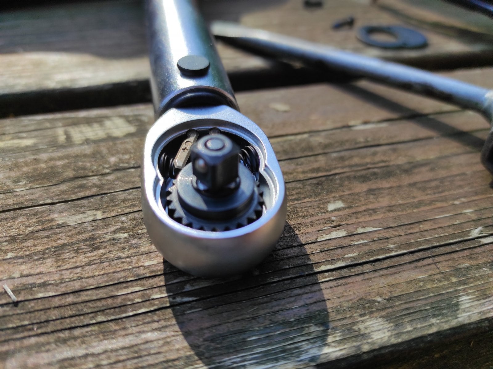

@steve_sordy I can't find the original thread where we said about fixing ratchets .. but as some Muppet just managed to do some double destruction (extreme abuse of equipment) and broke their's I thought I'd take it apart and take a picture for you !
This is the bit where normally one or both pawl's ?!? just end up moving/dropping out of position. You just put them back in again and viola - it works. Takes 2 minutes.
As you can see, mine is now a free turning variety as I sheared the head - that bit shouldn't turn on it's own :) :
(and yes, I know, don't use torque wrenches to undo things .. this one was already relegated to none torque wrench use .. and now it's a little hammer - a little hammer that should click when you've boshed things with the correct force ! :-) )

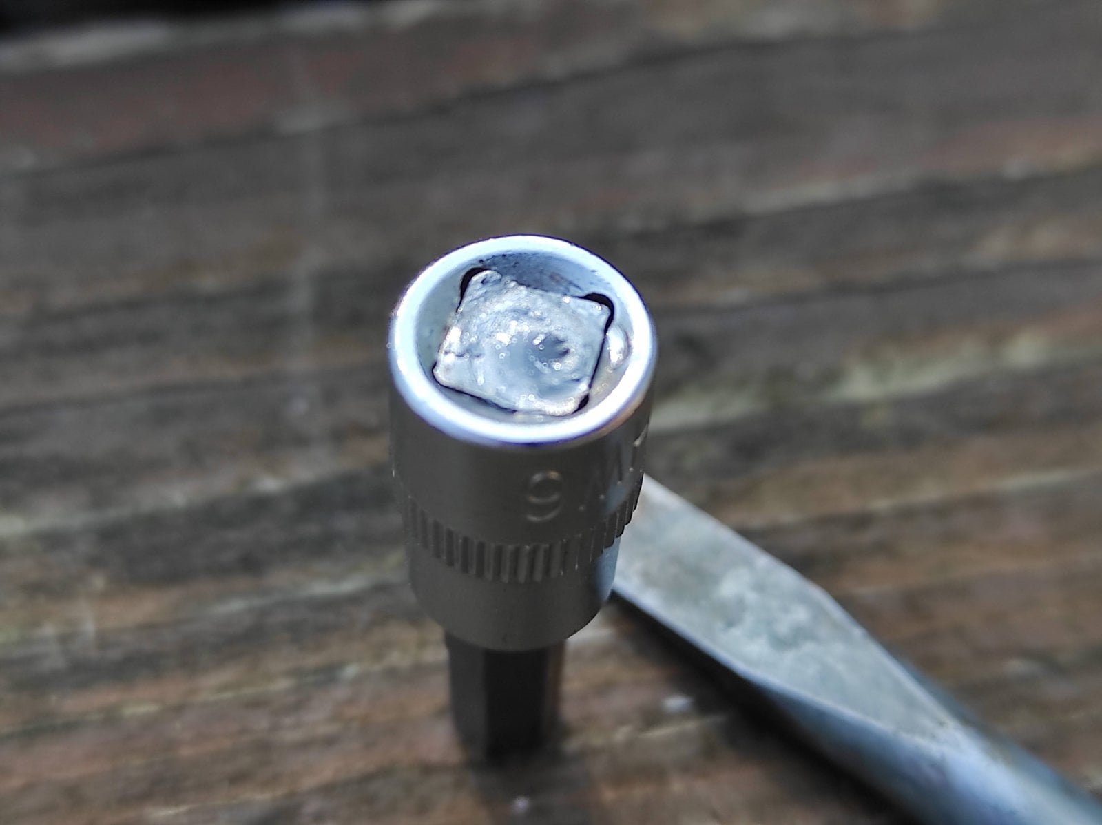

Amazingly, I was on a roll and then sheared an adaptor ... :)
Thanks @Zimmerframe that might even motivate me to have a go at fixing my broken one. (Broken by trying to torque a left hand thread). It shouldn't be too bad as it wasn't a big thread - so no great force was used.
