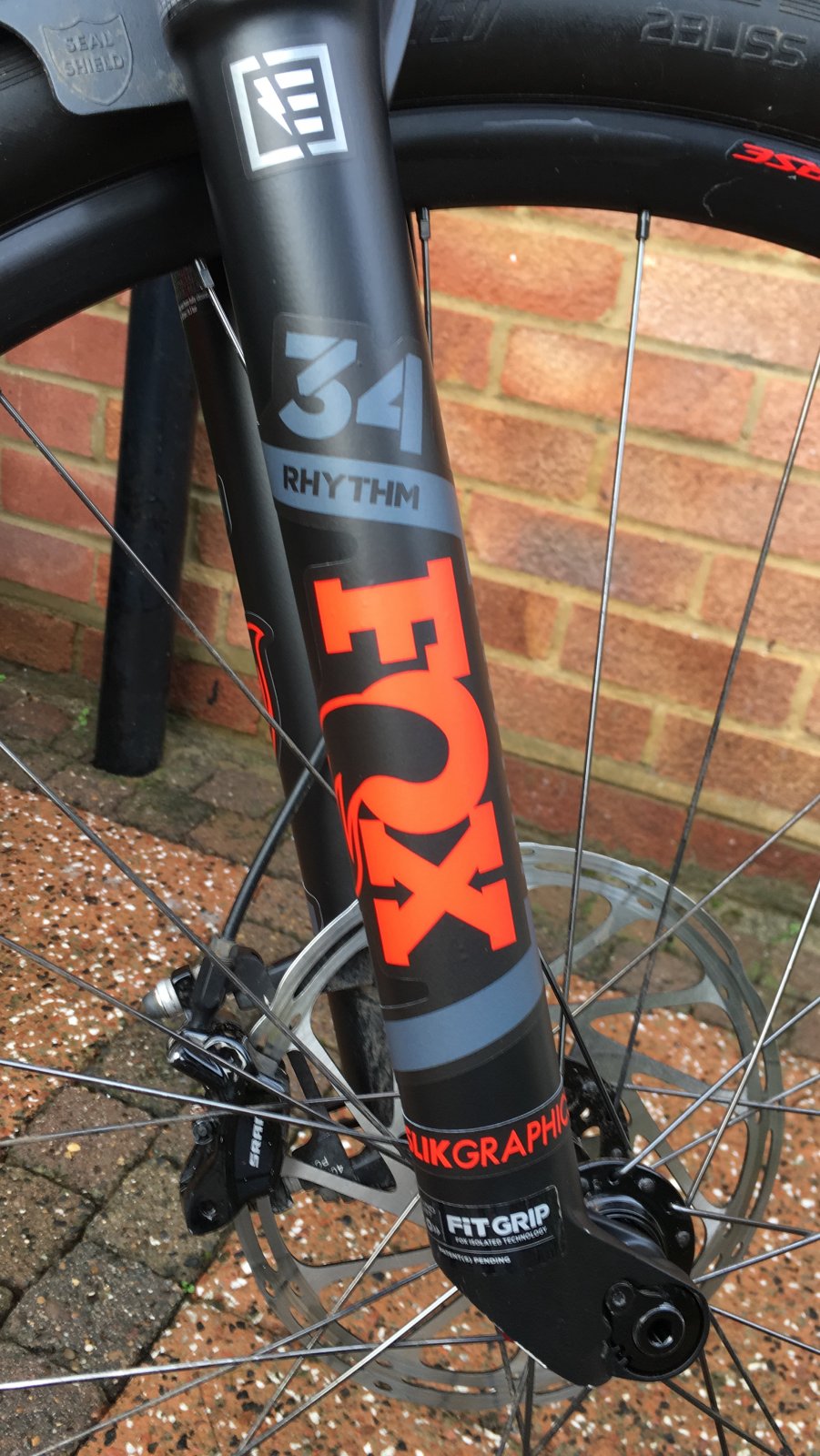

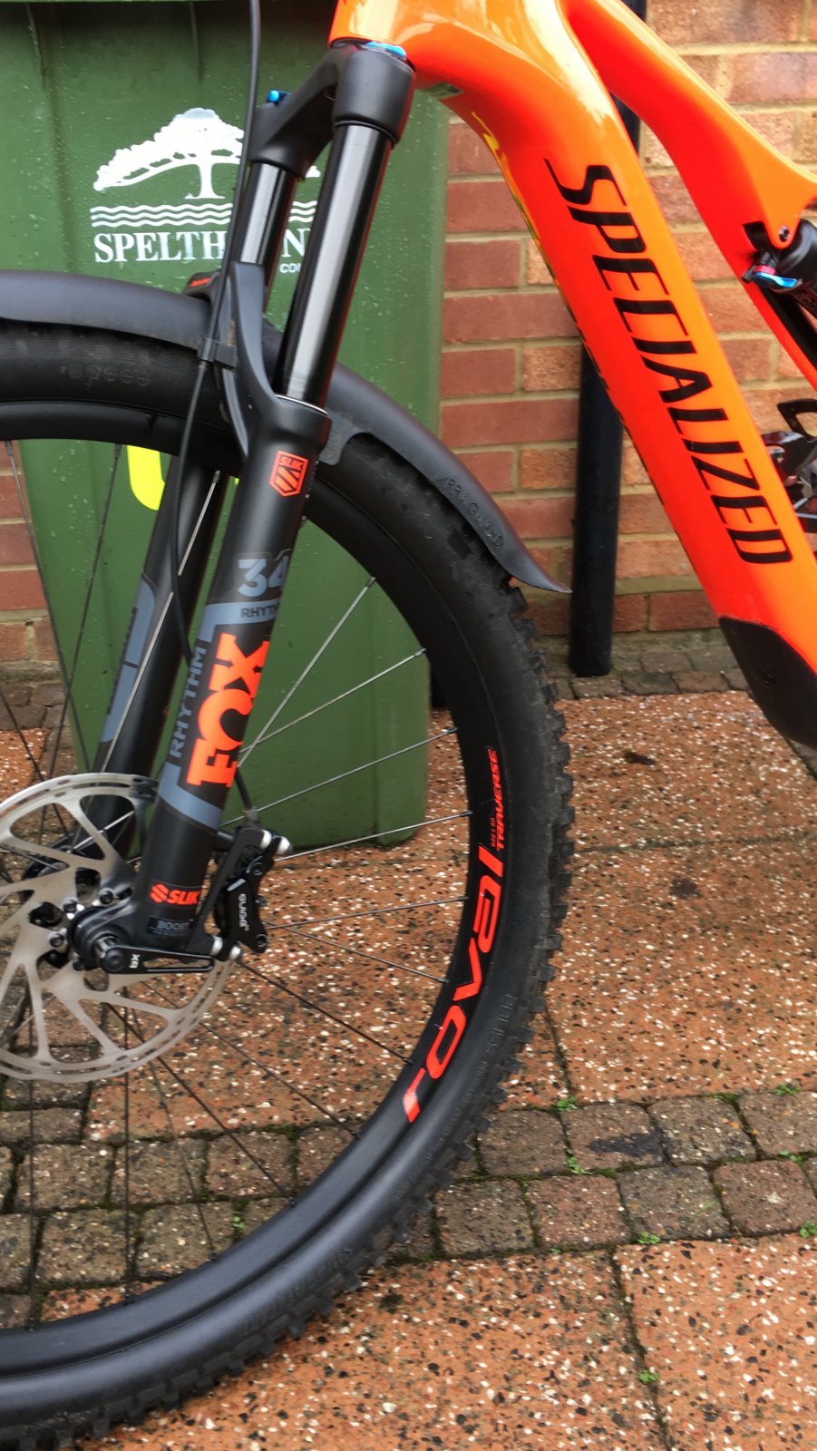

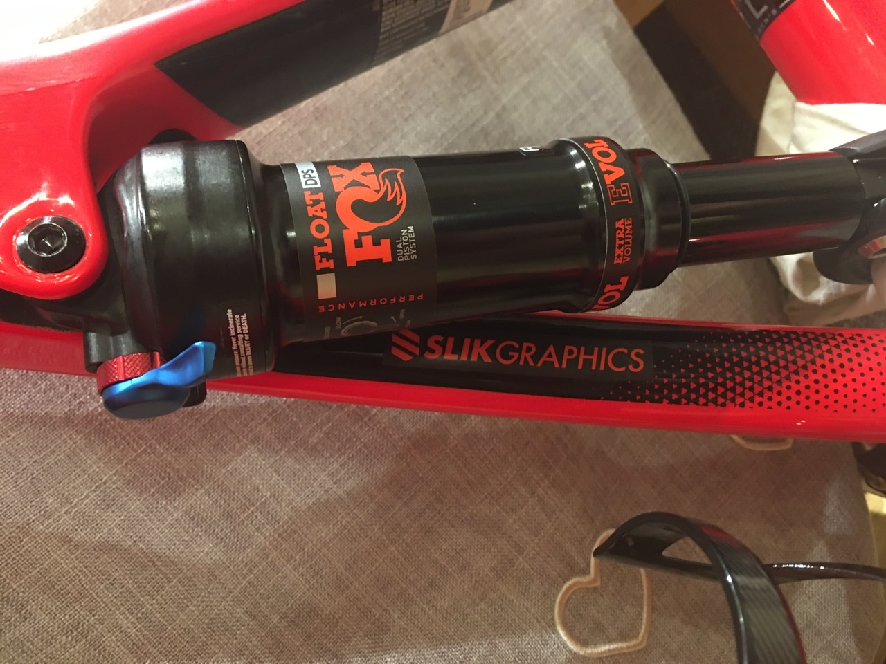

Custom fork graphics. Rocket Red
Looks great!
Did you use a custom color code, or is that one of Slik's standard colors?
It’s a custom colour. I emailed them as I was going to order Neon Red, but they told me just to put Specialized Rocked Red and they would match it. The match is very good, see picture post install. The other colour is the standard Dark Grey.

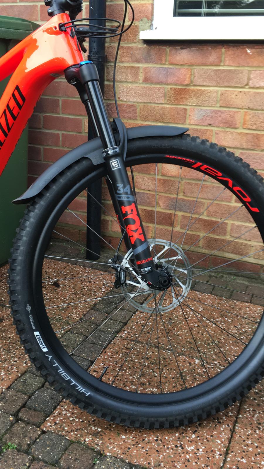

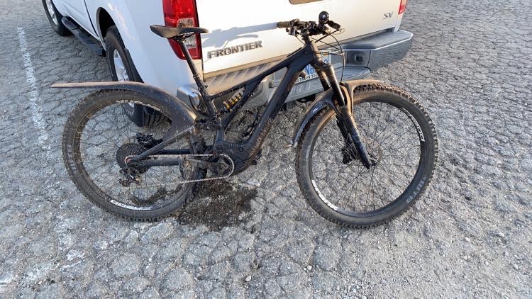

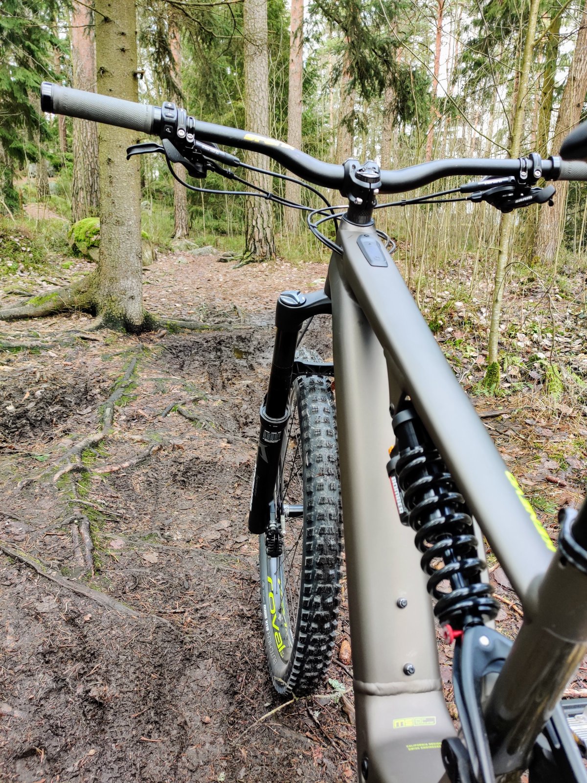

First ride on a new DT-Swiss 350 Hybrid Arc40 27.5/29 wheelset, Cushcore with a rear 27.5 x 3.0 Purgatory Grid and a front 29 x 3.0 Bontrager SE4.
Forgot to mention in last post that fork is now a Lyrik Ultimate 160 mm...
So far, love the mullet and the 3.0 tires better than my 2.8’s.

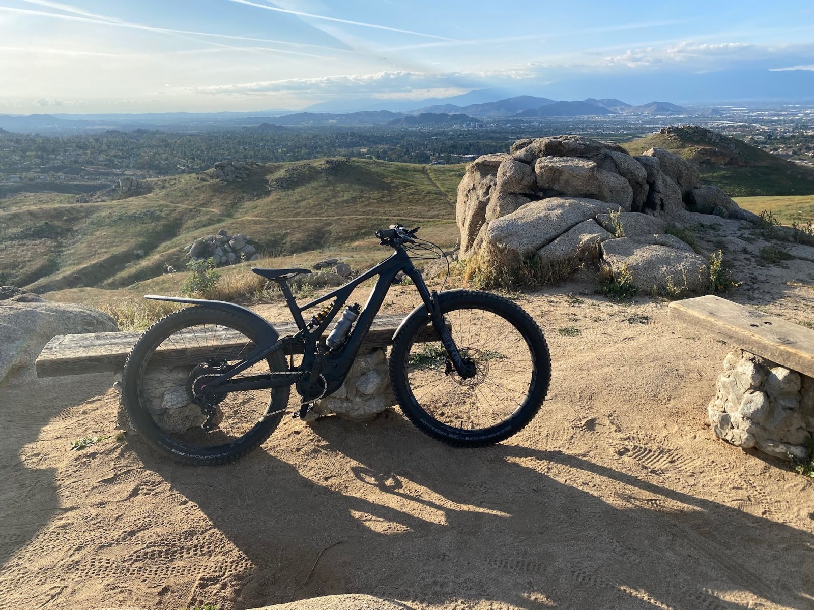

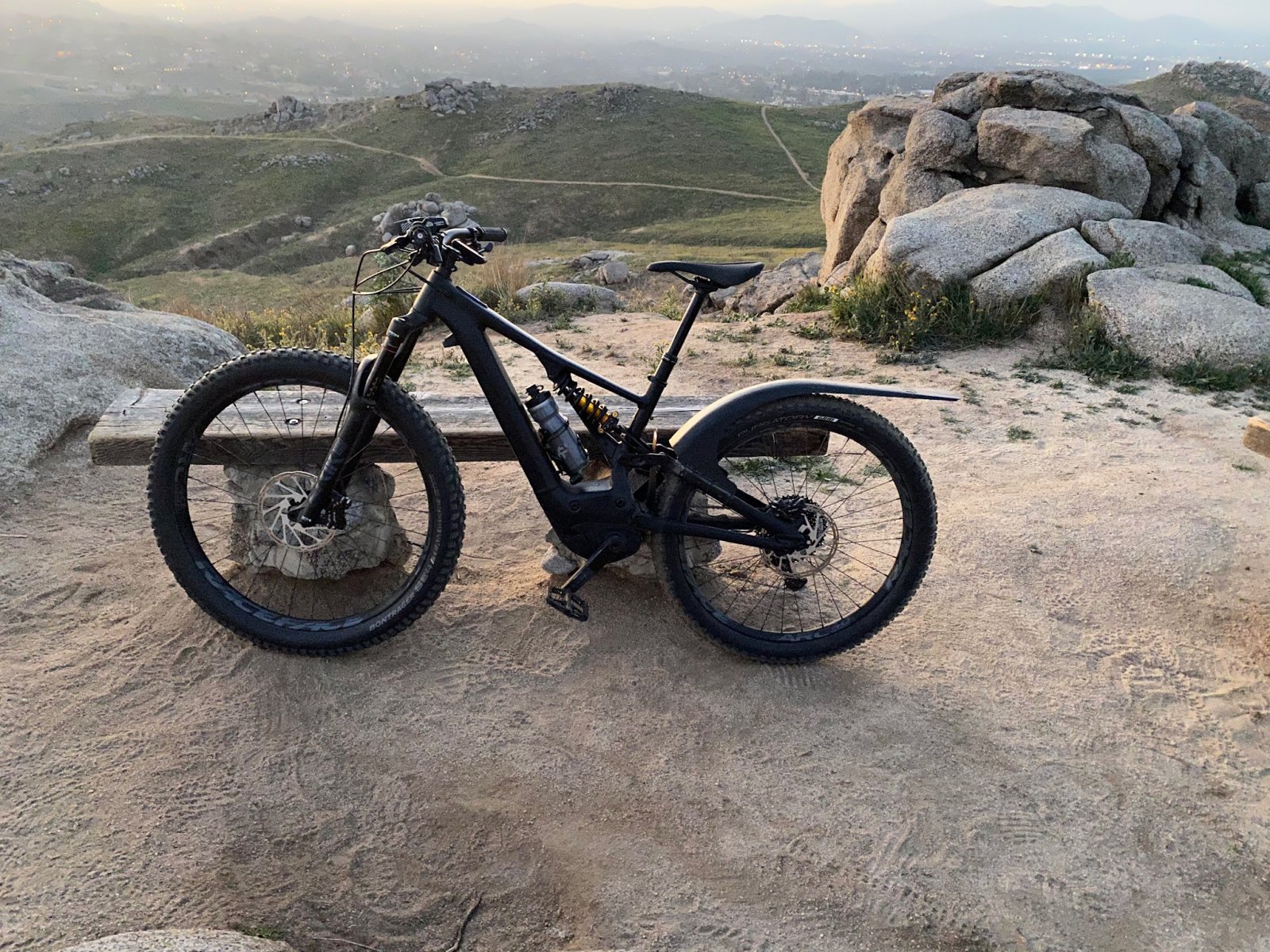

Upgraded RE brakes to Code RSC, put on a smaller Mudhugger rear fender, switched the Front fender to a Mudhugger FRX quick release (barely fits with a 29 x 3.0 tire).

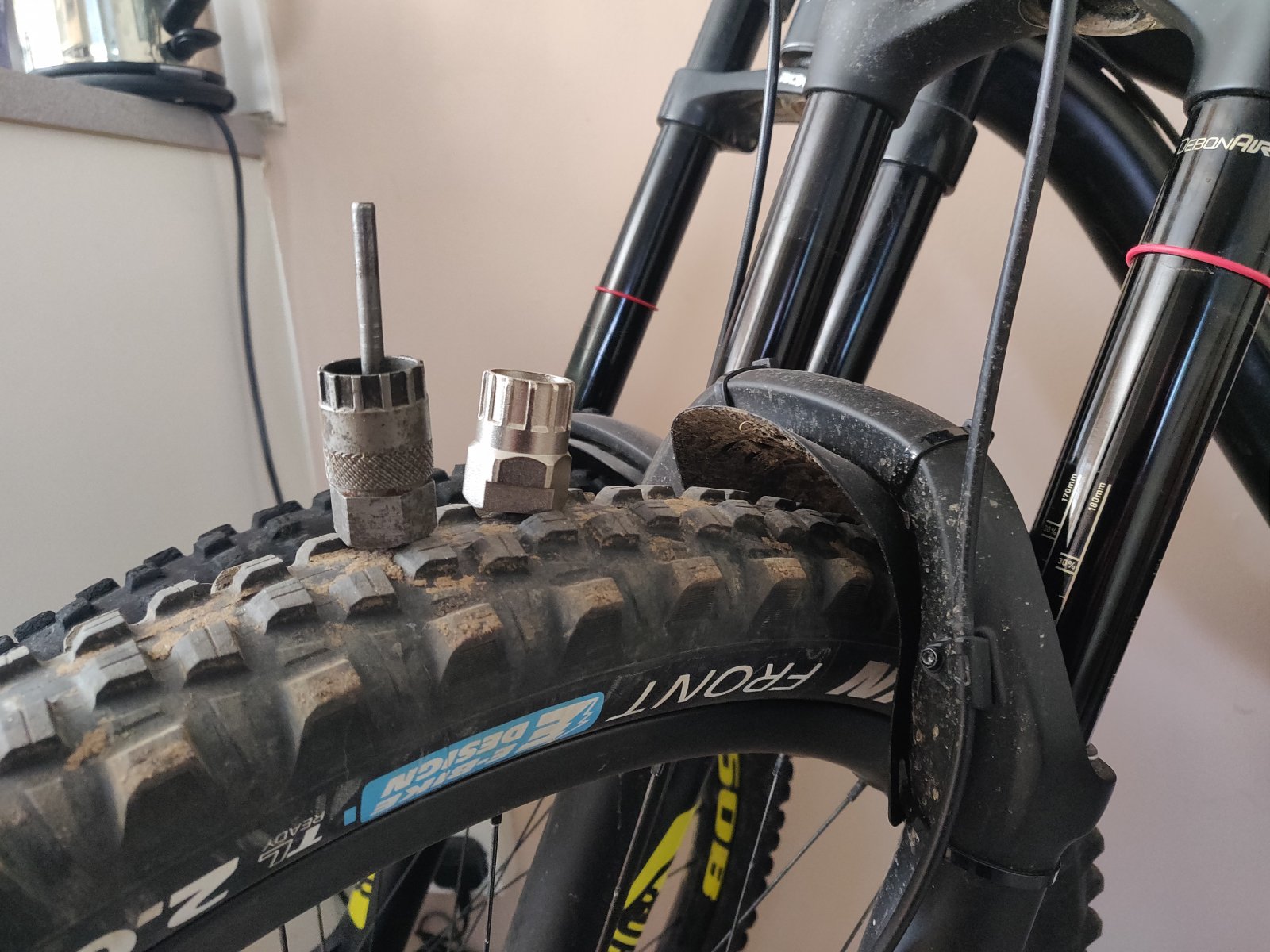

Bought a cheap cassette tool from eBay to check the tokens in the lyriks.1 as standard, added another. My main cassette tool has a prong so is no use for the forks.

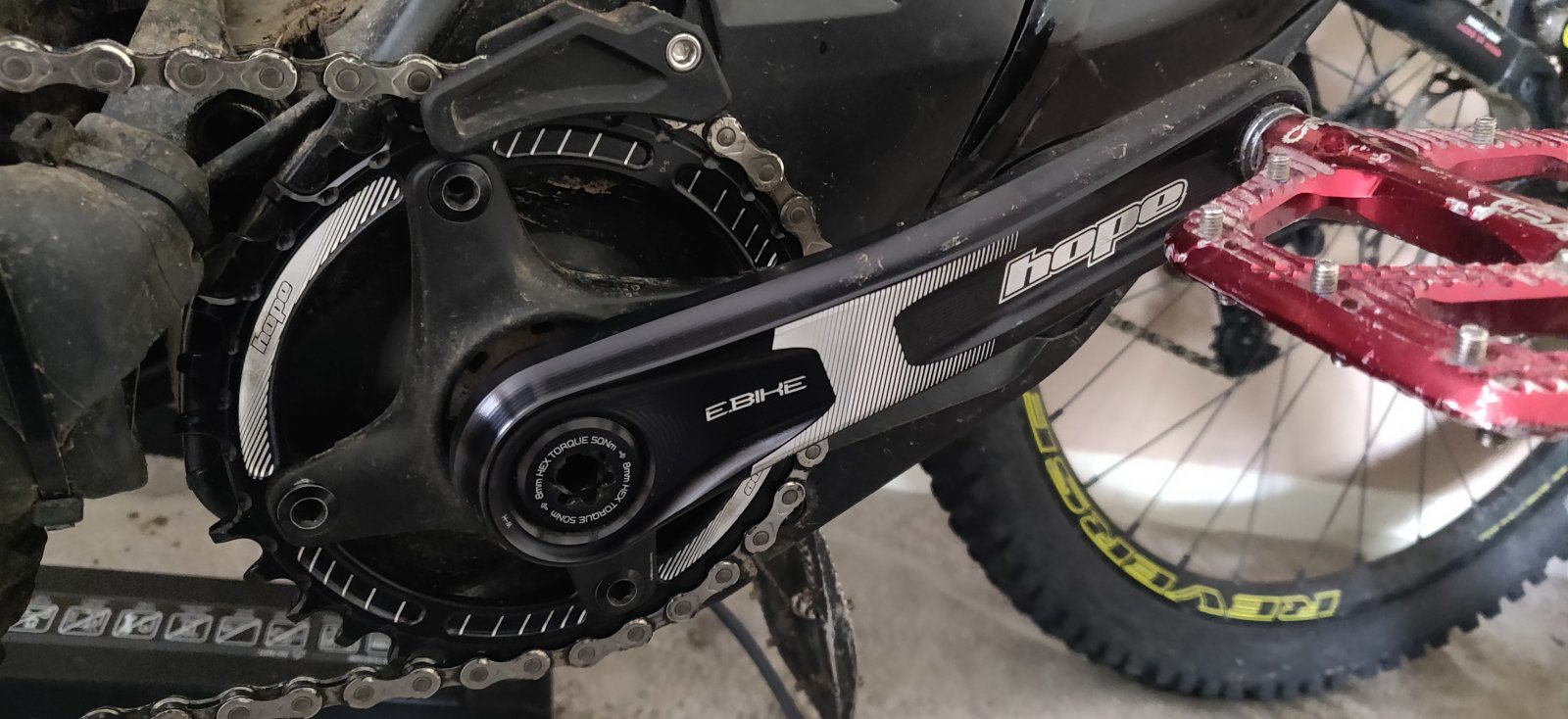

This week's unessesary spend due to not actually being able to ride is hope cranks at 155mm with a 34 to replace the stock 32. I did have some Miranda at 150mm but they were just a stopgap so see if shorter suited me. Q factor seems about 10mm wider each side.

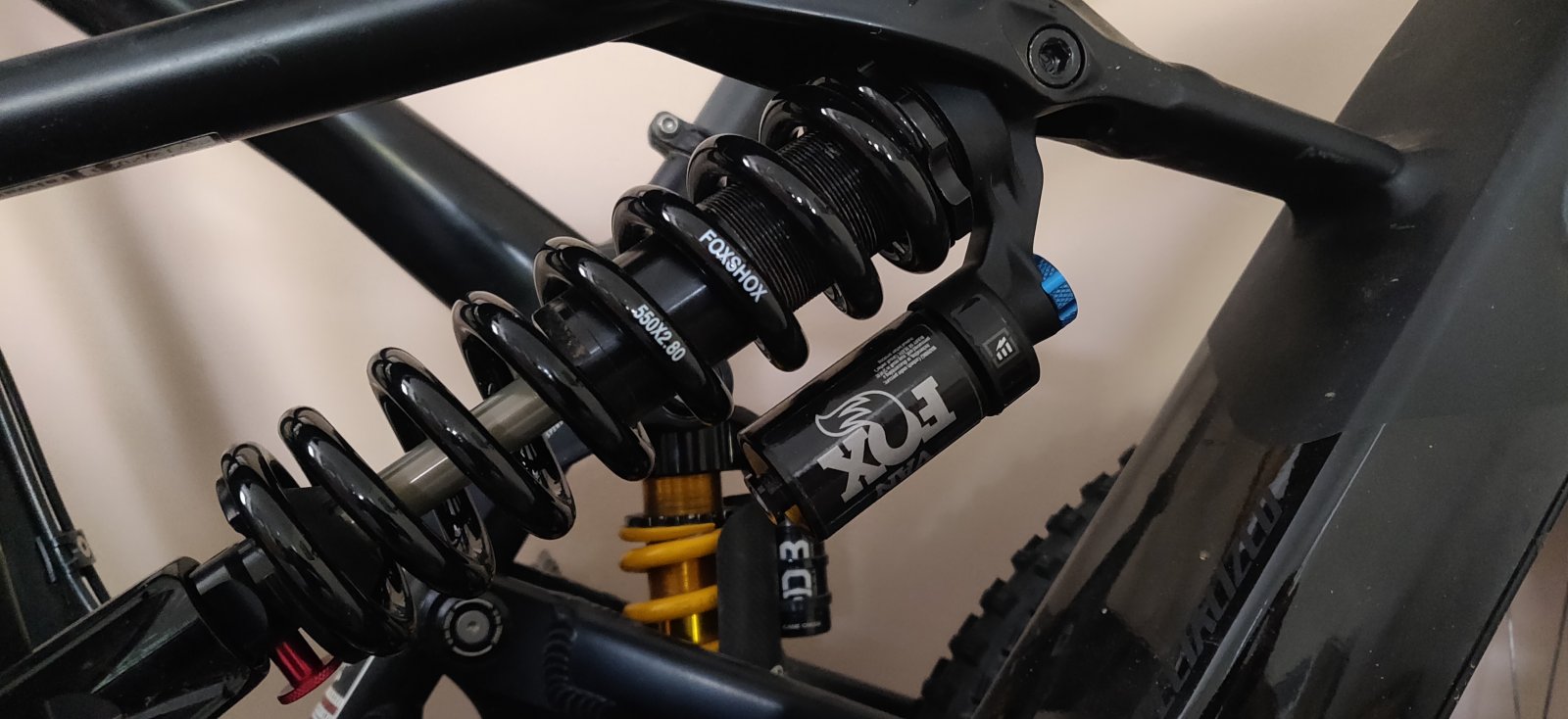

Also a fox spring 550x2.8 I ordered from Germany as even with postage was cheaper than the UK for just the spring alone. Replaced the 650 it came with which only sagged at most 20%. Should be ideal once I get down to 95kg.
Removal was a nighmare needing ratchet straps whilst bouncing on the bike to tighten them enough to be able to remove the retainer. Removal of the straps involved jacking and lowering my van onto the spring to compress it enough to loosen the straps. Lucky the new one was a bit shorter and fitted with no hassle!
