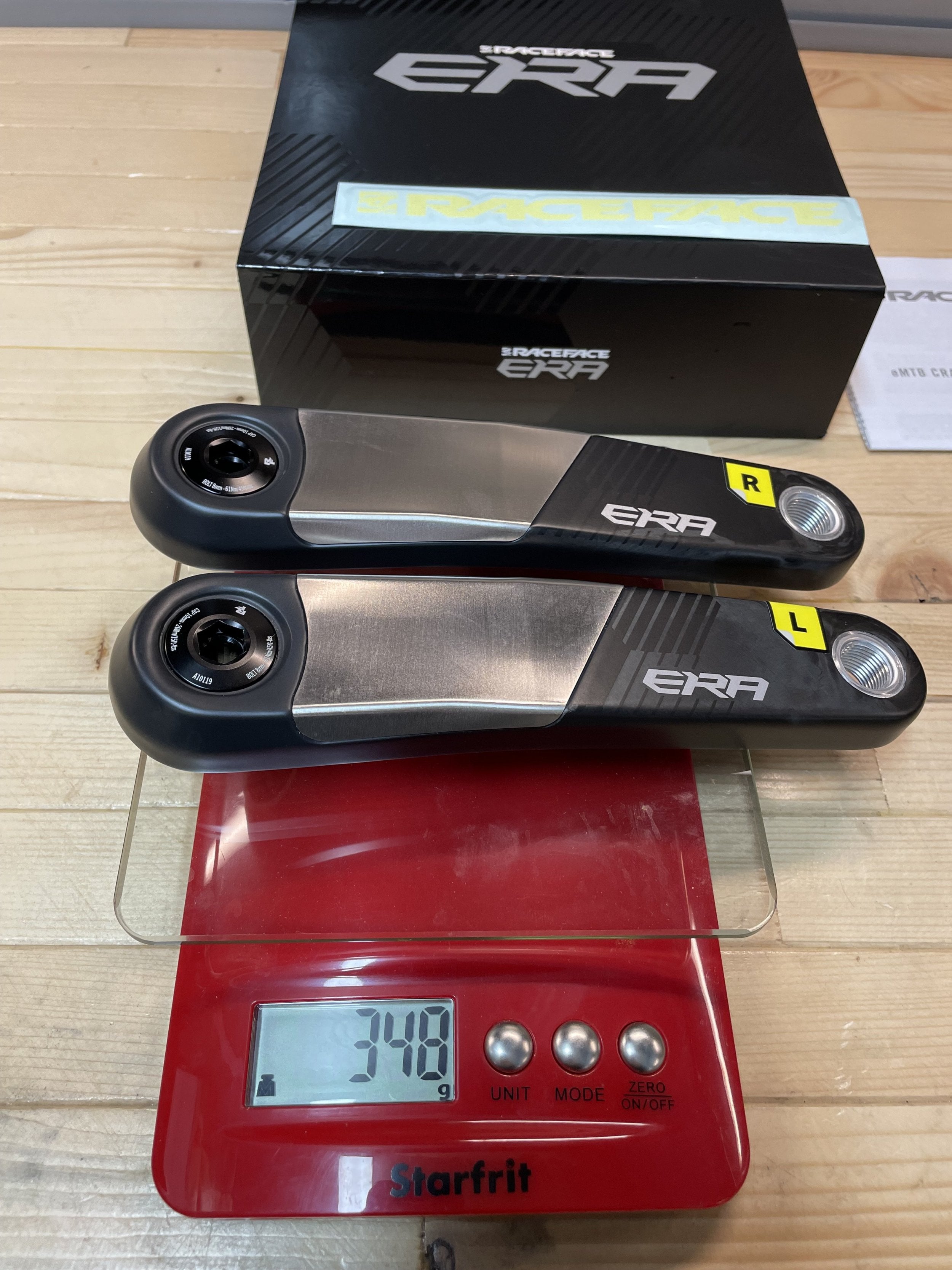

160mm. The bike came with 165mm alloy. I wanted to install 155mm cranks for less pedal strikes but I couldn’t find them in carbon.
I watched a video of some guys destroying carbon cranks. Failures were mainly at the inserts, which to me is a critical weak point. However the Era carbon cranks broke or failed in the middle under more pressure or torque. That made more sense to me.
After a serious peddle strike I don’t want the crank failing at the peddle insert or motor insert. A broken crank near the middle takes more effort. So I was convinced. These ERA cranks are only slightly shorter (5mm) and I never really noticed a difference in my cadence or additional torque required. But they were pricey, but not as pricey as Titanium cranks (holy sh**).

@Zimmerframe did a good review of the 3D printed Titanium cranks. I can’t attest to the strength comparison between these Titanium and Carbon cranks, but the Era carbon cranks seemed to be lighter.
