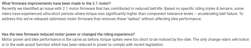

Can you please explain what the firmware update does? Does it actually decrease motor support as temperature increases as many have guessed from behavior of the replacement motors?
Bigtuna00
Nov 27, 2019
556
336
CA
It's answered in the second post:
What firmware improvements have been made to the 2.1 motor?
Recently we identified an issue with 2.1 motor firmware that has contributed to reduced belt-life. Based on specific riding styles & terrains, some riders have experienced ultra-short periods where torque was significantly higher than component tolerance levels – accelerating belt failure. To address this we’ve released optimized motor firmware that removes these “spikes” without affecting bike performance.
Reduced motor support under high temp is "normal" behavior, my '19 has done this since day 1. I'm sure it's been adjusted over time too but I don't think it's related to this update.

To all owners of 2019/20 Turbo Levo & 2020 Kenevo featuring the Specialized 2.1 motor, here's a letter to you from Mike Sinyard - our founder and CEO.
Thanks for all of your support & feedback on this forum. We'll keep a close eye on this thread and do our best to answer any questions.
There are people who have updated and complain that there is a decrease in power in the engine and that is has to increse the assistance in eco.
It is true that the engine update involves a second reduction in power like the previous one that was made at the end of 2019?.
Can you explain what the update consists of, what has been removed?
McInner1
Jun 8, 2019
227
173
Austria
Official Spesh statement (see beginning of that thread):
Has the new firmware reduced motor power or changed the riding experience?
Motor power and bike performance is the same as before, torque spikes were too short to be noticed by the rider. The only change riders will notice is to the walk-assist function which has been reduced in power to comply with recent legislation.
Hi @Javice . Thanks for asking - if you check the 2nd post in the thread there's a Q&A that addresses this and other common questions specifically.
So - absolutely not true that there's any reduction in power. That was our concern too! For anyone reading this or experiencing a seeming reduction in power after an update we'd advise that you check your tuning settings in Mission Control after the update - move all the sliders once and then put them back to where you want them (including acceleration response etc) so that you are 100% confident the bike is tuned the way you like it.
If for some reason you still feel that something isn't right please find a ride that you've recorded before and perhaps re-ride that route whilst recording the ride and then compare your support/power consumption etc. If something doesn't look right then post here.
@gaba / @Bigtuna00 - Motor support begins to de-rate after 90 degrees C. Before that point you should not notice any loss of power.

@Specialized Rider Care As a couple other 2021 new owners also mentioned, I have a December 2019 motor in my new Levo Comp. I was expecting a much newer build for the motor and it looks like mine is in the zone where issues could be seen. As mine is a 2021, I don’t have the longer 4-year warranty. The FAQ and letter talks about all 2021s having their updated motor and parts, but is that accurate for my bike and others who have a 2019 motor build?
Why do 2021s like mine have a motor from last year? Does my motor have the older belt/other parts that were the cause of failures? Should I go back to the LBS to have them update the motor to a newer version under warranty?
@Jsmithjr732 / @Fiord / @Reap3r - thanks for the question here. Need to dig a little deeper so please give me a few days. I may PM you for some bike serial numbers, hold fire for now.

@Specialized Rider Care can you tell us when we can expect to be able to do the firmware update over mission control? Bike shops are super busy and it seems to me that this would certainly help owners if it could be done in the comfort of our own homes.I
Great question. I have no reason to visit the bike shop and would much rather apply the update myself
