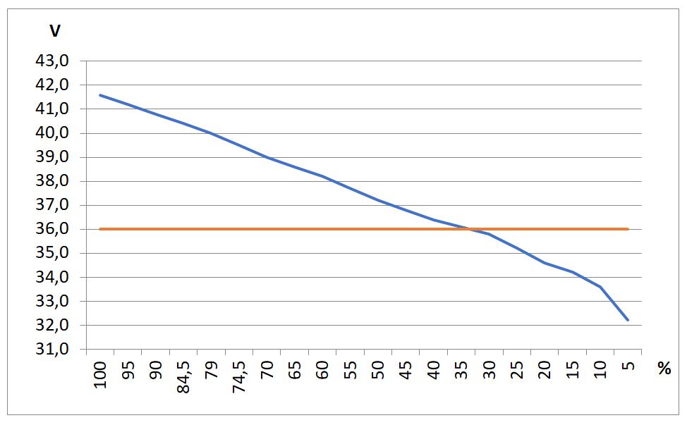

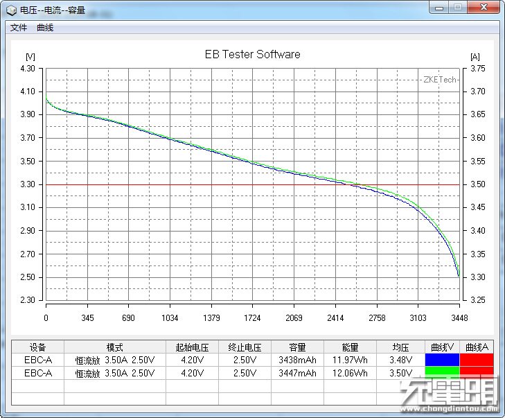

To go along with what Zimmerfrane is saying, if you look at a discharge graph for a 3500mah 18650 lithium battery you will see that voltage decreases at pretty much a linear rate until around the last 20% of capacity where it starts dropping off sharply. Your perception of less power is therefore correct but is not due to software. It is a result of the battery not being able to supply a set voltage throughout the discharge.
Zimms suggestion of looking at the voltage and current will verify what you are "feeling".

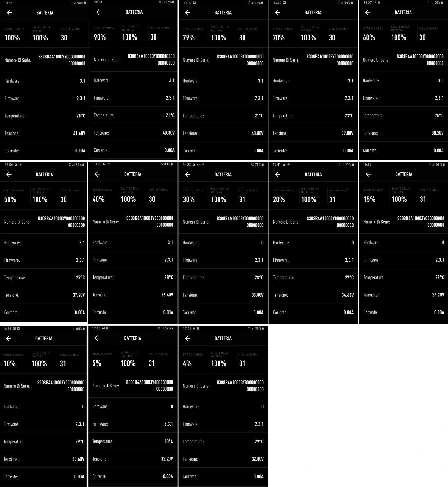

A bit OT, but I hope this data can be interesting...
Regarding the discussion about the support drop at 15% and 5% and the voltage drop
Data collected during a single trip 3050m vertical drop
700 Wh battery, I always let the battery 1 minute before taking the screenshot (the battery recovers about 0,2V compared to the moment of the stop)
The voltage ranges from +15.5% to -7% referred to 36V nominal voltage at 5% battery remaining (always refer to nominal voltage)
The BMS never allows the battery to go under -12%. It would heat and damage the battery pack. Don't compare with a single cell without BMS. Maximum and minimum voltage are comparable to my old Yamaha 400 Wh e 500 Wh batteries.
In the graph you can see the curve is linear until 10% battery remaining, and the support drop is not due to a battery voltage drop.
The motor support was 15% when I got the support drop at 15% battery remaining, and I barely noticed; completely different when I was at 40% support (I looked back to see who was attached to my bike :sneaky:)
