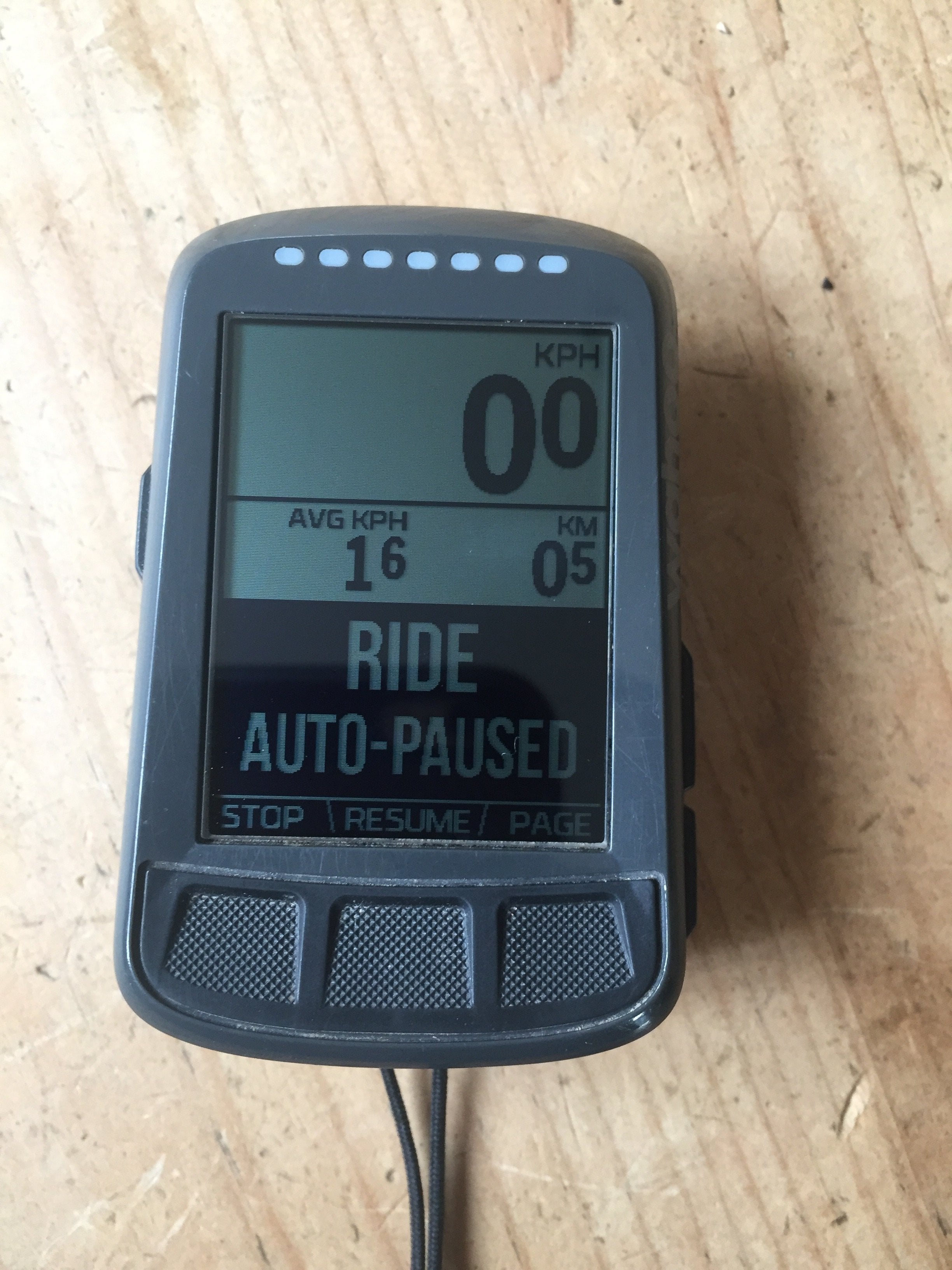

Hi does anyone know how to get the battery display on the levo to come up on the wahoo bolt I can blue tooth the power speed & candence onto it but can’t find the battery I’ve goggled it & utube but no help or perhaps you can’t any ideas cheers

Hi mate - I’ll take a look later and let you know. Basically there’s a fake channel setting on the Levo if I remember correctly that you set in mission control app.

Select the fake channel via mission control. Then in the Wahoo app select Cadence. It’ll pick up your battery level instead of cadence.

whats wahoo bolt?
Hi....it’s like a Garmin Edge 520 cycling computer....but in my opinion a lot better
