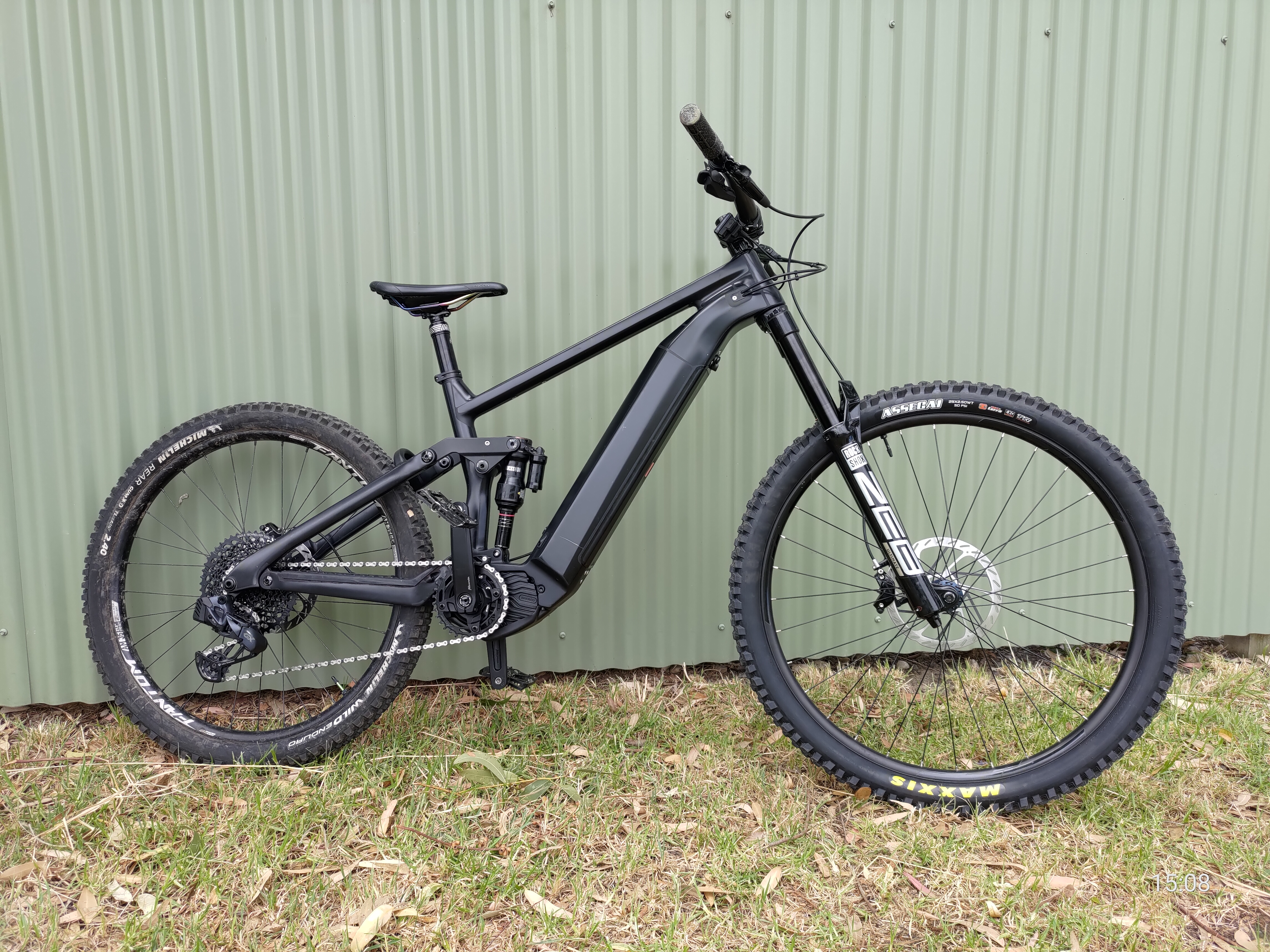

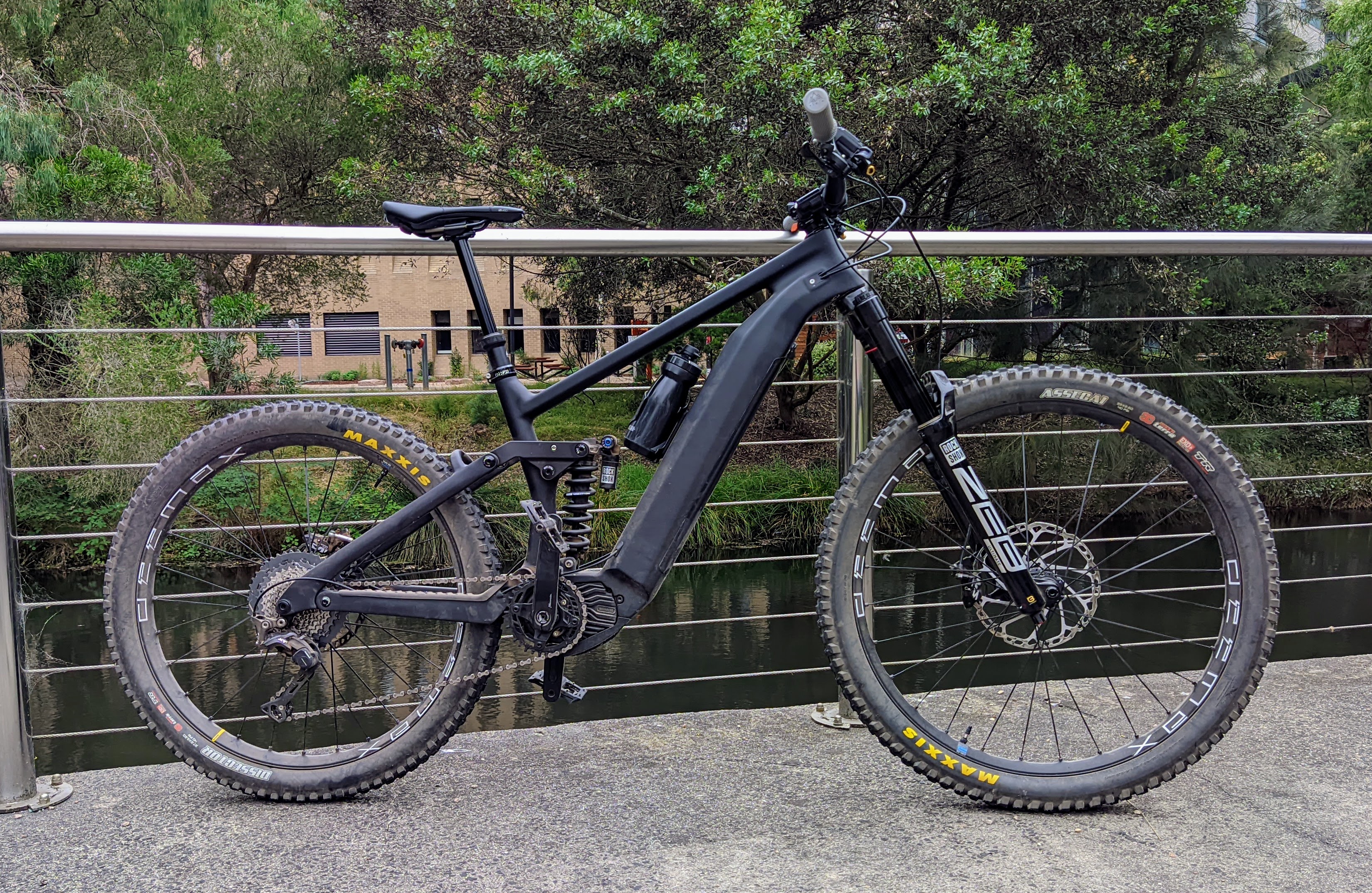

What have you spec'd it with?
Thanks.
Shock: 2023 Rockshox Super Deluxe Ultimate Coil B1 205 x 65 (550lb spring)
Fork: 2023 Rockshox Zeb Ultimate Charger 3 180mm
Bars: RaceFace SixC 35mm R 35 Ø x 820mm
Grips: PNW Components lock-on
Stem: RaceFace Turbine 35 Ø x 50mm Black
Headset: Cane Creek Hellbender ZS44/ZS56
Seatpost: PNW Loam 34.9 dropper 170mm
Pedals: Deity Compound flats (from old bike)
Saddle: Prologo Proxim w450
Tyre (F): Maxxis Assegai 29 x 2.6 Exo+
Tyre (R): Maxxis Dissector 27.5 x 2.6 Exo+
Insert: Rimpact Pro (rear only)
Wheel (F): Mavic E-Deemax S30 29” (30mm IW)
Wheel (R): Mavic E-Deemax S35 27.5" (35mm IW)
Brakes: 2012 Shimano M810 Saint (from old bike)
Rotors: Shimano SLX 220mm F, 203mm R
Pads: Cleanskin Sintered
Shifter: Approx 2016 era Shimano XTR 11 Speed (from old bike)
Derailleur: Shimano XT Shadow+ 11 speed
Cassette: Shimano Xt 11-46
Chain: Shimano XT 11 speed
I recorded the whole build with the intention of making a YouTube video of it. Just need to find some:
Time: spare

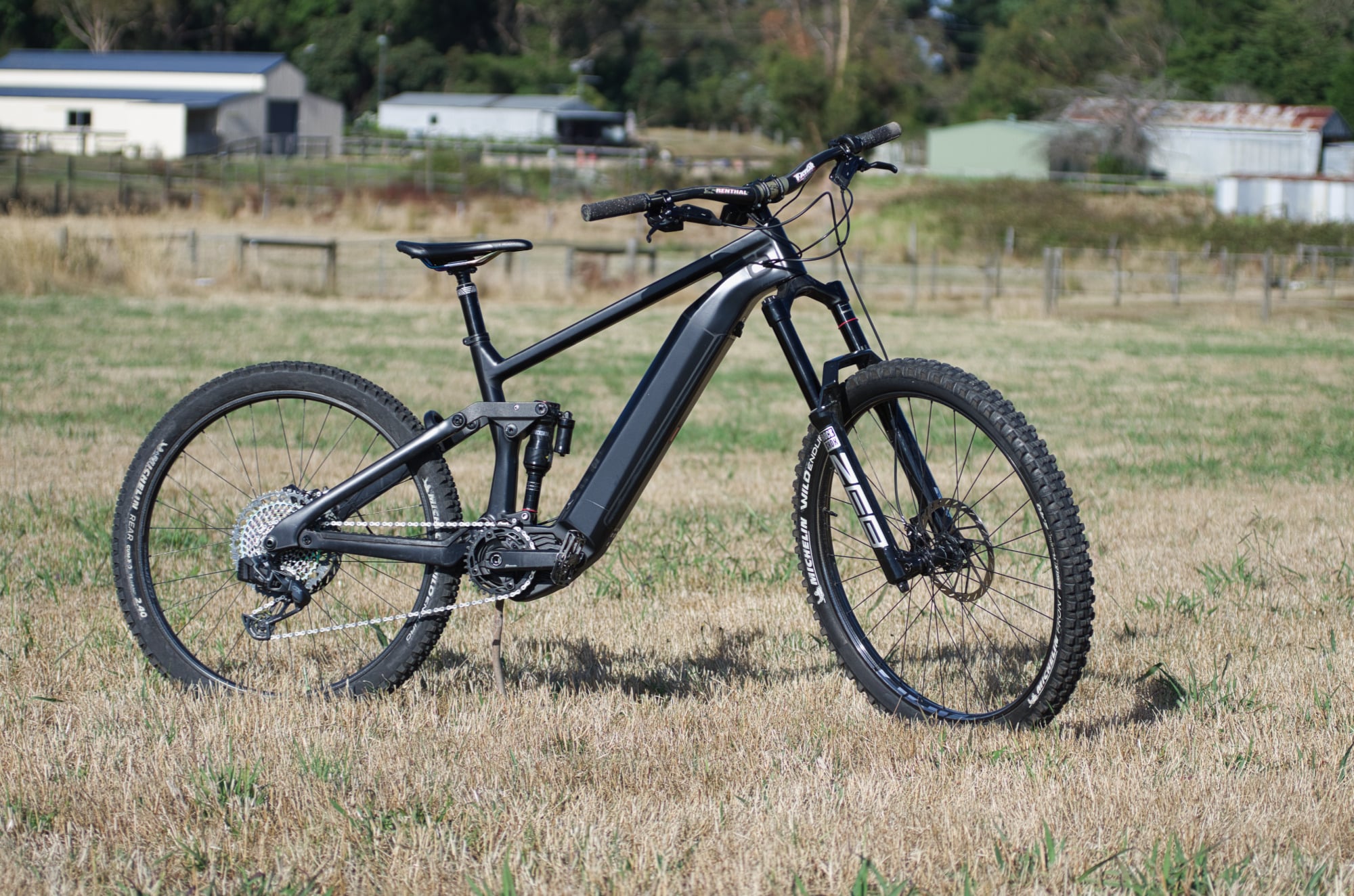

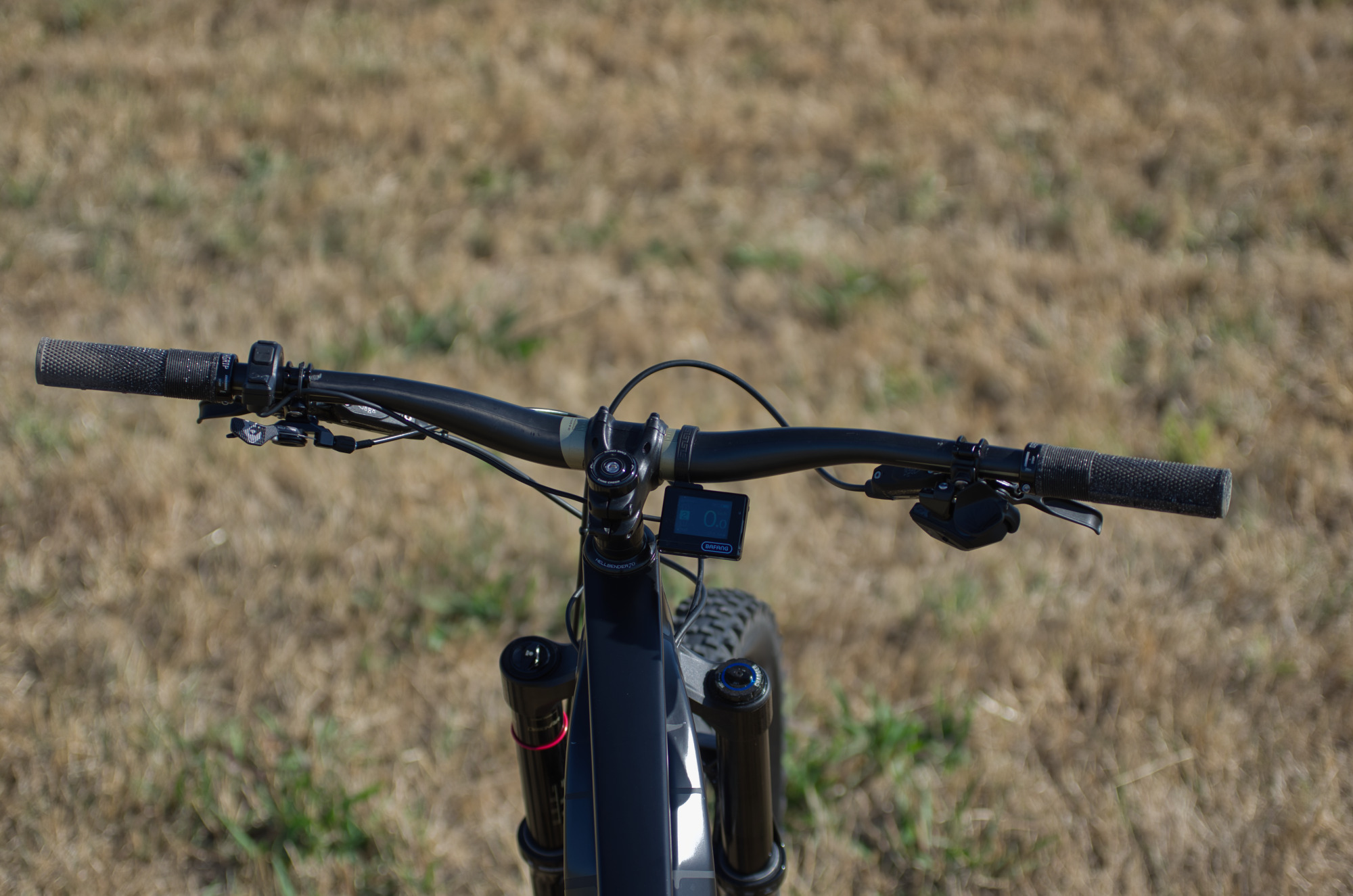

I built up my Typhon over the weekend and had my first ride tonight. I'm absolutely stoked so far, it's a really confidence inspiring bike. I was really just tuning the suspension and tweaking my cockpit setup, but felt really good straight away and ended up with a Strava PB.
Also having a battery that big is great, I was smashing down, then going straight up the fire trail in boost for an hour and a half and still had 70% battery left.
Also a massive thanks to Chris for answering all my questions during the build.
Time for an update on my early experience with the Typhon.
TLDR: I love it.
My previous ebike was a 2019 Giant Trance e+ SX which I really enjoyed, but the 500Wh battery was too much smaller than all my riding mates who had 600+ Wh batteries. I started looking around at what was currently available, and what I was finding is that most bikes I could afford I didn't like the spec of, or were way outside my budget (looking at you Specialized). I saw Rob's cheeb video a while back and thought it looked like a fun way of doing it, but the Chinese frames (E10 etc) all seemed to have pretty dated geo. That's when I came across the VMG Typhon, and it quickly had me interested. I emailed Chris and he quickly replied back, and everything looked good. I had a think about it over Christmas, and after riding the Epic at Mt Buller (42km with 1200m of climbing) and running out of battery I decided to pull the trigger.
I ordered a frame, wrap and headset through VMG just after Christmas, then went on a buying spree in the boxing day sales. I love researching parts and trying to find bargains so I really was a kid in a candy shop at this point. What I bought was a mix of new and used parts, cutting the corners which I feel don't really effect the performance and spending where I think it really matters. The parts started to build up in my home office, then it was a the waiting game for the frame to arrive (the headset supplier shutdown over Christmas so that pushed things back a few weeks). I've listed the spec below.
Once everything arrived, I started by applying the wrap. I thought this would somewhat annoying task, but it was way more fiddley that I imagined. Buy the end I was getting much better, but if you haven't done it before, pay someone to do it for you, trust me it's worth it.
With that done I started putting it all together. Everything went really smoothly and I didn't have any build issues at all. Being a somewhat cheaper Chinese carbon frame, I was wondering if I would run into any issues, but happily there weren't any. I setup the suspension with 30% sag front and rear and followed the Rockshock trailhead app's recommendation for rebound.
I'm really happy with the look of the bike as well. You can only get the frame in black, but after the fluro orange and blue of my Giant I wanted to go the other way. Looks certainly weren't the top of my criteria list when shopping for parts, but when possible I did go for black parts to match. It's ended up looking really cool to me with nearly everything being black, then the fork, shock and wheels having silver stickers.
For my maiden ride I took it to Red Hill which has a few very rutty and rough tracks with fire tracks back up, which are a great place to setup suspension. I started on an easy green run (East Link) to give the bike a shakedown and to make sure I hadn't stuffed anything in my build. By the end of that track I was already impressed, it just felt really comfortable and I was going into turns faster than I really intended to before the run, it just gives you confidence.
I then rode up a pretty basic climb (High Roller). Chris had asked me if I wanted the firmware with more or less overrun and I went with less as it's what I'm used to. Even with that firmware there was still quite a bit more overrun than I'm used to and a couple of times I stopped pedalling into a switchback and I kept accelerating. The first few times definitely took me by surprise and I grabbed a load of brake. It's certainly something you need to get used to. The motor has masses of power, but it delivers it differently to the Giant Yamaha motors. The Giants are best when you are in a higher gear and at a lower tempo, the Bafang seems to be more like the Shimano or Bosch motors and like you to keep the tempo up a bit more. Now that I've had a few more rides and I'm getting used to the overrun, it is really useful for climbing tech, and also for riding switchbacks. You stop pedalling just before you get into the corner, then to overrun powers you through it.
I then rode up the fire trail to Rock Salt which is a hard blue run. It has a bit of everything, berms, little drops and chunk in a pretty short run so is great for testing. The first run a took it pretty easy and was pretty happy with my setup. I rode back up and hit it a bit faster, then faster again. I did 5 laps with a few suspension tweaks each run and was pretty happy with my setup by the end of that. I also ran into a guy up there was really interested in the bike. Having something different is always a conversation starter.
I rode for about 2hrs in the end, with quite a bit of faffing around tweaking things but still only went through 35% of the battery doing 750m of climbing. I certainly don't think the battery will limit my riding time now, my fitness might though. At the end of the session I found I had a Strava PB which shocked me, the tracks were dry and I wasn't trying to push hard at all. It just shows how capable the bike is that on the first ride I was feeling that comfortable.

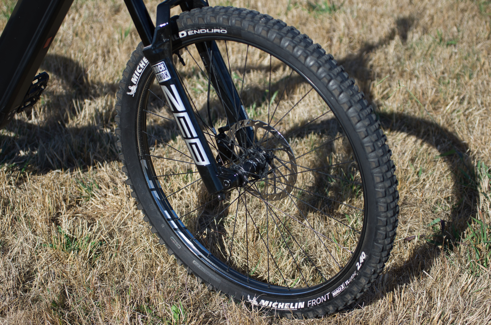

I've had a couple more rides since and haven't come away any less impressed. The bike chews up the chunk as you would expect a 170/160 bike to, but the cornering ability is what has really impressed me the most. I don't know what it is, but I am going into corners so much quicker than I ever did on my Giant and is just keeps gripping. I've done a few 5 footish drops and the bike eats those, again with decent suspension I wouldn't expect less but the frame has taken it all in stride.

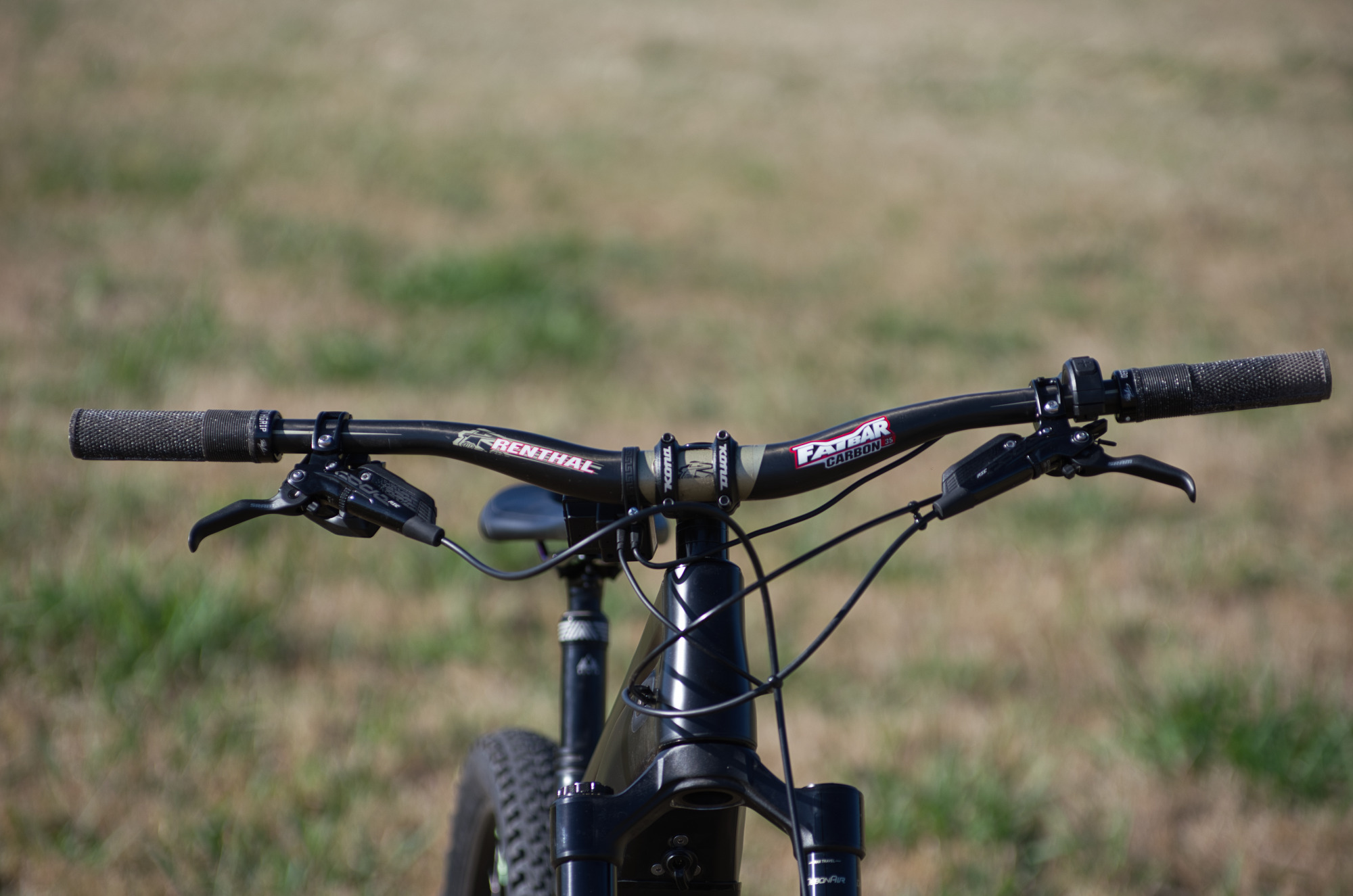

So far the only thing I don't love the controller and display. The controller is just bigger than it needs to be and where the cable comes out gets in the way of the dropper unless you angle it further forward than you really want to. The display is good but the mount is only designed for 31.8mm bars not the 35mm I have, so I have to do a bit of a hack job to get it fitted. I will have a look at the new DP C245 controller and display and I can find them anywhere (it sounds like Chris is going to get some).

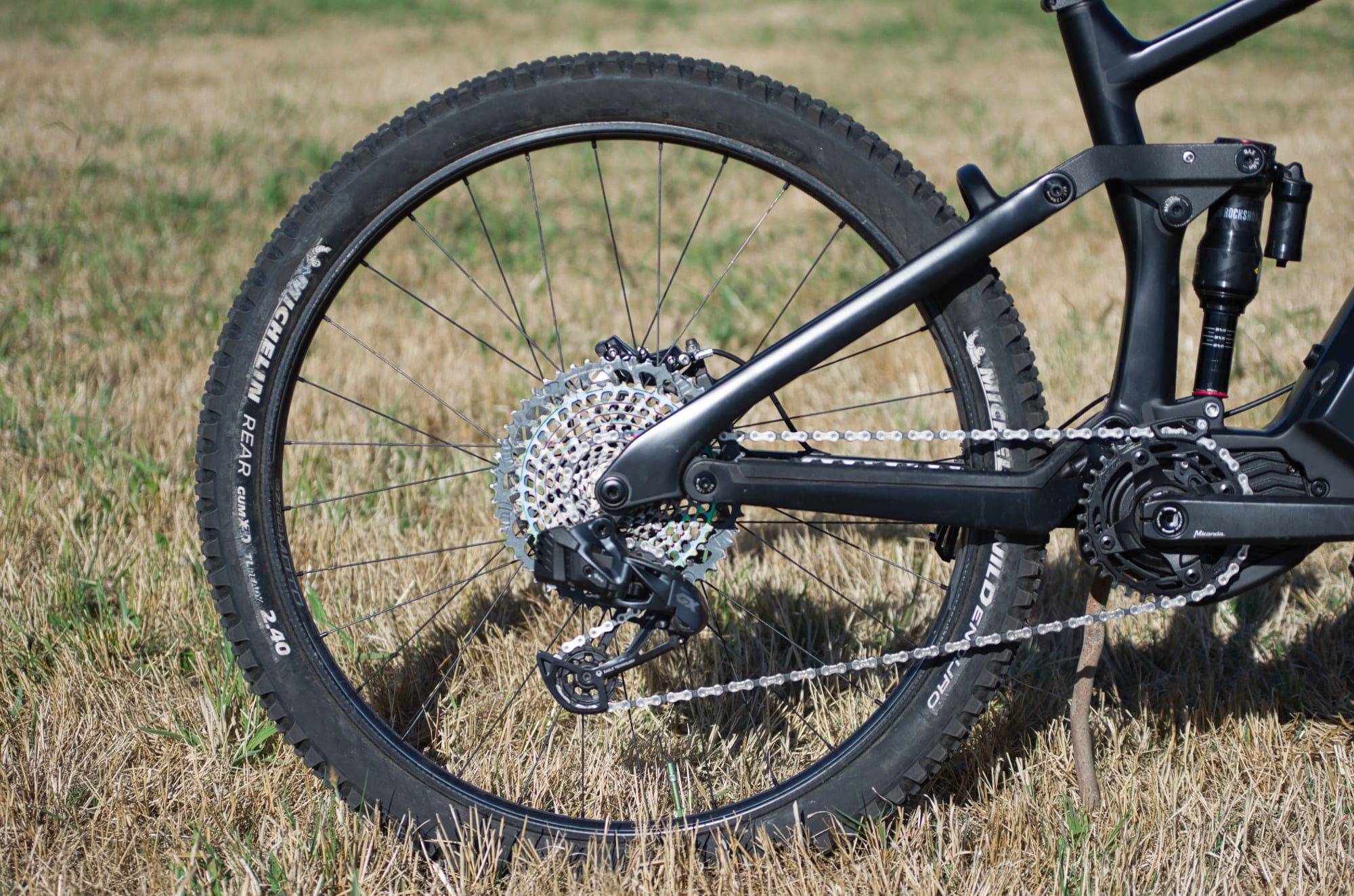

Derailleur: SRAM GX Axis
Cassette: SRAM XX1 10-52
Bars: Renthal Fatbar 35 Carbon
Grips: DMR Deathgrips
Stem: Kona 40mm
