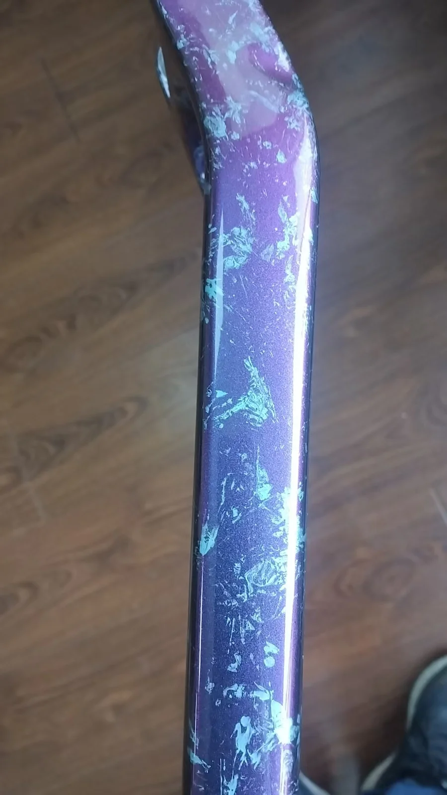

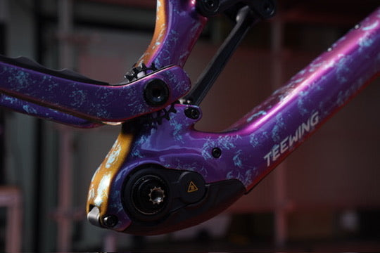

Shop in Arizona getting special paint jobs for the Force and Flux framesets.

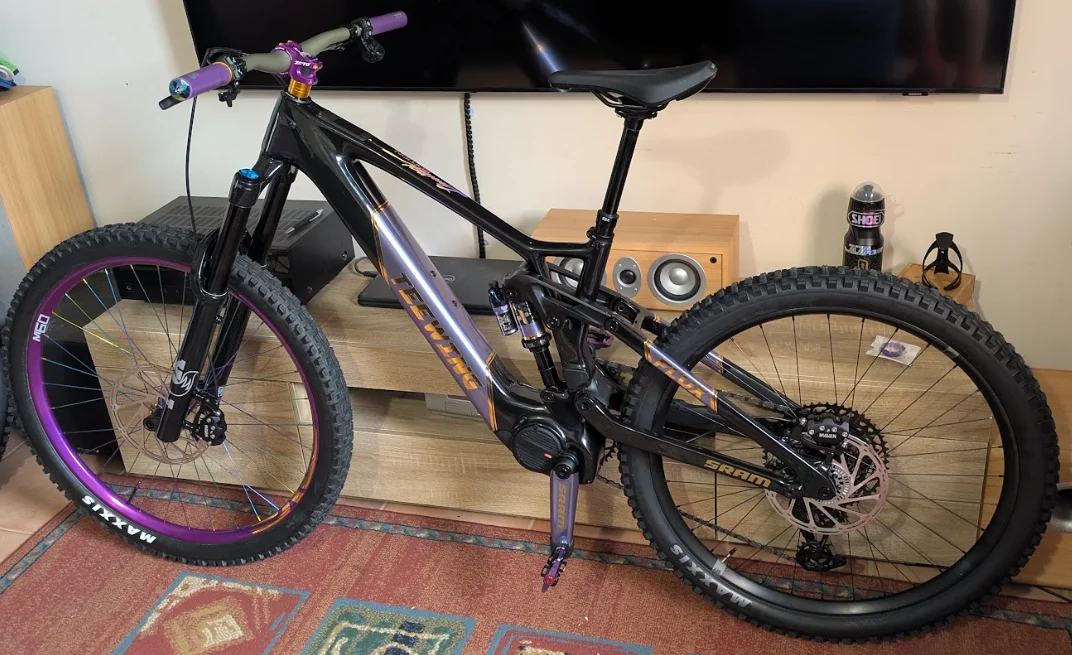

Got to say. After running the Magura MT7s on the Amflow. I'm not a huge fan of the Mavens on the Flux. There may be a brake upgrade in the future.

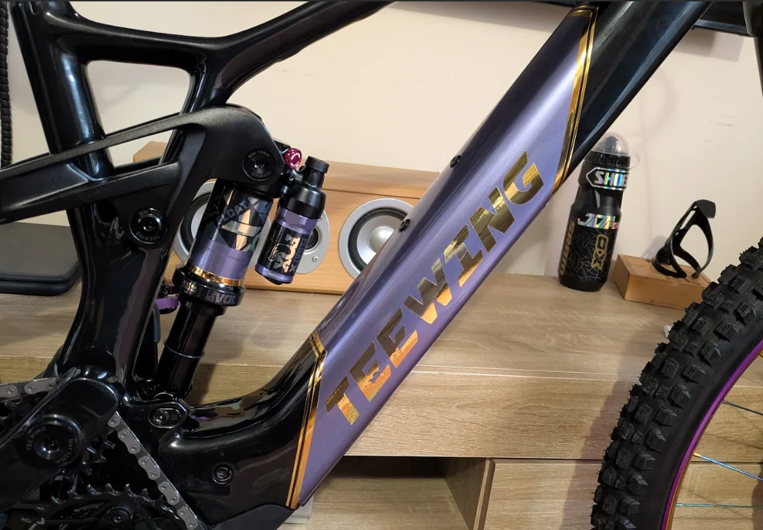

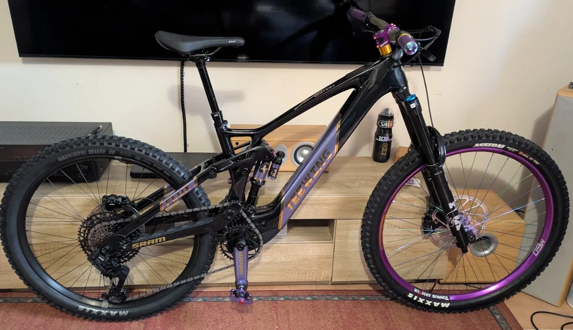

Meanwhile. Progress is getting there. Still got the fork and rear wheel to go. But the design on the shock turned out super nice.

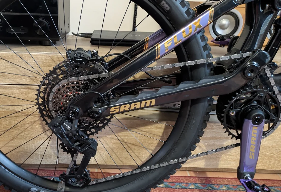

And the SRAM S1000 AXS Electronic Transmission has been fitted and the Smoothshift is working nicely.
Mate alls looking electrified, even getting the cranks dressed much respect to patience.... Astro's outfitter custom tuned rigs 👍
Mottled in olive green be ok to but yeah nice to see some new colour flare.

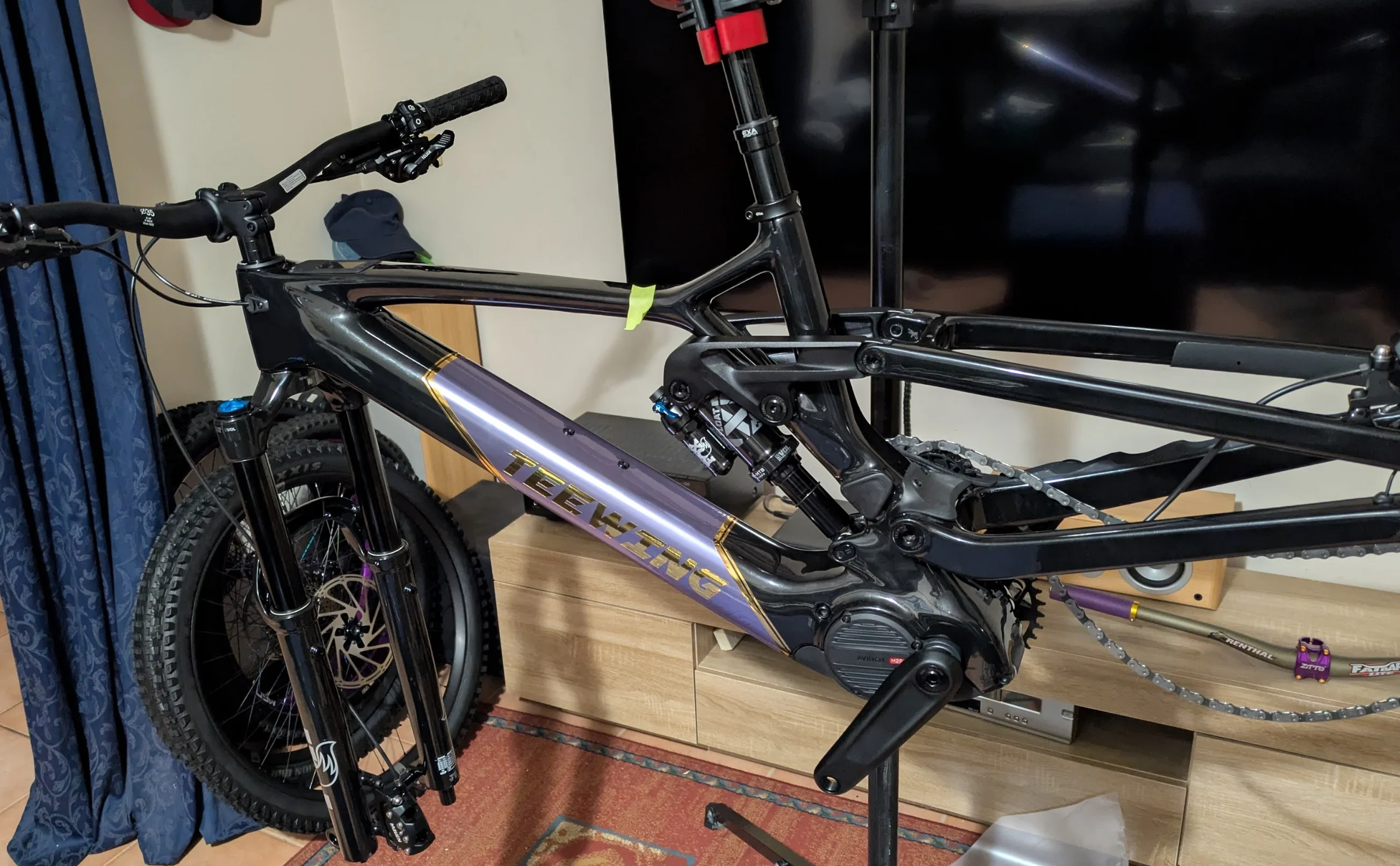

Nearly finished. Just one more fork stanchion to do.
BTW. I ended up taking the rear wheel and chainring spider to a local bike store to remove the rear cassette, and remove the chainring bolts. Couldn't for the life, of me get them off.
Charged me AUD$50 to do it, which didn't impress me, but he did say both items had lots of Loctite, which was very stubborn to remove. So be aware when you want to change these items.

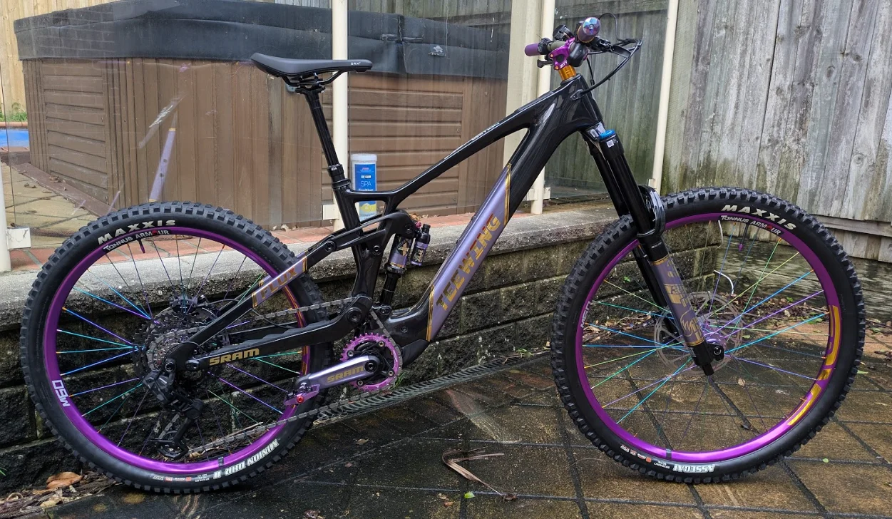

Looks great, bet it's going to ride equally as good to, 27 wheel in 29 setting.
What's the final weight, with/without pedals?
