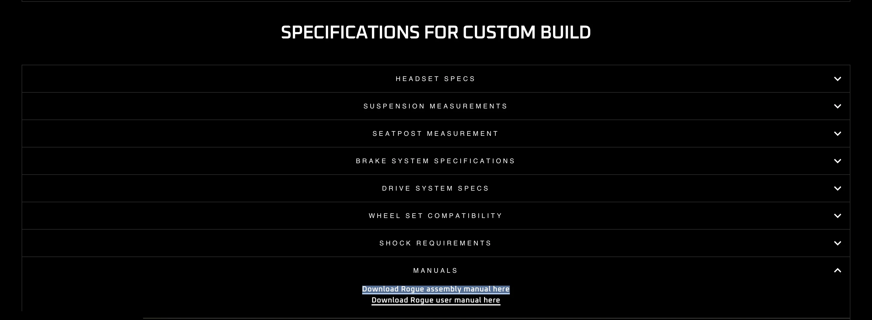

Installed as shown in the pdf from Velduro website.
I couldn't find it, the reason I ask is I understand its not the best way as it says from the outside (?). I put mine on the inside. I added a small amount of epoxy. You can then remove the spacer washers. Make sure you then check alignment on the idler after this. No creaks at all on mine now, mine didn't have much but uber silent now. BTW, it would have taken you just as long to say per the website or answer the original question but in good news I lost 5 minutes of my life looking for as per the pdf 😆🤣😆
Thanks for sharing.
I might be missing it but the top hat washers are not in this PDF (as far as I can tell). In regards to the green ones on page 15, they are the washers that come with the Avinox bolt system and not the top hat washers.
Disclaimer - my eyesight is middle aged but I refuse to recognize it.
Thanks for sharing.
As per "The PDF" ... I think this was actually emailed as a link to me by Velduro Int.
