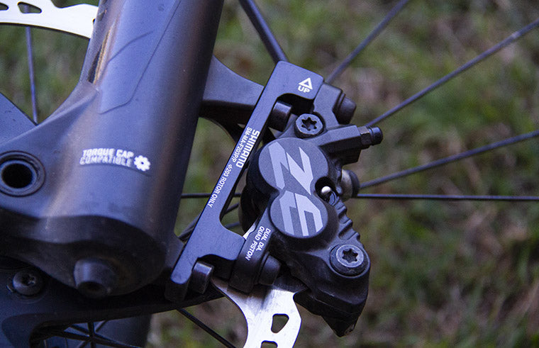

I'm looking at upsizing my rotor from the 203mm to 220mm rotor. I can't seam to find any info as to the adaptor bracket size that is needed for the conversion?
Has anyone done this and if so what bracket size is required? What brand rotor did you choose?

If you have forks with 180mm Post mount you need +40mm PM adapter.

I just got done upgrading to a sram 220 rotor on the front of my levo. But I had to use a +63 PM adapter from Galfer because I have a 2017 yari with 160 post mounts.

yeap, it depends on the fork model (rotor mount) and the brake caliper model, so no general answer to this
