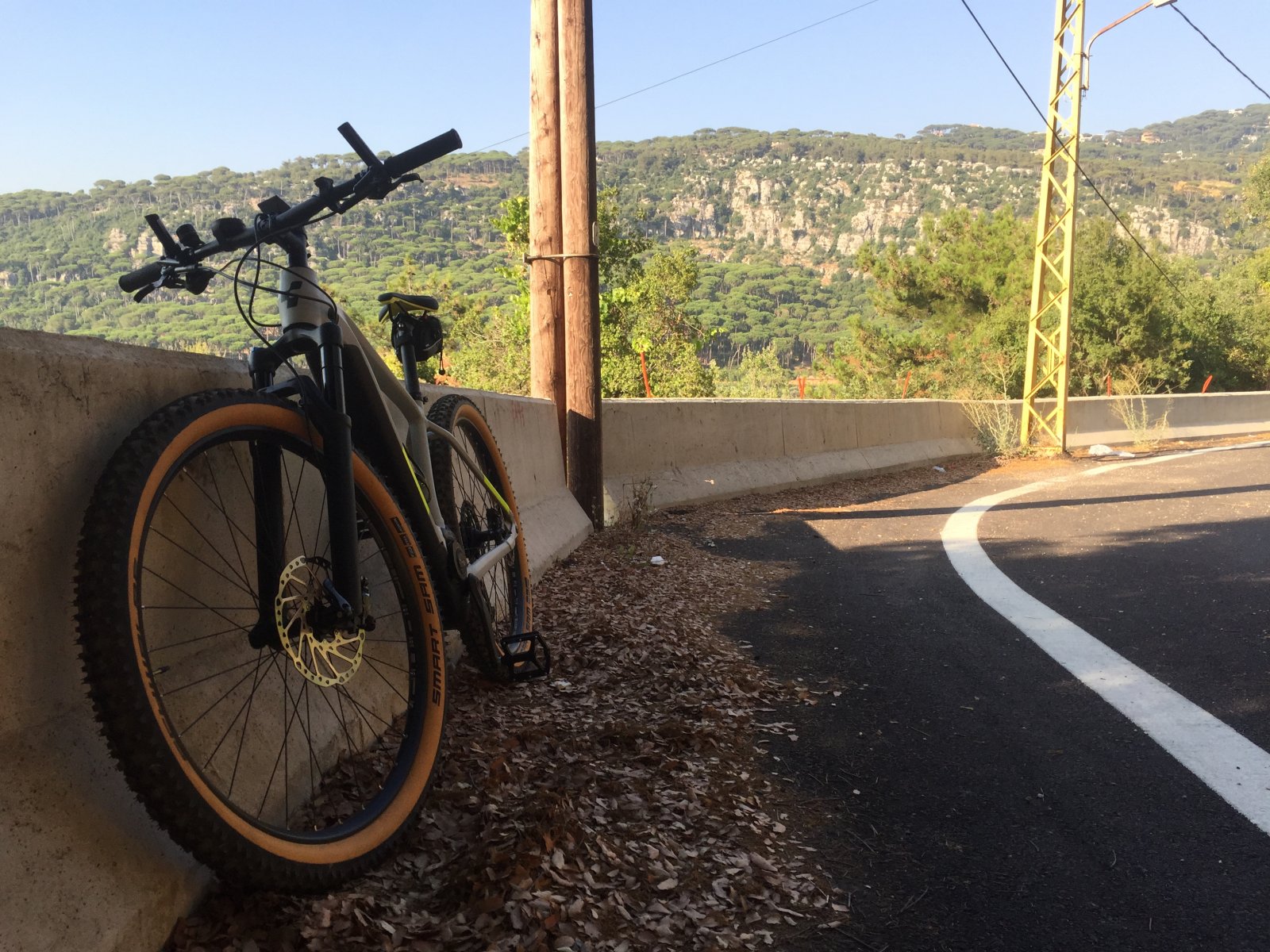

hello all, I bought a new cube reaction hybrid set 625.
now after 3 months the lbs told me I need to change my rotors, already? I thought..
but in all honesty, I am 94kg, ride 4/5 times a week, and basically only climb mountains, I usually ascent around 11/1200m (no other options in Lebanon Beirut) only to ride back down on tarmac so yeah heavy breaking there.
these are 50km rides give or take.
so my question is are there special pads or rotors that will last longer?
right now it has 203mm rotors in front and 180mm rear, Shimano sm-rt64.
the cube has the Shimano XT BR-M8120 break system, which is excellent I think.
perhaps I should change the rotors to ice-tech (not sure if I say it correct), would that help a little besides losing weight? ;)
oh and should I go for metal pads instead of resin?
thanks in advance & blessings

Rotor braking surface life will be much of a muchness between brands. They're just 1.8mm thick sheets of shaped steel and so their lifespan will vary more from braking surface size and pad contact size/shape than what particular brand of rotor you use. and with the same calipers fitted this is not going to change hugely anyway.
Pad life however varies considerably from compound to compound.
your dilemma is if you buy the hardest wearing pad material you'll wear your rotors out quicker.
Icetech rotors aren't any more durable or lighter - they simply cool down a little quicker due to the shape and the construction (alloy sandwiched betwen steel)
Icetech finned pads are also designed to reduce heat.
Less heat may well lead to slightly better lifespans... BUT at TWICE the cost. so no real saving for you overall. infact it'll cost you more.

it all makes so much sense, thank you Gary for your responds.
i will keep changing to the original rotors and pads for now.
guess i have to start seeing pad and rotor cost as fuel money.
indeed no dragging of the breaks here, short light or heavy squeezes to keep them breathing.
thanks again!
