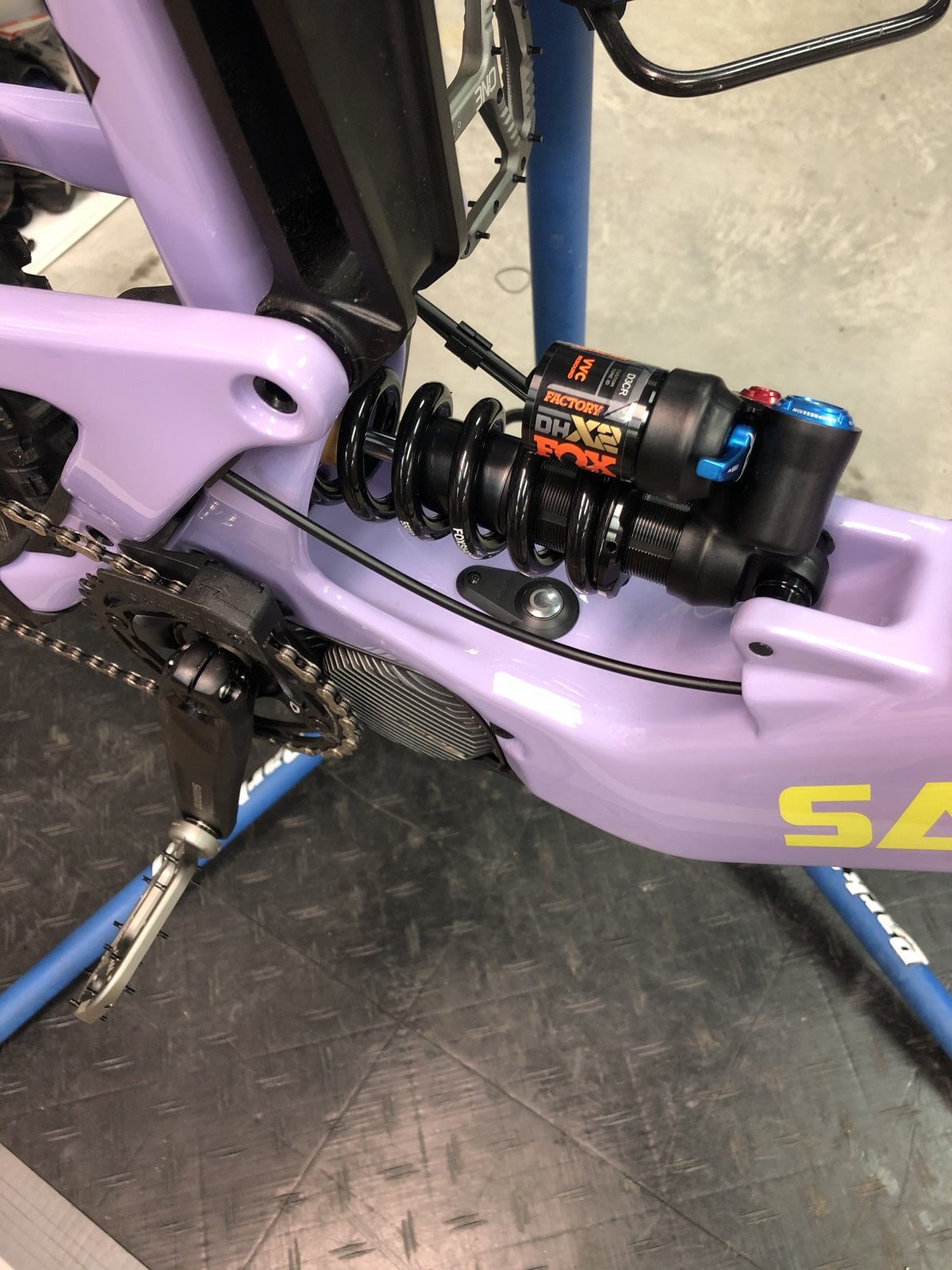

I own two DHX2 shocks, a 2020 version that came stock on my Devinci and a 2021 version that I bought as a spare while my stock one was having the blown seals fixed.
the seals are totally suspect on the DHX2 shocks, I’ve blown the seals in both shocks now and had them fixed under warranty. I love the feel of the DHX2 but I wish they were more durable.

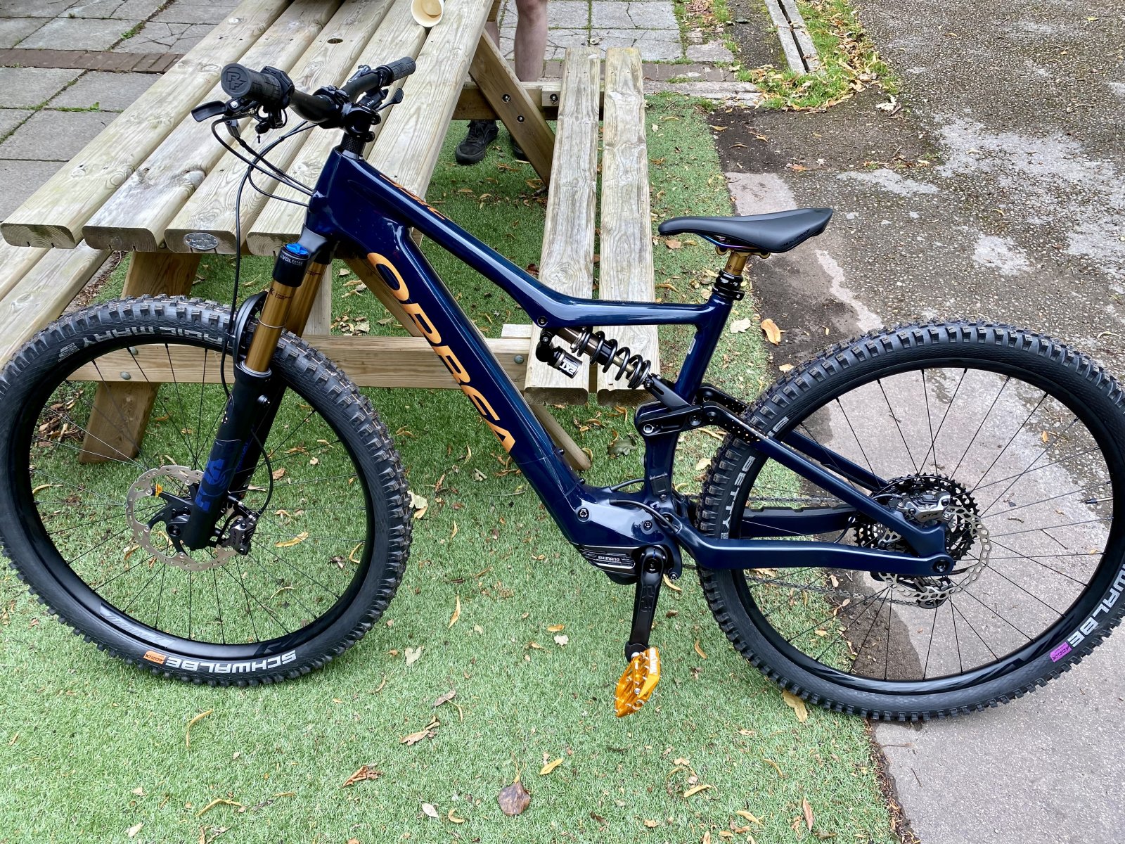

I went EXT in the end, just fits in nicer colour wise and I liked that they prefer you to come in and let them fit it for you, they also have very gnarly trails in Wales were there based. The shock performed better than expected, or the bike did maybe, or maybe that was just me! ?
I did bottom out the fork though…..

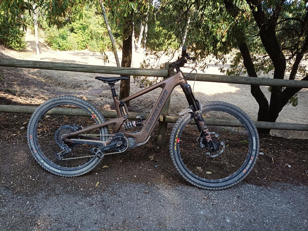

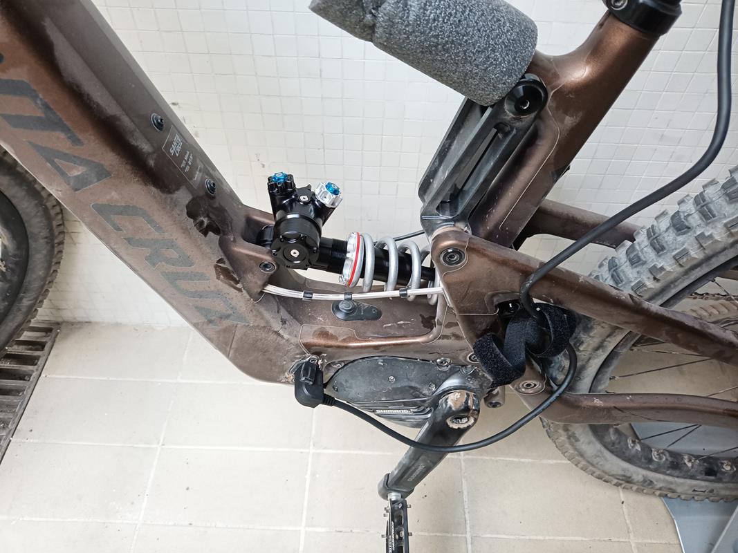

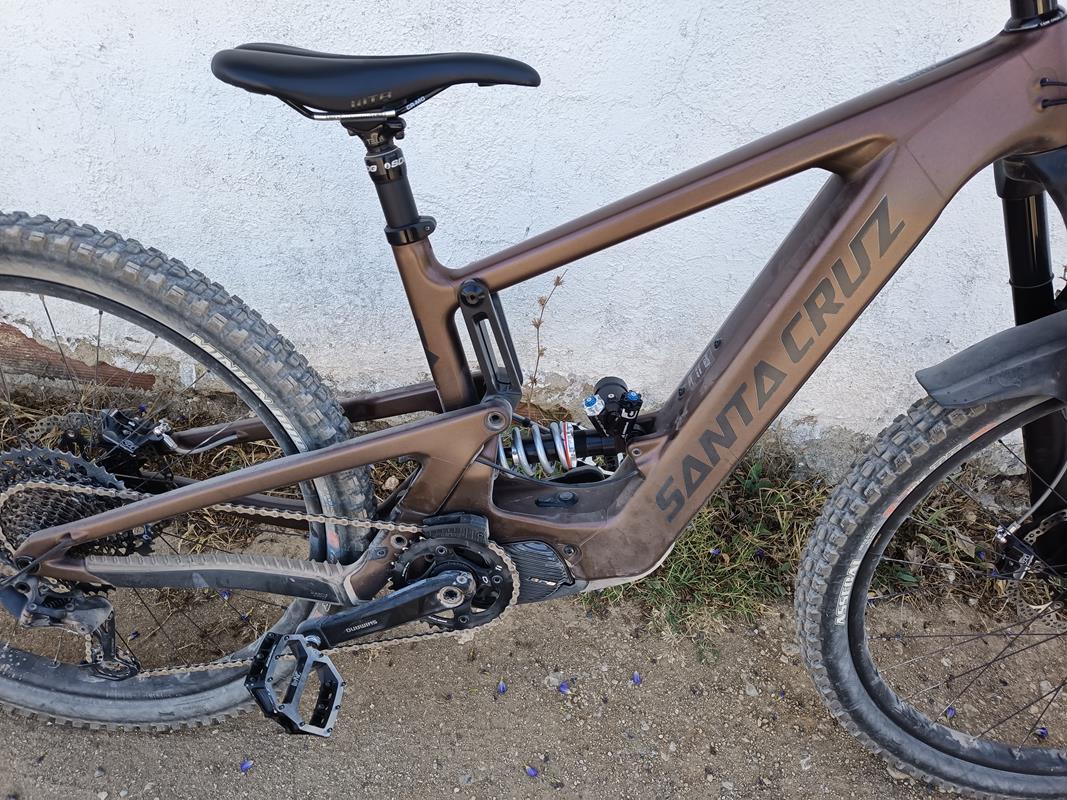

The Bullit was already very good out of the box (better than my Nomad 4 was before i installed an 11.6 there), but now it's even better!
How are you finding the coil on the orbea? I've had push 11/6 on my last 2 non ebike and the Rise is my first ebike. I've not really tried to dial the suspension in yet so I don't want to be too judgemental but it definitely feels like it has less grip in turns than what I'm used too. My Evil also has the push coil and damper conversions in the fork too which is probably affecting the handling.
