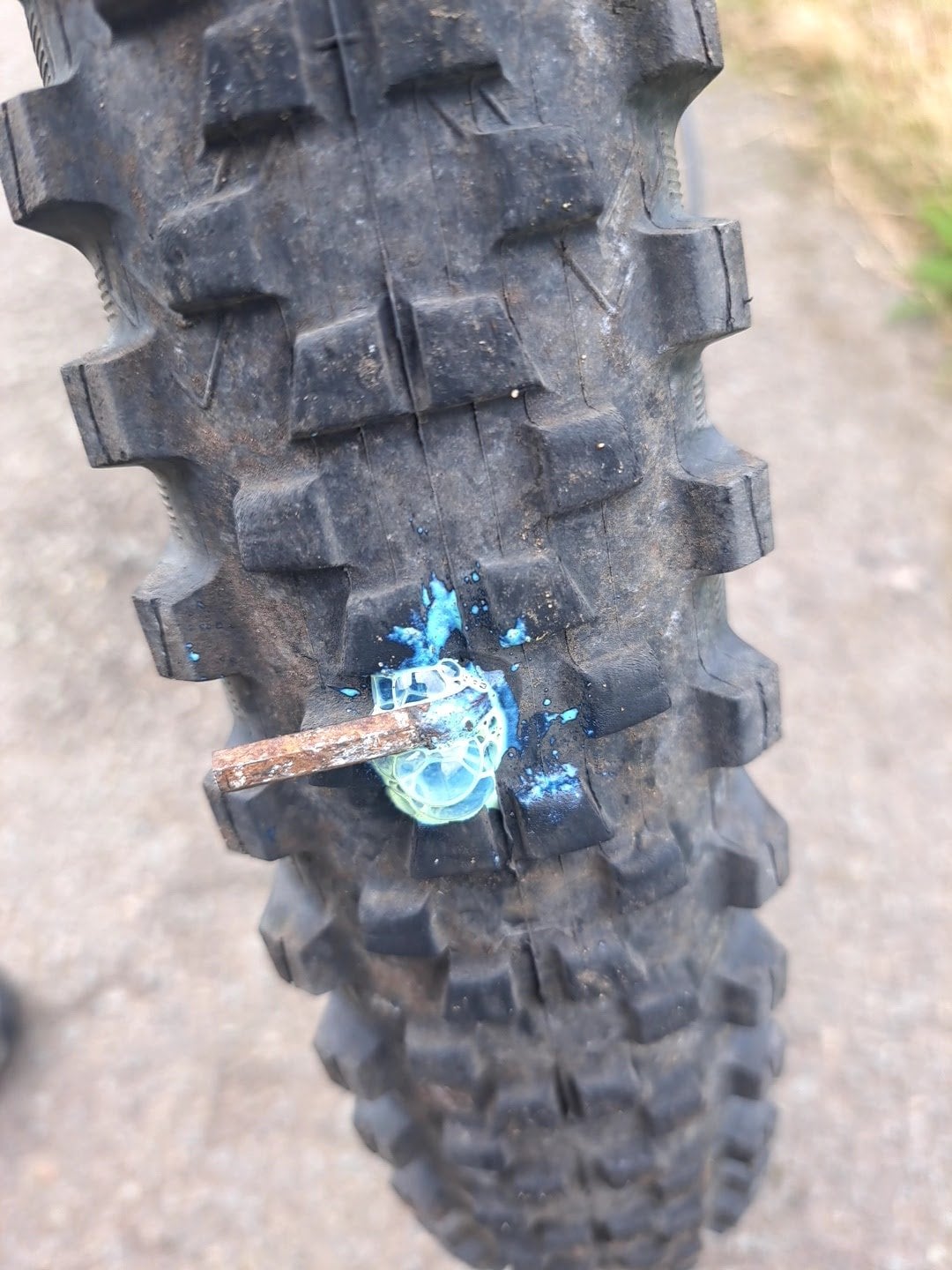

Which ever sealant your pick (Stans is the best cuz they were the first and they cost the most ;)), you will have to stick with the same product as they don't mix. You should also pickup some Bacon Strips for holes that won't seal with sealant alone.

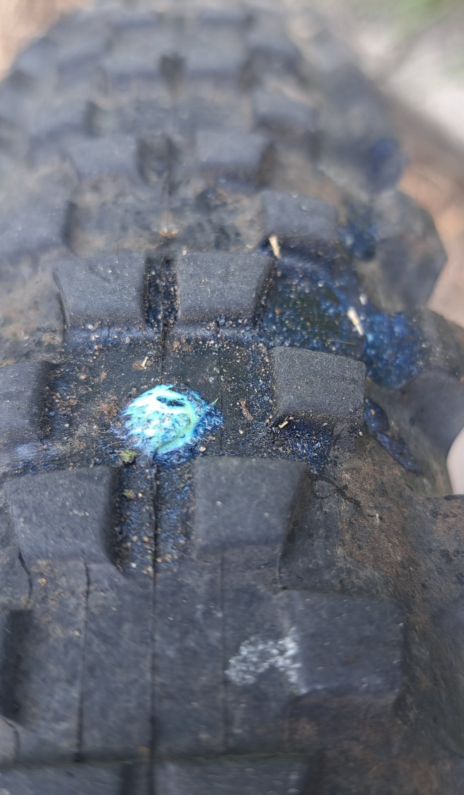

I carry a Stan's DART (Dual Action Repair for Tubeless). It has a kind of chimney sweep's brush with a barb for positive engagement to plug the hole, and a coating that reacts with ammonia sealent (e.g. Stans) to bond it all together. Not cheap, but the one time I have used it was to seal a sidewall split about 5mm long which lasted the life of the tyre. It also has a valve core removal tool built in. To mount a tyre I now use a tube to pop the beads, then deflate, release one side, remove tube fit, valve, and, with one side seated, only half as much air to escape so much easier to get it sealed. As a last resort, if my Air Shot still can't get the tyre seated, I use a co2 inflator, but, replace the CO2 with air (as Stans recommends) since it can react with the sealant. Don't use Stans Race sealant as it dries up really quick.

I used stans for years but I changed for a few reasons
1st it would bleed through sidewalls on some tyres Maxxis being the biggest culprit
2nd it failed to seal some simple punctures
and last but not least it corroded one of my rims where there was bare alloy by a valve hole
Muc off has done none of the above a year in use so will be sticking with it.
