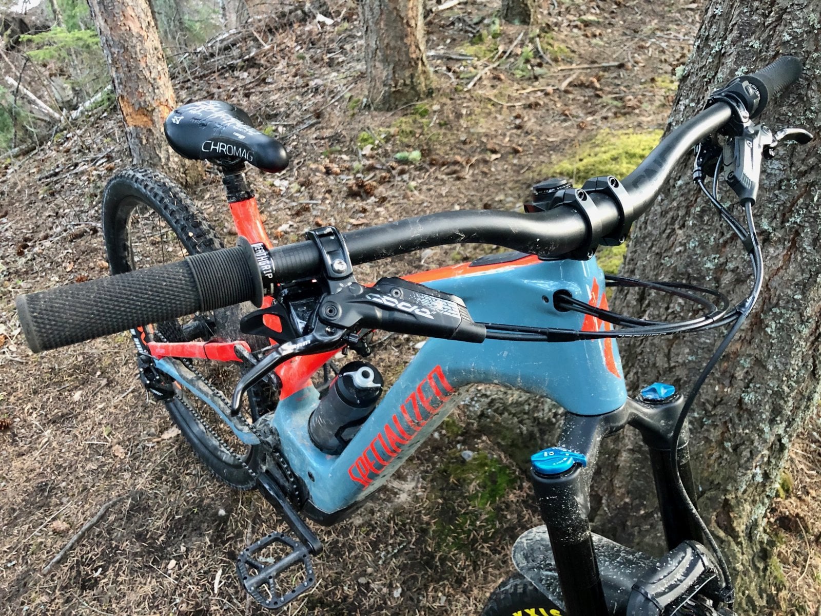

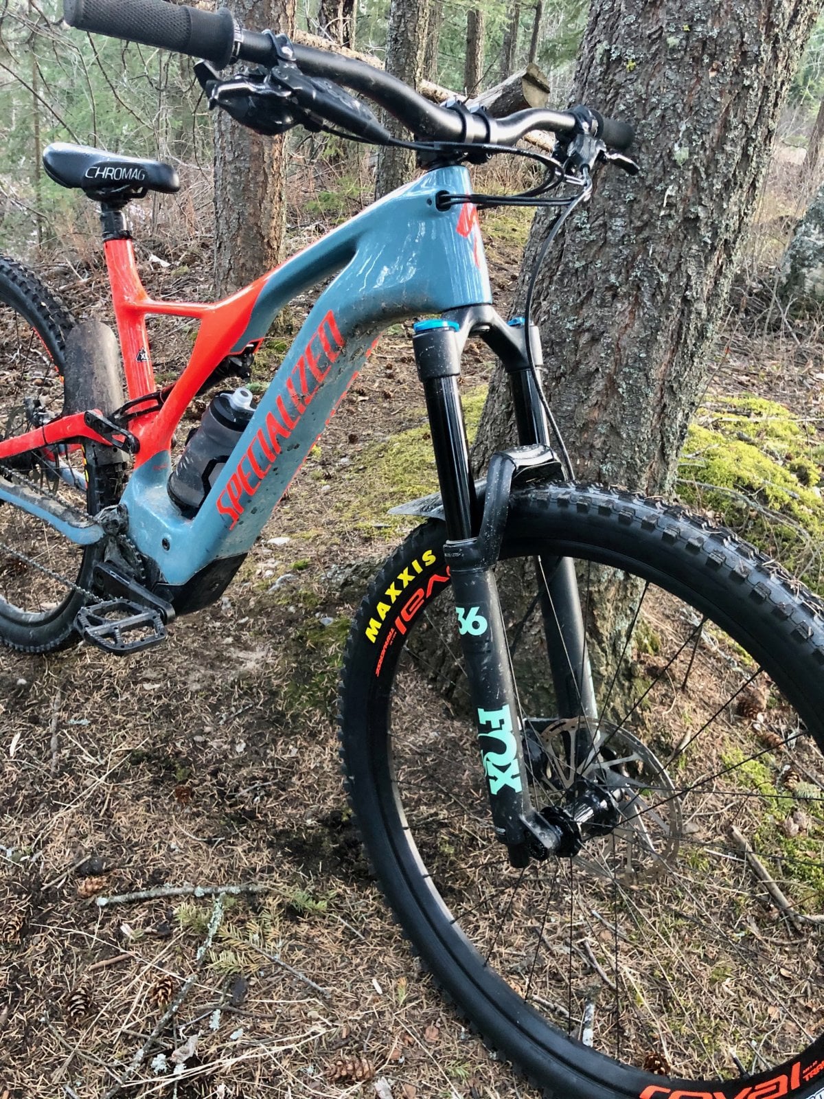

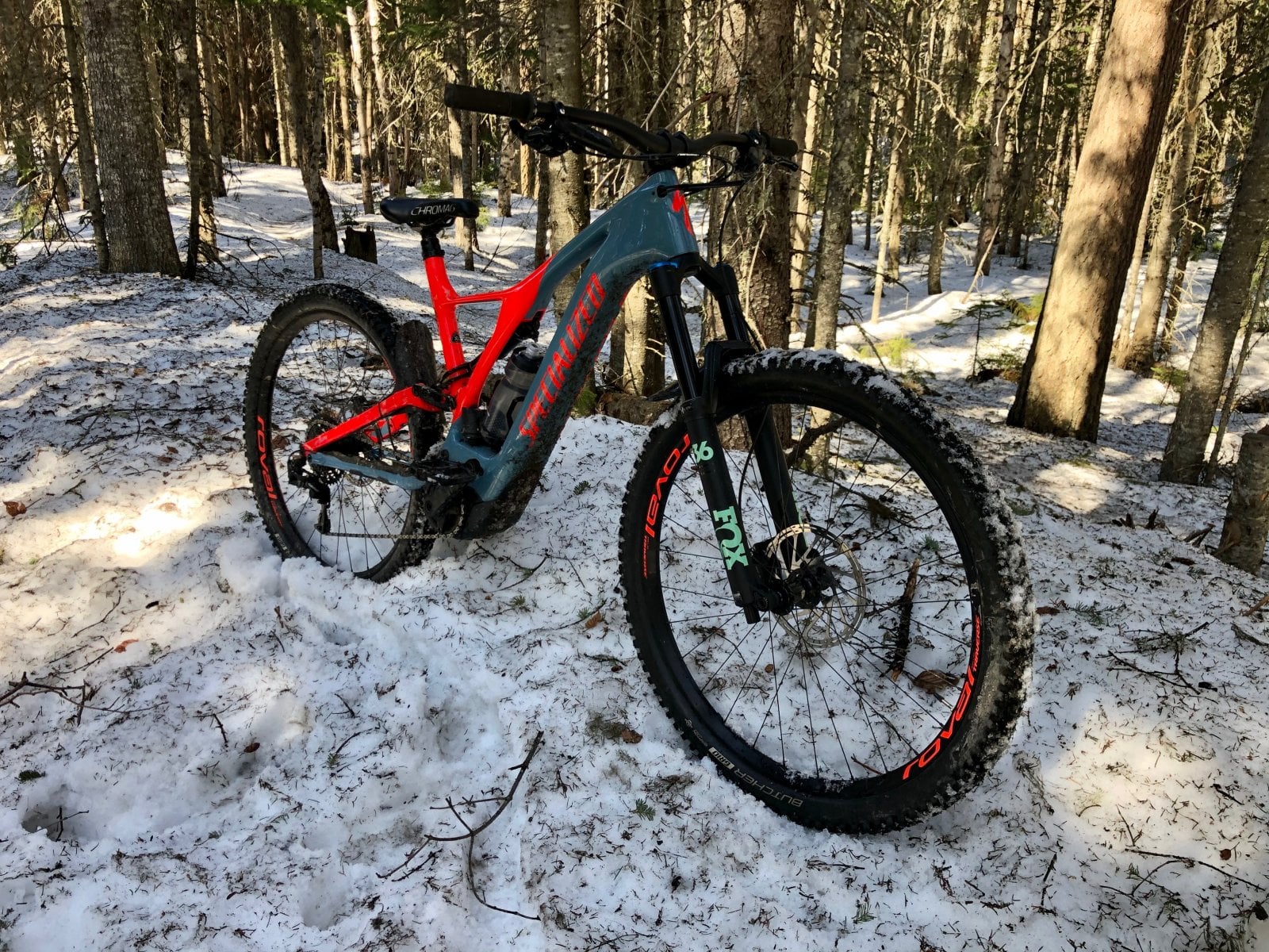

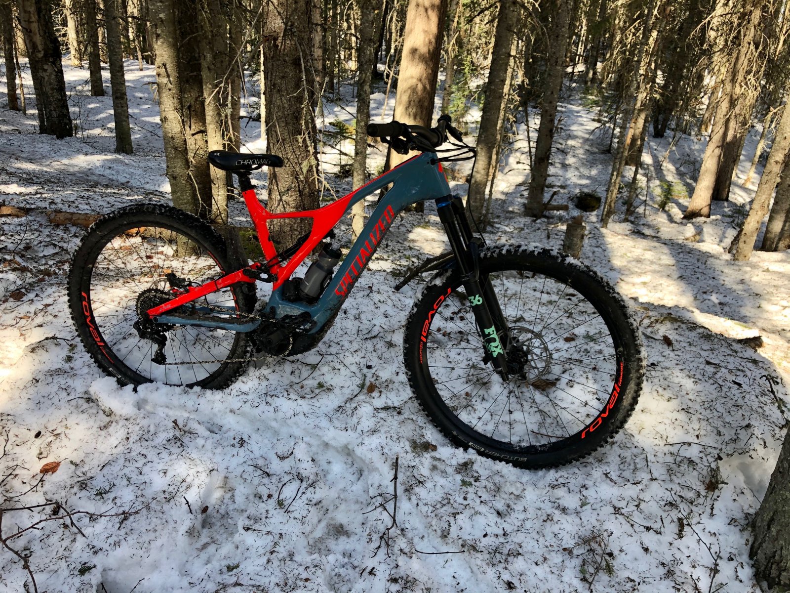

This is the start of my Custom Enduro Turbo Levo Build
-2019 Specialized Turbo Levo Expert
-2020 Fox 36 Float 160mm 44mm offset
-One Up Carbon 35mm Rise Handlebars
-One Up 35mm EDC Stem
-Maxxis Minion DHF 2.5 Front
-Maxxis DHR2 2.3 Rear
-One Up EDC Stem Tool Kit

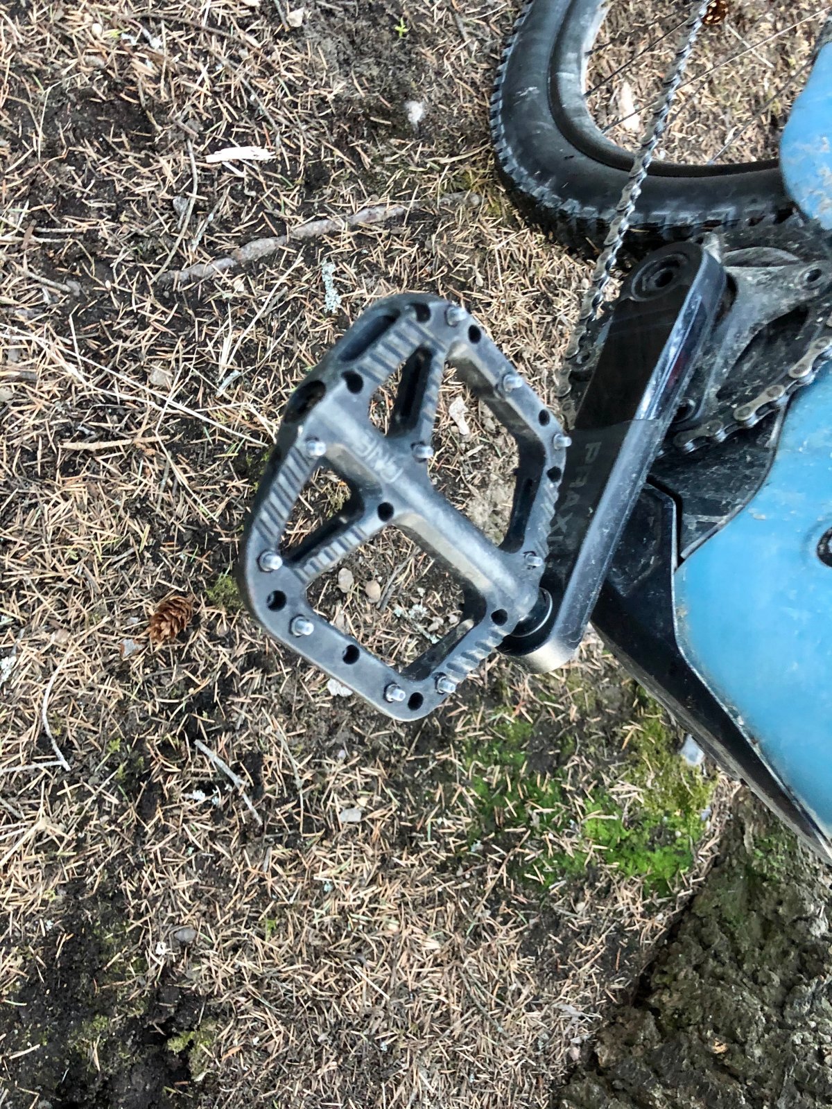

-One Up Plastic Pedals

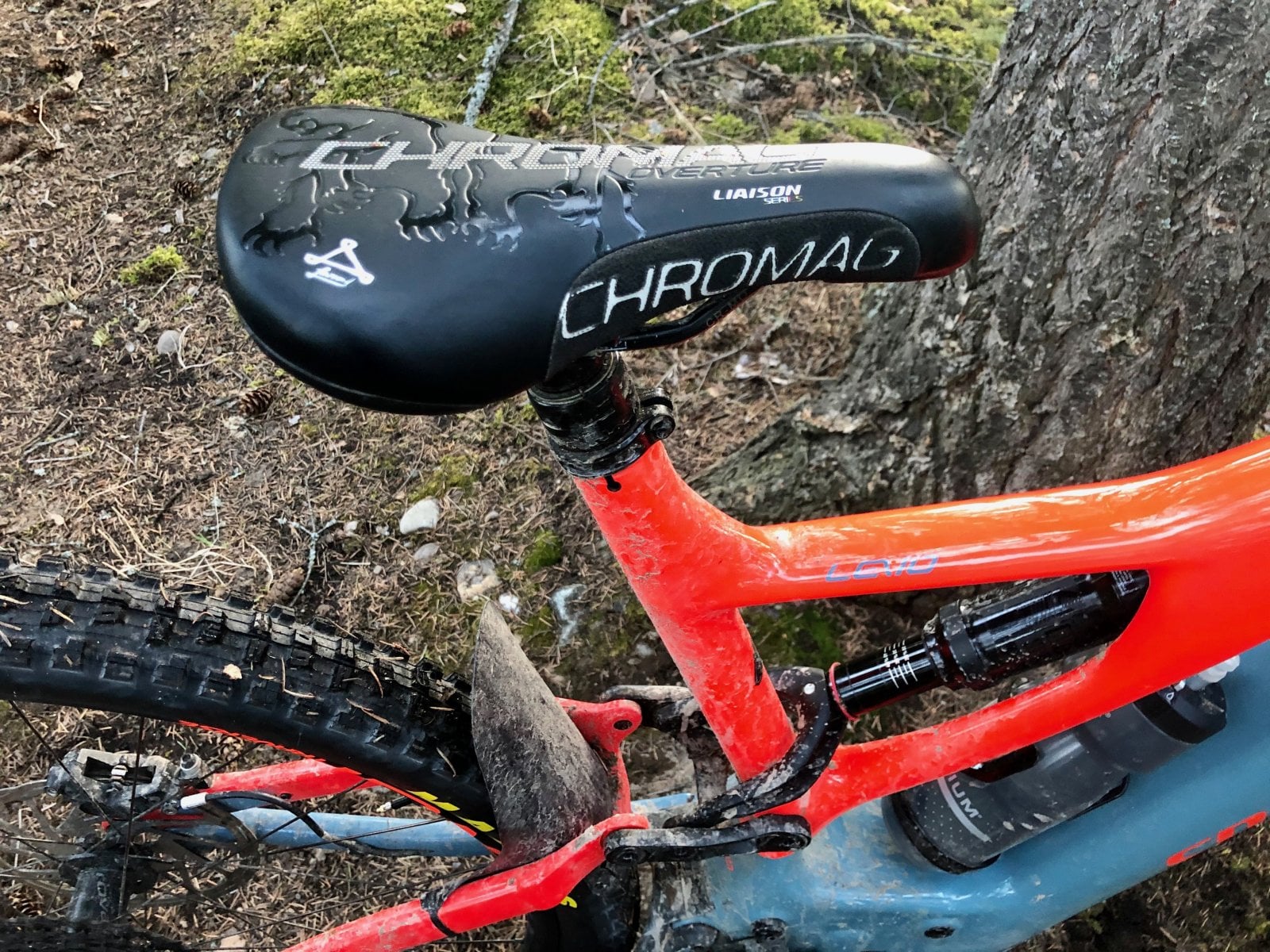

-Chromag Overture Seat
-DMR Death Grips
-Lezyne CO2 Canister (Under the Seat)

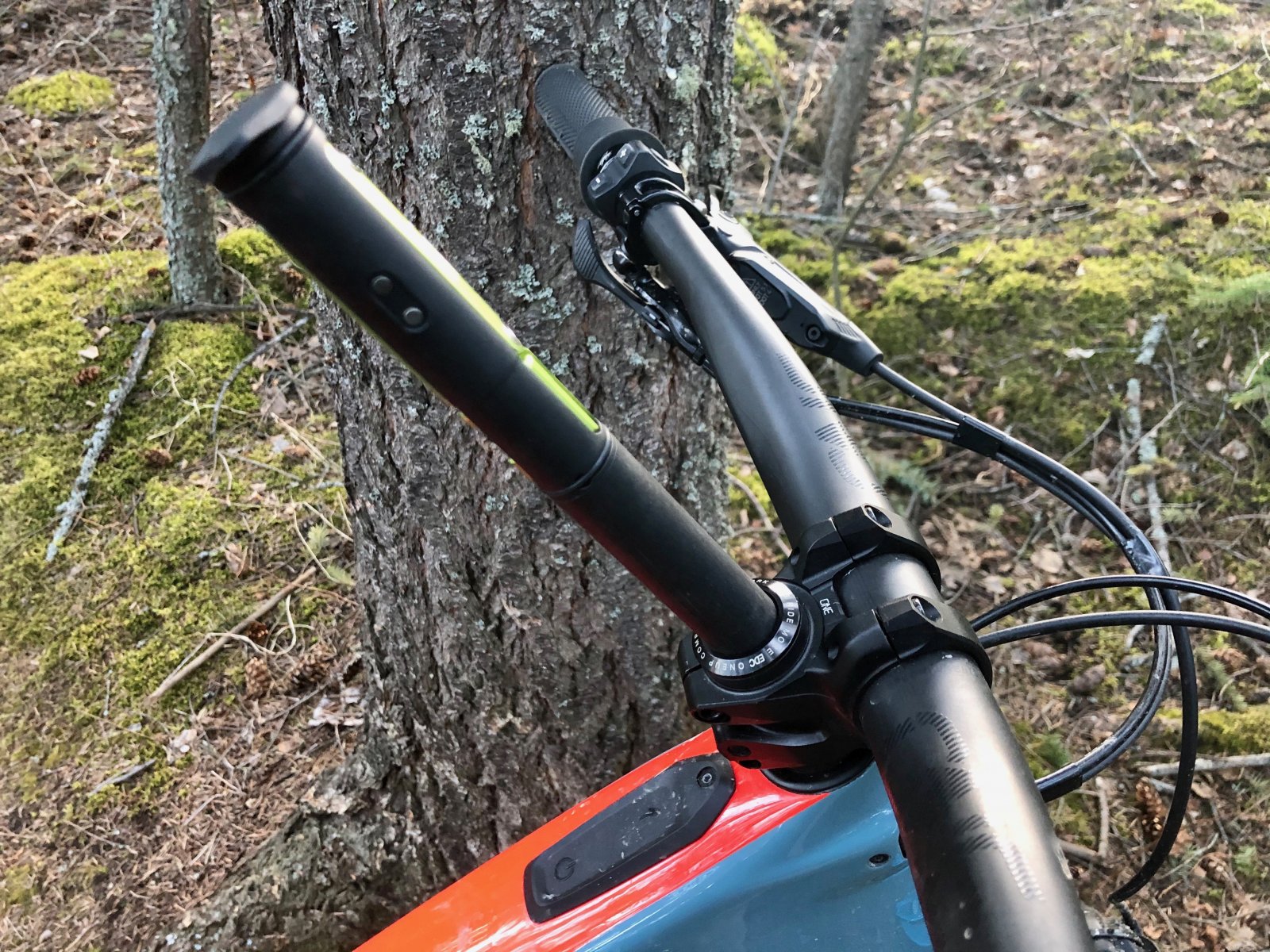

Next up will be a OneUp Dropper, Carbon wheels and Shimano Xt 4 piston Brakes

I love that color scheme.
I have yet to see one in person that actually looks that way though.
In person, the bluegray just looks basic gray. And the blazing redorange looks... Not as vibrant.
How is yours in person?
Tthibault16
Mar 31, 2020
11
15
British Columbia

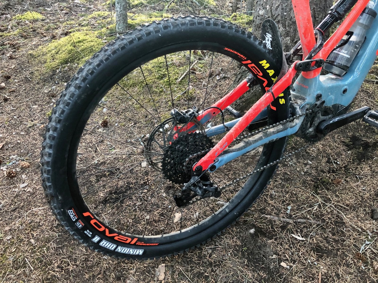

These picture show what the paint looks like in person
Some light it looks grey and some it looks grey/blue and the orange is vibrant.

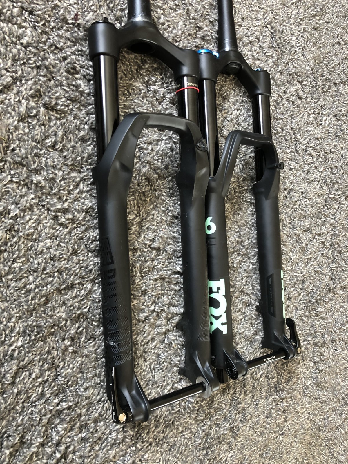

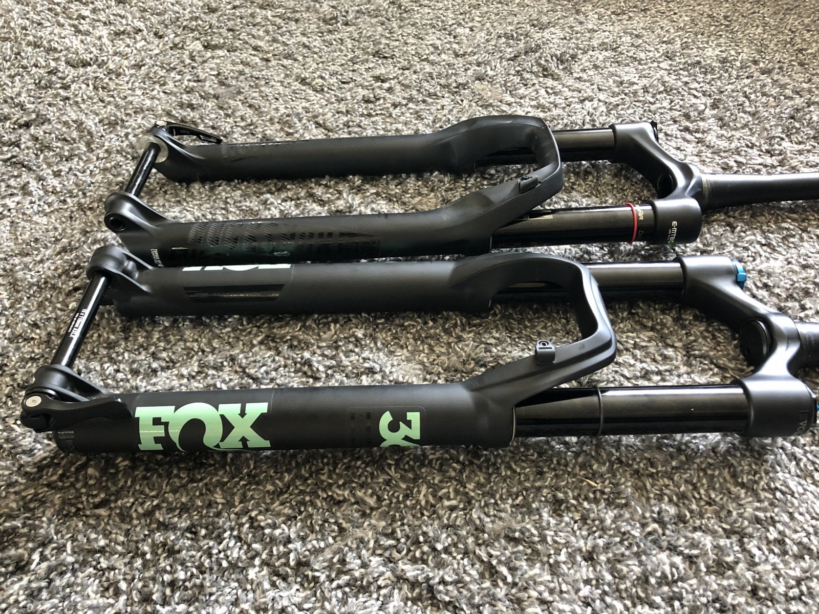

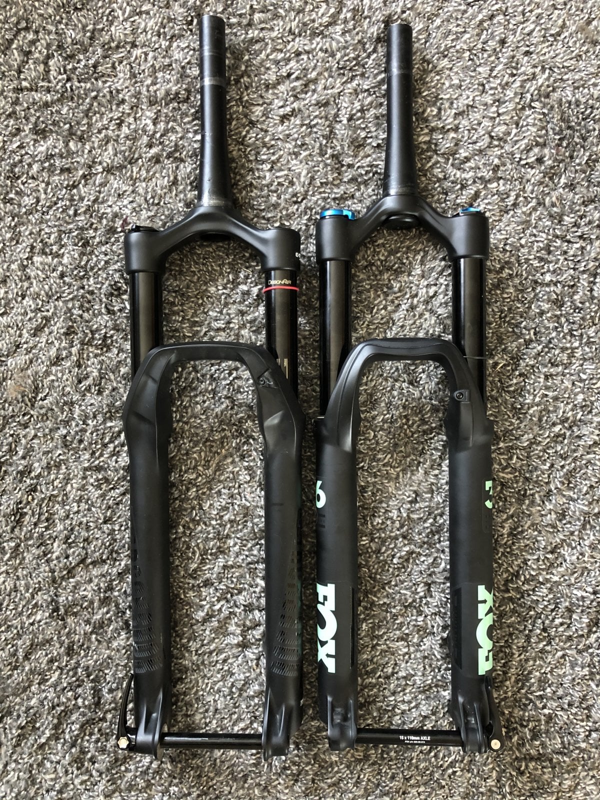

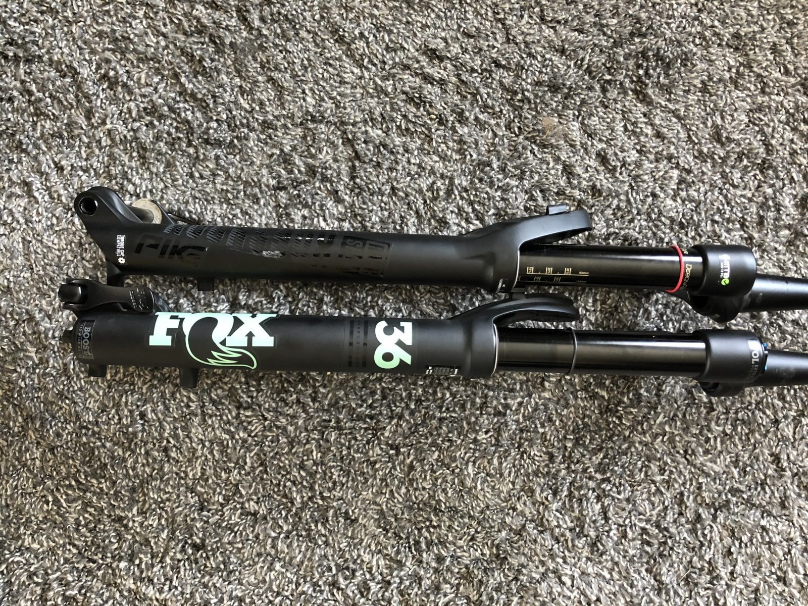

Nice build! Have some ideas of building something similar. Seems many keep the same offset even with the 160 fork. Would love to hear how u find em?
Tthibault16
Mar 31, 2020
11
15
British Columbia
The fork offset feeling is so minimal only the top 10% of people will notice a difference.
I changed from 52mm to 44mm offset to shorten the wheelbase to compensate for the the extra 15mm of fork length.
The 160mm fox 36 made the bike feel bigger and more capable, the best upgrade for sure.

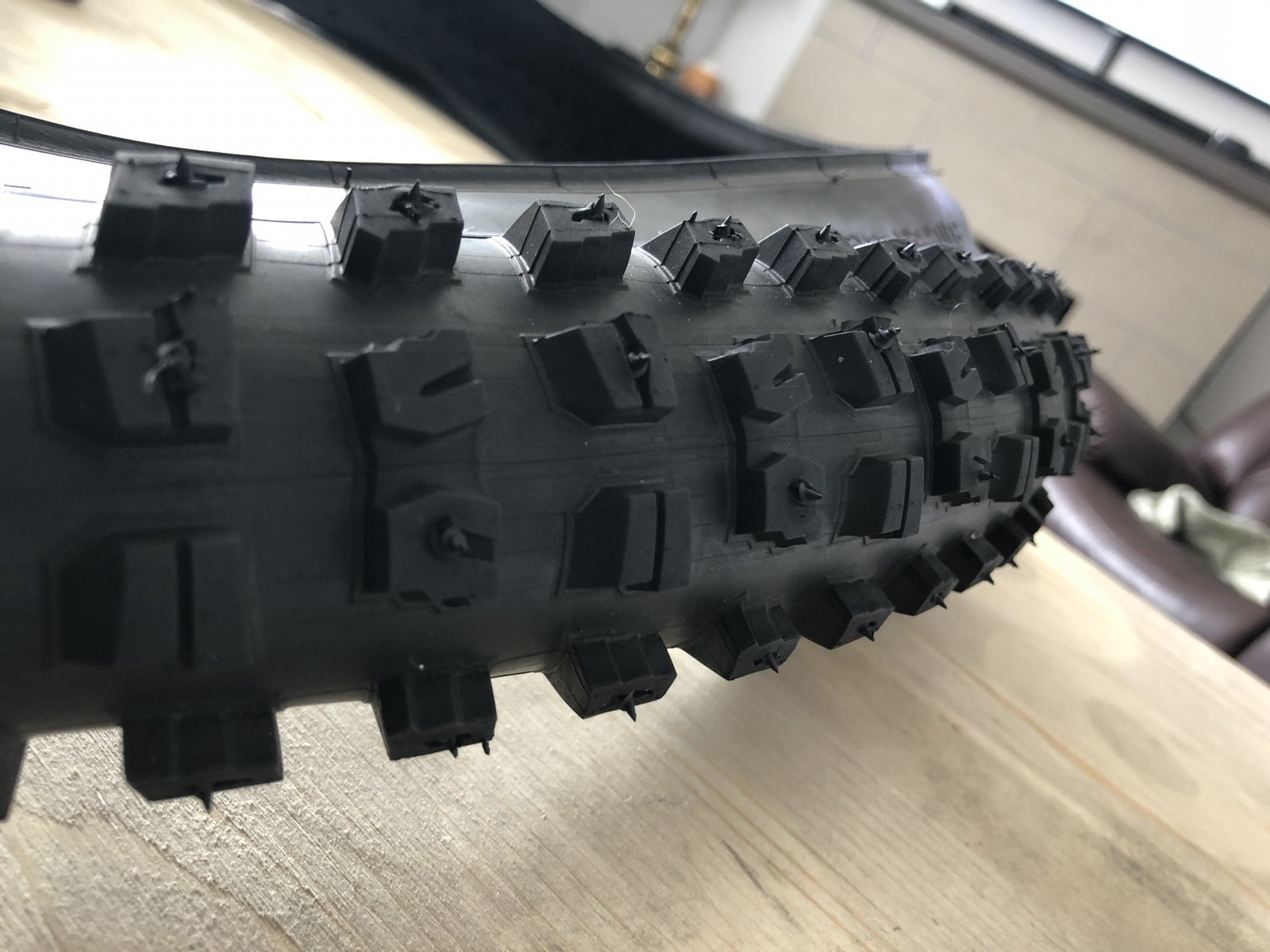

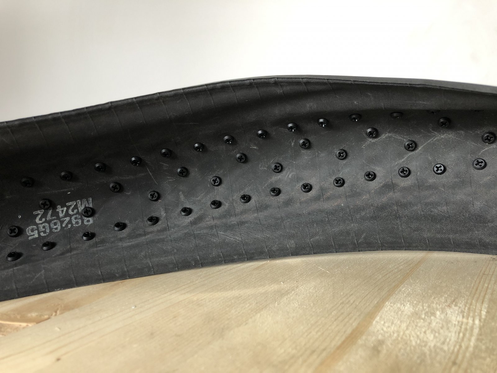

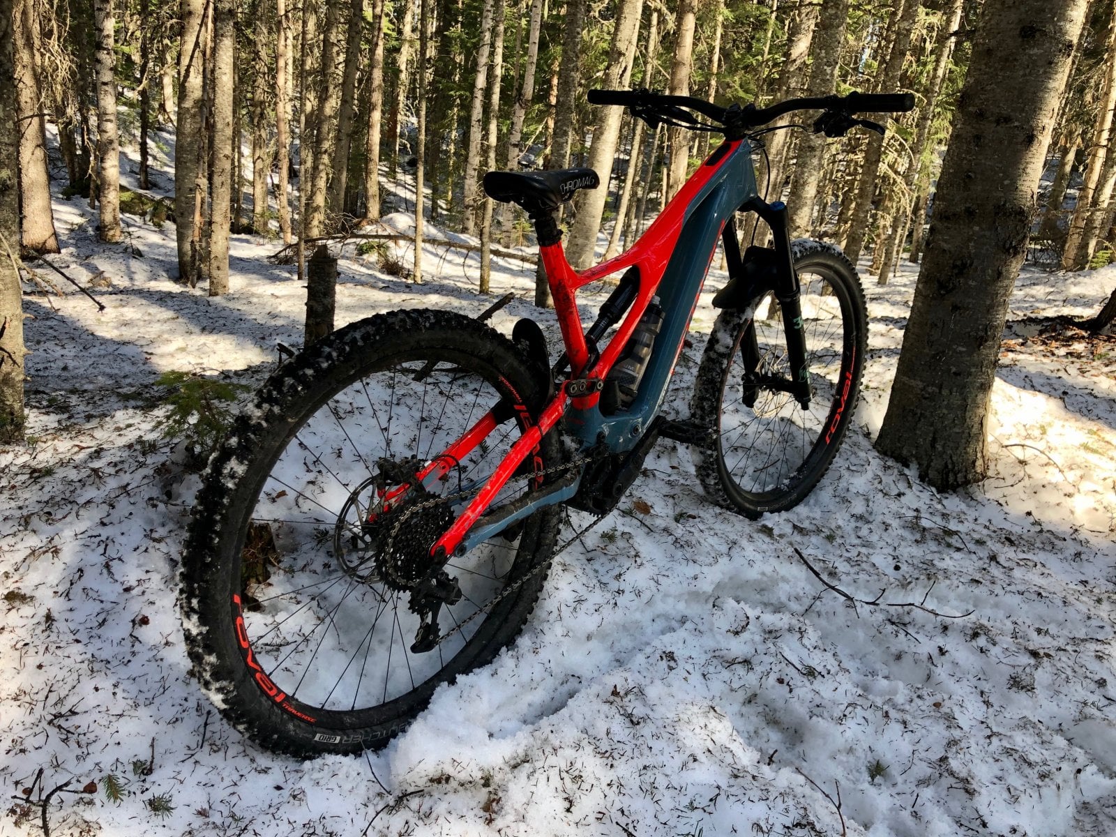

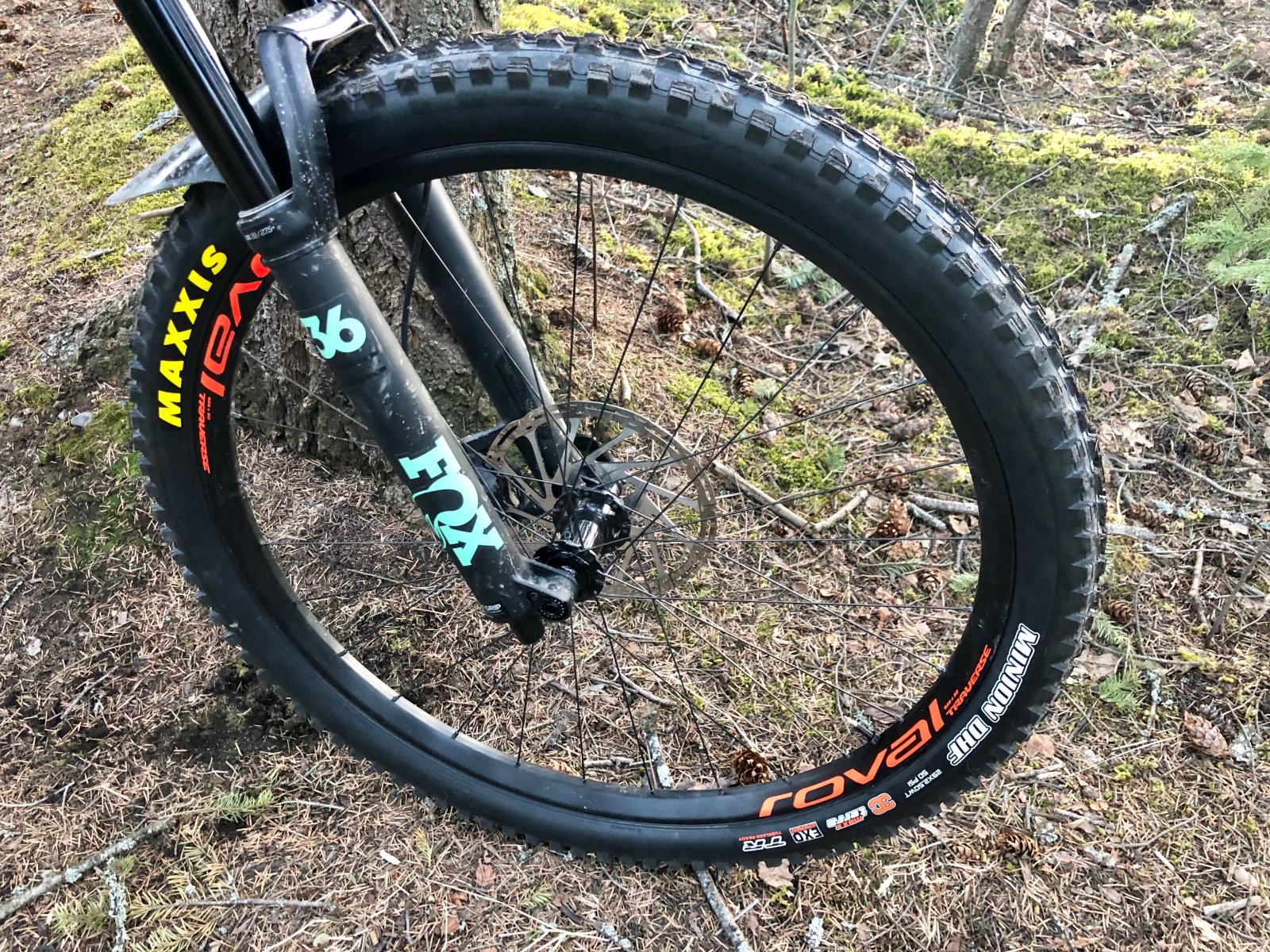

4-5 months of snow/ice in Northern British Columbia Canada, so I took some time while it was -35 degrees Celsius and made my own studded tires.
Worked amazing for 2 months of riding (now are off for summer) and could stop on the ice just like the dirt in the summer.
Stock 29x2.6 Butcher Grids with 7/16” pan head screws
