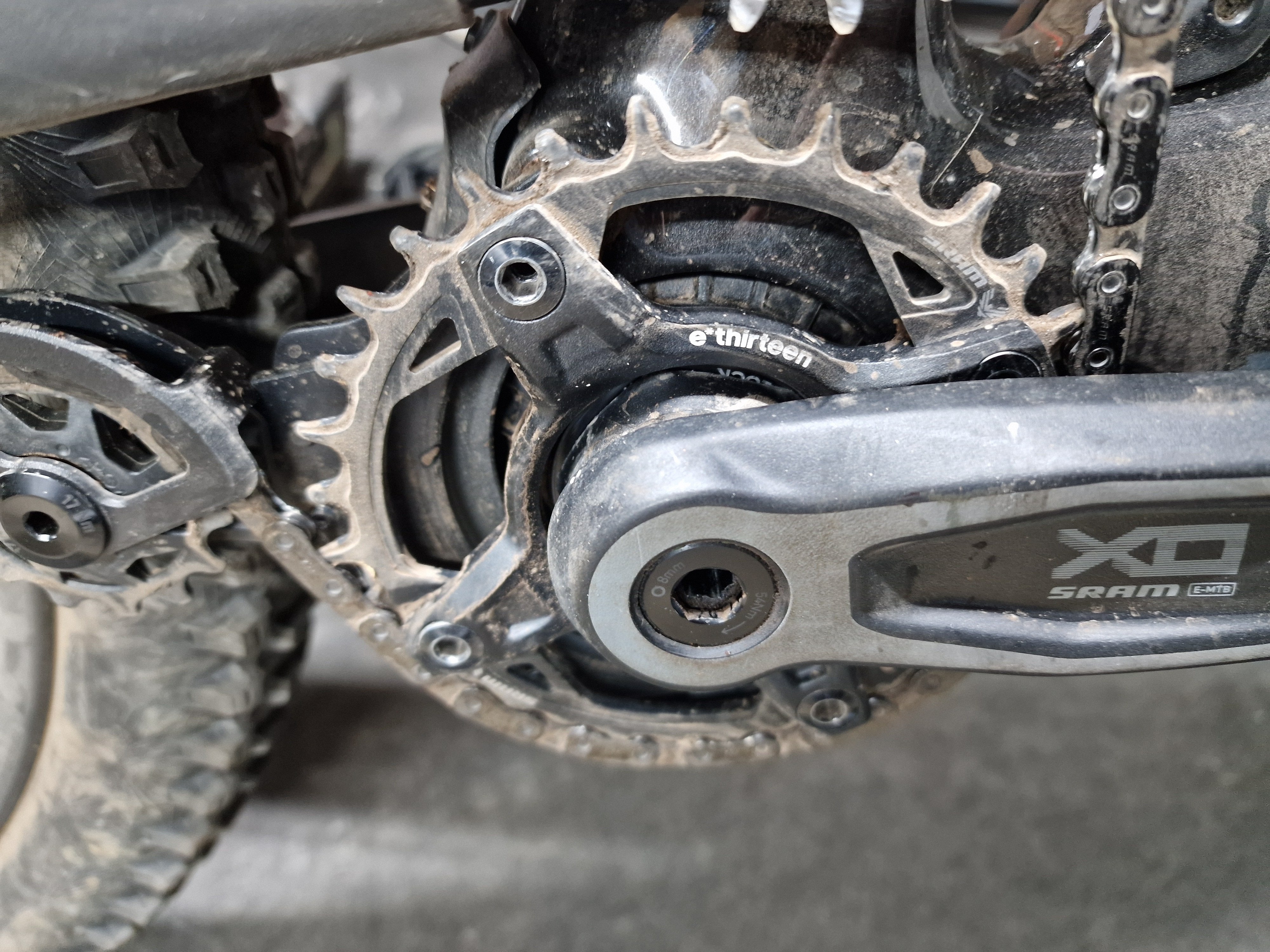

'Bottom bracket' noise
After a few hours riding I noticed quite a lot of 'bottom bracket'-like noise under big efforts uphill.
I don't (yet) own a 50Nm torque wrench, so couldn't do much. Took it back to the LBS this morning (I didn't notice any noise riding the few km) and described the issue. Mechanic said he hadn't come across this yet, but the shop barely has any mountain bikes, so I wasn't that surprised. I respectfully gave him a link to this thread, which he was happy to accept (don't now if he actually used it).
Bike was ready a few hours later. He said he regreased and tightened to spec the crank arms and the bit that connects to the motor, but said in particular that the two motor mount bolts on the non-drive side were quite loose. So he's pretty sure that they were the culprit.
I haven't tested it yet, but he seemed very confident, and thankfully those bolts are only 20Nm, so my existing torque wrench will work for them should I get a reoccurrence in the future.
Like this?
If it is like this then the culprit is the crank skirt (Sram Cover Cap 11.6118.072.001) I ended up removing the plastic skirt on the crank arm as I could not get rid of the noise no matter what I did. I tried grease, lubricant and even wax to try prevent it, but always came back as soon as I back peddled when there was dirt around that skirt (mainly a problem in the wet). Not great, but the TQ lockring has a rubber oring on it to prevent dirt and water ingress to the motor bearing which is better than nothing.
I also had:
Loose motor bolts
Loose crank arms
Loose lockring
Motor compensation bolts were not setup properly (Suggest you read the TQ manual)
Nothing was greased properly

Like this?
Can't be sure, but I wouldn't say so. I certainly couldn't recreate any noise simply by stomping on my pedals with the brakes on. But there was a consistent noise every crank revolution when I was pushing hard uphill unassisted.
Loose motor bolts
The shop mechanic reckoned this was the culprit. He said they were considerably below the torque spec. He seems convinced he has solved the problem, and I certainly didn't detect any noise riding it home. Will only get a suggestion in a couple of weeks when I'm pedalling uphill in anger how long-term the fix is.

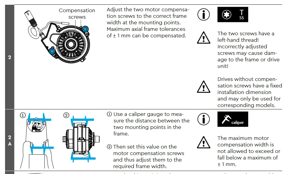

What exactly are you referring to here? When I search the service manual I can't find any reference to 'compensation'. Do you simply mean the connection bolts (M8 x 76.5 mm — 5289570) that go through the frame from the non-drive side, and screw into the chain guard on the drive side?
I assume the HPR60 is the same as the 50, but here:
Page 15.
edit to add, mine were not setup properly and one of them seized, they are made from cheese so are easy to round off.
TQ support said I should warranty it, but the idiots I bought my bike from had a spare one laying around amazingly and replaced it for me.
Ah thanks. I was looking at the completely wrong service manual!
I will hunt down the HPR60 manual from TQ now…
EDIT: Yep, it has the same. No idea if they were setup correctly. I'm going to leave the motor in the frame for the time being, but will pull it out and have a look at the first hint of more creaking. Thanks!
