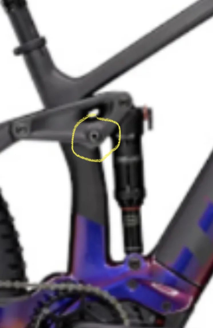

Hi, currently trying to replace the two seat stay bearings that connect the rocker arm to the frame. Have bearing pullers and even a bearing pro bearing puller and the bearing doenst want to come out at all. Any idea? Thanks
Do you mean the bearings on the Mino links? (ie that connect the rocker arm to the seat stays) Or the main rocker pivot bearings that fit onto the seat tube?
I've just replaced the Mino link bearings using a bolt and washers and a 20mm socket (I don't have a bearing puller!). Mine came out no problem with a bit of WD40 sprayed into the bearing seat first. Are you having the same problem on both sides? If so, it might suggest a problem with the fit/action of the puller rather than being unlucky and having two equally stuck bearings. Good luck!
these two bearings behind the rocker on the main frame that are half way down from the top of the seat tube. Tried everything so far and they won’t budge…will have to try freeze spray maybe that will work don’t think the bearings have been replace d since new so might be a little corroded 😴
It's a bit of a brute force then really mate. On the rail once you remove the bolts there's nothing stopping the bearing coming out other than the friction between the surfaces.
I go in from the opposite side and drift (smack) the opposing bearing out usually. YES it can feel pretty bloody brutal.
