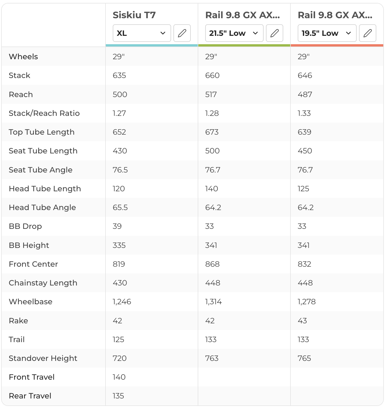

Had the chance to get in store yesterday, but unfortunately they only had a large in the Rail9Gen3 and a medium in the 9.8. So both obviously not suitable sizing for me. I was hoping to try an XL in the 9 and both L and XL in the 9.8.
I am definitely favouring the 9.8 for the extra $1500 AUD but the guy I was chatting to was almost certain that for my size the XL would be better (6'4" and inseam of 35 inches). So I don't know how to compare these two sizes as best for me. The longer reach (517) and wheelbase (1314) feels like it might be a bit hard to manoeuvre around techy terrain.
I have attached a comparison of L and XL and my T7 as that is what I am familiar with and have not other comparison.
Any thoughts?

I’m 5’11” on a medium 9.8 (460 reach) do you know your favoured reach numbers? If not the only way to tell is riding the bikes. Most people size down as I feel (49x reach) would be plenty?
The stack, reach and top tube length are all WAY longer on the XL Rail

Thanks for the reply,
I have only ever ridden my T7 and its impossible to get demo bikes here so I haven't explored a range of different bikes/geo.
According to Trek's sizing you would be a L, so how do you find the M?
My gut feeling says the L will be spot on. The store have also offered to get the other size in if I'm not happy with original choice.
It took me about a year to find the “sweet-spot” for the type of riding in my area. My medium Rail is likely not suitable as a commuter because I don’t ride paved roads. The trails around here can be technical and sometimes steep.
I originally settled for a M Rail 9.7 and slowly added upgrades and tweaked the geometry to suit my needs.
When I added the Fuel EXE 8 I did the same. When I sit on each bike and close my eyes …I can’t tell the difference, but once you start moving, or throwing the bike around, the difference is apparent. The wheel base is about 1/2” shorter on the fuel and that may add to its agility on the trails.
Another rider, same height as me, now regrets having a L Rail. His solution is to slightly reduce the geometry …but a medium sized bike could have made these tweaks a little easier. His bike would be great as a commuter …but not a techy trail bike.

I think the L would be perfect for you. I don’t pay attention to “recommended sizing” I like 460mm reach so that’s what I went for. My DH bike is 470, but for trail riding and some bike park I’m happy as with the medium.

I have ordered the XL.
Few reasons: My current bike is 500mm reach and it definitely doesn't feel big for me, the 9.8 L is 491. Whilst a few comments from youtube reviews suggested downsizing, generally these riders are way more competent than me and can 'handle/manoeuvre' the bike with more ability. Once I started reading from a lot more riders who were probably at my level, they seemed very confident and happy with the choice of XL - or other appropriate size without downsizing.
I rode the L around a nearby park and felt I had room to extend my arms and when I was standing and leaning around the bike I thought I wouldn't mind the extra wheelbase and stretch on steeper stuff - On my current bike I basically wipe my arse with the back tyre on anything steep for fear of flying over the front.
I get analysis paralysis with anything I do, but at the end of the day, I know I would have a bloody great time on either. The trek store also offer a 30 day return if I am really not comfortable and feel oversized.
