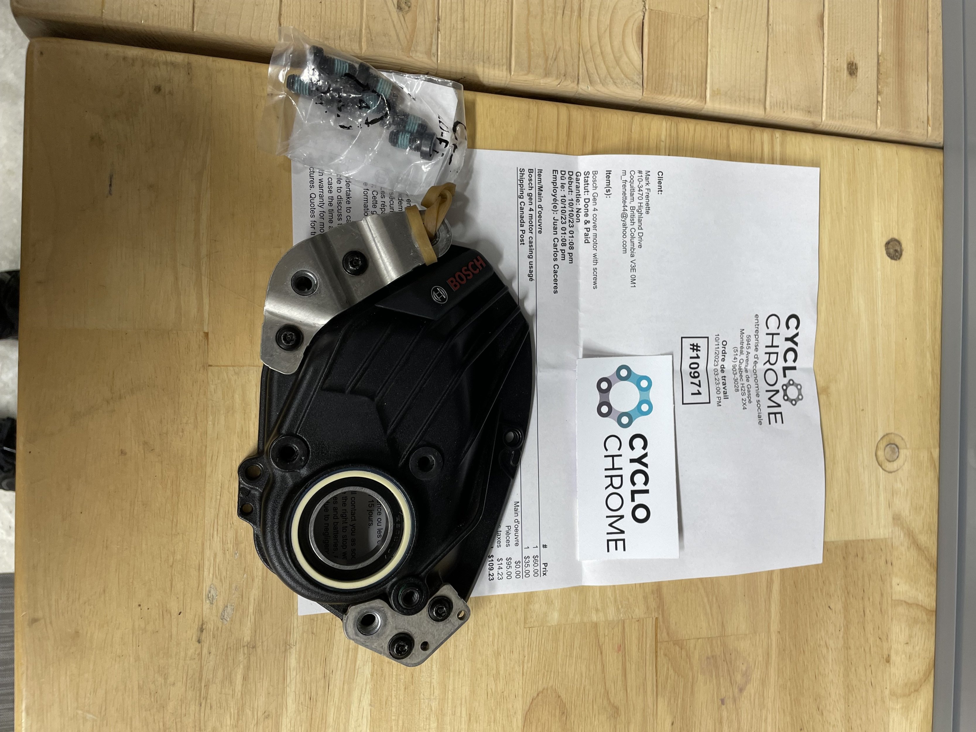

My 2020 Rail 9.7 had a creaking noise for some time. The creaking was minor at first but got progressively worse to the point others riding near me could hear it. I had taken all the pivot points apart and cleaned and retorqued them and cleaned seat post but still did not fix the creaking noise. Finally the only thing left was the motor mounting. I had noticed while holding the brake and stepping on the crank that the motor had a slight movement to it. I removed the motor and found the bolts for the motor mounting bracket were loose and one had broken off. I was able to remove the broken bolt. For some reason Bosch had installed them with tamper proof bolt heads and did not have any lock-tite on them. I removed the other 3 loose bolts and installed 4 new M5-18 X 16mm bolts with regular allen heads. Installed them with lock-tite blue and torqued them to 6 nm. Reinstalled them motor and have 2 rides for 40 miles and not more creaking. Bracket shown in the attachment.

A replacement motor can be expensive. For my neighbour the only option, at the time, was for him was to replace the Bosch CX motor after some bracket screws had sheathed off. (Drive-side). Removing the broken bolts/screws from the magnesium casing was impossible without damaging the threads. The slight movement of the bracket had also caused the small mounting holes to become oval. @Bearing Man helped me navigate thru the logistics of repairs and delivery.
Apparently is easy for anyone living in the EU. He provided the name of a service centre in Gaspe, Quebec Canada. Cyclo Chrome. Their response to my emails were fast and delivery took a few days (week?). After following a few instructions I was able to assemble a spare motor.
At this time I also realized the importance of a bearing seal kit for the Bosch motor.
The final price was very reasonable. I’ve forwarded this information to a few other riders whose Bosch motors have failed after the warranty has expired. I’m not sure if there is a service centre in the US.
