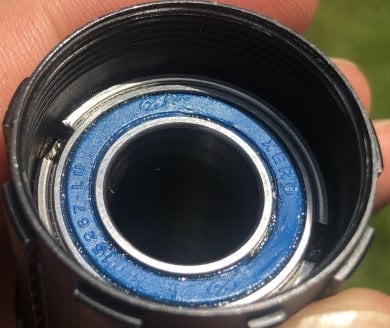

Driverside: Xero 15267 LU 15x26x7mm
Non-Driverside: Xero 6902-LU 15x28x7
The inner diameter is 29,5mm if you want to build your own tool from socket.

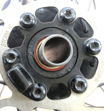

Play:

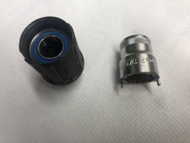

Made a tool from 21mm socket

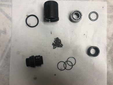

This is what's inside. 3 shims: 2 thins + 1 thick.

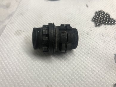

The freewheel pawls. Seems to be ok
