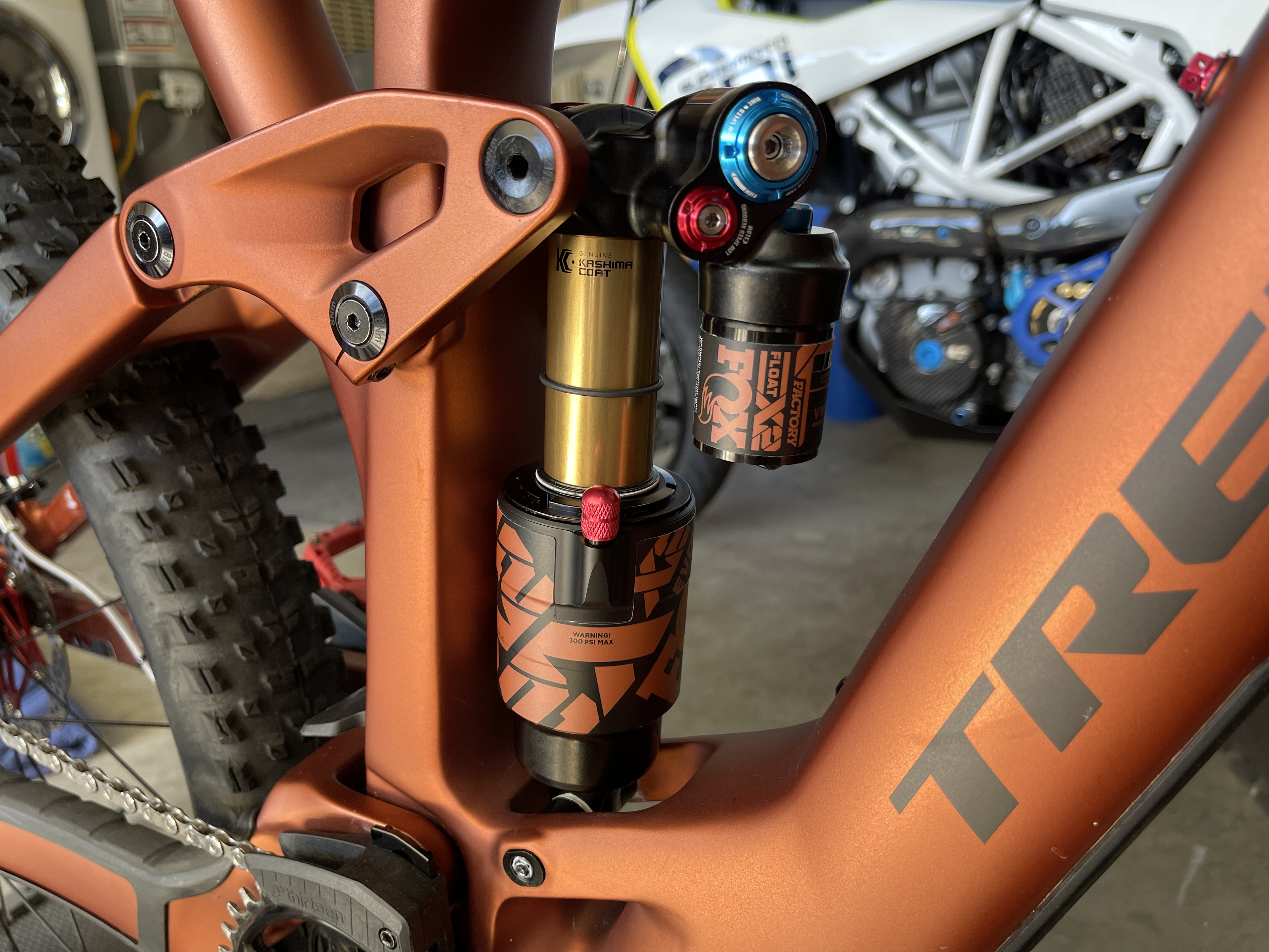

For what it’s worth, I cannot find a fault with the new 2024 Fox X2 @ 62.5mm stroke. The recommended settings for the psi needed for 30% sag are very accurate. The only thing I changed was to add 2 clicks of LSC. I use about 90% of the travel on a typical ride, which I’m ok with. That leaves a little extra for that rare big hit. Like the one I took when I broke 5 ribs on New Years Day. Yeah, I won’t be ridding for a while. 🤦🏼‍♂️

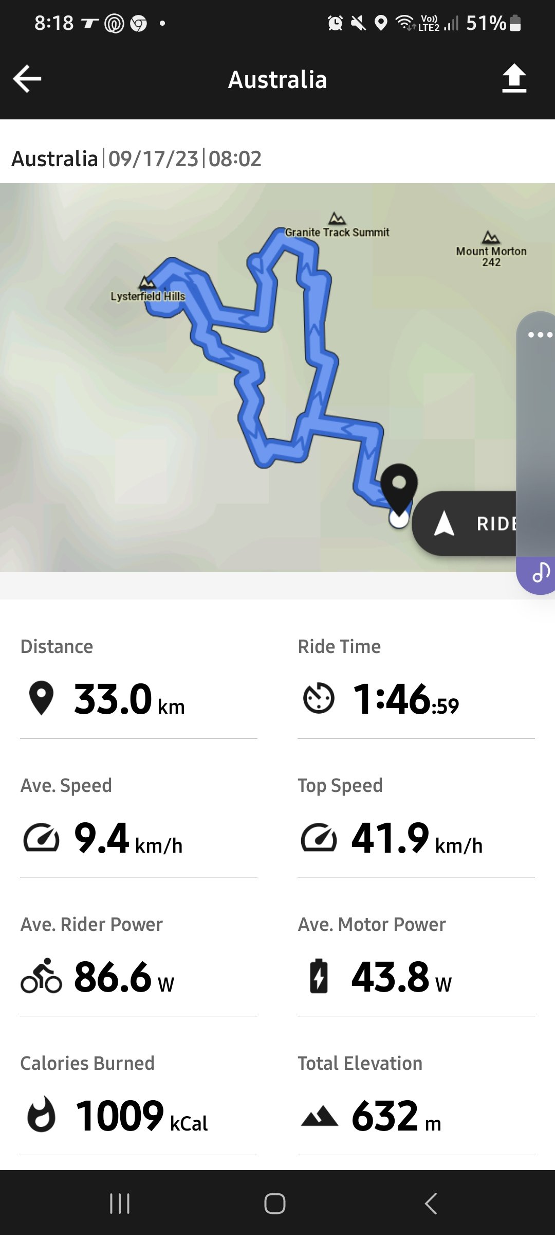

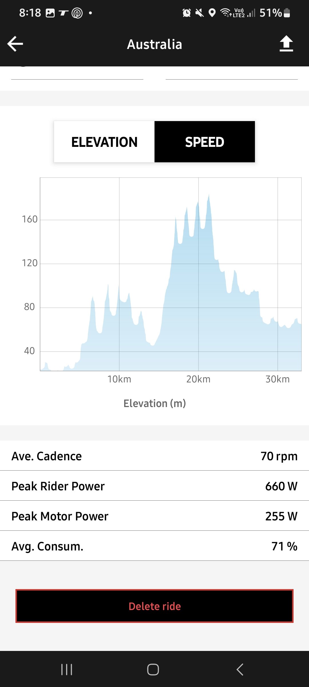

Can you show us a screen shot of one of your longer but typical rides. I’d like to see how much power you are putting in compared to how much power the bike is putting in. There are some things you can do to get better range. If you strike a really good balance between your power, proper power settings and cadence, you can get a lot more range. And, Eco doesn’t always get you the furthest distance. The higher powers take more electricity. But, you are also covering ground a lot faster.
I absolutely do get and understand that as soon as you've bought a bike, the technology will get surpassed. It's inherent in the game. My situation and preferences are for the bike to be set up as it is, and to compensate for the compromises I've bought an additional battery. This is not ideal but very workable I'm finding.
Would bringing the bike back to stock improve the range? I'm not sure or convinced, and I prefer how it rides currently so I'm unlikely to change anything back.
Regarding tracking rides, I've not done that in a while as I'm not fussed about the data.
After a look in the app here's as recent an example as I can find.
Screenshot_20240129_081824_Trek Central.jpg Screenshot_20240129_081832_Trek Central.jpg
You’re definitely putting in more power than the bike is. And yeah, the lighter it is the more range you’ll get. The EXe likes a high cadence. Anytime I’m going uphill I’m at 100 rpm or more. I know that seems fast, but you get used to it. Try a higher cadence and see if that helps you keep up with your friends. With two batteries maybe slide all the power settings to 300W with the Assist being different for all three modes. That way with a higher cadence you’ll get as much power as possible, based on the Assist percentage in whatever power mode you are in. I hope that makes sense.

That's a good question. I recall my Ohlins came with the Igus bushings like Fox uses, I had to swap those for a bronze DU bushing like RS uses for the shock hardware to fit correctly. I think my Ohlins was a new take-off so I'm not sure if they typically deliver with those Igus bushings.
Thanks, sounds good. I think I will take one, TTX1. Are there any special bushings needed for lower shock eye, or those from RS Seperdeluxe will fit?
I think you'll like it. I run mine at 65 stroke it is great.

Question for over strockers. Specially 9.7 fox float.
Any clearance issues on the Large frame with removing one or both spacers?
Is switching the mino link to high required?
