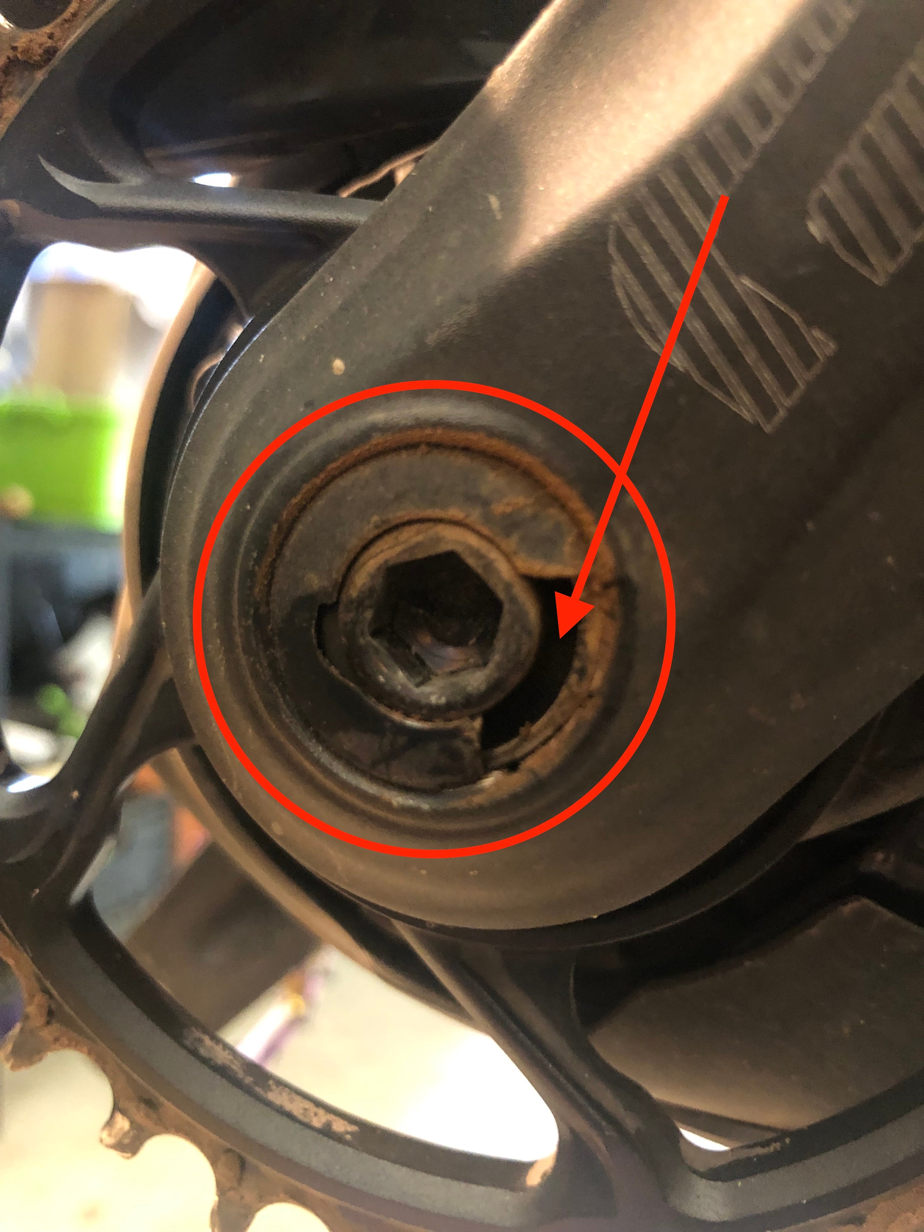

Hi all, if you see the attached photo, there's what seems to be a bit missing from the crank bolt from the chain ring side of the exe, maybe also a crack? I can't remember what it's meant to look like. Anyone else had this issue or can provide guidance? thank you
Nothing much to worry about there- the cracked piece is just plastic trim. You coud replace the crank-arm bolts if it bothers you- if you do, I'd look into self-extracting crank-arm bolts which come on the higher-end e13 cranks. You'll want to confirm their compatible.
