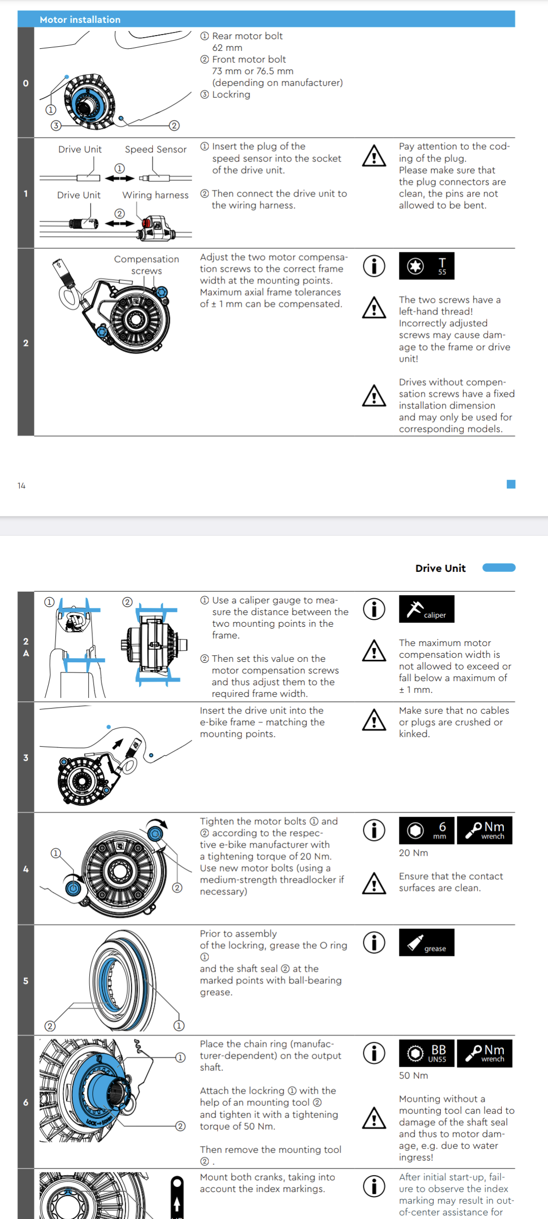

Check that the motor compensation screws (read the tq motor installation manual available on the tq website)are set to the correct width for the frame.
My trek fuel exe creaked and clicked until I did this,now it's silent.

Here you go. Steps 2,2a,3 and 4

I checked compensations screws they where to tight, i did as in service manual, put all back togather, clicking noise still there...no change. When i pedal with turned off noise is there also i can feel in pedals, when on, there is no noise...yes somene can say just turn it on and thats it...i dont agree bike for that money must function properly
Hi mate just wondering I thought you couldn't change the the motor mount width on the treks but you have ?? I've had that clicking noise coming and going since I brought it 8 months ago , Trek sent a new motor but it started doing the noise again after about 80ks , since then I've tried everything even had the spindle out there's nothing in the motor that could make that noise , then when i was putting the motor back in for the hundredth time I realised the motor was not a snug fit when i asked trek about adjusting the motor mounts they said trek made it so they aren't adjustable from factory ?? I can sometimes feel the clicking noise through my pedal into my foot as well did you feel that ??? Not only that problem but the thing is now cutting in and out of power 😠
Thats not correct, the motor mounts are adjustable for width, its not the mounts on the frame that are adjustable, but the width of the motor itself. Mine came set way too narrow and it creaked like an old bed, I set the width using some vernier calipers as per the tq motor installation guide, and the creaking was instantly fixed.
