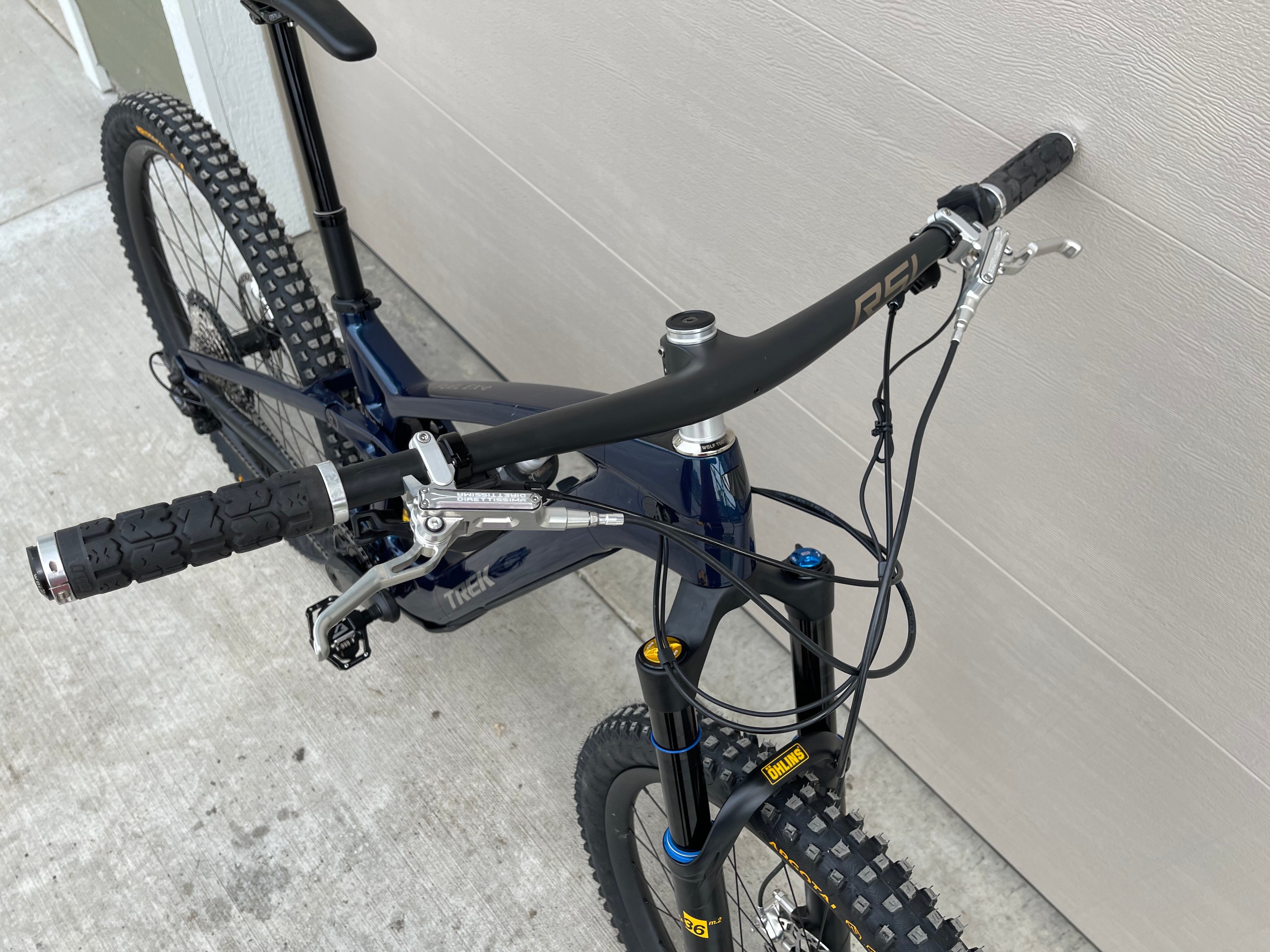

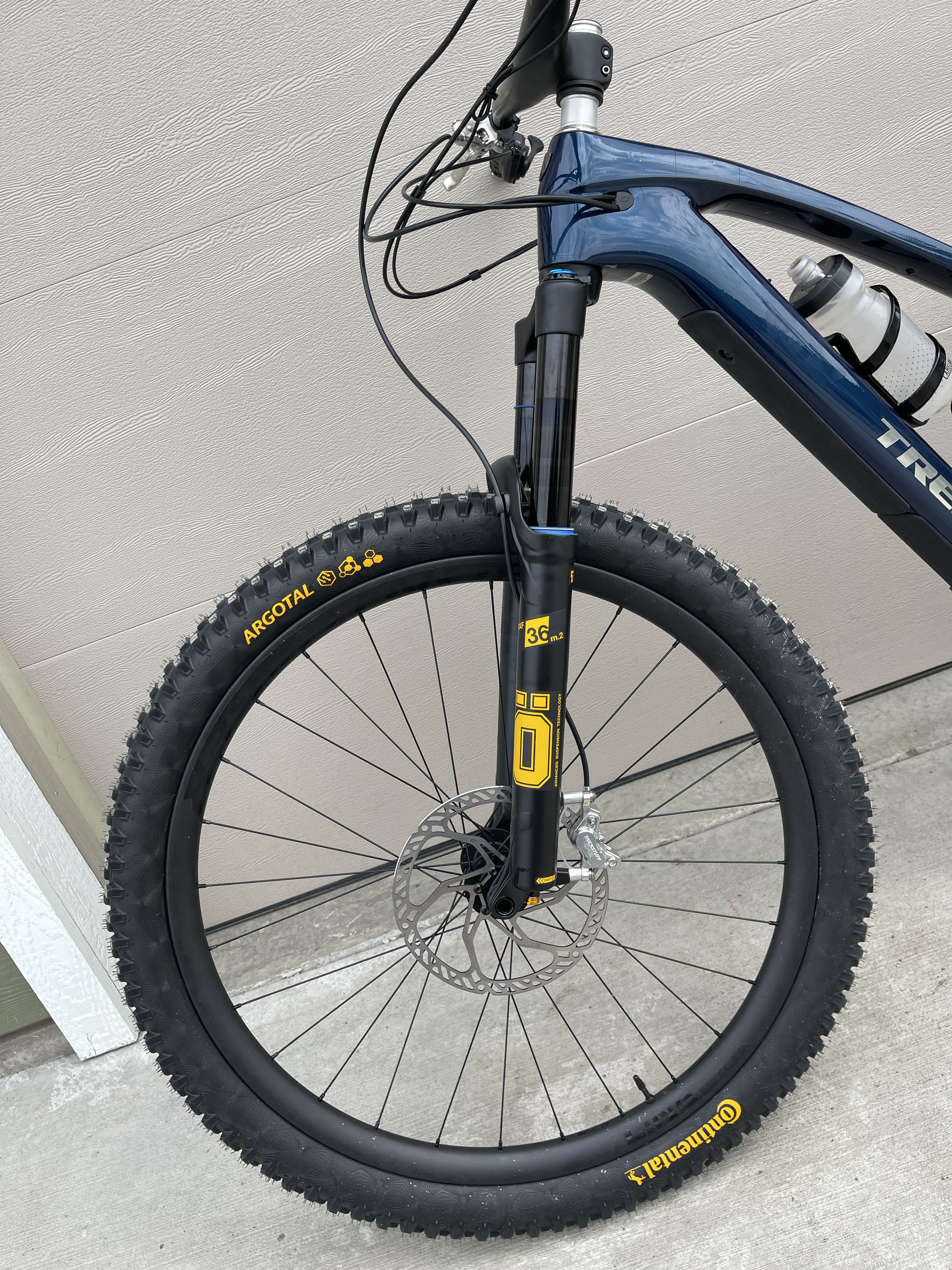

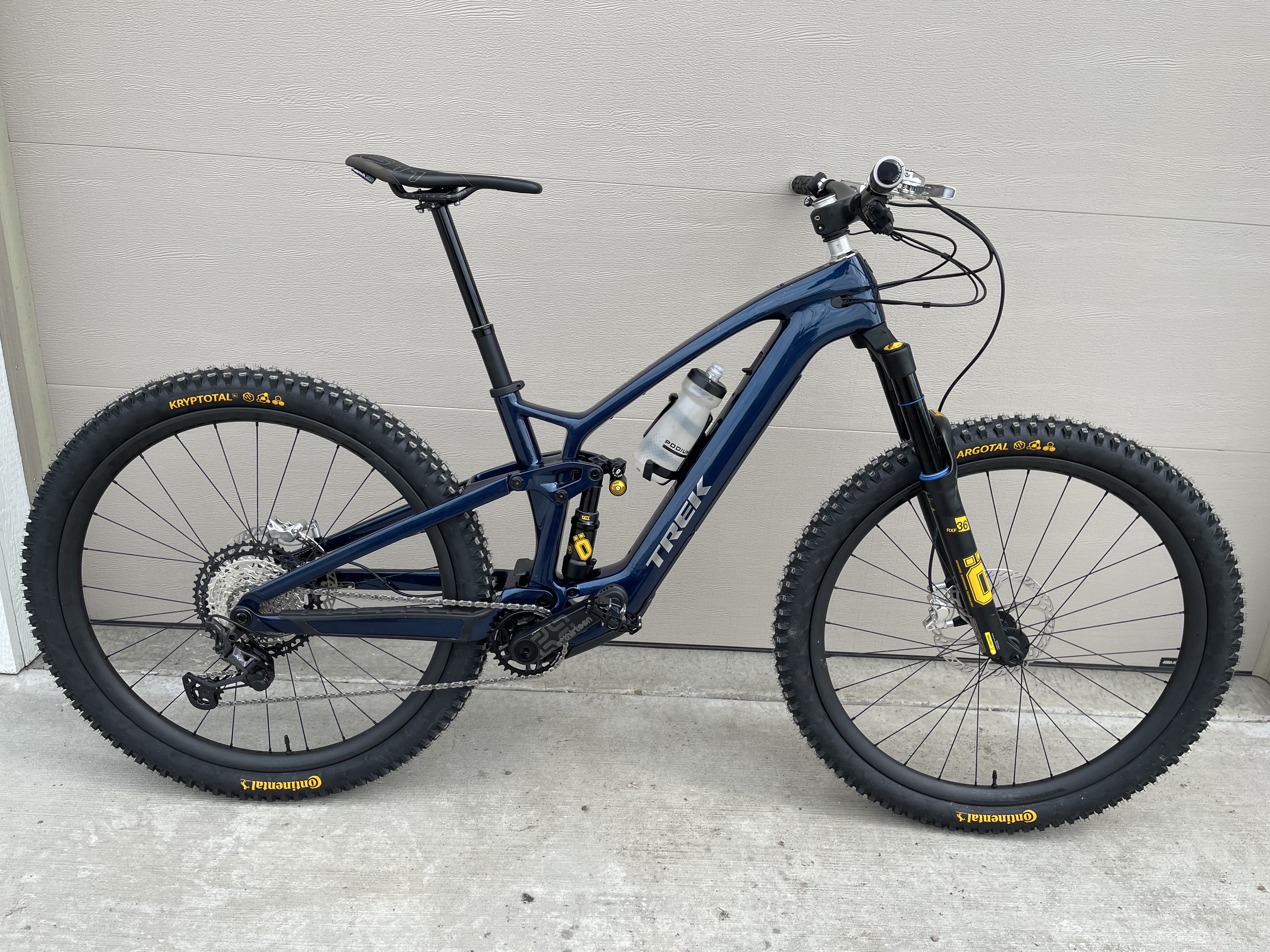

I got my 9.8XT EXE built up last week, ride wrapped it and swapped out some parts. Ohlins RXF36m2, TTX1, wolftooth post,lever,30 tooth chainring,headset dropper lever and some other small bits, an SQlab saddle,time pedals,conti tires and some trickstuff brakes and rotors. Still waiting for the new wheel set to show up.
After a few rides I am loving the bike (coming from a gen1 Levo SL) the bike is what I was hoping it would be being very poppy and playful. It has excelled on our fast flowy trails with jumps and side hits everywhere. I have found it it is just as easy to pop and get in the air as a non ebike.

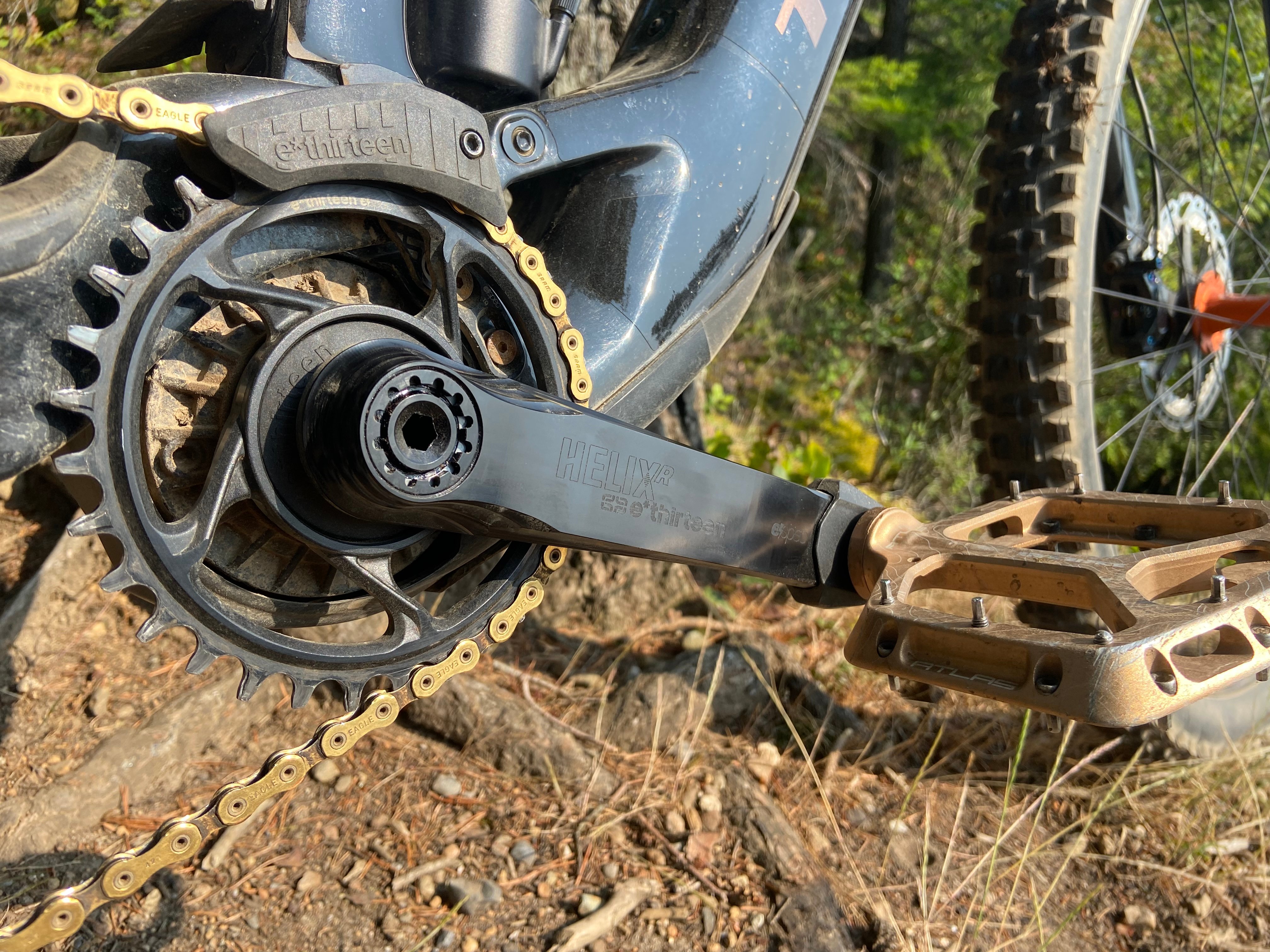

I have found that both of my crank arms have come loose after each ride, WTF? I will try loctite I guess. If that doesn’t work maybe some eewings or era crank arms.

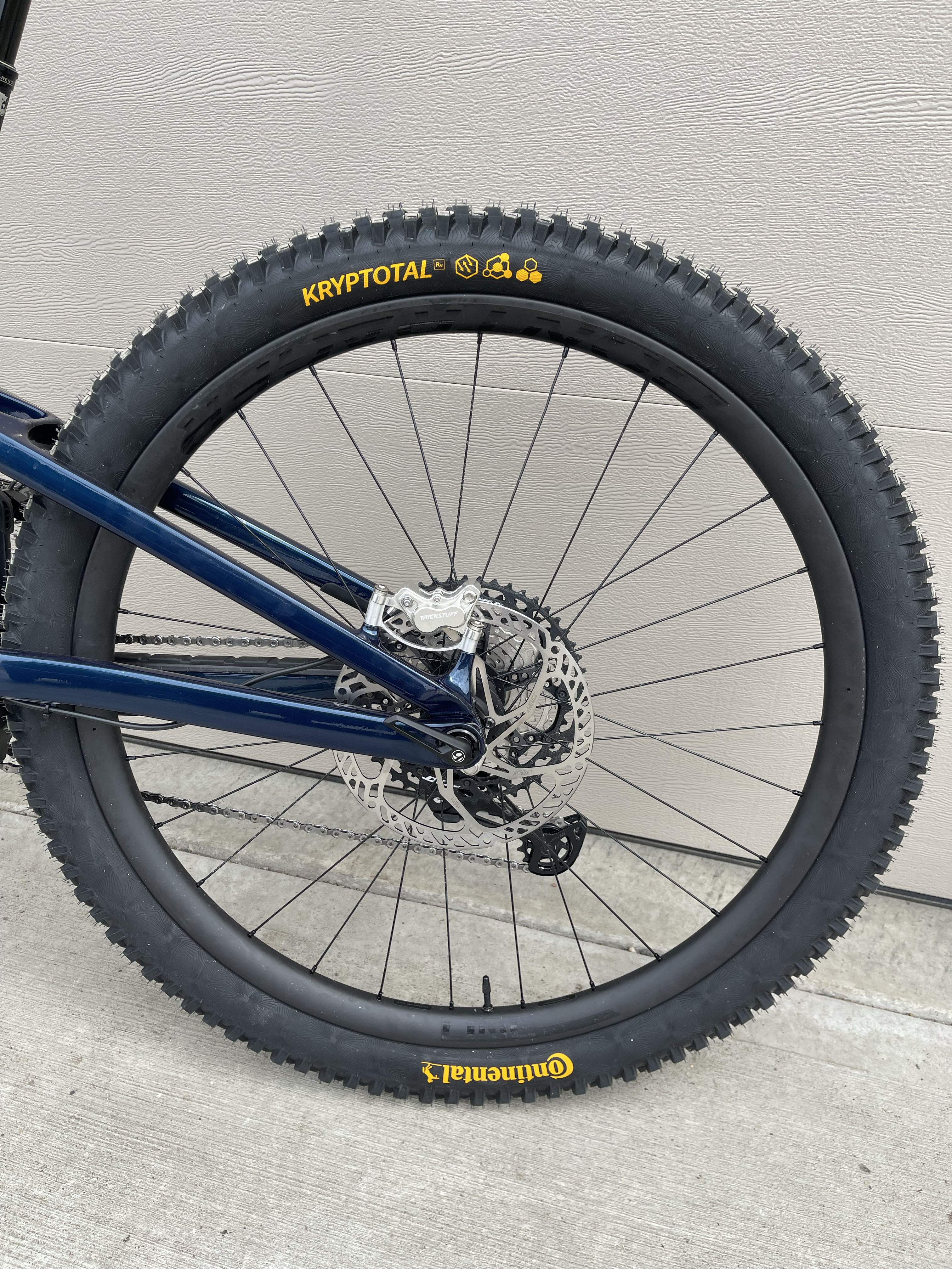

I'm thinking of putting a Krypto on my rear. 2.4 or 2.6? Was it easy to seat?

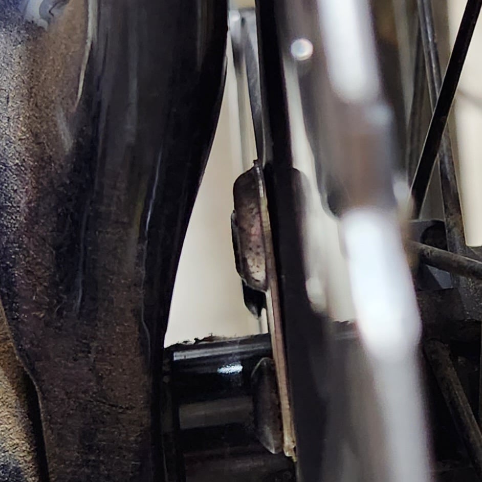

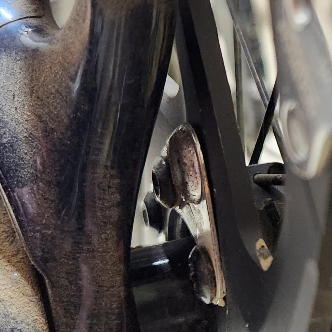

When I set up a Bontrager wheel, I found the oem magnet still required the use of the lock washer as a spacer.
Aluminum carrier is thicker that the flat stainless version. Worried that the magnet is too close to the frame.

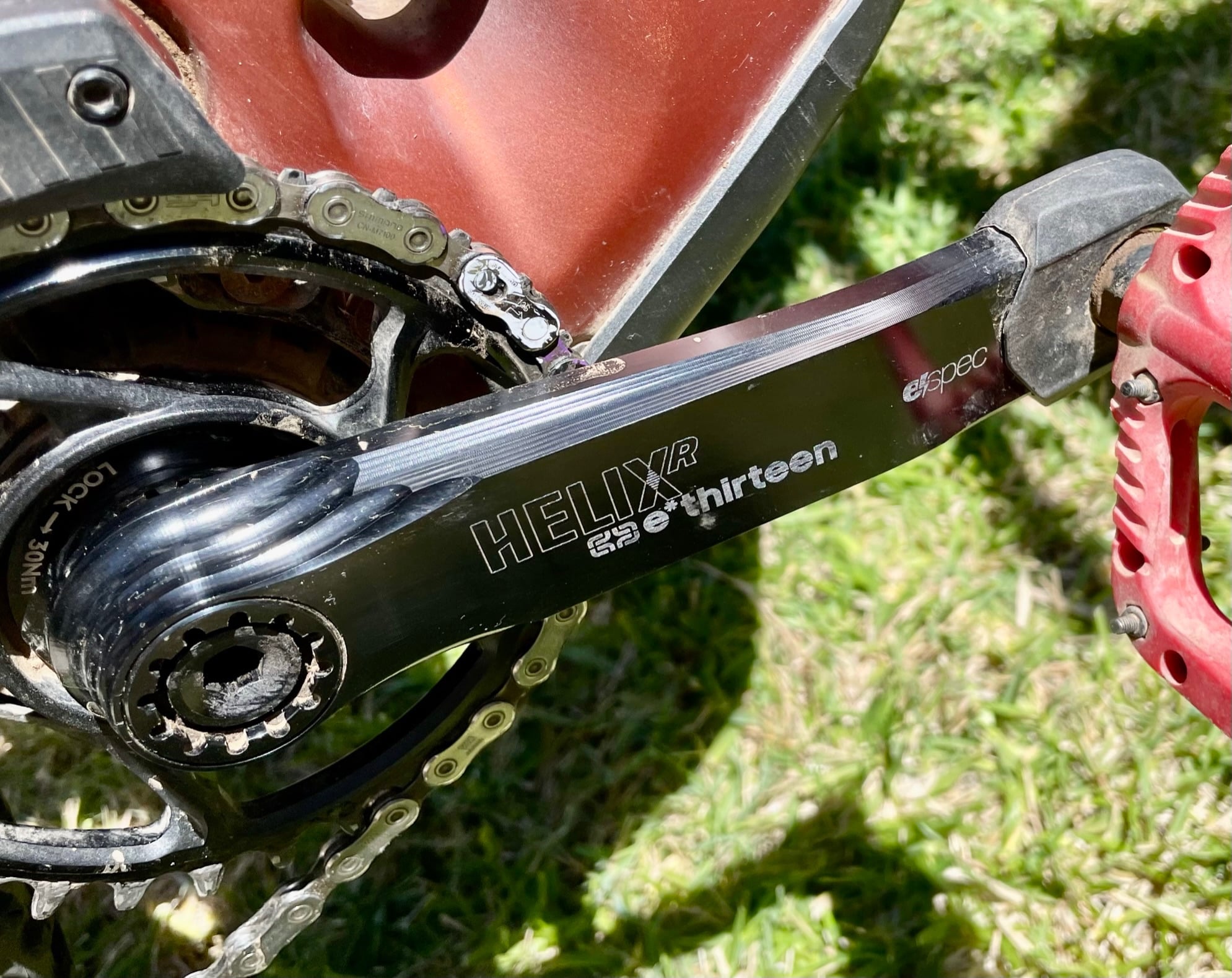

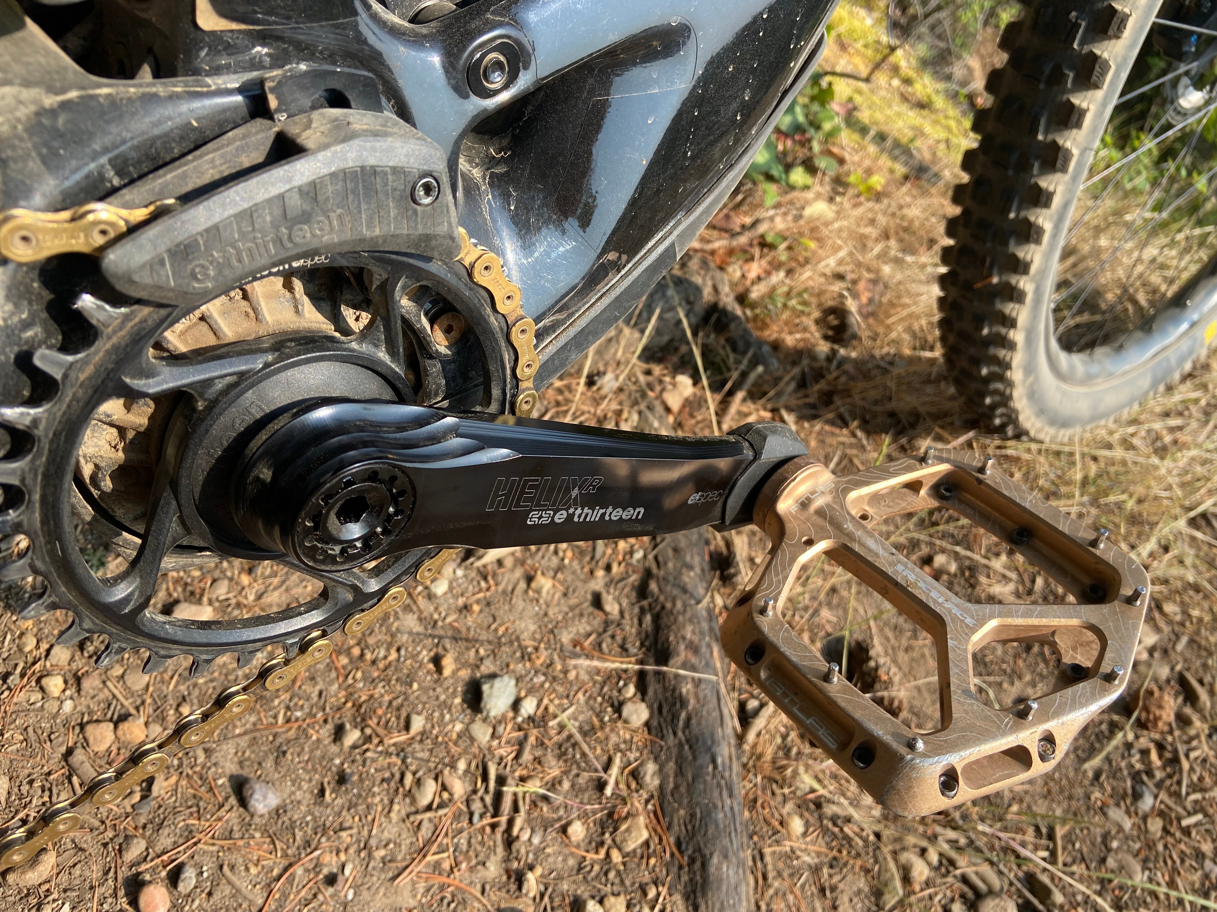

Picked up some e13 helix cranks, 160mm length. Good value, nicer hardware and finish than the stock cranks. Hoping they stay tight!
View attachment 119460 View attachment 119461
Are you sure they're 160mm, they seem not to make them in that size........?
Those in your link are the 30mm spindle, non-eBike version.
The Helix e*Spec are indeed available in 160mm, seems like the same crank for TQ, Bosch & Fazua (all Isis drive)
