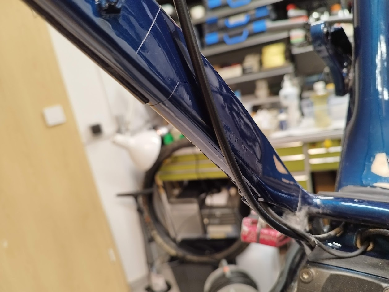

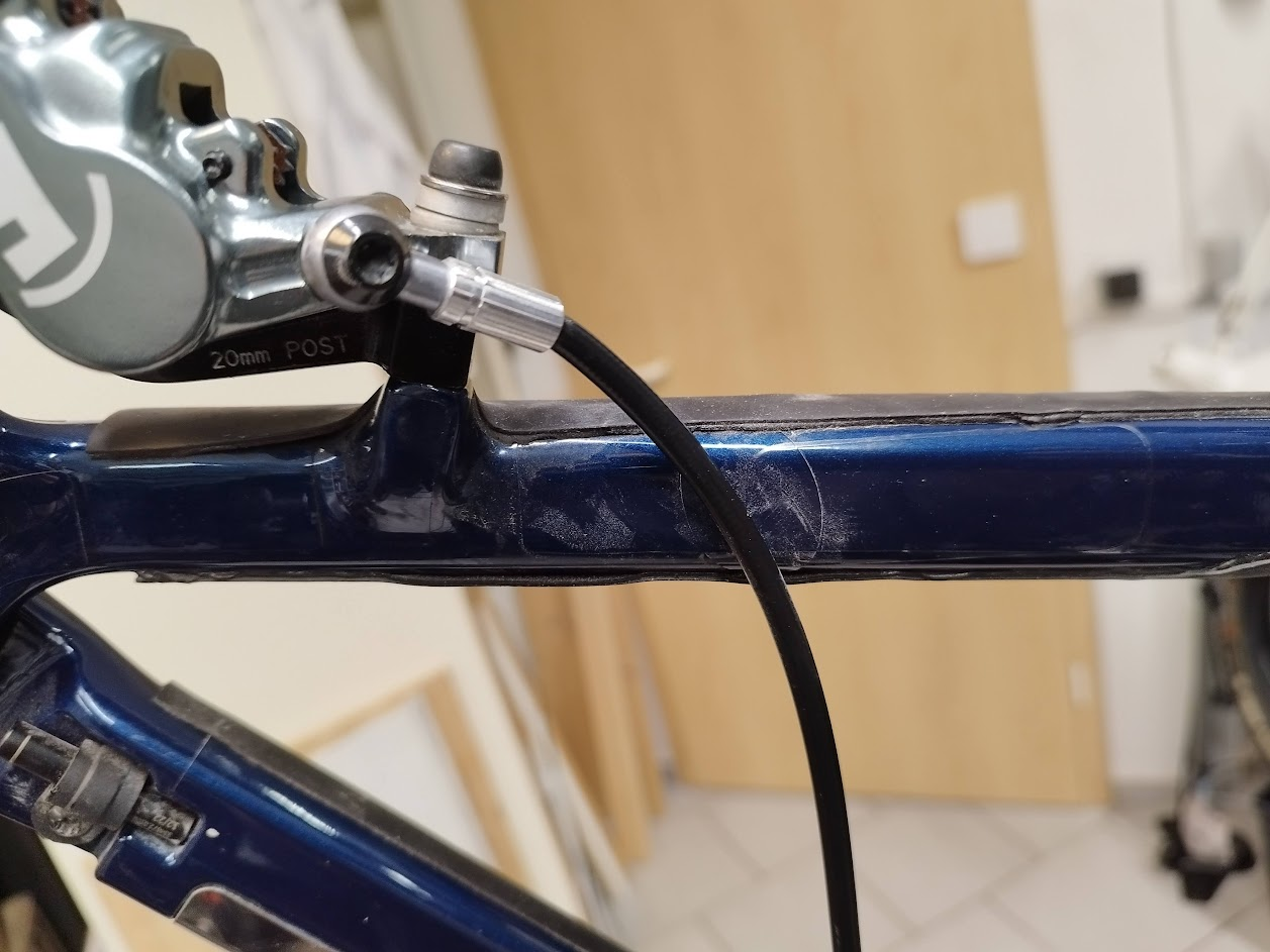

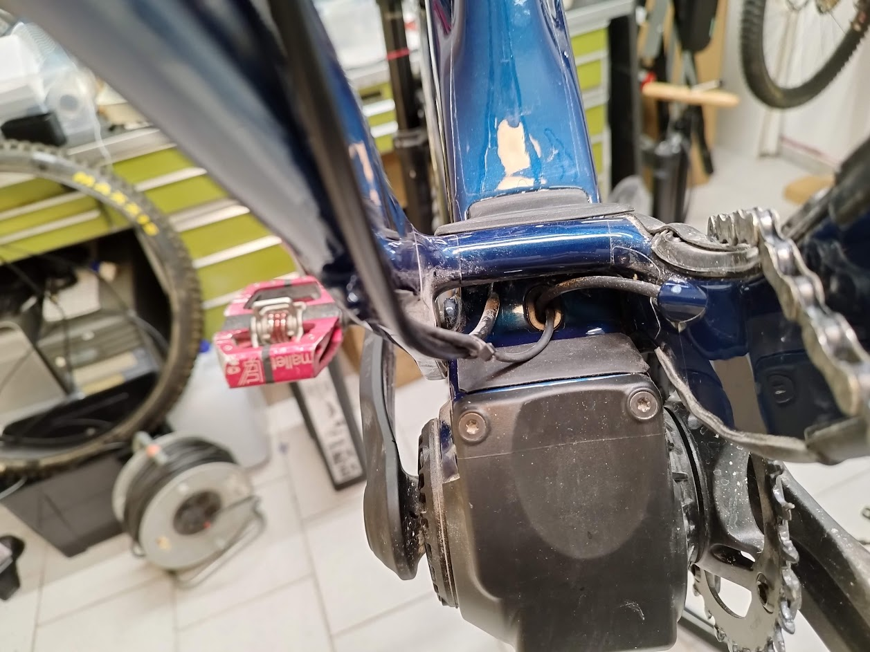

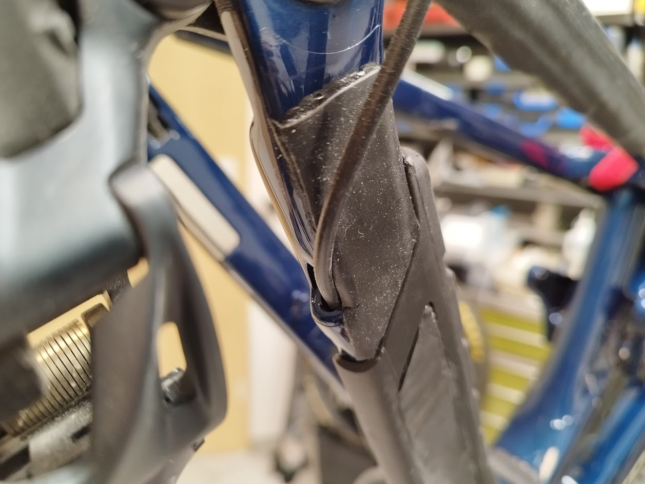

A quick update from my EXe:
Since I take very care of the frame, I used a protection film.
After my first long tour, I checked again for chafing spots. And found some:
I placed some slapper tape on the main frame, between the link.
The sensor cable was chafing.
Second charf spot is the rear brake line:
Charing spots on the lower and upper chainstay.
I used a second layer film. Should last a while.
(of corse I used cable ties, the pic is done without and then tied up again)
Also I noticed when riding in high (flipchip) the tention is higher and the chafing is also stronger.
Third is the AXS Cable:
This is not a mayor problem.
I used some more slaper tape....
The rear brake hose def moves a lot when suspension cycles. For sure something to watch.
