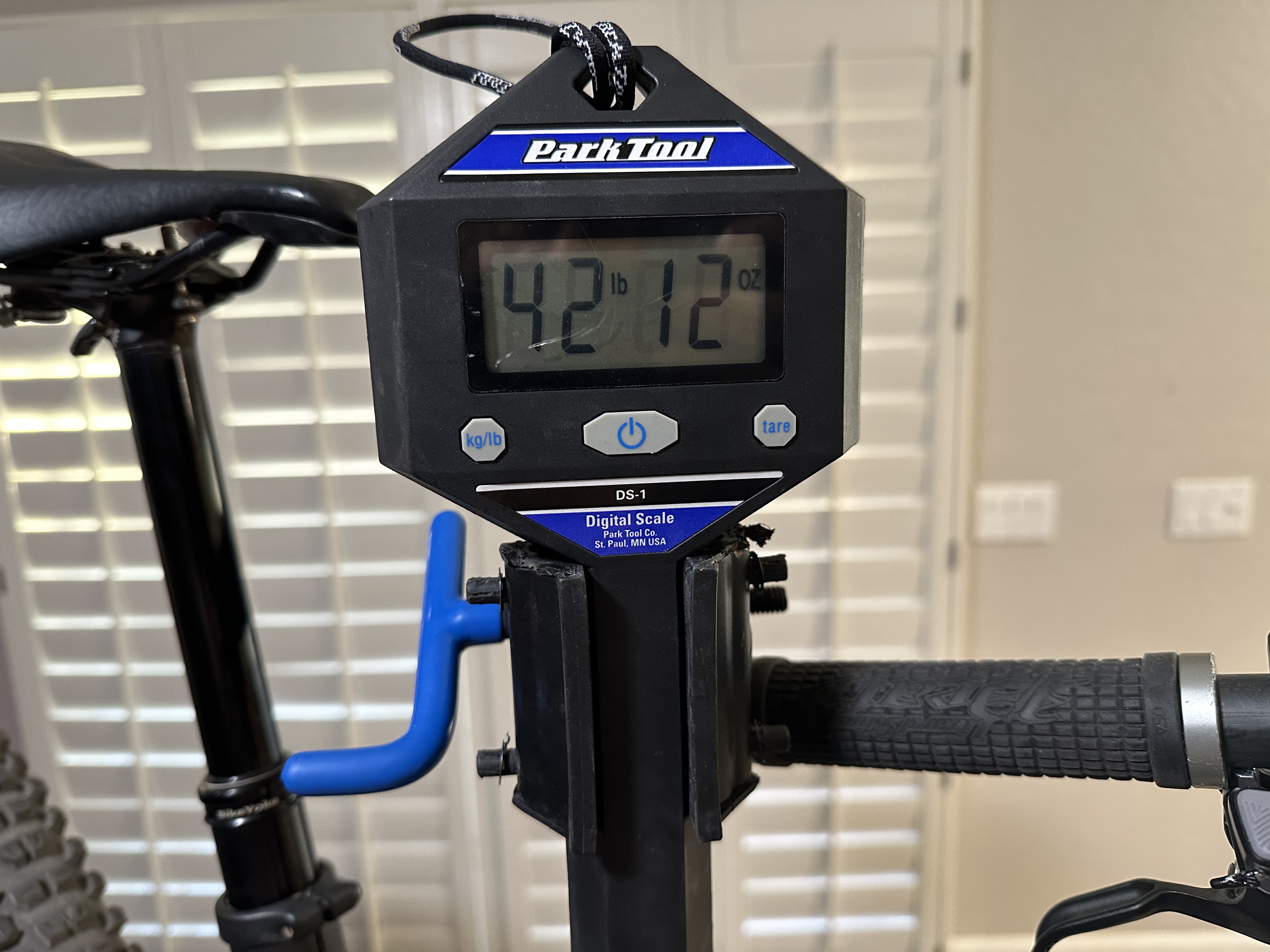

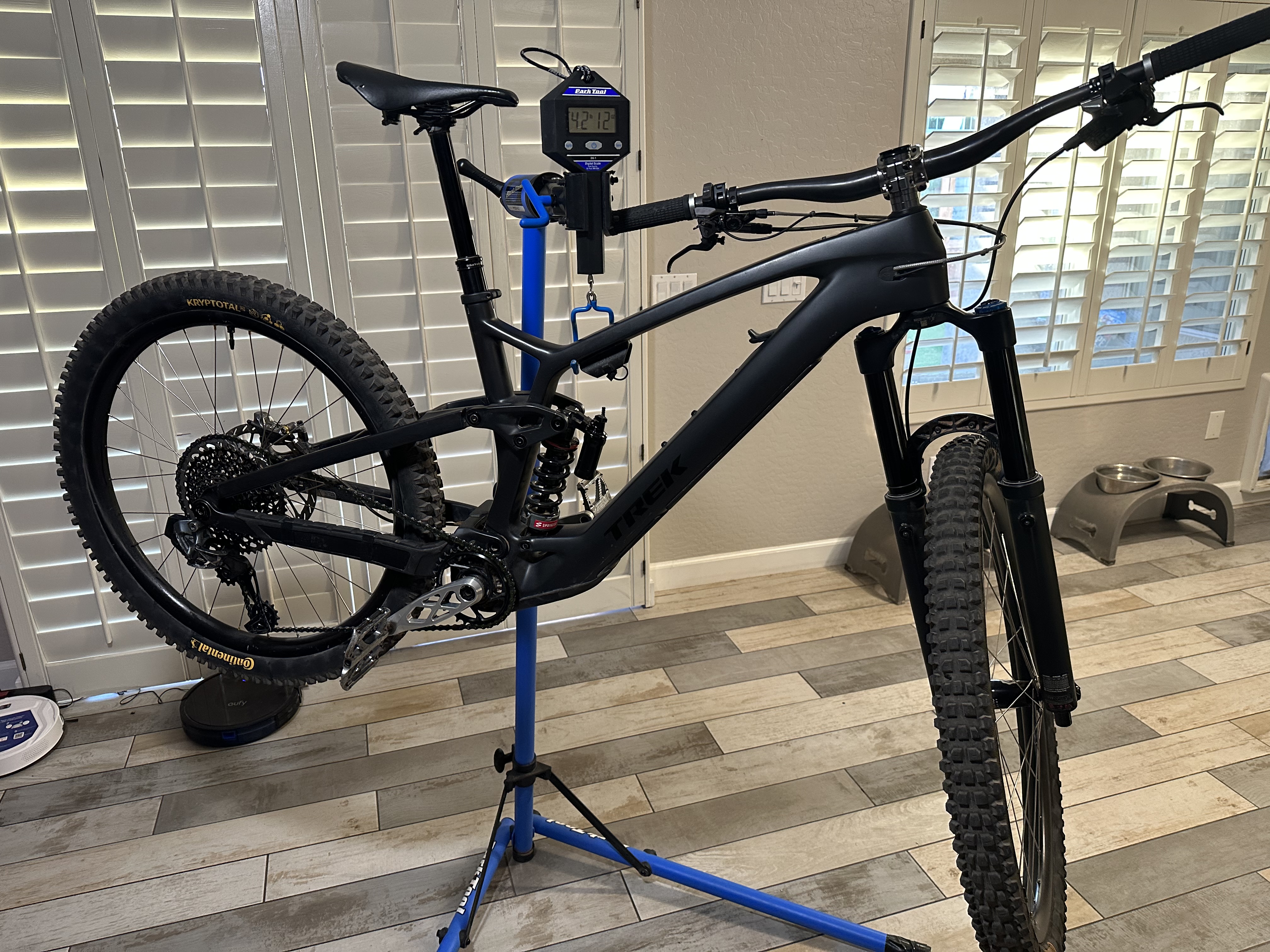

I haven’t weighed the EXe since I switched to a coil shock and 5Dev cranks. 42 lbs 12oz ready to ride.
8DD0C4C5-C8D4-4931-BDD6-70CF20A149D7.jpeg 28A68921-0EF6-4719-B419-BBB3585F038E.jpeg
