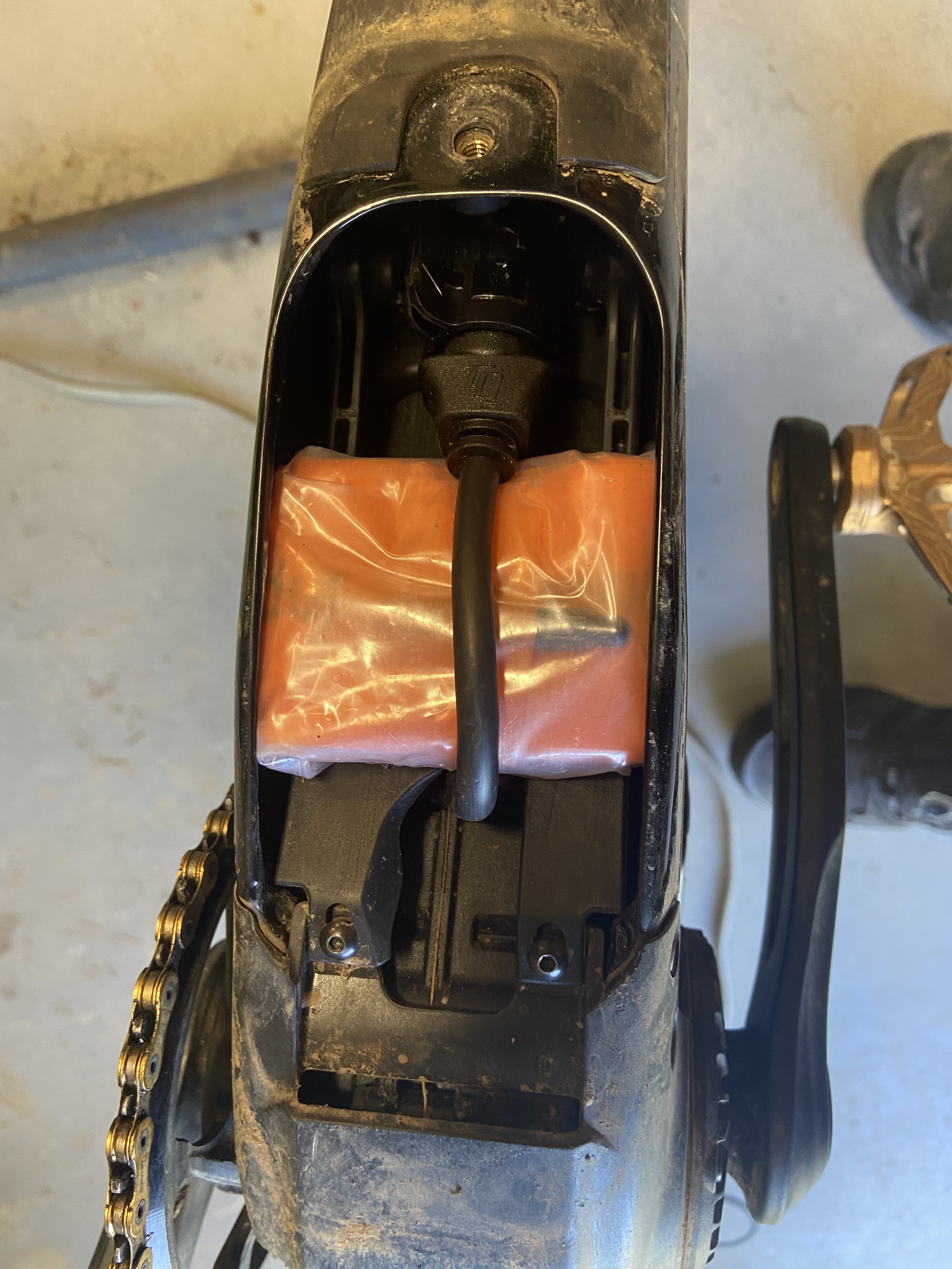

Pro Tip! Tubolito 29” tube fits very nicely inside the frame, under the battery door. Almost room to spare.
I had to walk home from a ride last week after a bead failed on my rear tire. A tube wouldn’t have helped (we tried) but it was a reminder to come prepared.

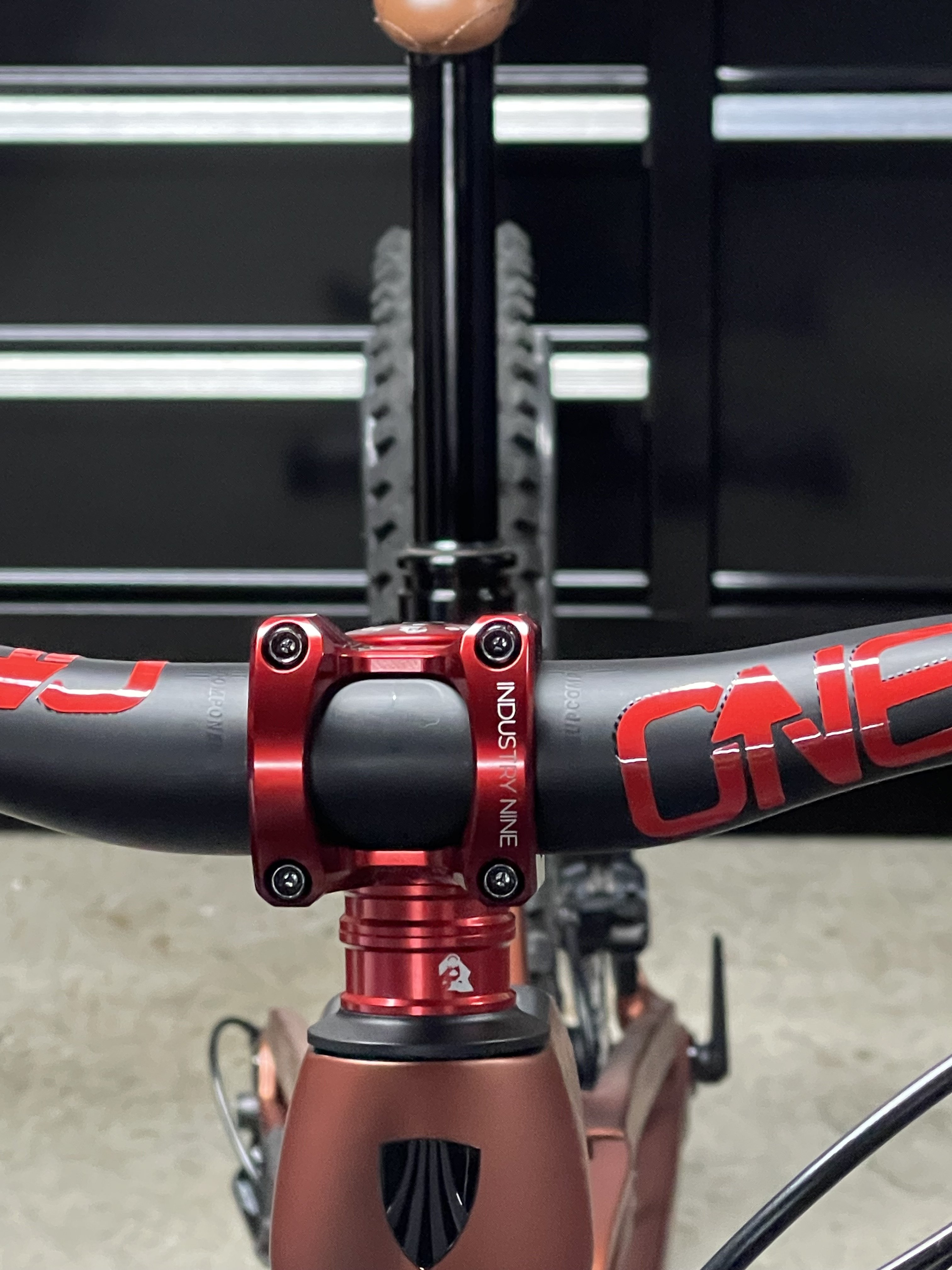

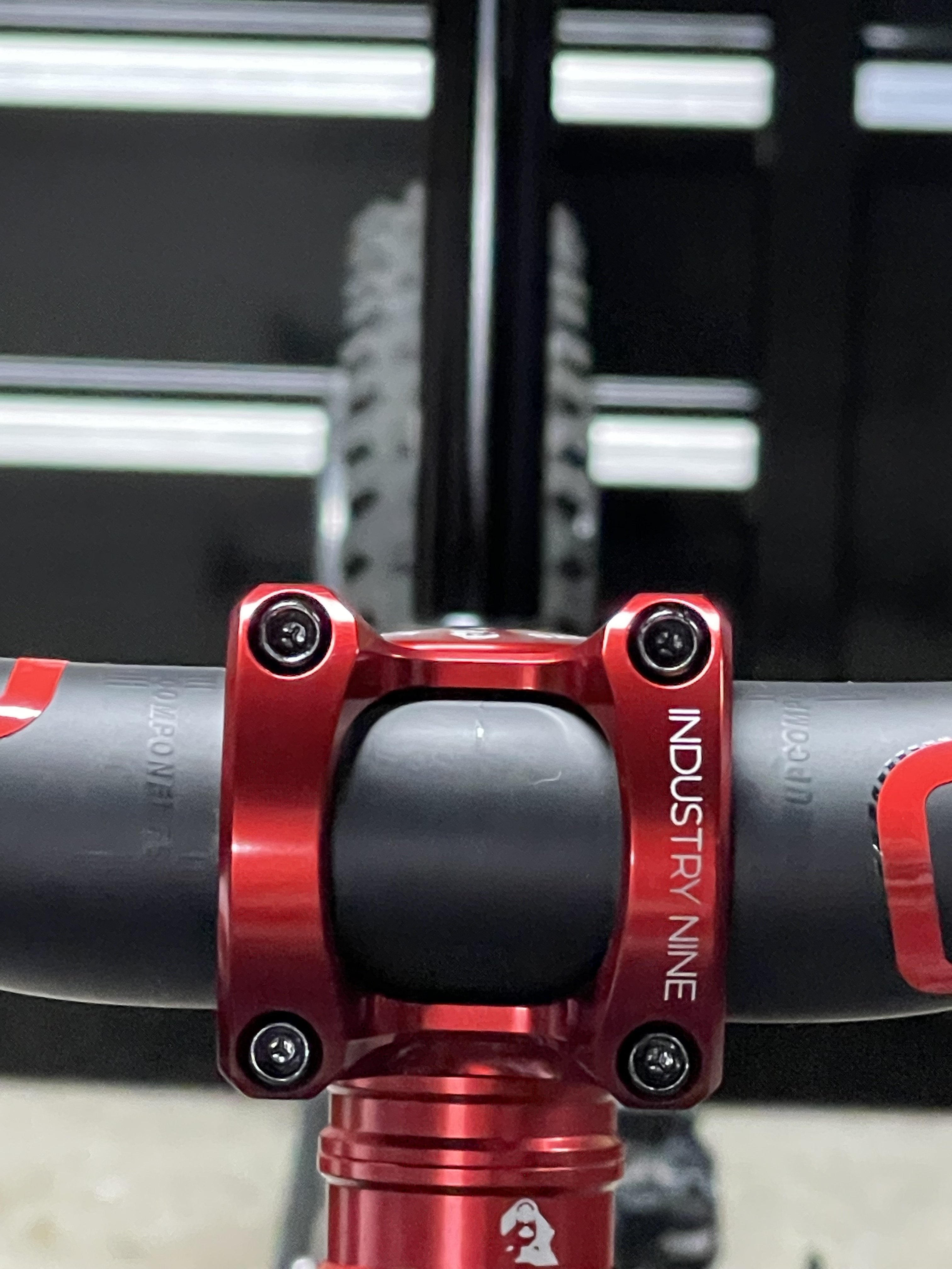

It's hard to tell based on the pic. The angle is off. The seat post is not centered to the stem so the dish of the rear wheel in this pic looks off.
Actually, I just measured with calipers from the edge of the seatpost to the outside of the stem. The picture is perfect, within one half of a millimeter. Now, if I line the post up with the rear wheel, this is what I get.
You mean you measured the picture?
There is a way to measure frame alignment, but I think it’s very unlikely to be the cause. run string from one dropout, up & around the head tube, back to the other drop-out. Then measure distance between the string and seat tube on both sides with calipers- should be same.
My money is on wheel dish, or possibly hub spacing (I.e. its a 145 or 142 wheel with the hub spaced to 148mm, but the wheel has not been re-dished)
