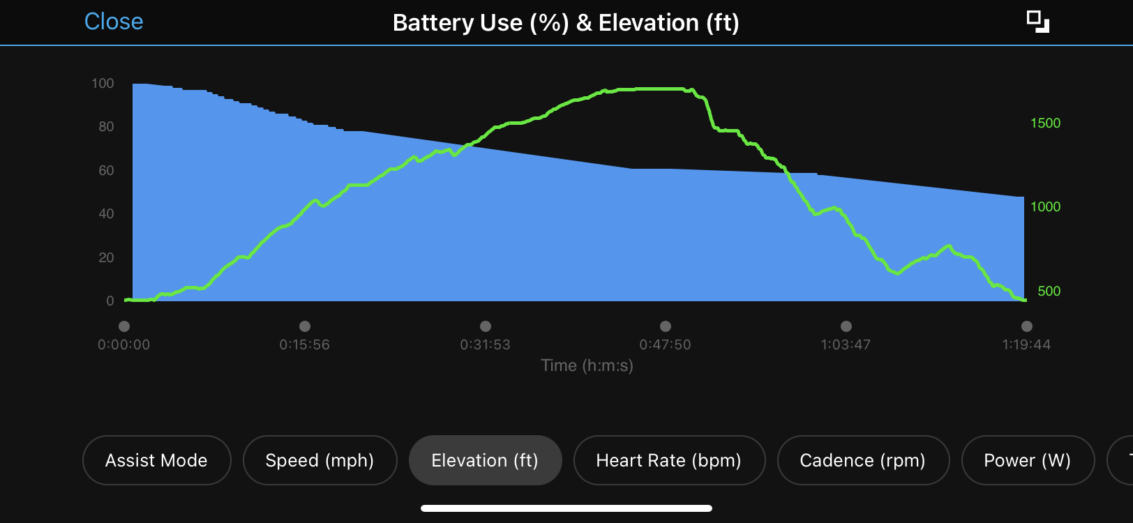

I did a ride today and recorded it on my garmin fenix 6 pro watch and used the trek central app to record the ride at the same time.
The garmin said the ride was 1700 feet of elevation, the trek central app said 2600feet of elevation.
I know the garmin is mostly accurate because it uses its barometric pressure sensor to calculate altitude,whereas i presume the trek app uses data embedded in the maps.
I was just surprised at how inaccurate the trek app was in terms of altitude. I guess it will vary from location to location due to it using different map data sources.

I would think it has to be a map issue. Generally my Trek and Garmin apps are within an acceptable tolerance, e.g. last ride on Garmin says 23.69 miles with 1,030' ascent, Trek app says 23.7 Miles with 998' ascent.
I find phone GPS App tracking to be pretty inaccurate in general. Aside from pulling elevation from GPS data, phones also seem to have a pretty low sample rate and of course, poor battery life. I was using a Garmin Edge 530 previously (mainly because it gave me battery % for my shimano motor) but just went to a Garmin Fenix 6 pro as well. The TQ Motor shares a lot more useful data. It’s pretty awesome with the Garmin and the eBike Field widget! Like being able to see battery usage (blue) over elevation (green, below).

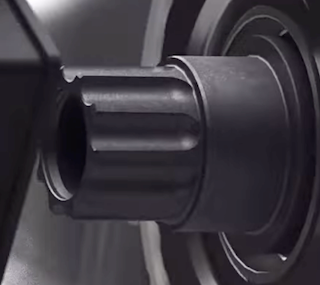

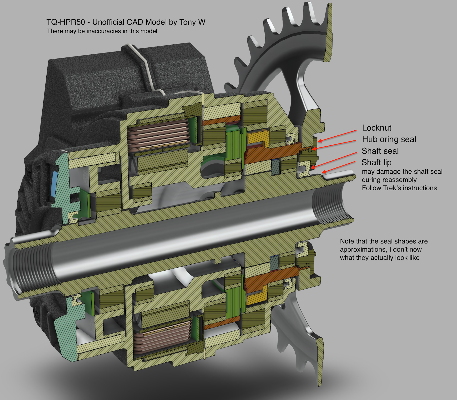

I recently got a little obsessed with understanding how the HPR50 worked
I ended up making a full 3D cad model
Might be interesting to some of you”

I’m curious if you have any comments about the sealing of the motor?
The service manuals note about potentially damaging the seal on the lockring freaked me out, since that seal wasn’t visible from the outside. Fewer moving parts and good sealing was something that got me excited about the TQ motor.

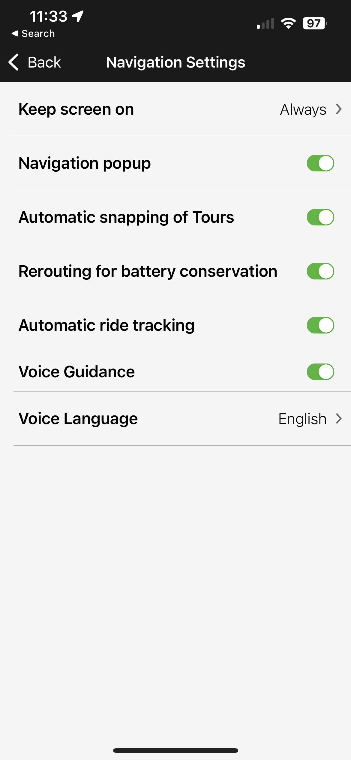

My Trek Central app lists "no recorded rides" under history. So I have to manually start something each ride? My Rail kept track of milage automatically.
There’s a setting that will automatically record as long as you switch to “Ready to ride” shown in this screenshot
It looks like the lip on the shaft could damage the seal during reassembly. The sleeve recommended by Trek would allow the seal to slide over the lip without getting caught and possibly damaged or flexed in the wrong way.
Interestingly, that part of the service supplement was were I learnt that there was an oring and seal attached to the lock ring, up until then I had no idea they were there, so that was one of the many clues I found that helped me complete the CAD model.

I've shown the lockring seals below. You can also see the other seals and gaskets in this section drawing (assuming I've got them right)
Very interesting, thanks and great graphics. Curious to what software you’re using, solidworks or inventor maybe?

I used Fusion 360 to draw this (free hobbyist licence)
You said the seal didn't come out with the lock ring, my understanding is that the seal as well s the oring should be attached to the locknut, so that is puzzling to me.
Me too. Maybe someone else can confirm how theirs comes out. Perhaps the sleeve tool prevents the seal from becoming detached from the lock ring when using the octalink/isis tool.
I’m sure trek dealers would have included that sleeve tool if it is really that important 🤔
