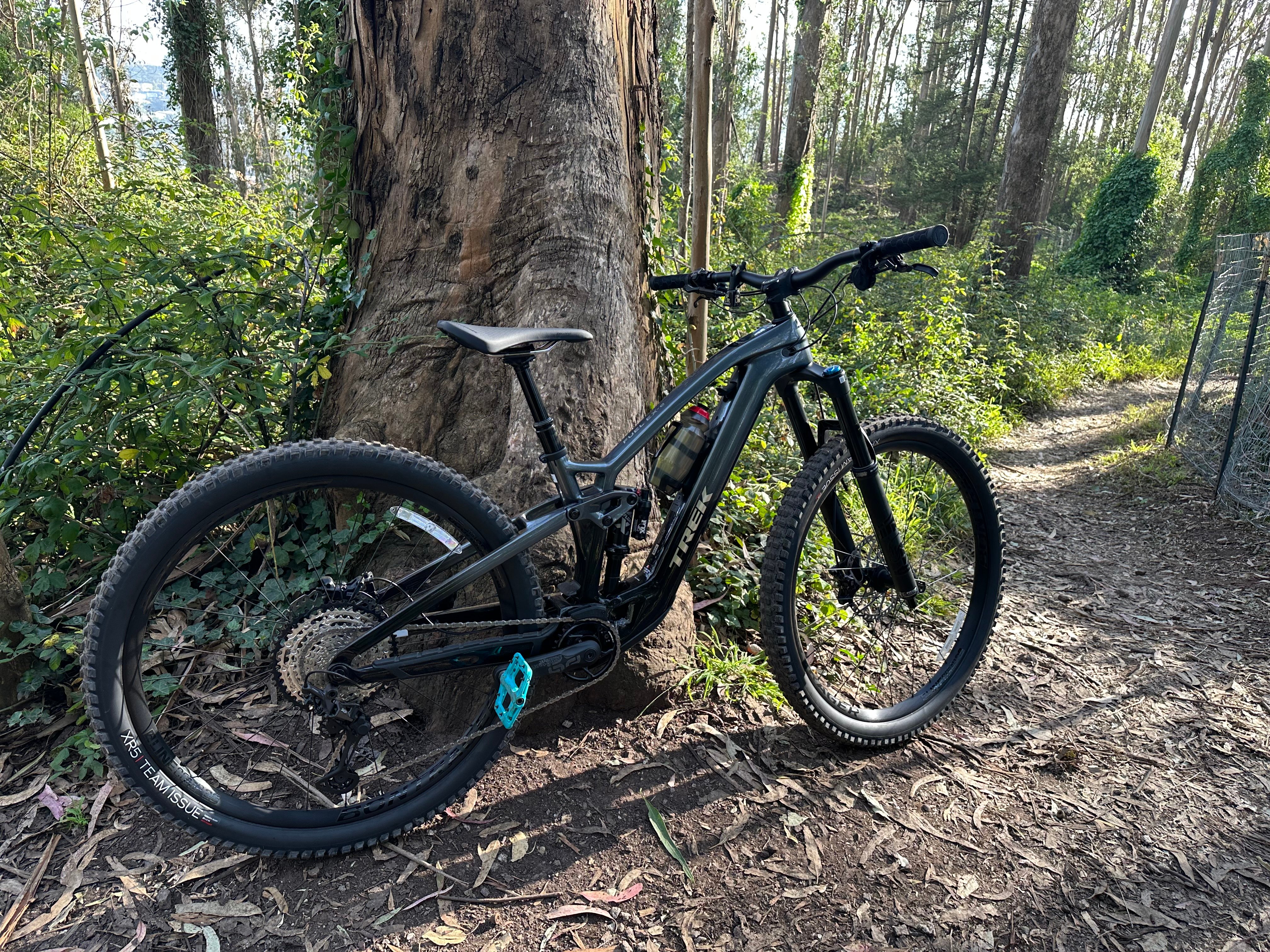

I managed to snag myself a 9.7 yesterday. A small Galactic Grey to Black Fade. The battery clip was missing, but my LBS has ordered one for me. Managed to take it for a spin today and it performs very nice uphill. I found myself turning off the assist completely on the narrower paths, to not spin. Probably need to adjust the settings a bit.
I like that it was so easy to connect my Garmin to it, too.
I really need to practice more...

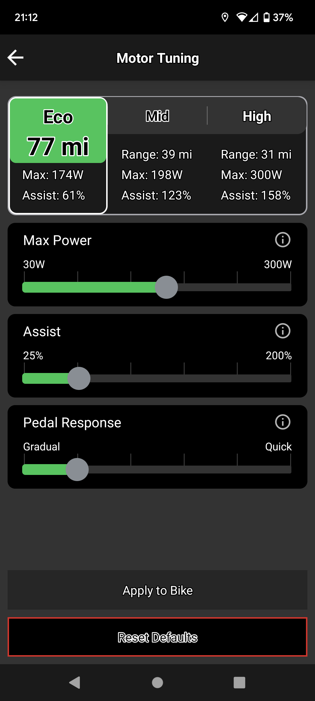

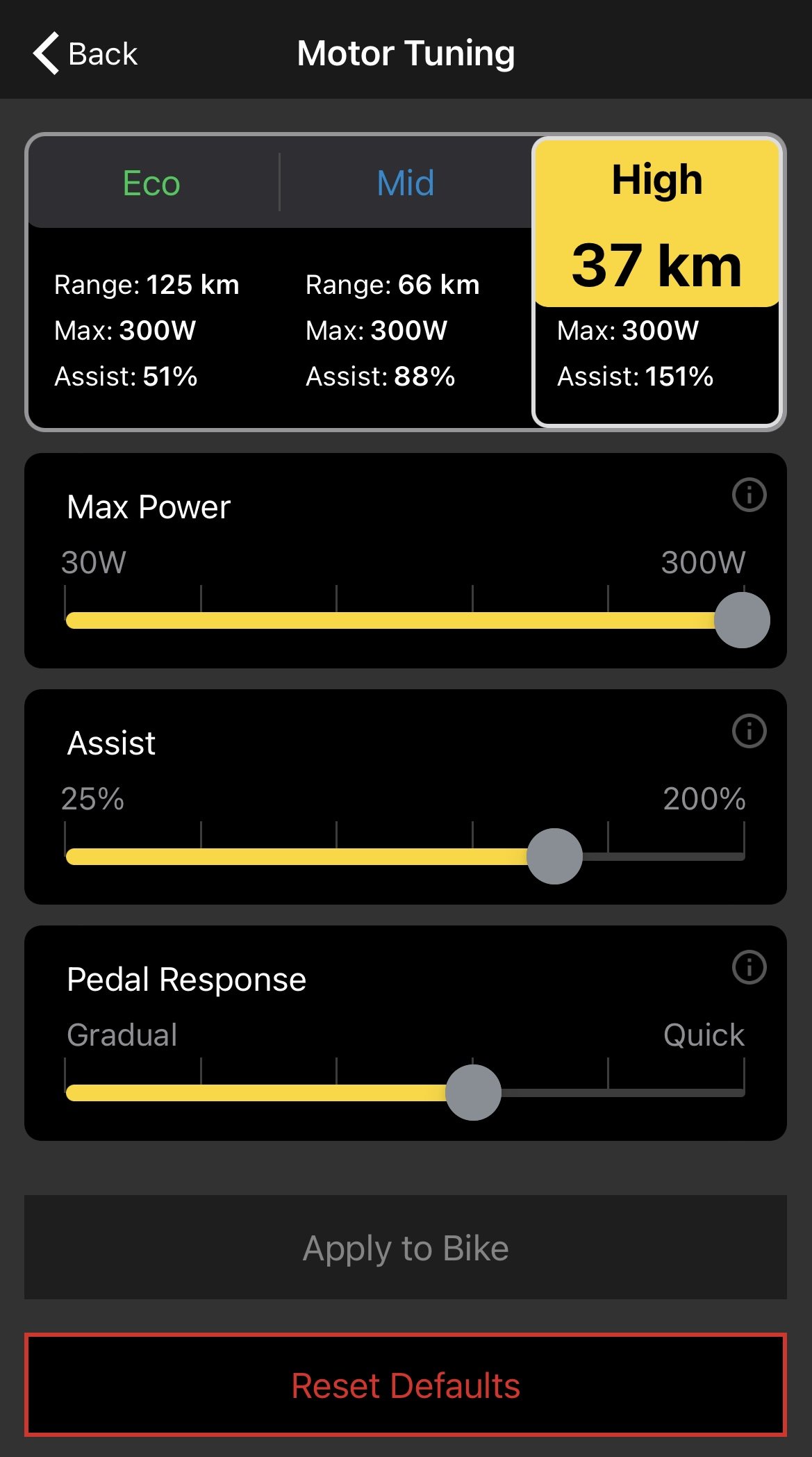

I can’t remember who here suggested it , but a bunch of us have now set up all modes to 300w max but different assist levels, which I’m really liking - and hasn’t really affected range for me. (Edit - Eco and Mid have the Pedal Response maxed out, High is the only one which isn't, which is why I screenshotted that - also I don't have full battery so ignore the range numbers)
The Max Power on every mode is the best tip I've gotten. I almost never take mine out of Eco because of it. Even on very steep climbs. The only time I use High is when I'm late getting home and am off the trails and on regular roads. Even with that setting, if you push like I usually am in those cases, you'll still get a great workout.
Any reason High Mode doesnt have assist maxed out at 200%?
I think the default eco mode that the motor ships with is set to too high assist amount for flatish riding, so you end up chewing through the battery too quick, dropping the assist down to 50-60% (similar to above)means the battery lasts a lot longer on flat road transfers etc.
below are my settings - I think I have found my optimum setup for mid and high, but I'm still fiddling with eco mode, I may increase the max power of eco and see if that enables me to stay in eco longer when going up steeper hills, but equally not chew through the battery on flat road sections.
