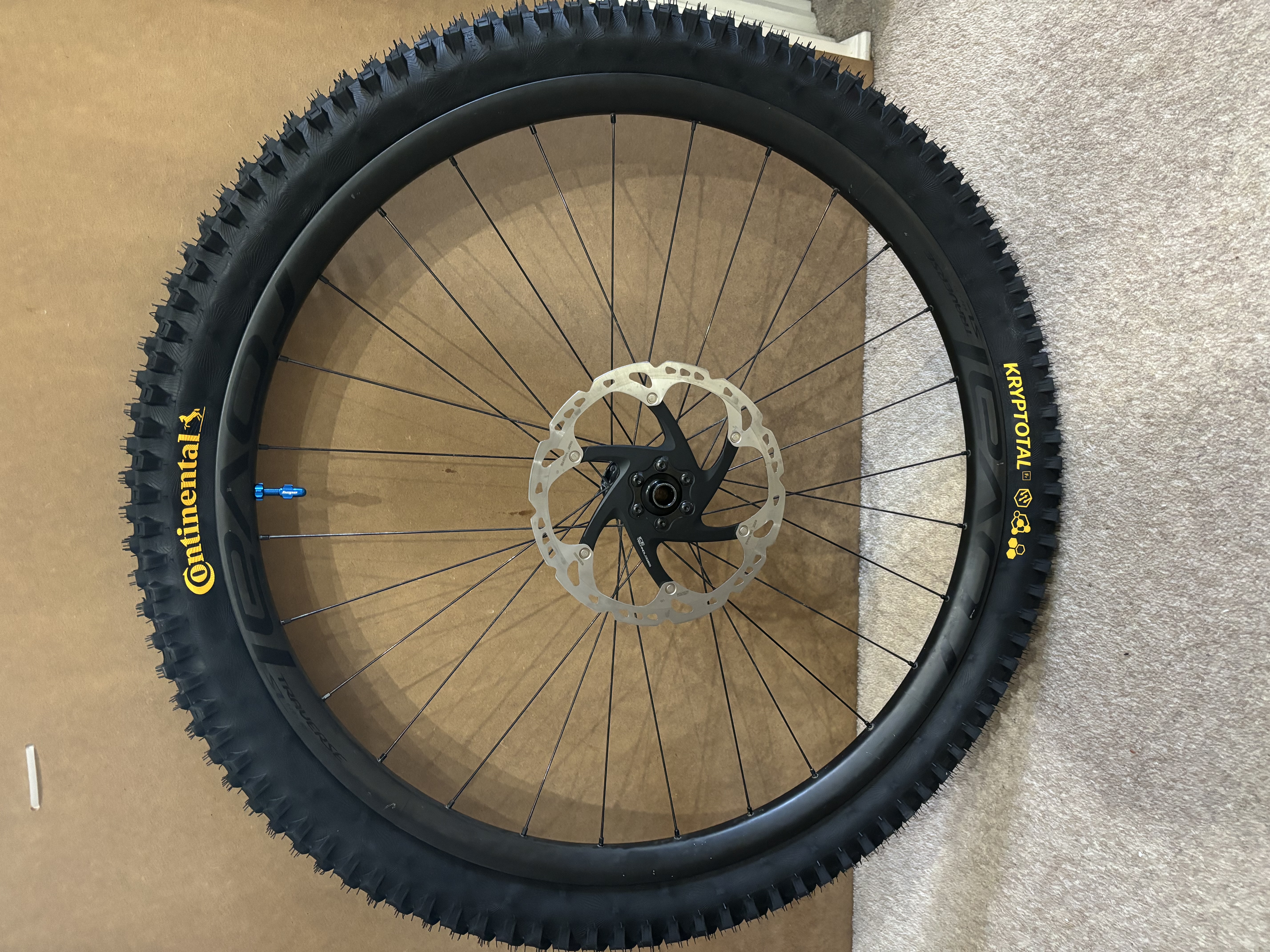

Hunt trail wide ii wheels
Continental argotal dh supersoft on front and Kryptotal enduro soft on rear

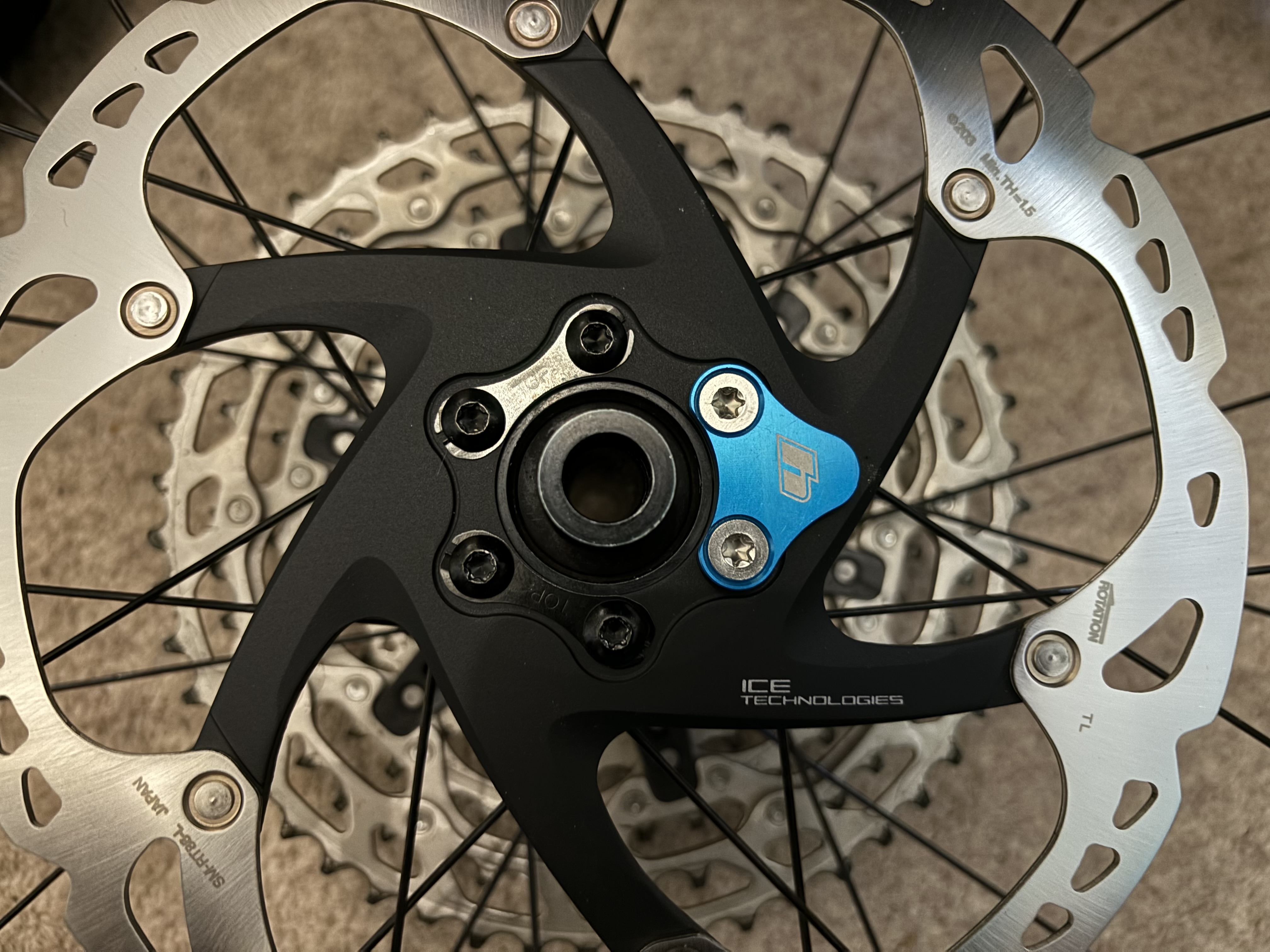

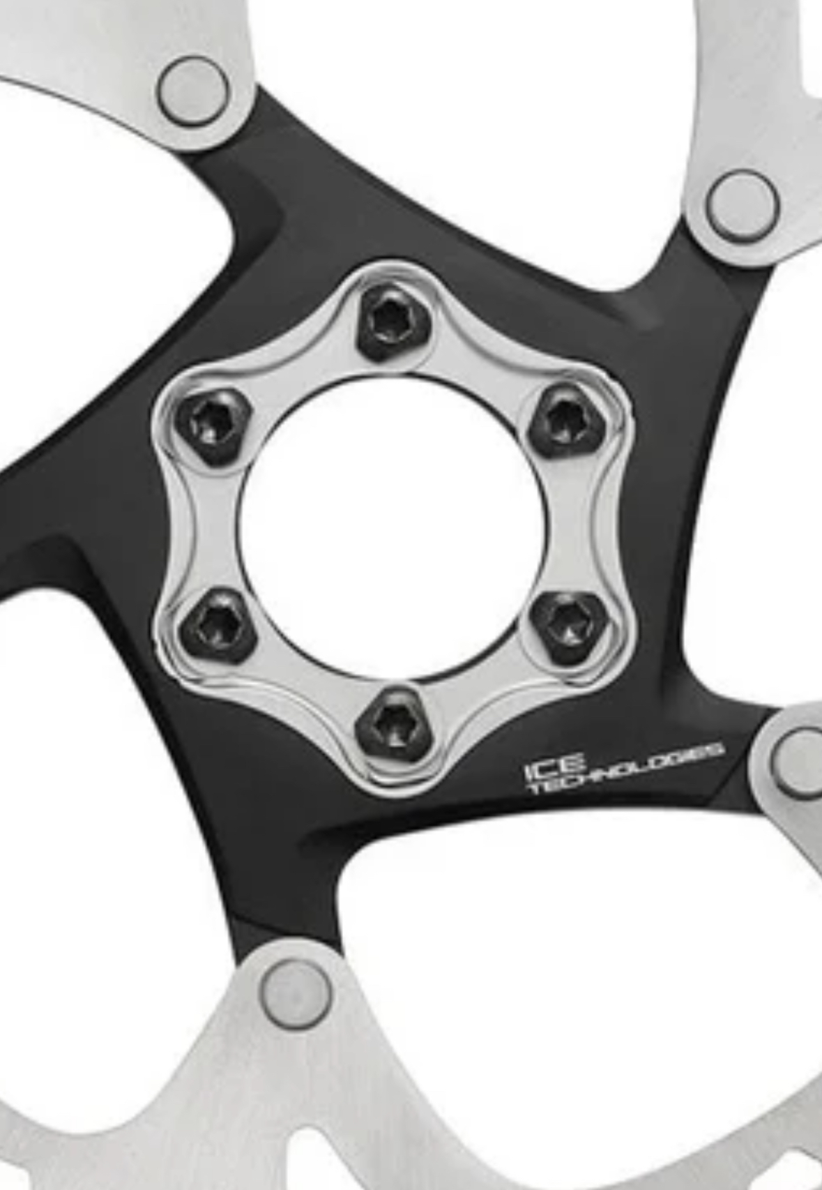

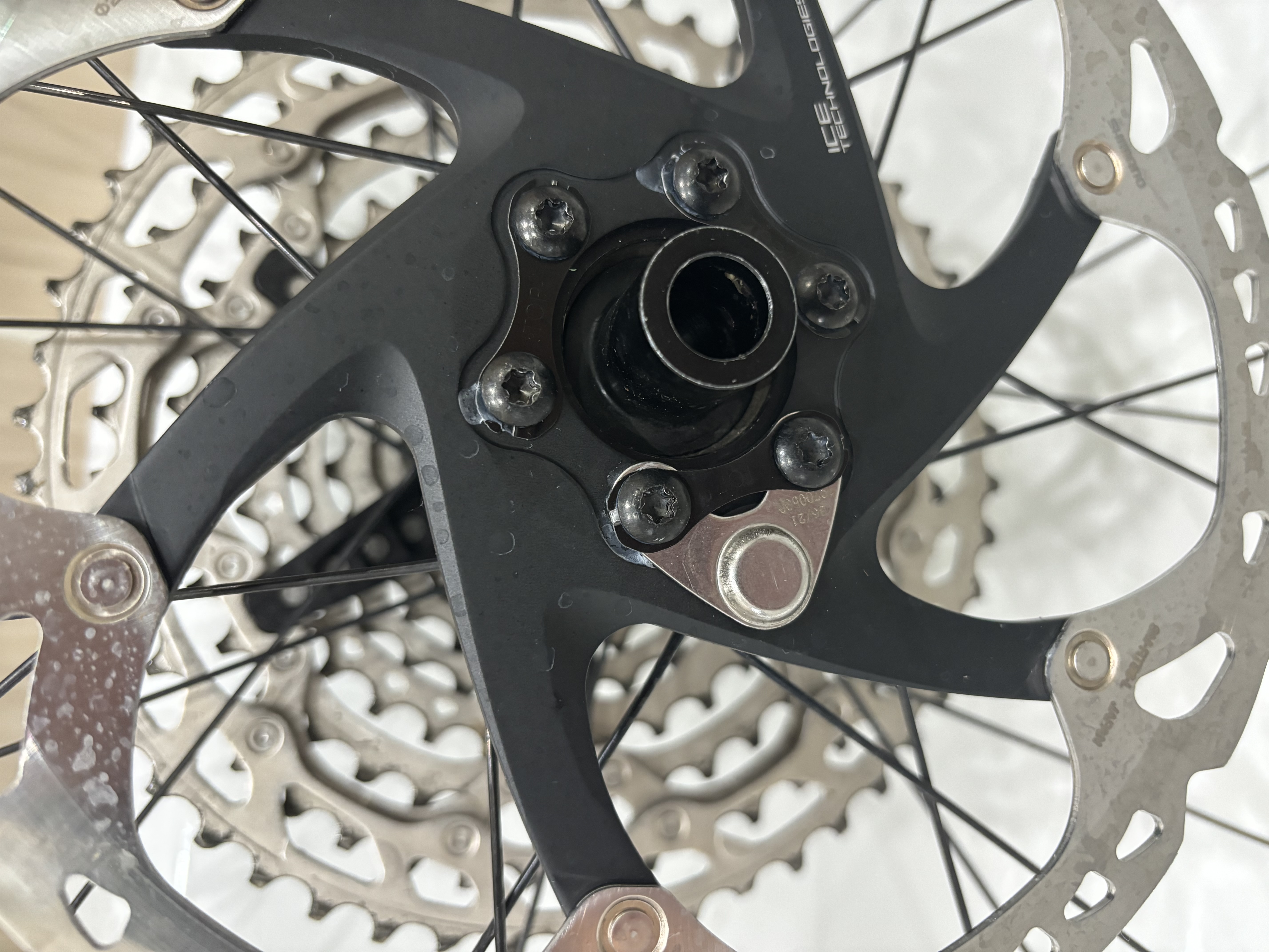

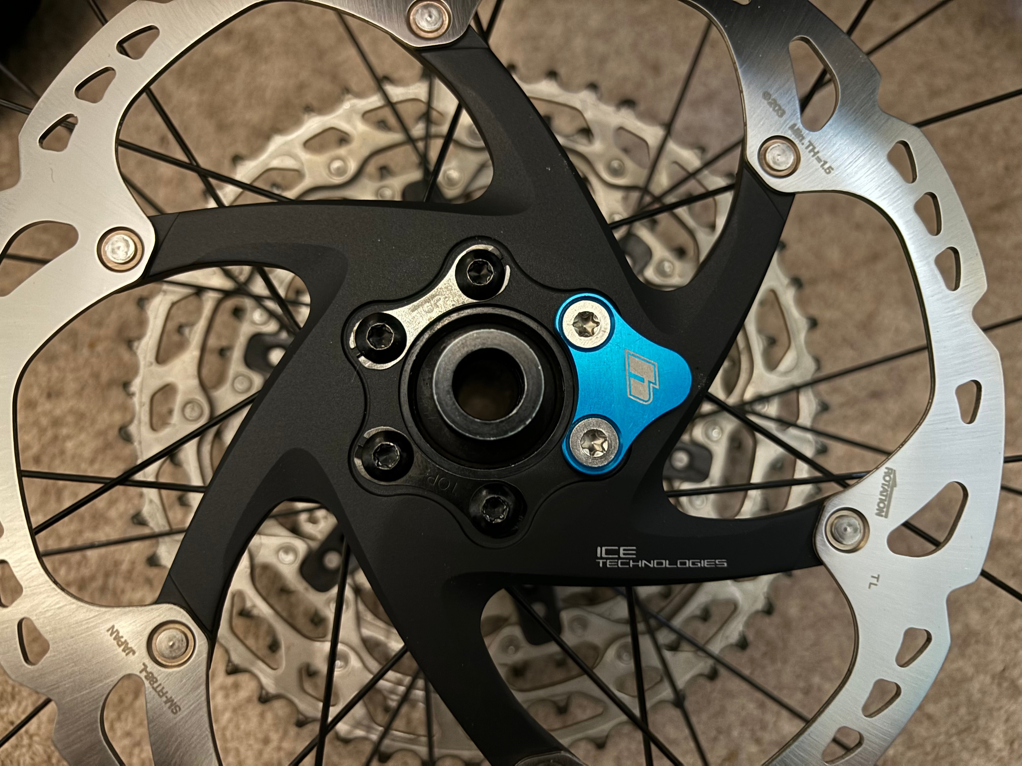

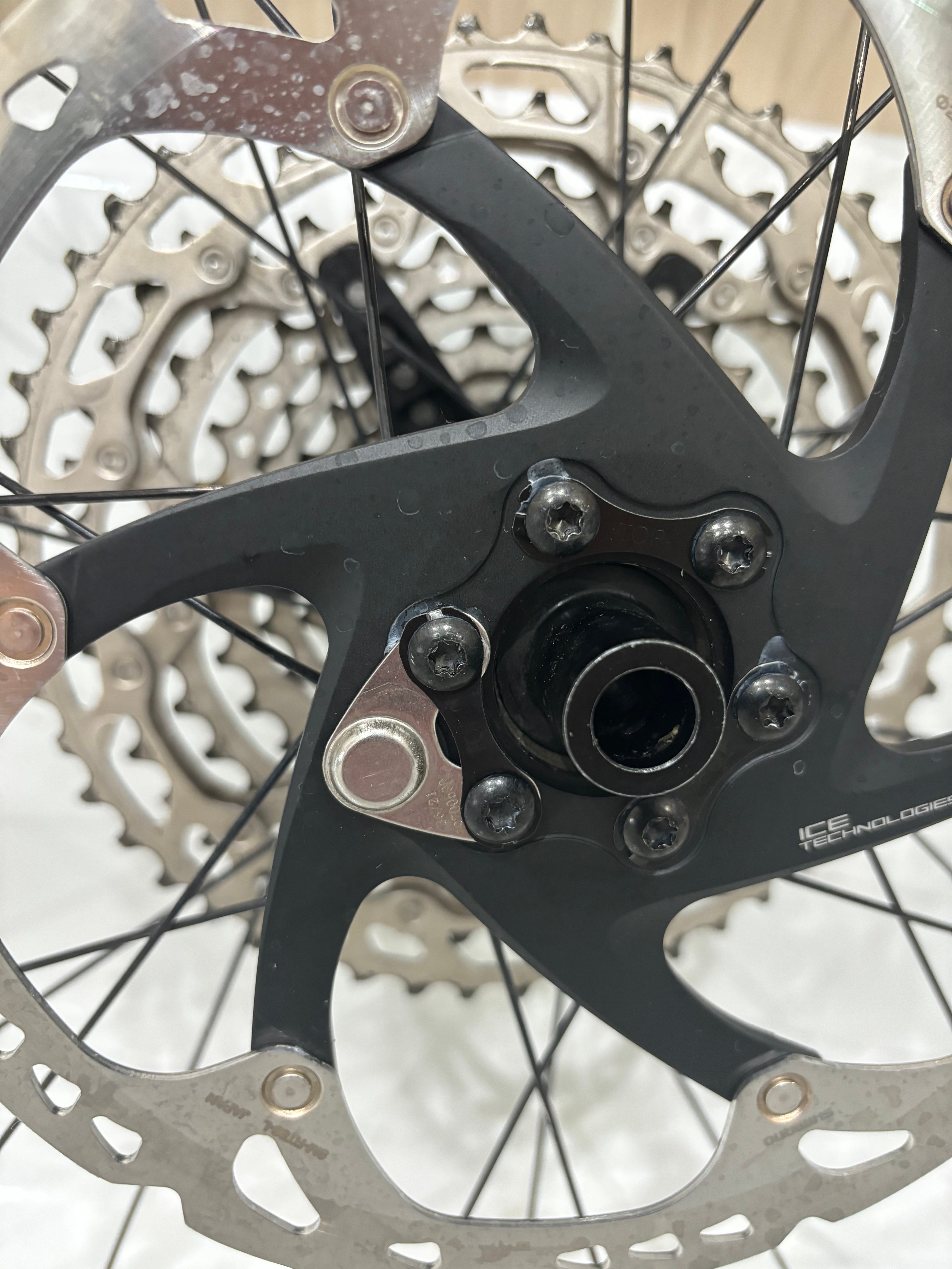

Was just looking at the XT brake discs and they come with a lock ring (silver bit in the middle). My older XT ones didn’t have this. Not sure these will work with the magnet as the bolts look like they sit in a lip? Will I need some spacers to get the magnet it fit properly?
All sorted. That lock ring was a myth lol.
