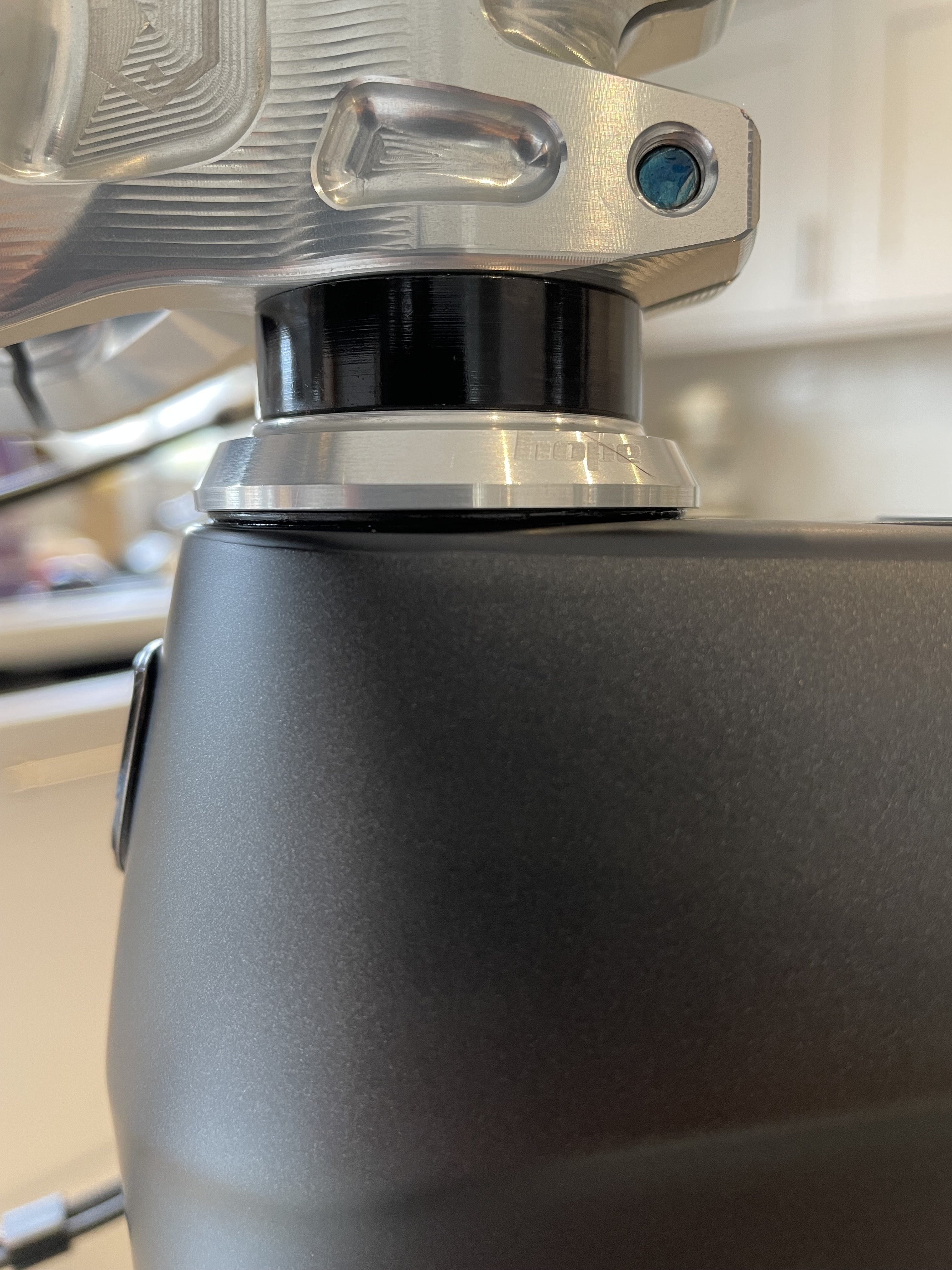

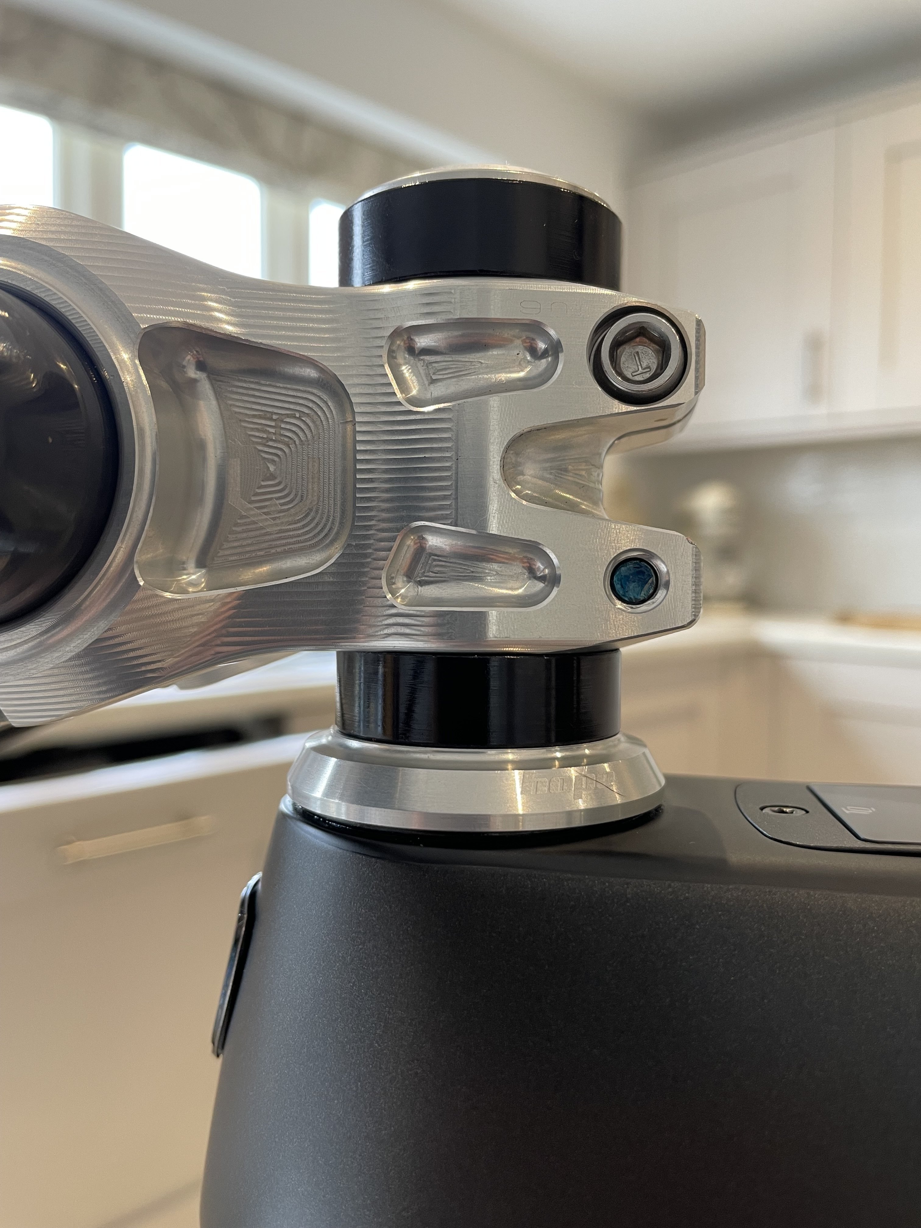

Also the stem on the 9.5 is 31.8 with 7degree rise. My 35mm stem has zero wise. Wondering how much that effects the bar height.
Also the stem on the 9.5 is 31.8 with 7degree rise. My 35mm stem has zero wise. Wondering how much that affects the bar height.

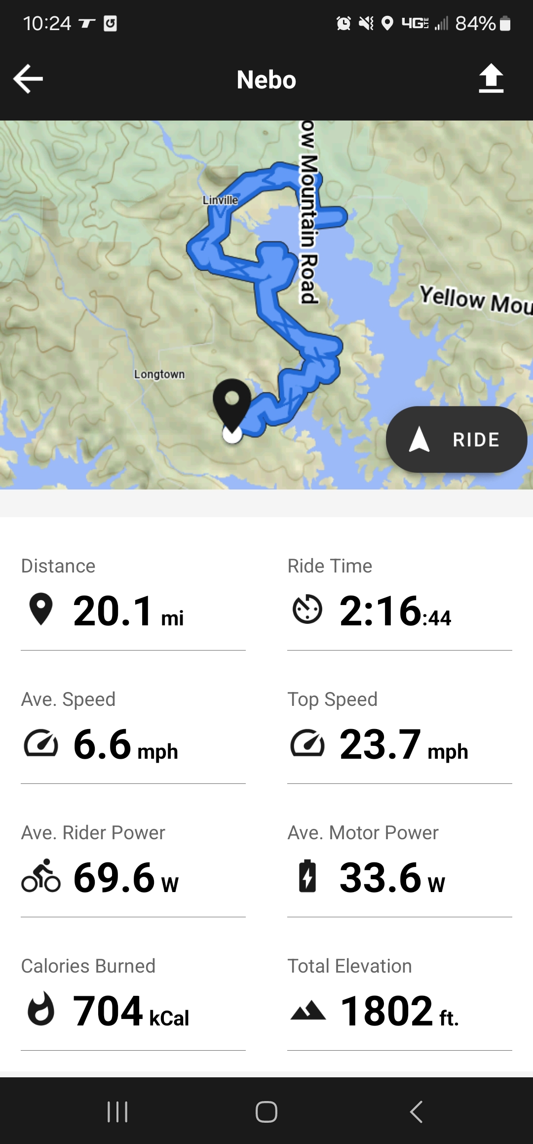

Things putting me off are range - I would like to be going out for a couple of hours but this would include a mix of flat and down and up.
As far as range goes, I’ll typically set the assist levels for the planned elevation gain of my ride and the results have been pretty consistent. 80Kg rider weight: 100W assist gives me 1250m, 125W/1100m, 150W/1000m, 225W/800m, 300W/650m all with a few % battery to spare. I set the % assistance so that I need to be applying about 240W of my own power before achieving the maximum Wattage for each mode. That’s for single track riding with moderate amounts of roots and rocks. Fire roads will generally get about 20% higher results due to more consistent grades and cadence.
I did pick up a range extender after a year for the lazier or bigger mountain days. It consistently gets 400m at 225W, and is usually drained by the end of the first climb leg, so just goes into the backpack for the rest of the ride. Don’t really notice it at all there, as its weight is mostly offset by the weight of the water I’ve been drinking along the way.

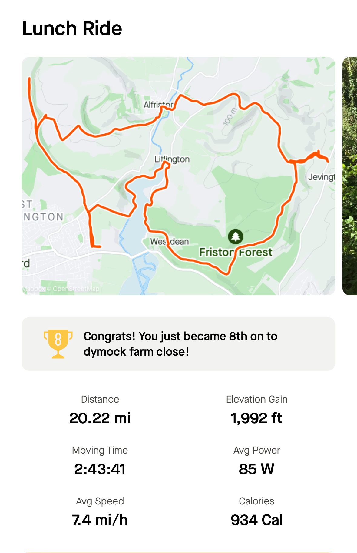

I’m a bit overweight right now and not super fit so that will probably not help the range until I shed some pounds! I am hoping to get out and do weekend rides that would be around 20-25miles so I am hoping I can manage the battery to last for that. I would say 50% of that would be flats and downhills.
It’s either this or try a full fat.
Attached is probably the type of ride I would be aiming for at weekends and more 7-10mile blasts during the week.

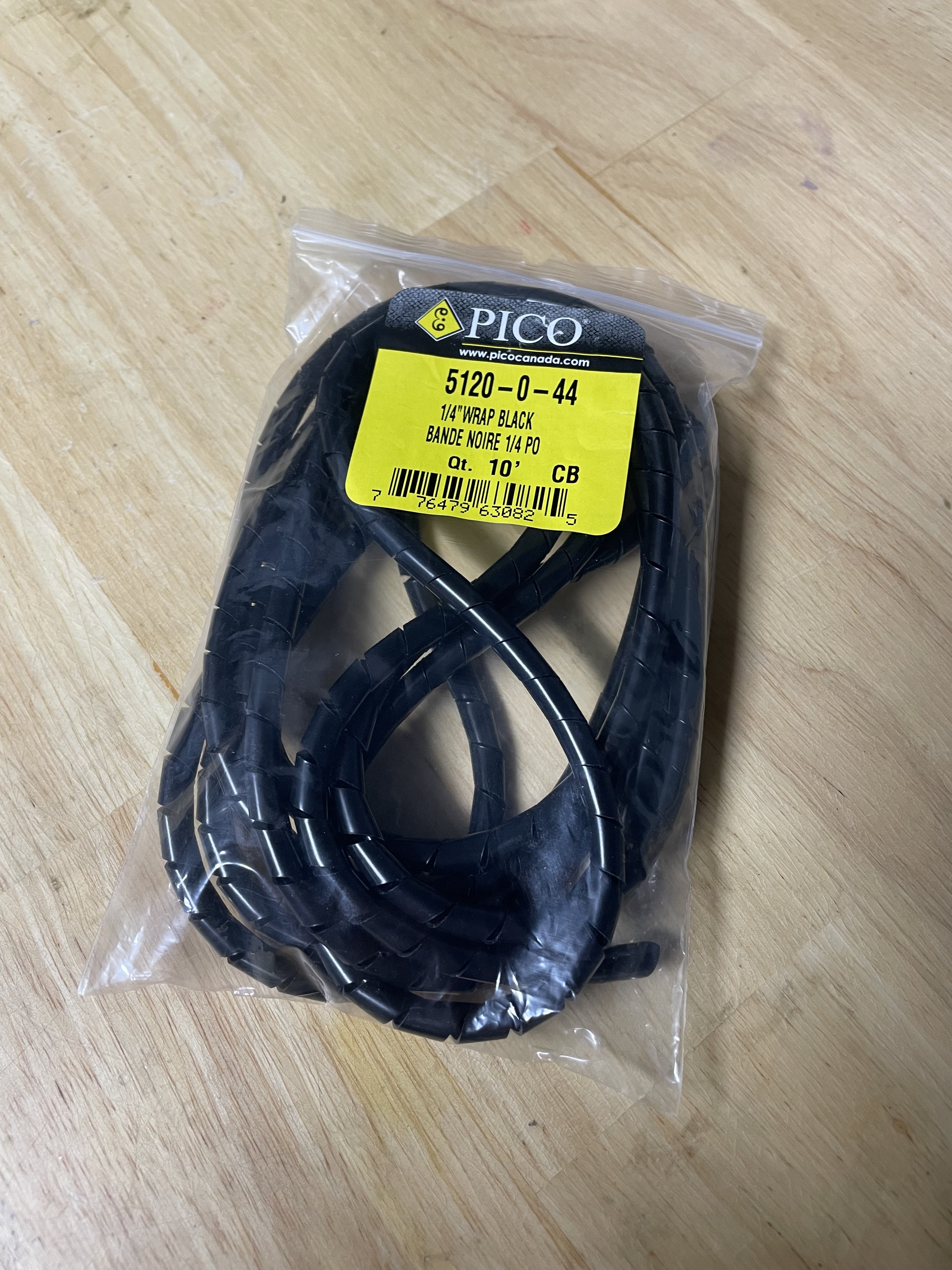

Just noticed that the rear brake cable runs down the left hand side so its going to have to do a tight loop round to the brake lever (UK - rear brake on left). Hoping the bike shop does a nice tidy job due to cable OCD lol.
There’s a few simple things you can do to help cleanup the cockpit, besides going wireless, that could lessen your cable/hose OCD symptoms.
I’ve used these. Automotive stores usually have them, along with a variety of zip ties.
