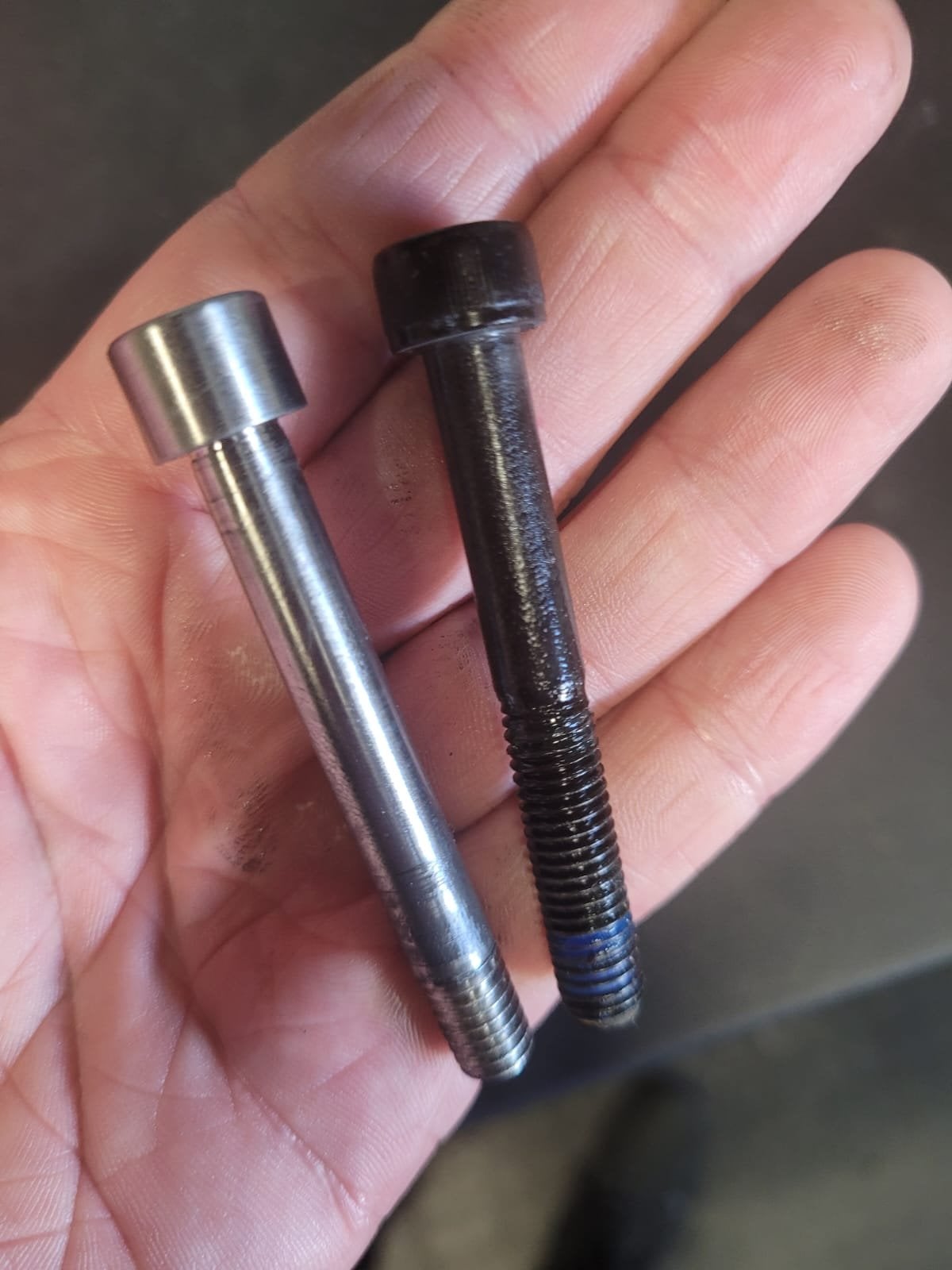

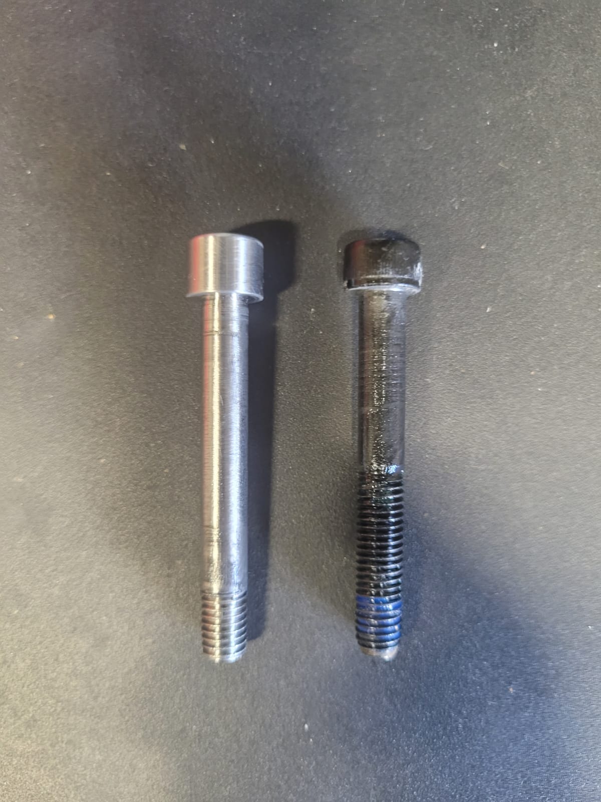

I would like to know their logic. Let's say you used the stock bushings, custom reducers could easily be turned down on a lathe from aluminum (if not CNC'd or even 3D printed). Going a step further, you could start with a fox hardware kit and replace only the inner sleeve- a simple tube. Machining threads and a bolt head out of steel (or stainless) seems inifinitely more complicated.
Burgtec is another company to keep in mind. I wonder if their santa cruz bolt kits might include a match for the EXe.
https://burgtec.co.uk/product-category/products/bolt-kits/
Logic was that when you want to make inner exact diameter within 0,01 mm (for example 7,88mm) its difficult, because tool presses to thin wall of rotating alu sleeve from inside…. Instead they took existing M10 ss bolt from shelf, took down it on lathe to 7,99mm, did 6mm long M8 thread and job was done within minutes. Anyway, there is for sure more solitions, aim is to make the gap between bolt and sleeve about 0,01mm.

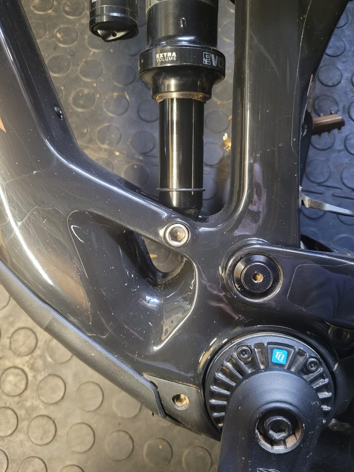

Greetings from Cape Town, South Africa. Our group of EXe riders also has one skilled with a lathe. Thanks to the great write up a few posts back we too managed to make a bolt that fits snug. I've had movement in the lower shock since day 1 and this fixed it for me. Pics below. Would be able to make a few more but probably makes sense for local people only. Cost around R400 (ZAR). Happy riding! bolt3.jpegbolt2.jpegbolt1.jpeg
Greetings from Cape Town, South Africa. Our group of EXe riders also has one skilled with a lathe. Thanks to the great write up a few posts back we too managed to make a bolt that fits snug. I've had movement in the lower shock since day 1 and this fixed it for me. Pics below. Would be able to make a few more but probably makes sense for local people only. Cost around R400 (ZAR). Happy riding!View attachment 144074
Nice one! Is your crank bolt outer missing?

I asked in garage for this and was told, that its technically MUCH EASIER to make 7,99 mm outer diameter bolt then to make 0,01 mm wider inner diameter of mounting sleeve/hardware. And, second problem is, that standard bolts are not produced within 0,01 mm tolerance, so every bolt would need custom sleeve. Anyway its fun for me to read how big talk is about one absolutely easy job - precise bolt. Two years ago I bought exe, shock was knocking, I measured the original bolt, was small in standard 8mm mounting hardware. I went to local garage, asked for five custom bolts, were made in two days and problem was solved. I posted it here much later, because was wondering how strange stupid solutions where written here, like "change rock shox for fox mounting hardware" etc... Dont get crazy, take your bike to local garage, ask for custom bolt and you will forget for this problem forever.
Believe it or not precision bolts are quite common ,maybe your looking at stock iso bolts , stripper bolts (yes i recall thats the name) are precision ground in various tolerances we use mainly h7 in titanium , theyre a standard tolerance, i think engineers in general expect so much more, I often wonder when the bike world is going to up its game on products that can cost 10k + then figure its a mass produced item built to a price with a 30-40 percent markup at retail put to gether by people often working for the love of bikes not a top flite salary plus the shop discount just so they can afford to ride. My honda cost 6k in comparison
Refreshing this a bit. Did a tolerance stack a while back. There are two sources of play on the bolt. The shock bushing and the frame. You cant solve the frame sloppiness unless you match ream everything to a new bolt size. You need to clamp the orange bushing to the frame to reduce the frame bore tolerance issue. The frame fitting is very stiff and you need to make sure you have the widest/closest fitting bushing possible.
I bought a 40mm kit and torqued it up to about 20nm and that fixed it over a year ago.

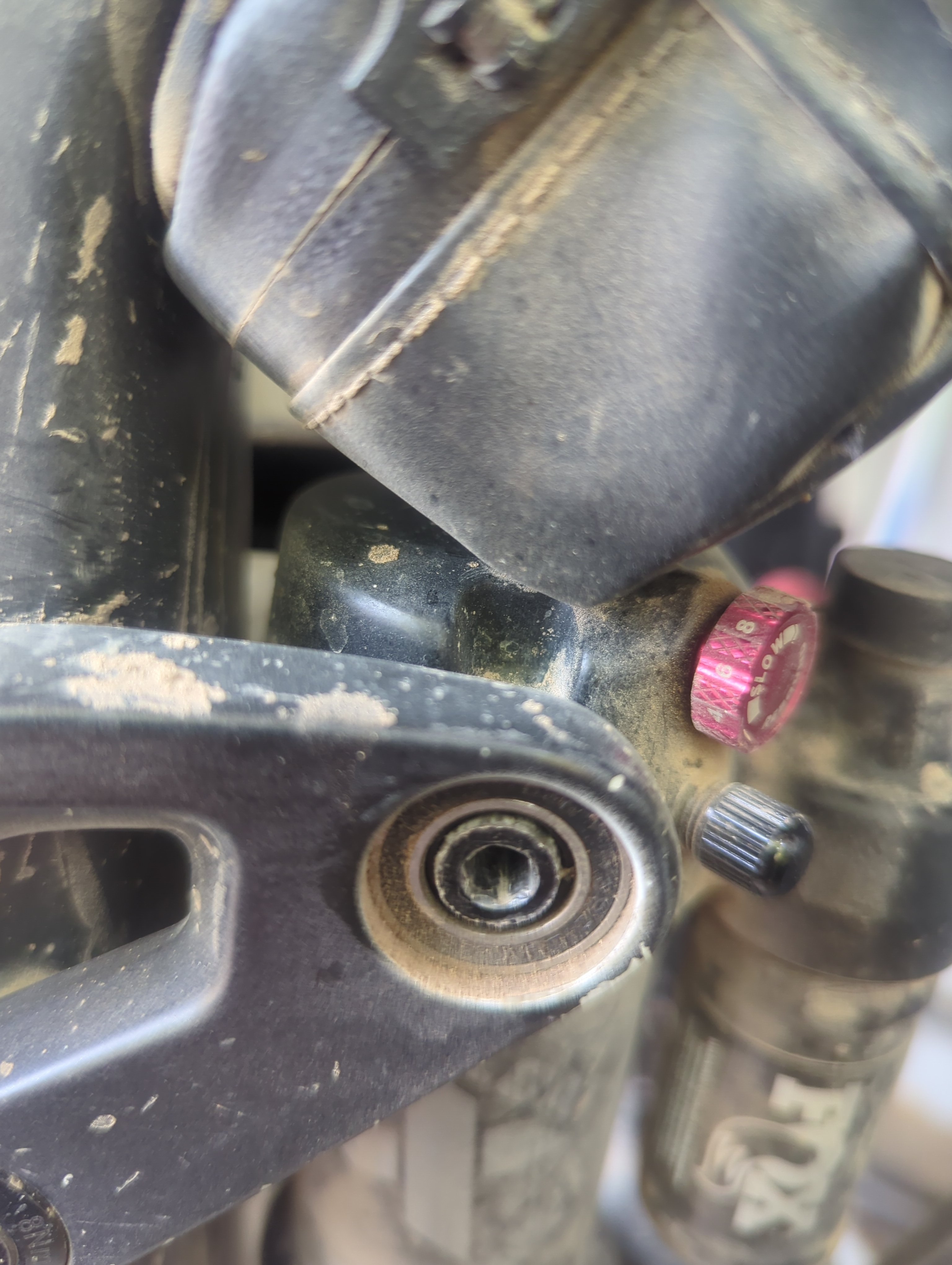

After a shop did a shock service, and bolts were tightened to spec, I now noticed the "head” of the bolt is gone, on both sides.
Anyone had this happen?
Think it might be unsafe?
Or just bad since bearings are exposed to dust
That's terrible, probably not actually super unsafe (but not safe either) , but you could do damage to the shock or linkage if you rode it like that for a significant period.
The shop have sheared the head off the bolt and hoped you wouldn't notice. I'd be raging at the shop if that were my bike.
Time to take it back and get them to replace the bolt and never use that shop again, I wonder what else they've ballsed up?
