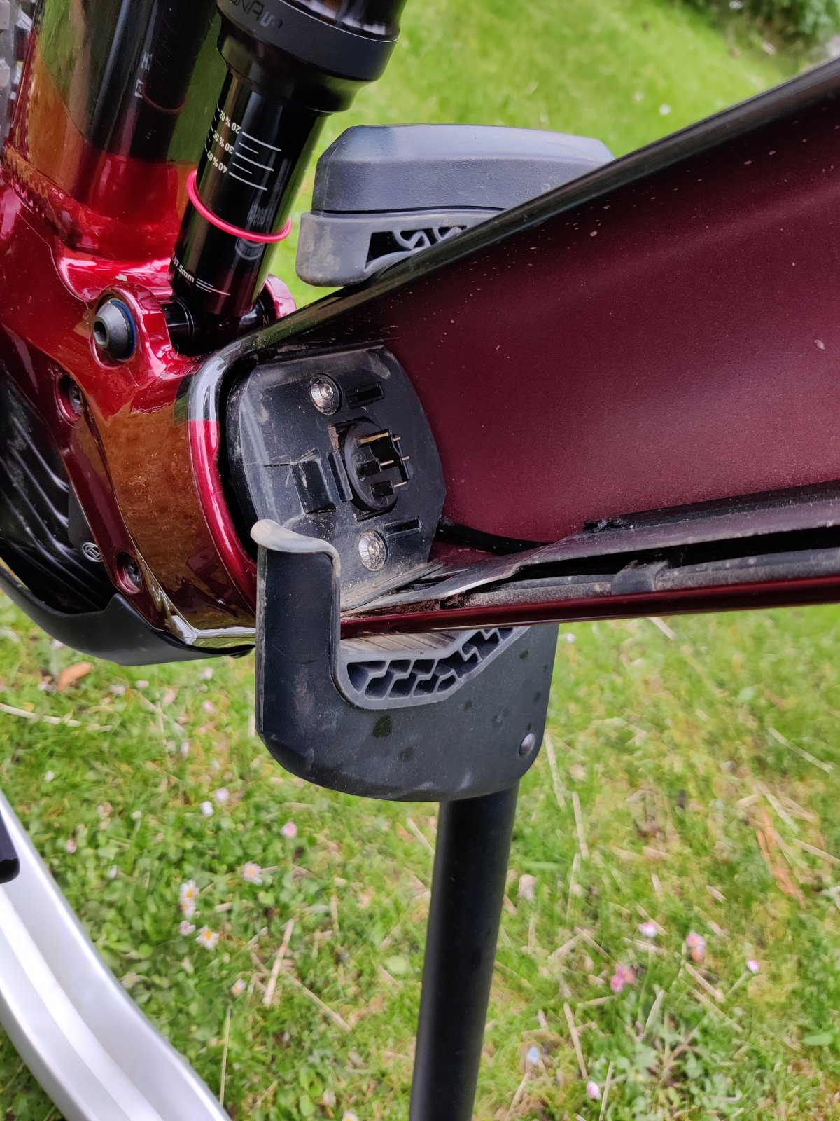

Very good question since a 598 is the only way I've got of transporting my Rail 7 on the car. The news isn't good, just about squeezed it on at ground level, no chance at all of doing it whilst balancing the bike on the roof. And when on the downtube was sitting right on the edge of the lower clamp. Houston we have a problem...

That's the best evidence yet! So glad I asked. Bought a 598 rack (will be sending back!) and expecting bike to arrive on Thursday (although that's been pushed back 5 times, so who knows).
Will be buying a front wheel rack. Thule 599 or Yakima Highroad. Yakima appears to have the best reviews out there!
Thanks for the response!
