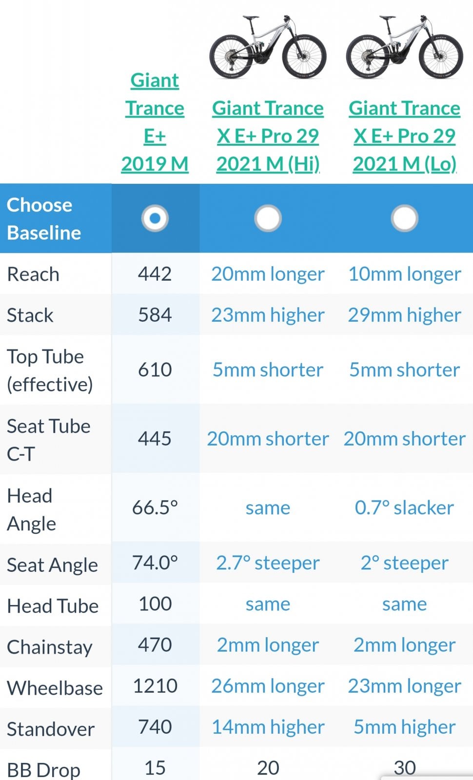

I just bought it and my son has the 2020 Trance e+. In comparison the geometry feels much different. The cockpit on the 2021 feels taller and slightly shorter. The motor has a much beefier bash plate. The 2021 has higher end forks and derailleur. The rear tire is an EXO+.

Based on your height, it would be a medium or small. I’m 5’7” and I test road a medium before my purchase and opted for a small as the medium felt too big with the 29’s.
Thanks for that, than I stay with Medium.

TRNC-X-E aka Transexy is Longer and Taller. In this context it's all good.
This next bit is only my completely biased and unjustified opinion.
I think most folks around here with a 19 or 20 trance, ended up installing taller bars after a few months. The longer lower trend seems to have found it limit on the lower dimension for this demographic. Longer is good but some stack height for comfort was needed. I believe the 2019 trance was a little too low and this bikes corrects that error.
Yes, the 2021 is definitely more comfortable than the 2020 for me due to it having more stack.

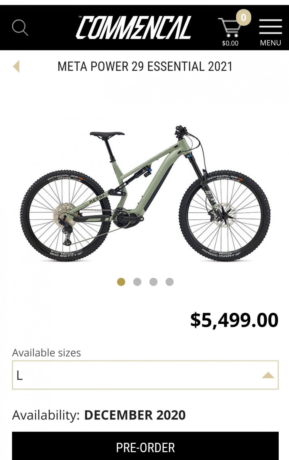

First ebike, looking at this vs commencal meta 29.....the ep8 motor has me waiting and I could get one of these quickly based on info from my LBS....any comments one which one.....the wait on the ep8 is killing me

Sorry it looks like a pregnant guppy. Wont work for me. Gonna keep waiting for my 2021 Commencal... and waiting...
This is a very convincing bike (META)! One could say, an even better spec, at a lower price.
Similar geometry, until you get to the chainstay (gulp), but no token.
Both are painted up in Lincoln lawyer understated elegance?.
These two (TRANSexy V META)would make an awesomely fun head to head.
