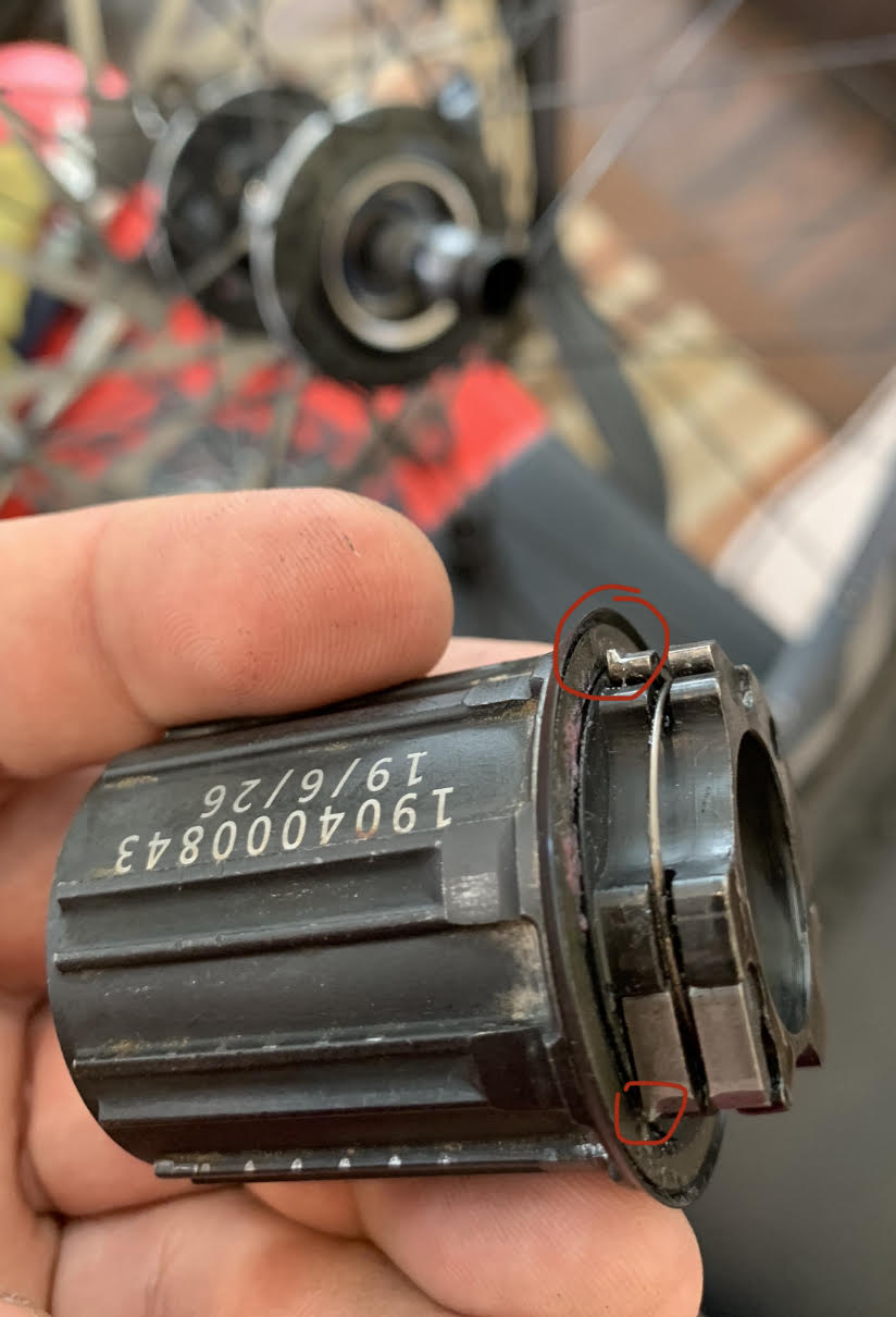

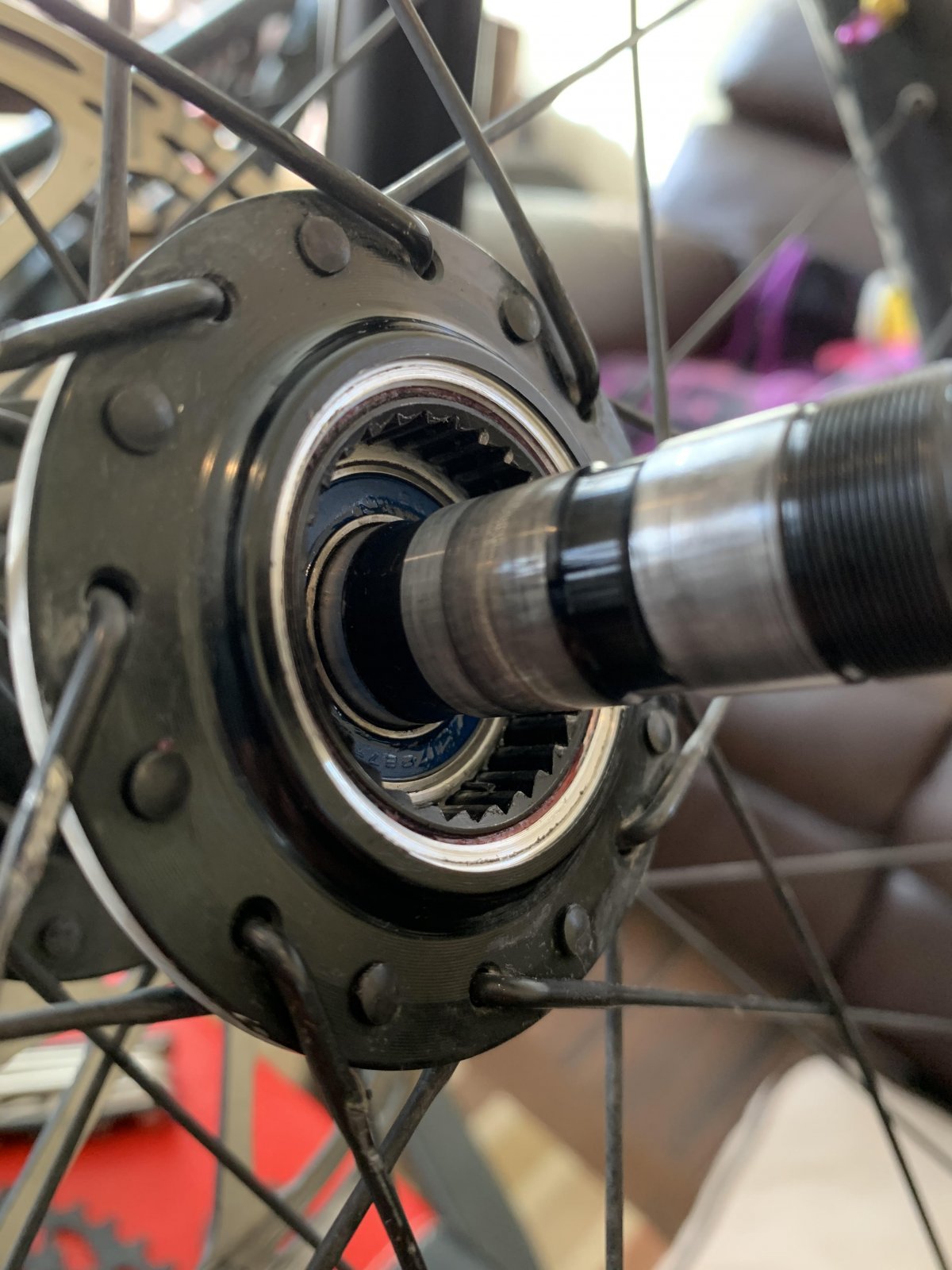

Just wanted to share some pics of my sheared freehub for those that were curious. I'm only 12 charge cycles in, and the freehub on my 2020 reign e+2 gave out on me on a steep uphill last week. Within a few rides leading up to the failure, there were a couple instances on full stride pedal strokes where the chains felt like it skipped a tooth and made loud "conk" sound. From the reading i've done in this thread, i'm assuming that was the pawls skipping teeth and catching again potentially due to the thicker grease mistakenly applied at the factory.
My local LBS reached out to Giant to warranty the freehub, but the wait time is an interesting "2-6 weeks". While I wait, I just want to get back out riding. Does anyone know a replacement freehub that would work? Maybe replacement pawls? The part number on this Giant proprietary hub yields no results.
I've circled the parts in red that show how much material used to be on the pawls. The rest have seemingly slowly sheared away. The ratchet splines on the inner hub still look to be in good condition, since it's cast from hardened steel.

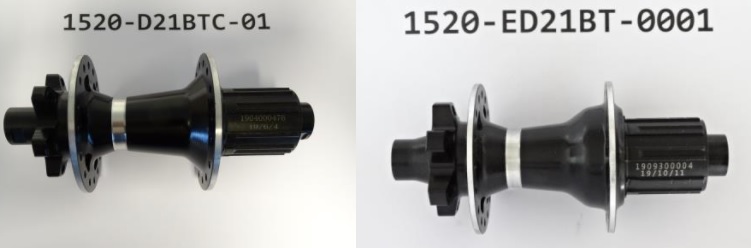

Is covered under warranty and there is a totally new hub, very similar as dt swiss 350 hubs. It has much more quality, is quite better hub and it doesn't report any problem.
Both problem have solution: complete new hub
Thanks for the info. The visual difference between the two (wasn’t initially obvious to me) is that the right hand flange of the new/better rear hub has a stout inner surround. I immediately checked what type is on my Trance e+pro... it’s still doing well so far - but it’s the old version. :(

Yes, de ED reference is the new one. Is much better hub, as you can see is quite similar to DT Swiss 350 hybrid:
Maybe in July this new hub was not ready yet.
