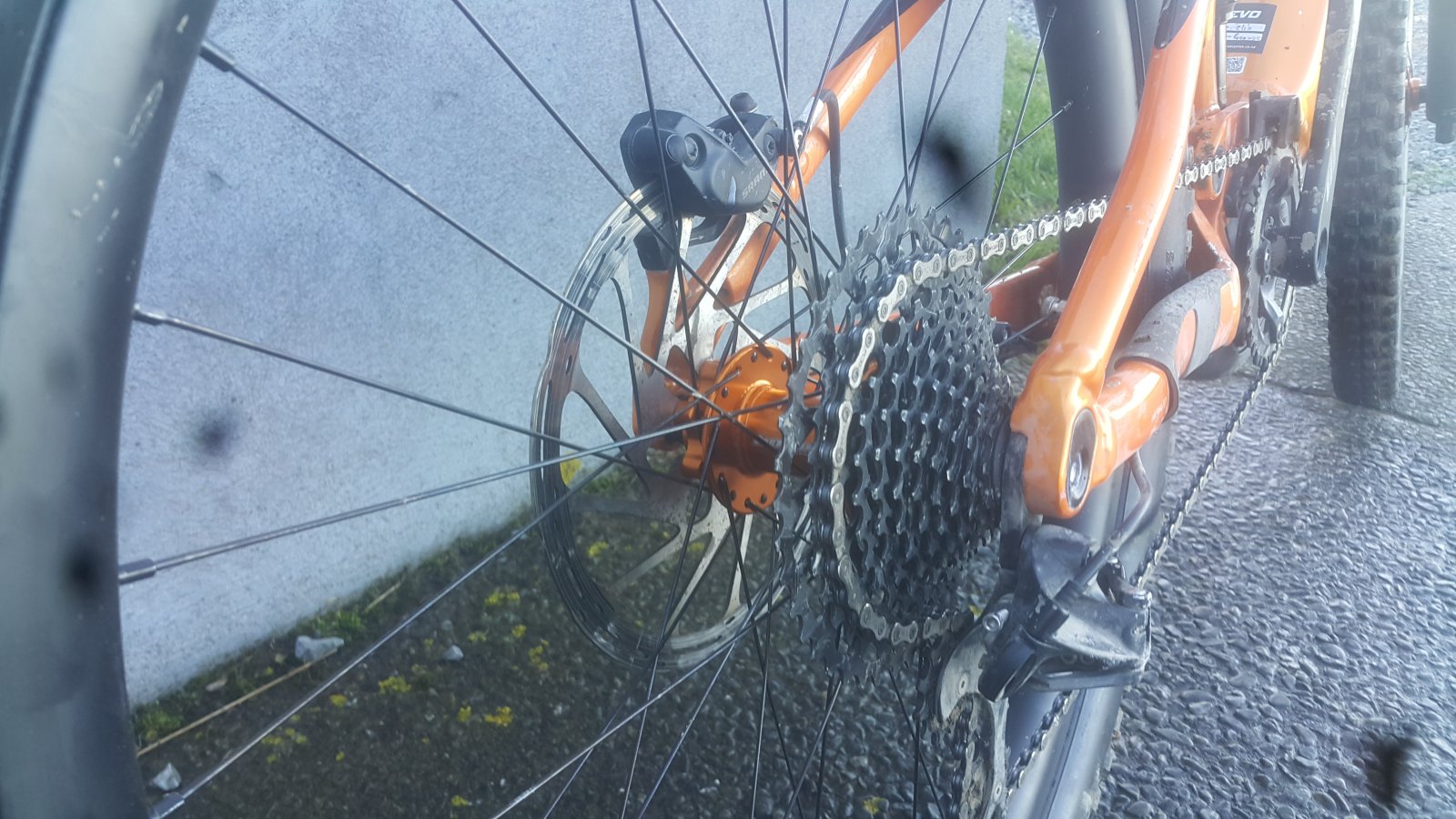

For those looking for solid replacement I recommend Hope Pro 4. Has given me back the confidence I lost from original hub. I love the fast engagement too, responds so much quicker. Sounds sick too!
View attachment 13227Hey Dude
They look sweet, did you buy complete new wheel or have the wheel rebuilt with the new hubs?
