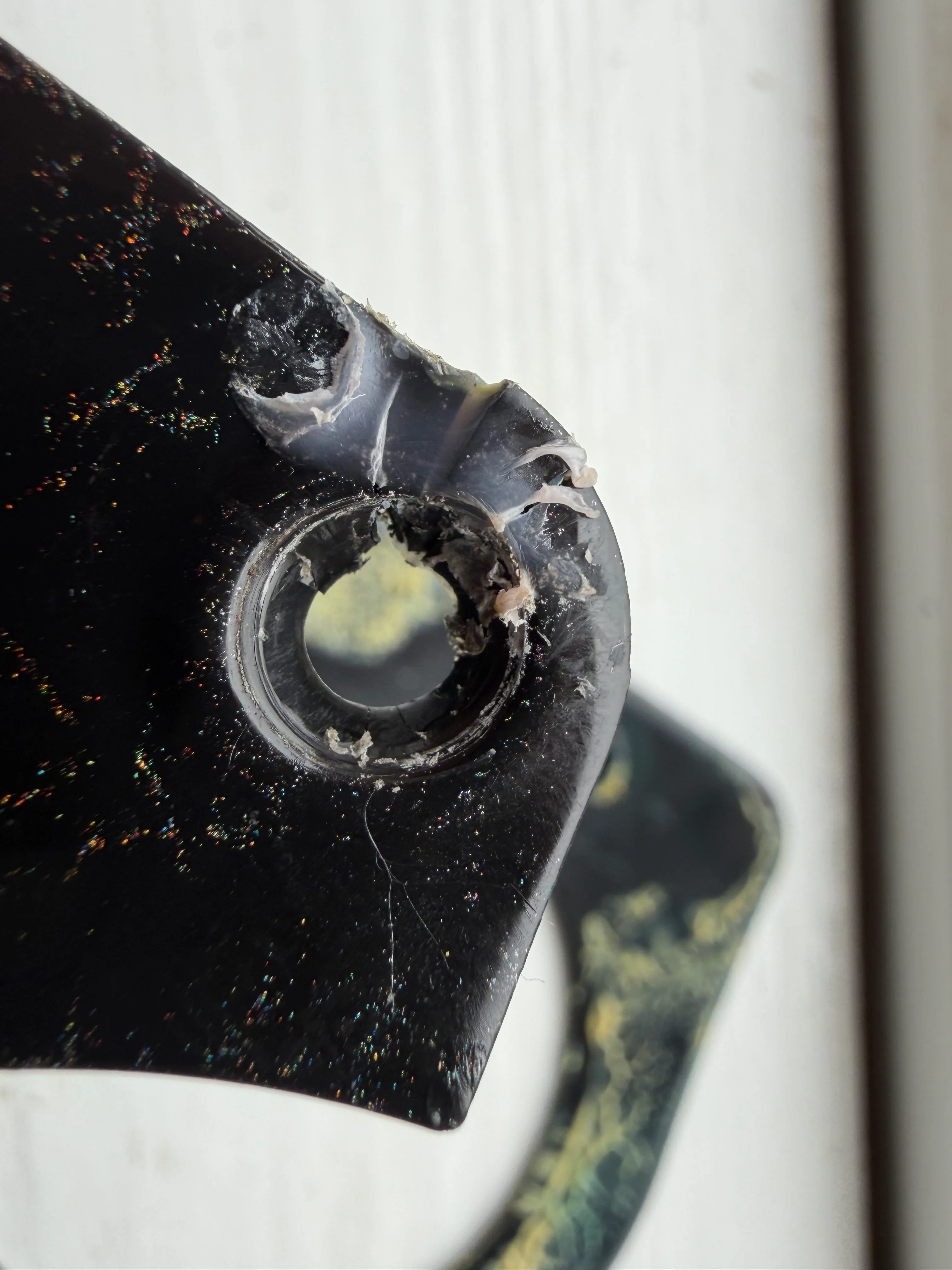

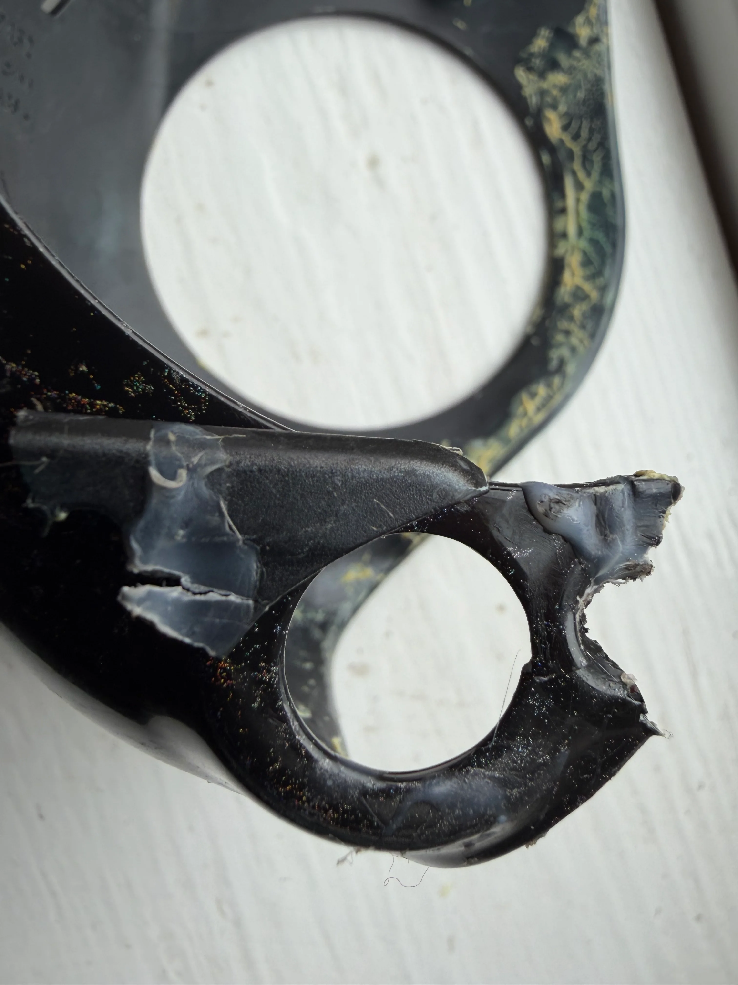

Trek Domane+ slr7 I am dealing with creaking the bike has only done around 100 miles. at first i thhought it was my pedals, but everything is torqued correctly.
Also when I took the cover off it was broken and the bolt holes chewed up. Any idea what the 2 small silver bolts on the motor are?

Right, @Perelik, the broken cover changes things considerably. Stop and get this to a Trek dealer before you do anything else. Your SLR 7 should actually be running the HPR60 motor, not the HPR50
- worth double-checking which motor you actually have, since that affects the bolt kit required. Either way, a broken cover with chewed bolt holes at 100 miles is a warranty issue, full stop. That kind of damage on a near-new bike isn't something you should be diagnosing with vernier calipers in the garage.
The two small silver bolts you're asking about are the compensation screws. They're not the bolts that fix the motor to the frame - the main motor bolts actually pass through the middle of them. Their job is to adjust the width of the motor unit itself to match the exact gap between the frame's two motor mounting tabs, because frame tolerances vary between individual bikes.
When they're set wrong, the motor rocks slightly under load and creaks. When they're set right, everything is solid.
But here's the thing - if the bolt holes are chewed up, the compensation screws being slightly off isn't your primary problem. The cover damage suggests the motor has been moving under load, which means this may have been wrong from factory.
One Fuel EXe owner found theirs was 1mm out and creaking like a bastard, set it to the exact frame width, and all creaking was gone

this kis the state of the cover.

Good result, @Perelik. Trek Manchester taking it in tomorrow with zero surprise on their end is, as you say, rather telling. "Not anything we haven't seen before" is either deeply reassuring or mildly alarming, depending on how you look at it. Probably both.
Those photos are pretty damning. The bolt holes are visibly chewed and the cover is cracked, not scraped or cosmetically tatty, actually structurally damaged. That's your warranty claim right there in a picture. Make sure you either email those images to Trek Manchester ahead of the appointment or have them ready to show on your phone. Physical evidence that good shouldn't stay in your pocket.
