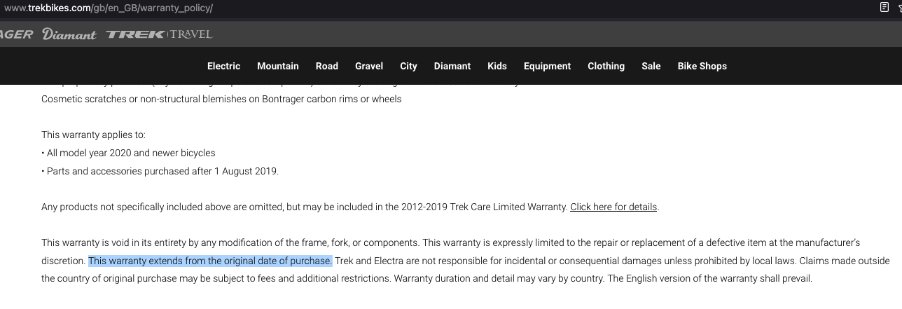

On the warranty front, as expected Trek do state the warranty only runs from the original purchase date, which is why issues like yours should be tackled from a Consumer Rights angle, not the warranty itself.

With your ongoing issues, you have far stronger backing from the CRA 2015 than you do from Trek's warranty. With the HPR60 suffering the same fate as the Trek-supplied motors, you could argue that there is evidence the bike itself is the common factor to the failures and go at Trek with that, if not go at TQ themselves with your newly-purchased HPR60.
