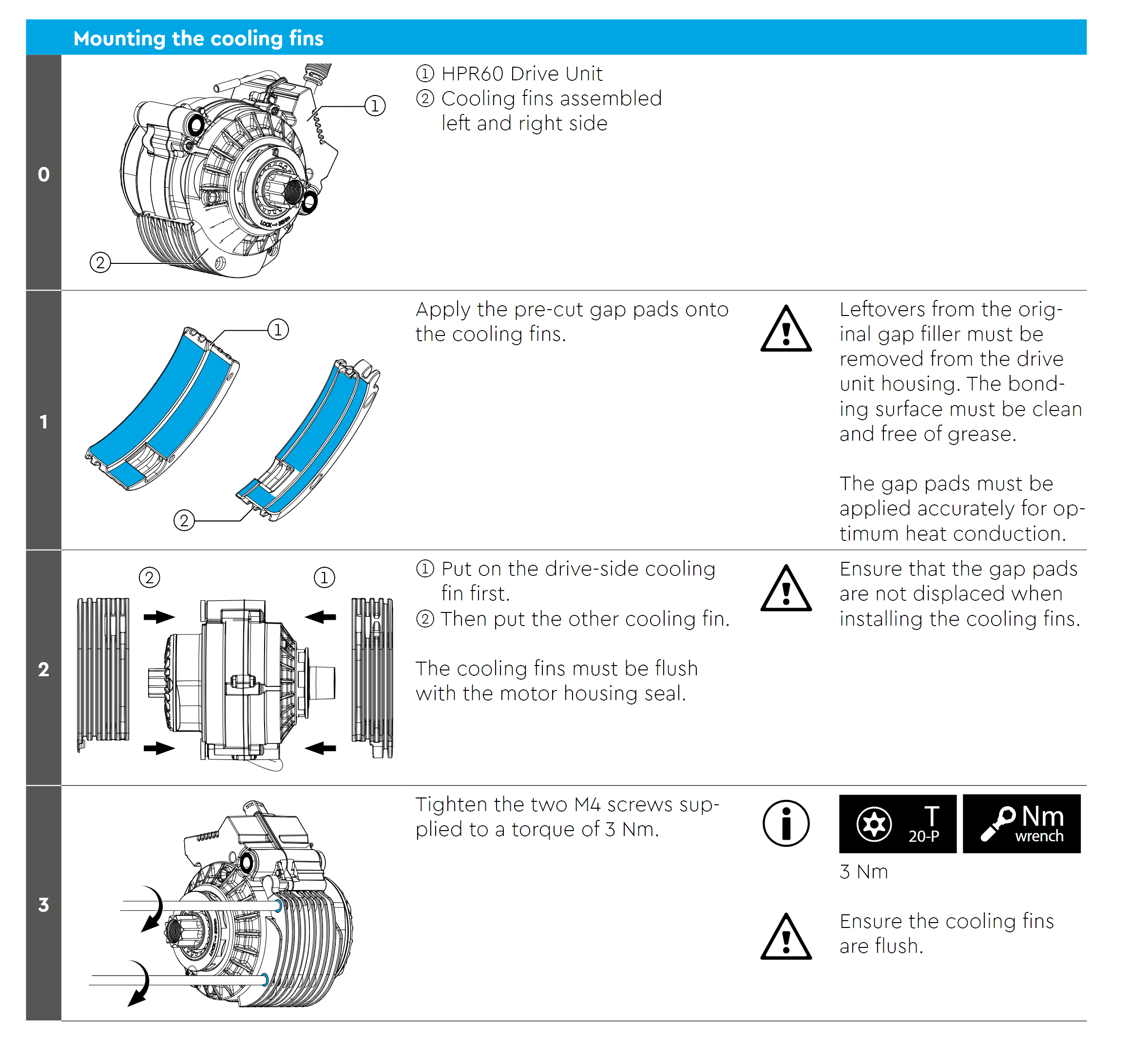

Service manual for the HPR60 shows how the cooling fins can be installed/removed. Relevant for retrofitting to existing bikes but ideally the manufacturers would make new covers that fit around the cooling fins.
Can be found here under the "Service Manual HPR60" tab

I may try one to compare. We have three fuel exes. I think the batteries are not compatible, so that would increase the cost. I do not think the cooling fin thing is an issue; the frame cutout size is determined by the motor size. But in reality the 60 does not seem to be available from silverfish or anyone else just yet.

I have Trek fuel Ex-E 9.8 model 2023 and ran about 4500 km, As I read on TQ home page ,it is possible to replace the HPR50 motor with HPR60 by removing the cooling fins and some E-bike makers made adaptors to use the HPR60 motor with cooling fins.Any one has idea that about it?

I bought it from silverfish, the UK importer. I think it was £899 (or £800 can't remember), it just bolts straight in, but you need the dealer software to activate it.
