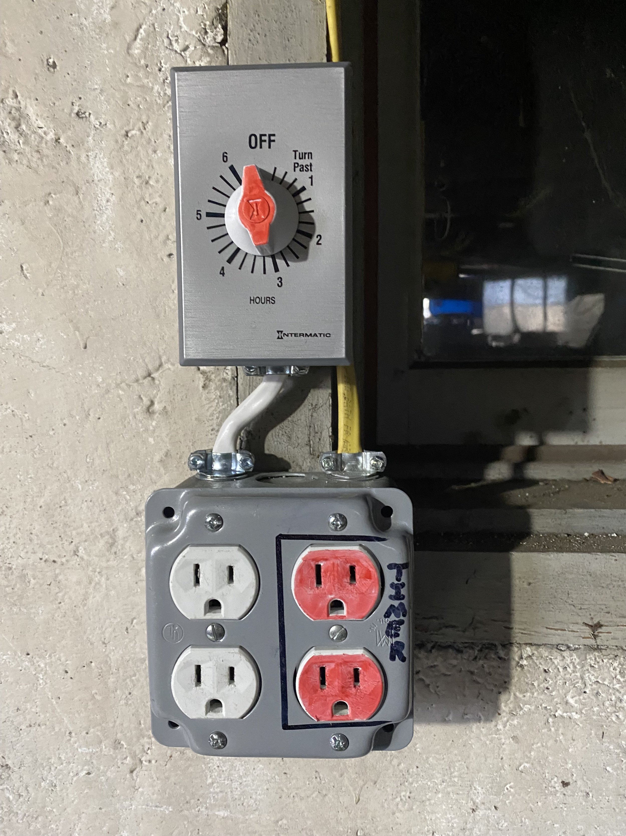

I do use a wind up Intermatic timer that I installed so the AC is off after charging. When I said checking every 1/2 hour increments, I meant until I bring it back up to 70% after riding. If I left it on the timer for an hour or so after a ride, it would probably go right up to 90%.
