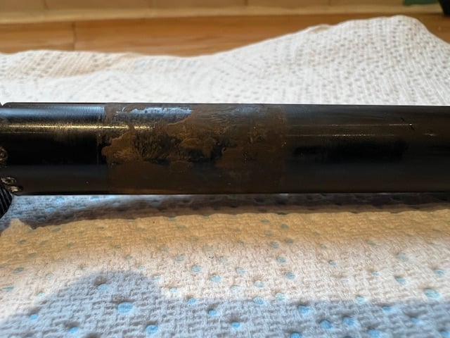

I’ve ordered a new axle. As you can see, the axle is scratched/worn marks.
I’m going to clean inside of hub and oil/grease well.
Any ideas why the damage has occurred?
See Post #10.
Some will tell you grease is not necessary. The bike store boys don't do it. The YouTube jockeys don't do it.
But your pictures show what happens when you don't use grease to protect the metal and inhibit water intrusion.

View attachment 128057 View attachment 128057 I’ve ordered a new axle. As you can see, the axle is scratched/worn marks.
That is fine particles of dirt and grit build up through lack of removal of axle for months if not years.
Clean in up, Grease it up, remove every month or 2 to inspect and clean.
Job done.
I have some vision loss, so it's hard for me to see exactly what's going on. Greasing the new through axle can't hurt (and definitely grease threads and metal on metal), but through axles shouldn't contact any portion of the hub axle. Properly fitting undamaged end caps will provide separation. Are they in good shape? Might as well check everything out while it's pulled apart.
