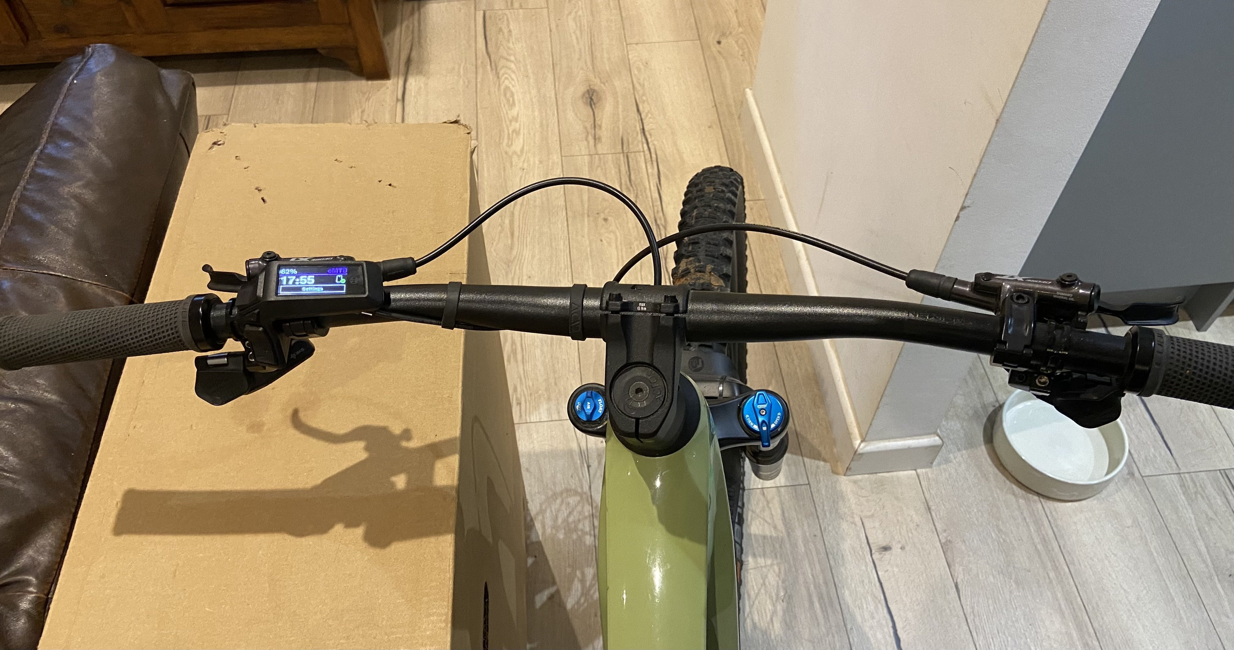

Just had mine fitted today. It’s a little chunkier than the led controller and doesn’t have any adjustability for mounting. Seems to do everything the led controller/kiox combo does other than navigation.

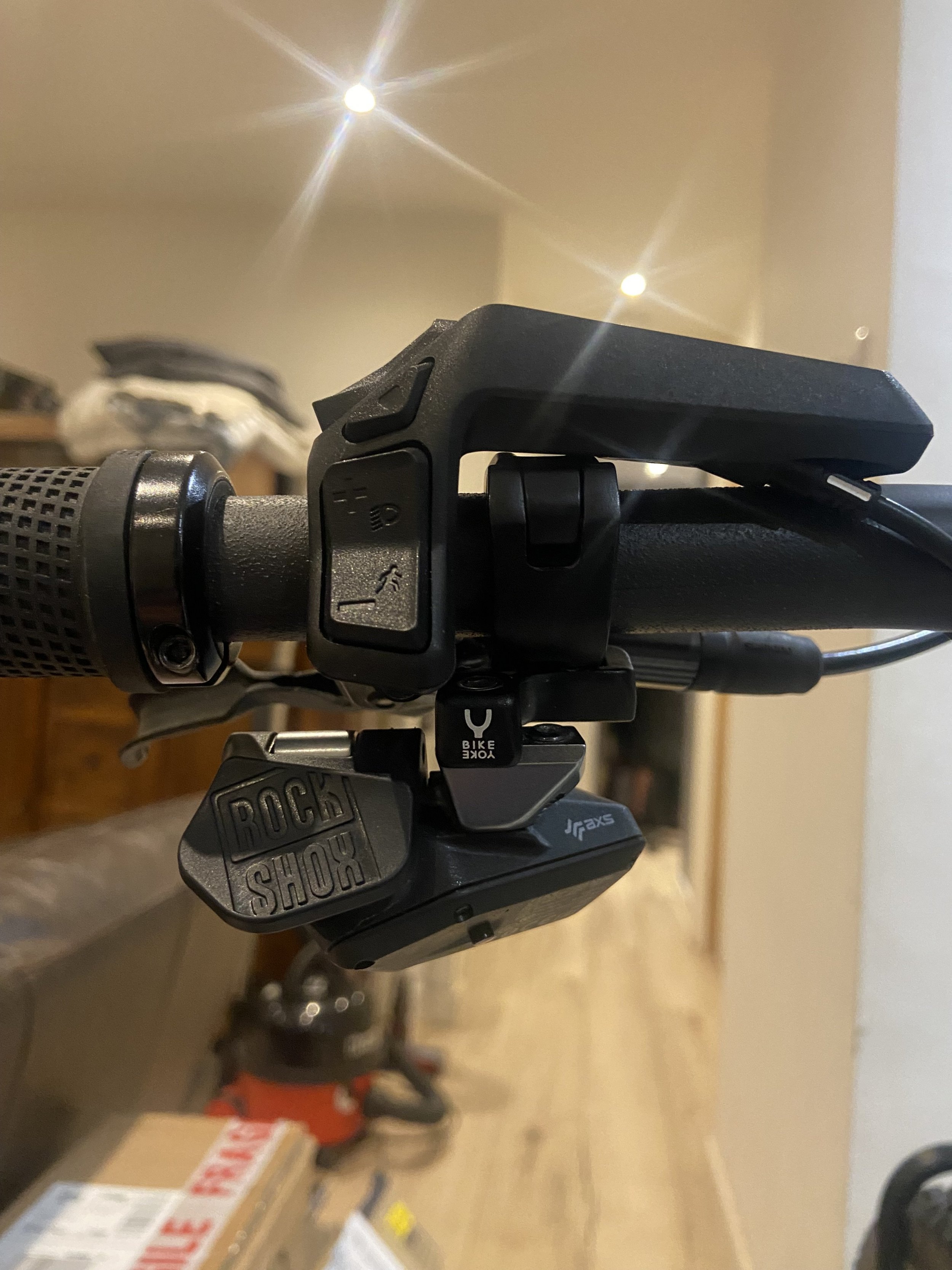

If you mean the gap between the clamp and the little brace, it does fit as shown in my picture above. Pretty sure it’s designed to sit right next to the clamp with the little dip it has in the back of it. You cant really sit it anywhere else. It is a faff to get it on though. You have to fit the brake and controller simultaneously. I’ve also got a matchmaker for dropper lever which makes things easier.
