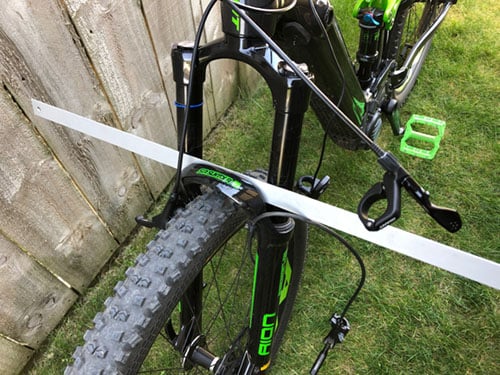

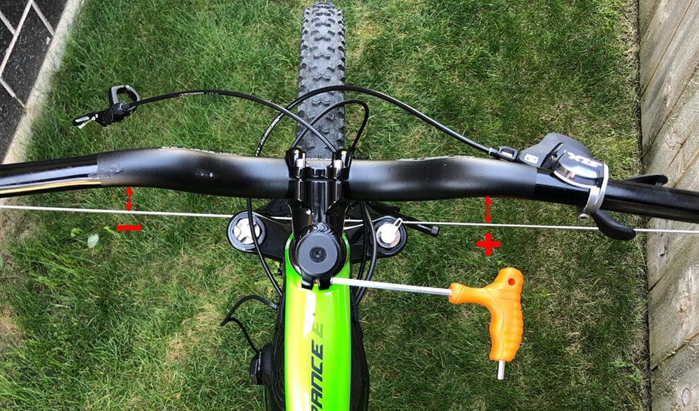

Handlebar Alignment Guide
If your OCD is playing up, here's a hack to make bar alignment easier, quicker, and super accurate.
1) Place a ruler (preferably a wooden yard stick or a thin wood trimming) and lean it against the front of the two stanchions and just behind the slider arch. If you have an aluminium ruler like mine, stick some vinyl electrical tape so as not to scratch your fork stanchion coatings, because when you stand over or sit on the bike the fork could move. So clean and wipe all the grit off the tubes before you start! (I'd say DO NOT use a steel ruler with sharp edges - just not worth the risk).
2) You still have to eye-ball it from above but using the ruler as a reference takes much of the guess work away. Pic below is just to illustrate where to peek at the gaps (left and right gaps are uneven here). Make sure you position the one eye you're using directly over the stem cap, and then move your head forward until only a slither of the ruler shows through the bar bends.
Best to lean the front of your tyre against a wall so that you can turn the bars accordingly without taking the fork along with it. Tighten the stem clamp bolts and forget! (Make sure you've tensioned your head set bearings properly with the stem cap bolt, before you do.)
(Now all that's left to annoy you is how imperfectly aligned your hands are on the bar grips, and how irritating it is to see your left and right shoelaces NOT flopping in the wind in perfect symmetry.)
Great idea but instead of having to eyeball it from above and having to move you head/eye around, why not just take a picture as you have done here as the gap difference is obvious. Adjust and take another picture if need be.

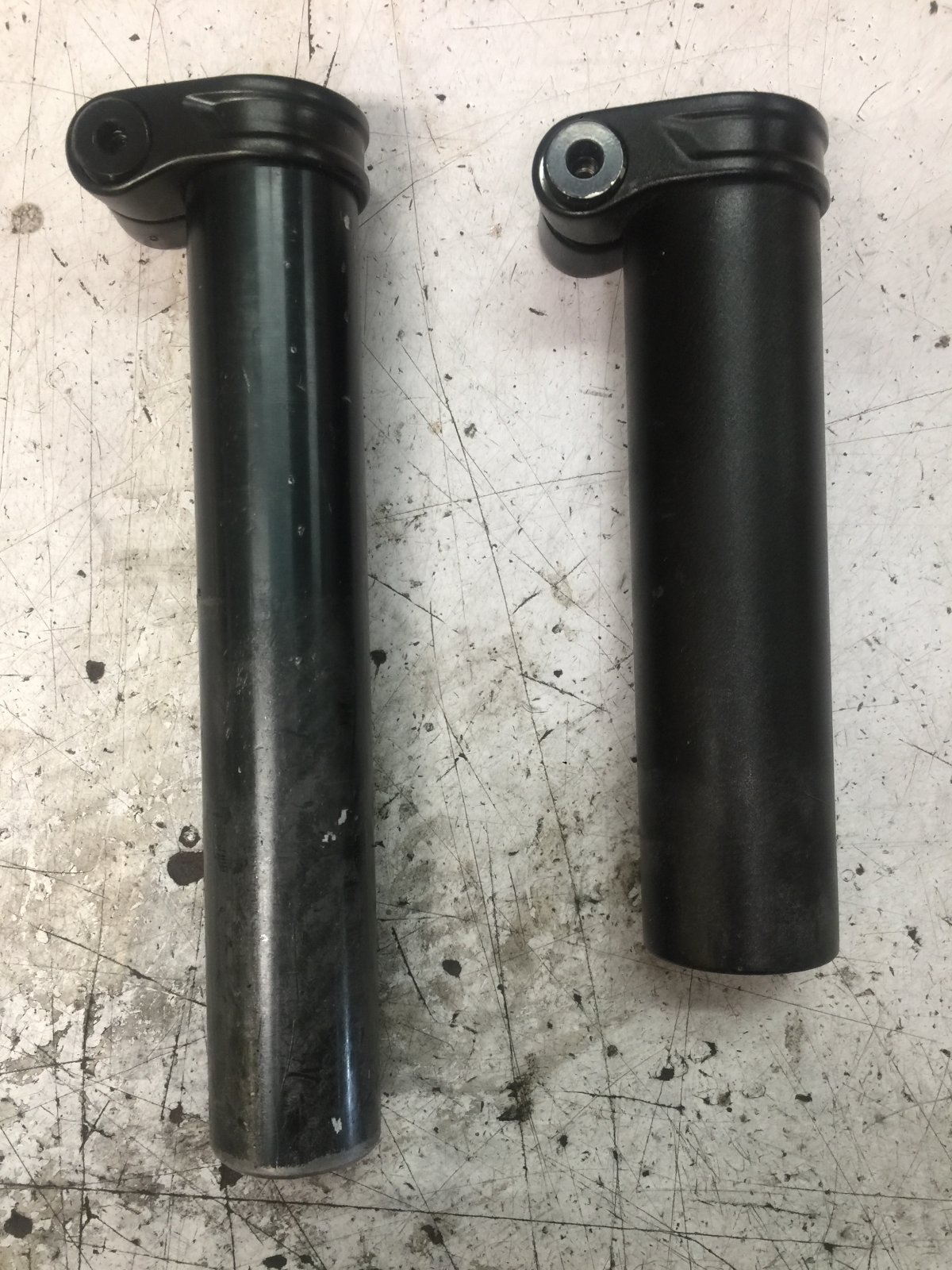

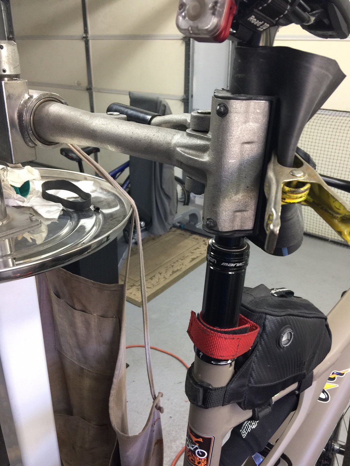

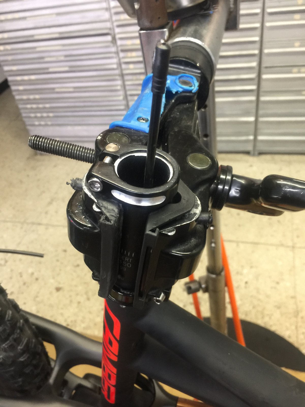

Since I build and service Emtbs and Mtbs all day, I’ll share this one.
When a new bike comes out of the box, the cable for the Dropper is sticking out of the frame.
You can hook up the Dropper before you do anything else, but that’s a hassle out of the stand while everything is wrapped up and the handlebars are not installed.
You can shove it down in the frame and connect it later but that might crimp the cable housing or make it hard to remove.
So my solution was to use a straight post and cut the top clamp off and tighten a seat collar to the top of it.
My repair stand has something to clamp onto, the cable can stick out and I can strip and build the bike in my preferred sequence.
It’s also great for repairing bikes with droppers. No one wants to see their Dropper seat post clamped in the repair stand. And there is no danger of the post getting scratched.
Agree!
There's gotta be another way to attach an eBike to a repair stand. My D-post is set all the way down so there's not enough of the outer post to grab. I don't know about other bikes but with my Trance E+ you'll have to pull the inner actuator cable all the way out above the seat clamp to unhook it - in order to be able to install a normal seat post (or maybe just a tube) in it's place... and it'll be a pain to insert the inner cable back in again. The outer cable end is down deep and can't be easily pulled out because of the semi-permanent internal routing.
At the moment, I'm just hanging my bike under the front of the Saddle but it's far from ideal because the front end is down touching the ground and it's wobbly and not secure. :(

[QUOTE="Al Boneta, post: 116578, No one wants to see their Dropper seat post clamped in the repair stand.
I'm hoping the cushion from the old inner-tube wraped around the post prevents any damage to the seat post riser...so far so good.
Your stand's clamping faces already have protective plastic/rubber inserts and are fine to clamp a dropper stanchion with. Just make sure there's no debris on the stanchion or the clamp covers
I've clamped thousands of dropper posts in Park tool stands with the same style plastic/rubber clamps you have and never damaged a single one. Infact. every single time I service a dropper I actually use the park tool stand to clamp the post in to allow me to undo the top seal assembly.
When building new bikes from the box with droppers I generally place the bike straight from the box into a Feedback sports Rakk folding wheel support stand with cardboard from the box under the fork dropouts. The stand then holds the bike while I attach the hose/cable and insert the dropper into the frame. then I'll clamp the bike in the workstand by the post.

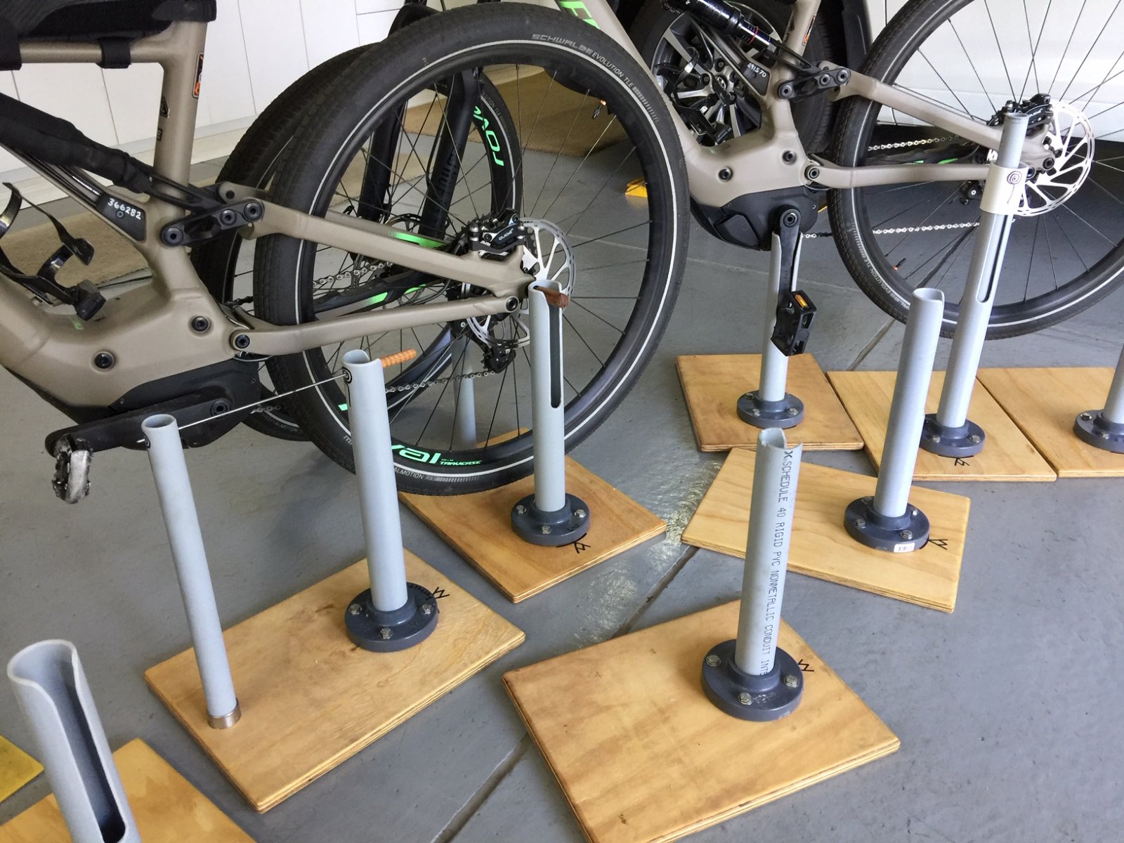

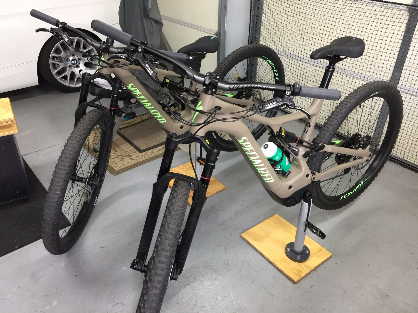

Parts via Amazon since I reside in a small city without great hardware stores available:
NIBCO 4551-H Series PVC Pipe Fitting, Flange, Schedule 80, 1-1/2" Socket Stainless T-Nuts, 5/16"-18 (25 Pack), Threaded Insert, Choose Size/Quantity, by Bolt Dropper, Pronged Tee Nut. (5/16"-18 X 3/8") NELXULAS Stainless Steel Closet Rod Flange Holder for Pipe (AD2) 5/16-18 x 1-1/2" Hex Head Cap Screw Bolts, External Hex Drive, Stainless Steel 18-8, Full Thread, Bright Finish, Flat Point, Quantity 25 by Fastenere
Pipe riser is 40 schedule electrical conduit with slot & radius edges...kind of fiddly to cut & a Dremel tool comes in handy for easing the edges.
Made a few for family and friends including the "KABOB" model which skewers the rear axle for chain maintenance when on trips or camping. Miscellaneous adapters and extensions can be added if you get creative....must be my OCD kicking in ....:rolleyes:

Super Nice! You should sell them on ebay. I'd like to try but I'd never make clean cuts down the pipe like you have. * Just realized you could put small castors under that and push bike and stand around the garage when needed.

Deadeye:
An unanticipated advantage is that the stand doesn't need castors to move about since the PVC squeezes and stays onto the Praxis Crank arm and simply lifting the rear wheel slightly allows easy relocation. Cranks with end cap protectors also fit in the stand, if the slot is slightly elongated, and pinch on very firmly. Castors would make the bike unsteady during servicing.

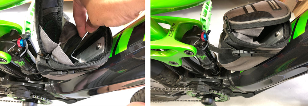

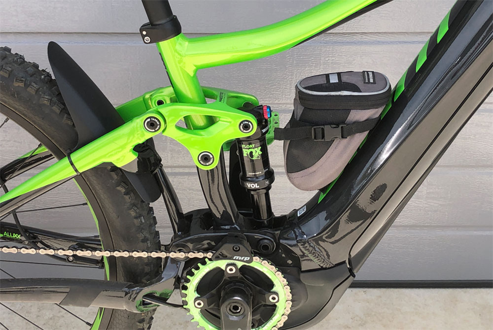

Preparing my bike for a weeklong holiday up north this Christmas break. We've only gone away for day-rides, without taking any spares or tools and have gotten away with it thus far. Not taking any chances this time.
I've got this really old Saddle Bag which straps onto the rails at the underside of the saddle for hardtail MTBs - but definitely NOT for full suspension bikes. I cut two aluminium flat bars and drilled two holes that line up with the water-bottle bolt holes on my Trance E+ down tube. Punched two holes on the Saddle Bag and sandwiched that area between the two flat bars then bolted the bag to the frame.
I was worried that my feet might hit the bag because it can flop side to side a tad, but I've taken it out on two different trail rides and it works just fine. Tightening the side straps stops everything inside from rattling about, so no noises. Not waterproof though, but easy enough to put the stuff in a plastic bag.
Inside is a spare inner tube (I know, I know I'm an old fart :giggle:), a CO2 inflator with 1 cylinder, two tyre levers, a multi-tool with a mini chain splitter, a quick-link, and a few other bits. The idea is to just make do and get back to the car which will have all the proper tools needed to make proper repairs if needed. Hope we don't need to use any of it.
