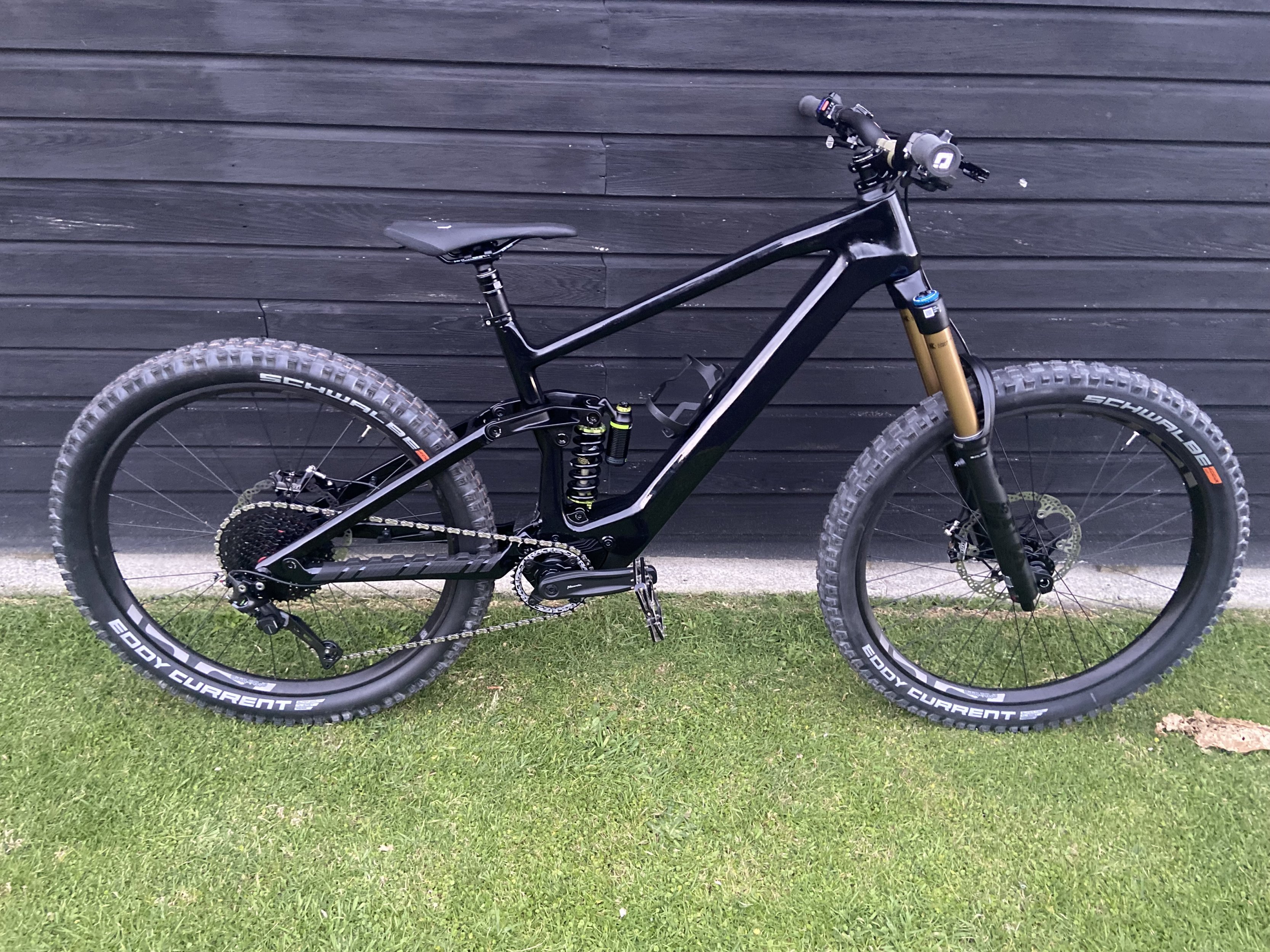

Here is my DIY ebike, good comports and geo is bang on, I shopped around for good gear at the right price. The build cost was $8000 nzd or $4900 usd.
Rides as good as a mainstream bike at half the price.
